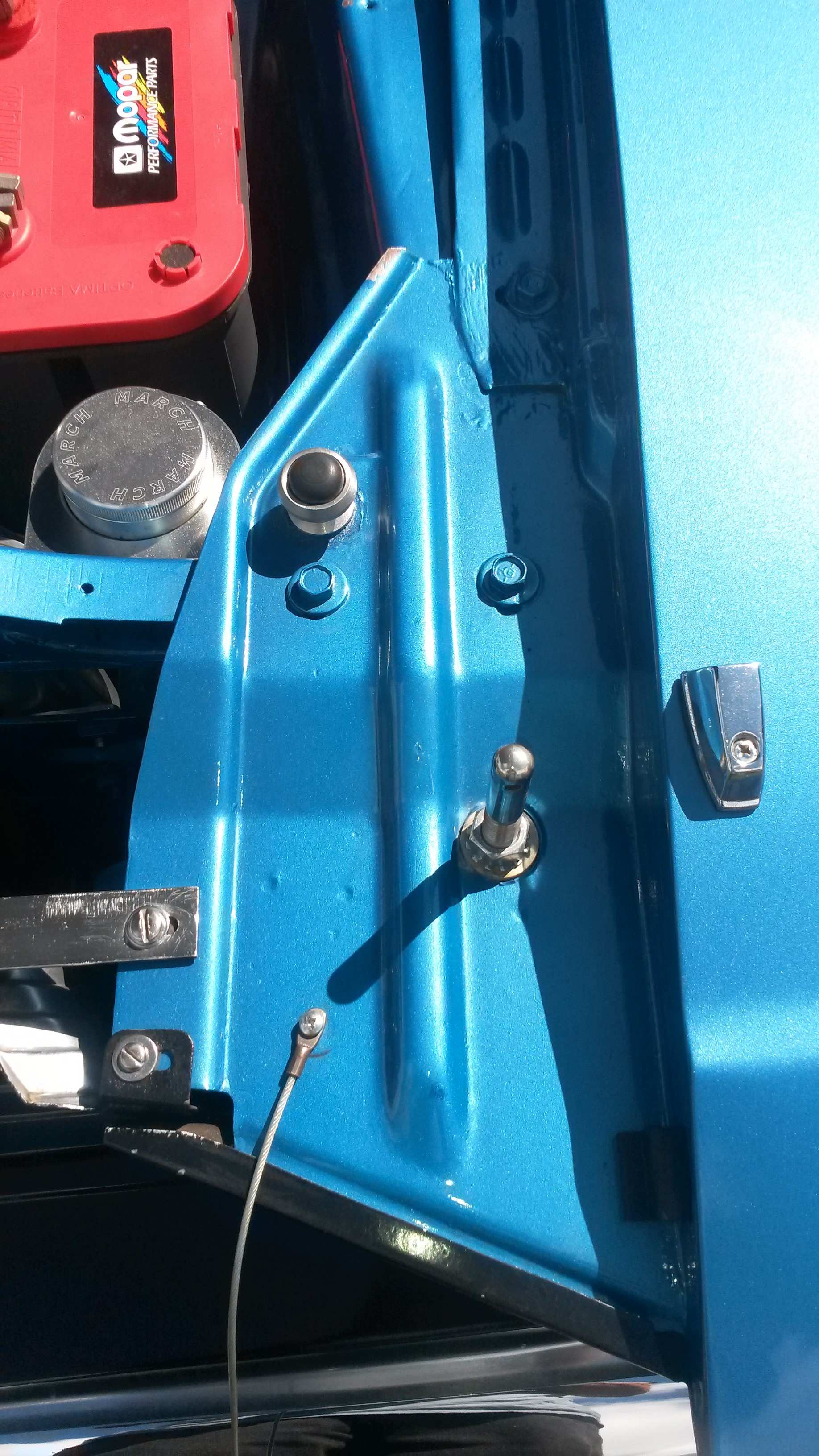

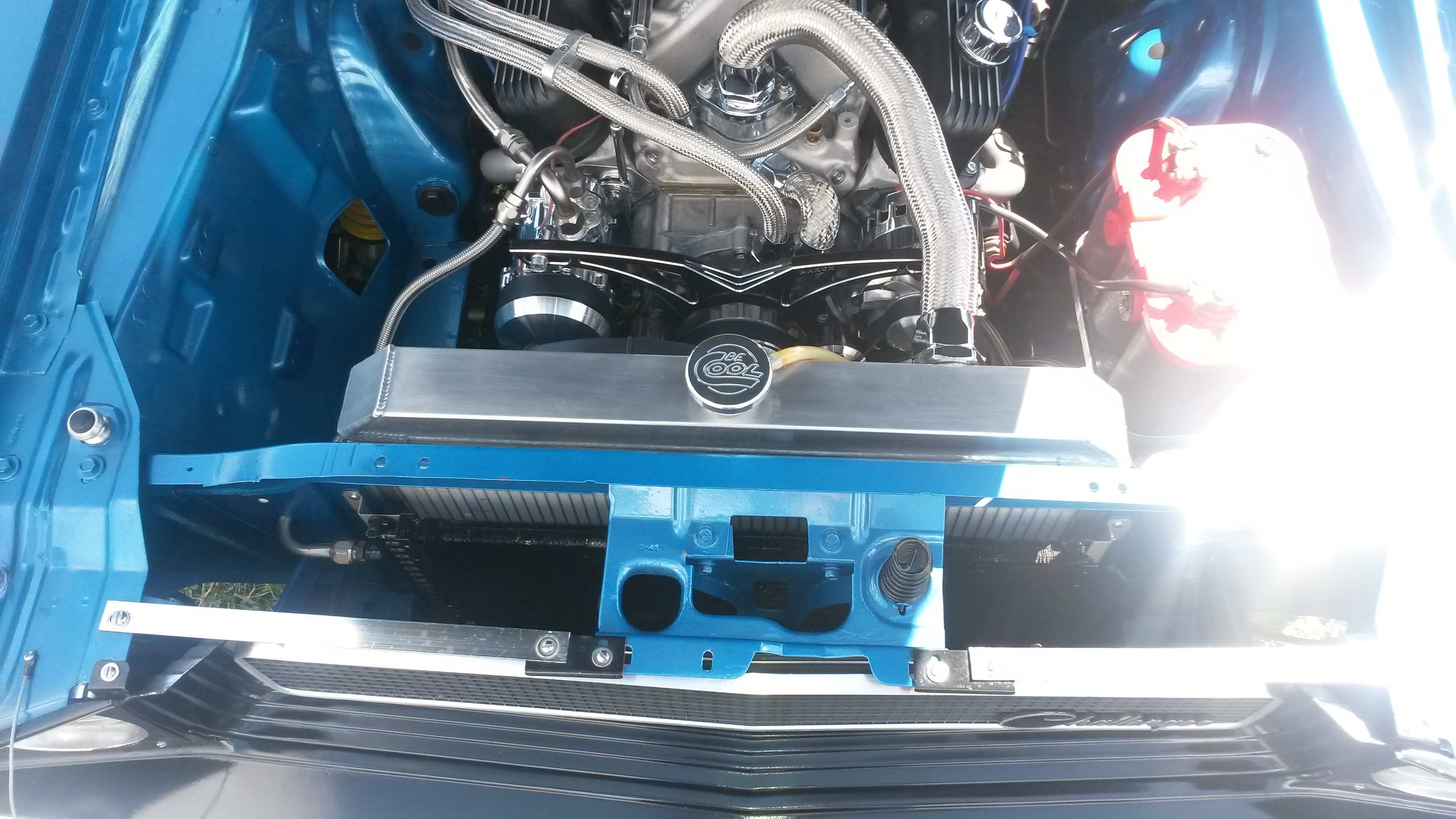

Headlight buckets are part of the fender on a '70, part of the header panel on a '73.
I changed the grille of my '73 to a '70 by first getting the grille and headlight surrounds and then buying the fender headlight bracket/panel (whatever you want to call it) from a guy with trashed fenders.
Fit the 70 headlight brackets to the 73 fender. Have to take your time making sure you have them positioned properly by mocking up the whole grille assy to make sure everything aligns properly.
Then...your bumper will have to move back or it will look kind of goofy. You will have to slot and notch the bumper brackets to be able to move the bumper back over an inch.
