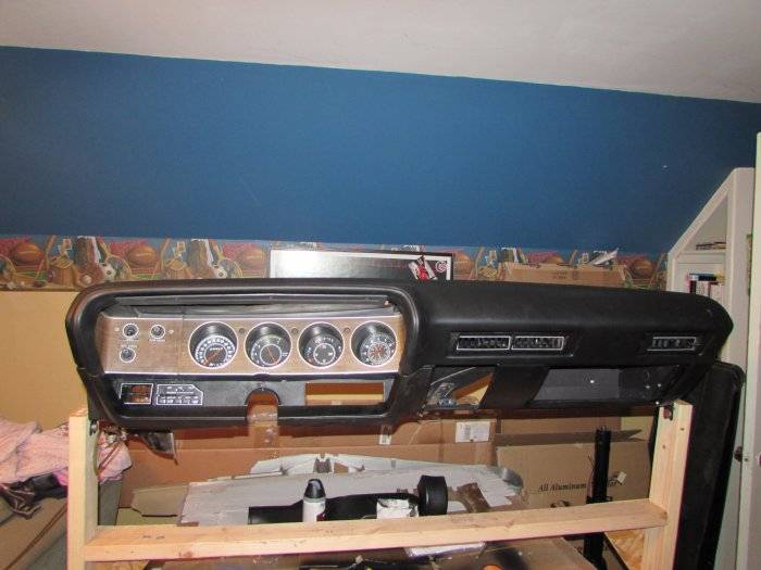

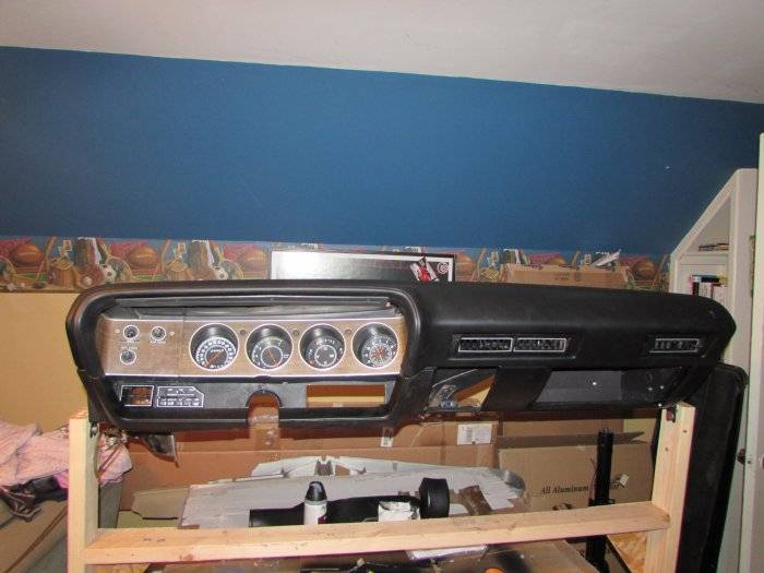

rklein71
Feb 27, 2015
1,176
539
Amarillo Texas
I would spend an hour and put together a 2x4 stand, so much easier than trying to roll it around on a bench or tabletop.
