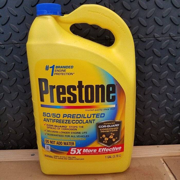

I always leaned towards an old reliable. Especially if is contains corrosion inhibitors.
