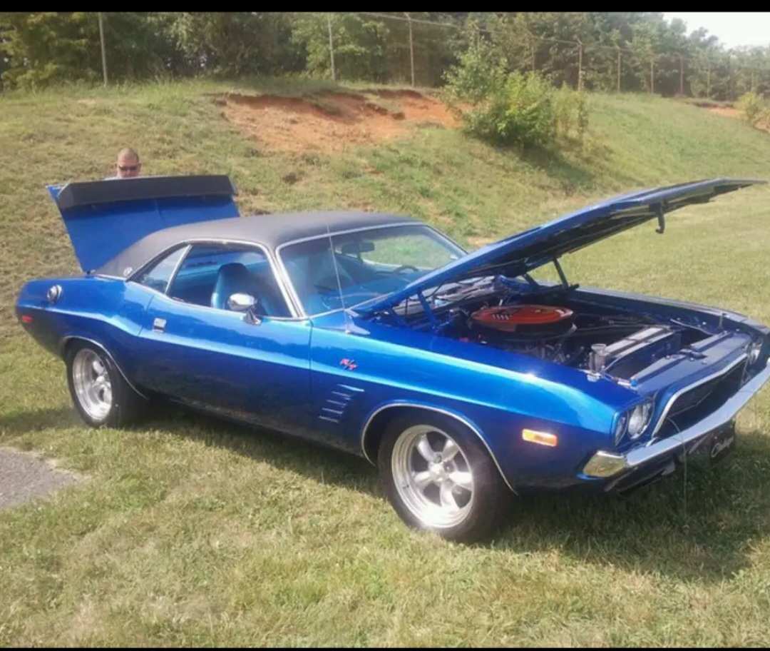

mrmopar340
Dec 10, 2023
405
253
Shawsville Virginia
I put 72 brackets on my 73 and moved them back towards the body. 73 bumpers fit fine on mine with the bracket change.
