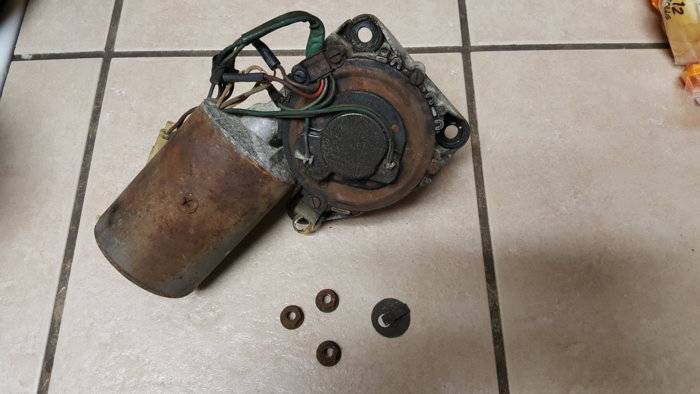

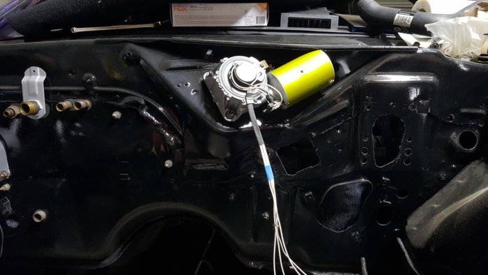

Wiper motor disassembled, cleaned, lubed, painted, wired and reinstalled.
