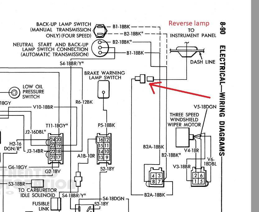

What do you have it connected to? Should go here, near bulkhead connector, engine compartment.

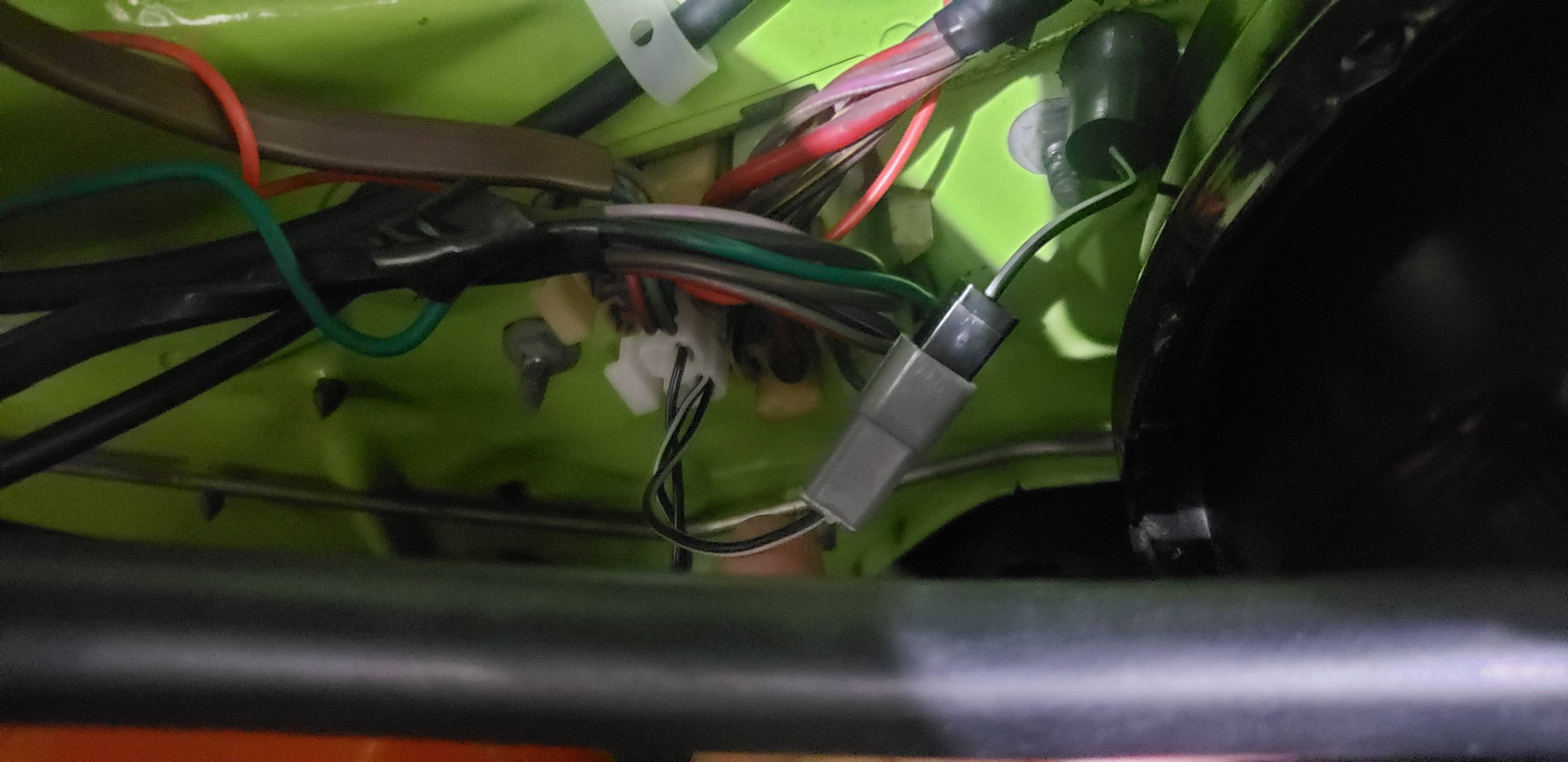

Thanks for the reply. Yep, it's connected in the right place. Cable runs from the trans switch to the bulkhead connector then from bulkhead it connects to a wire that passes through firewall to the reverse light in dash. Weird. As I said, the back up light comes on when put in reverse so I know the trans switch works ok, but I cannot understand why the dash light is always on?

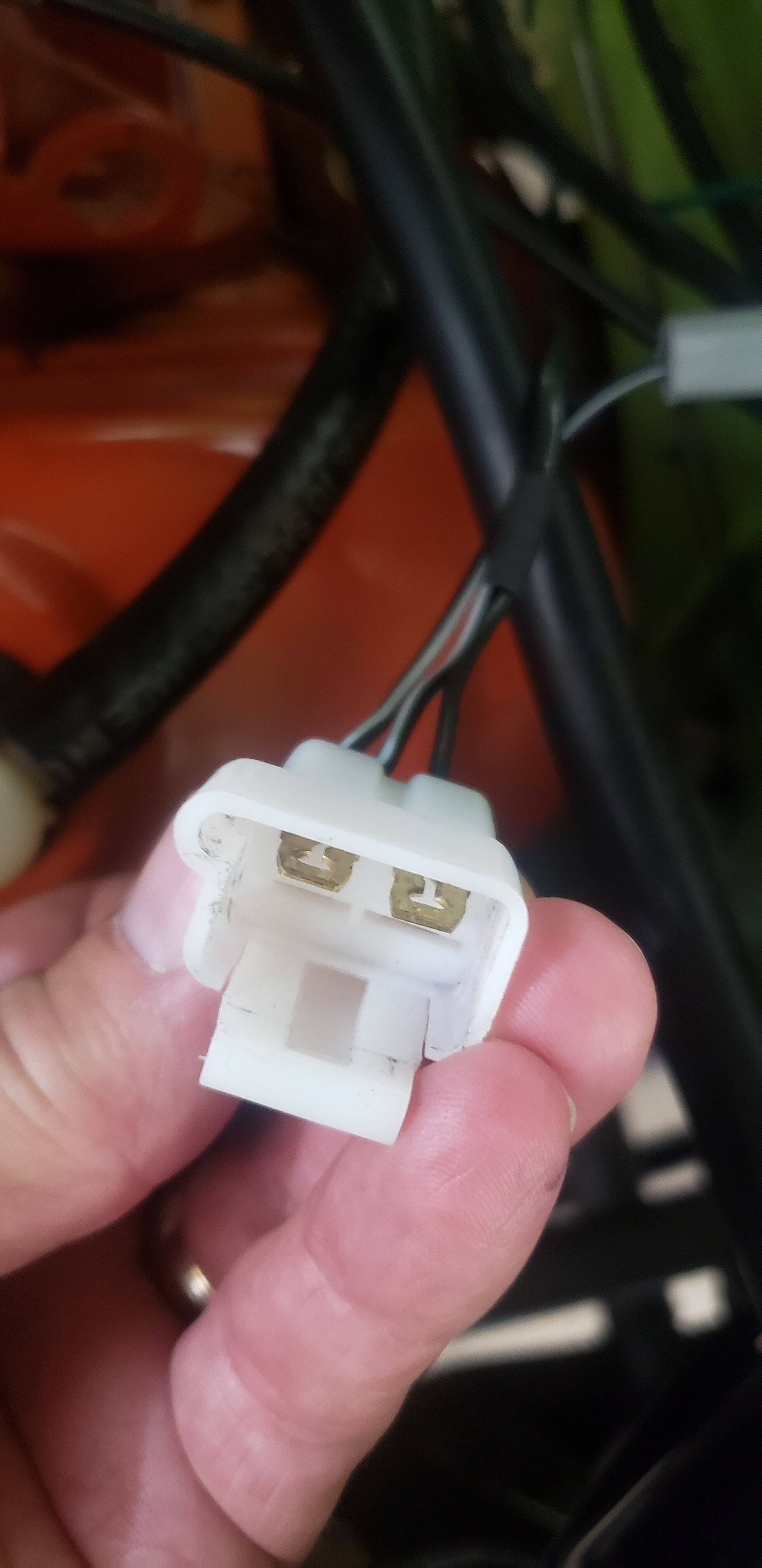

The black and black with tracer wire terminals in that bulkhead connector are reversed, swap them around it’ll work correctly. The black with tracer wires should be in the upper (#7) cavity, the black wire in the lower (#8) cavity.

Interesting. I'll give that a shot. I don't suppose there is an easy way to swap the terminals in the connector without having to cut wires and splice?

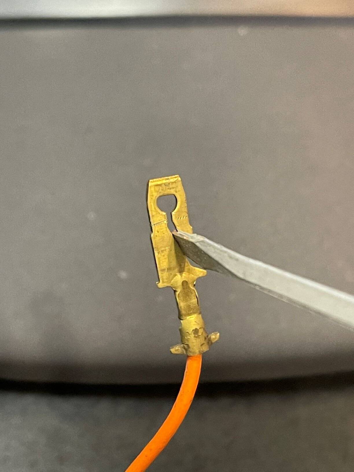

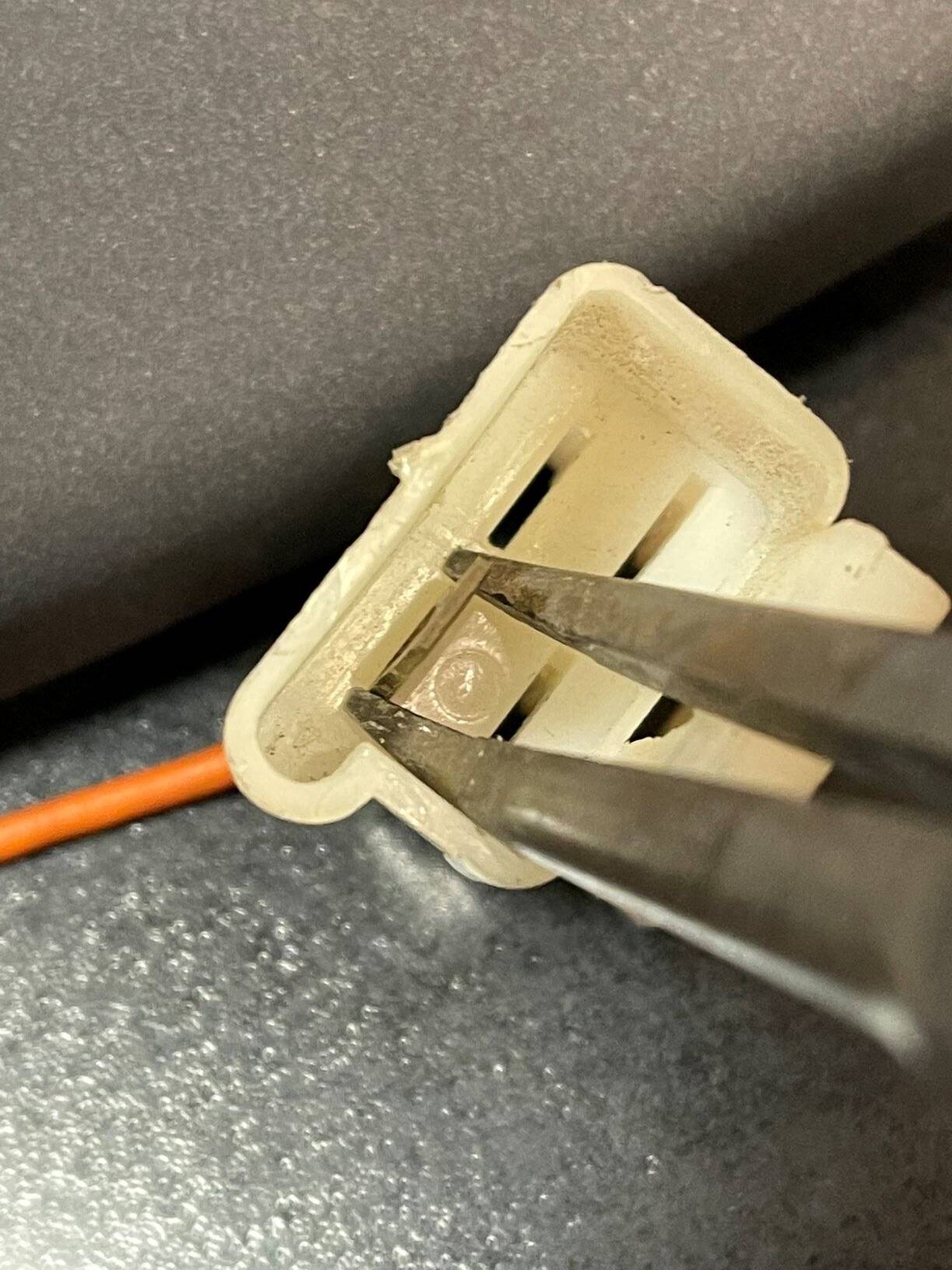

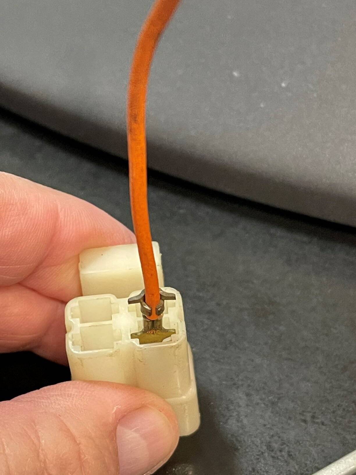

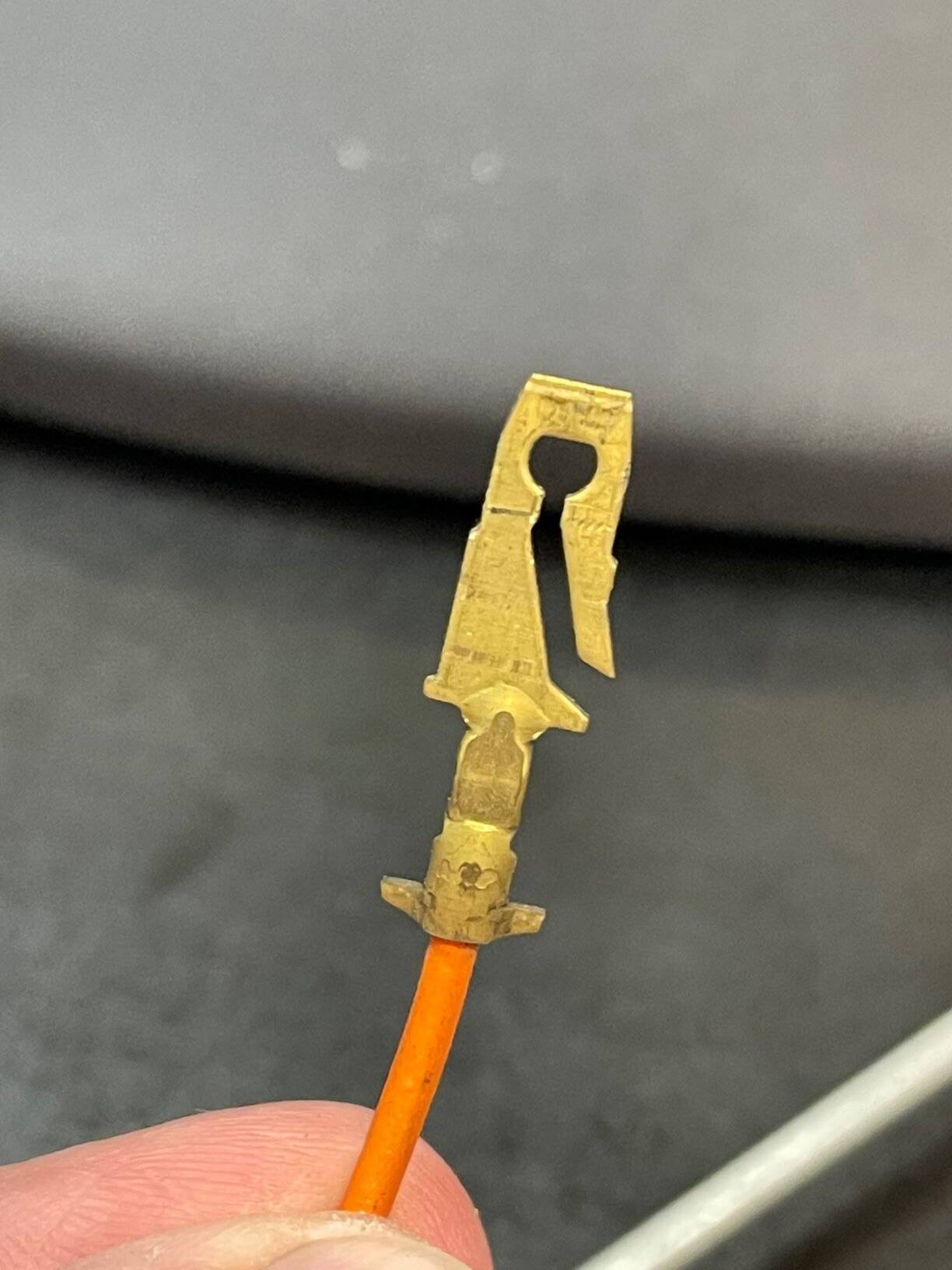

There is, way easy, squeeze the edges of the male Packard terminals a little with some needle nose pliers, pull them out from the back. Use a small screw driver to spread them back to there normal position, insert back into the correct cavity from the back.

Piece of cake to do that with the terminals and everything now works! Thank you so much for your detailed explanation. You are the man. I think I'll reach out to Brewers and let them know about that connector wire change if they don't know already. So glad I joined this forum. Thanks again!!
