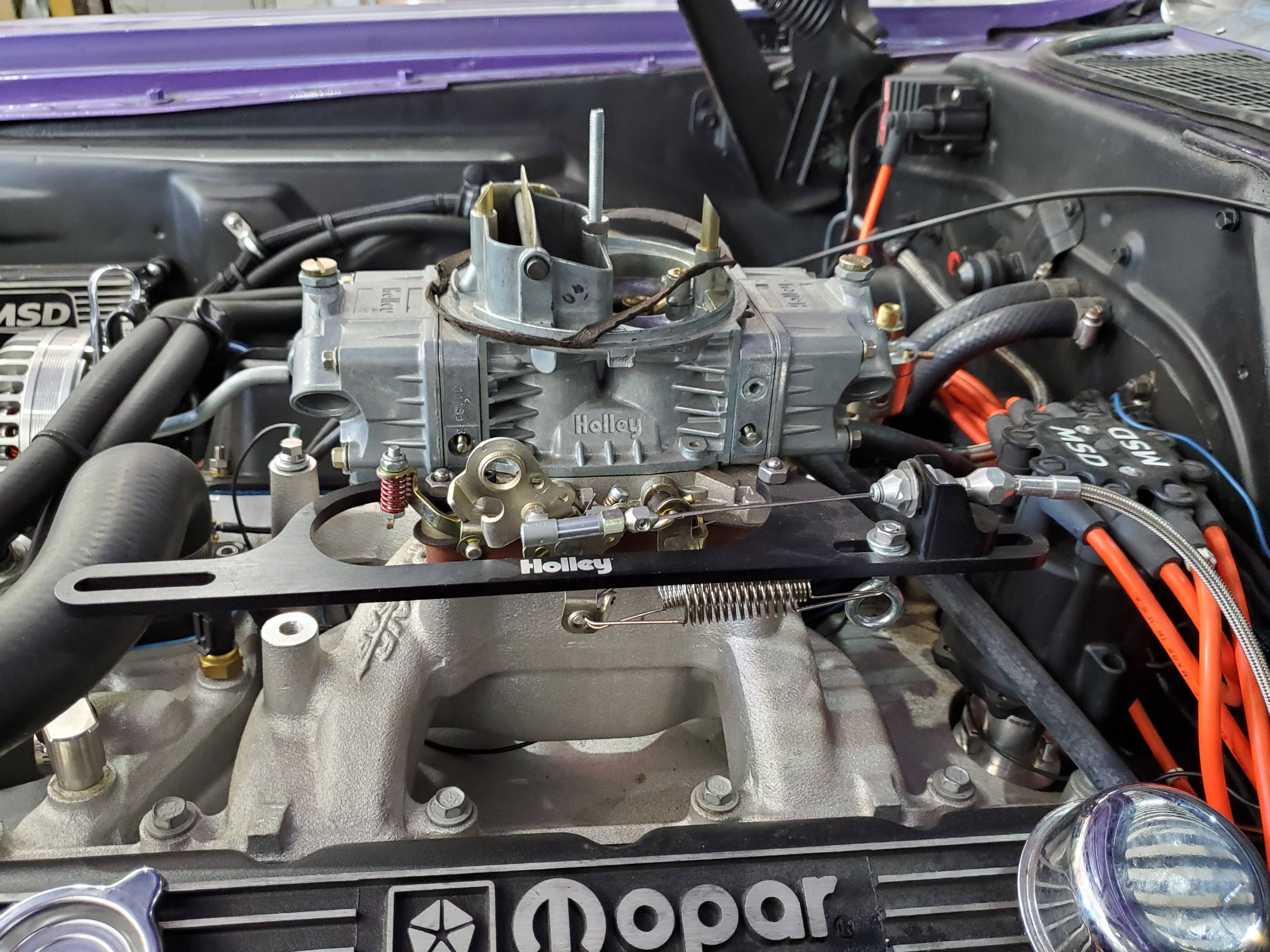

Tom, fyi I run a Magnum with air gap with a 1" spacer under my R/T hood but I use an aggressive drop air cleaner base from a 66 vette to offset it. I DO run Power Tour so I wanted lots of heat reduction. The height of the air gap and the base drop did make throttle cable installation challenging - I ended up with a Lokar cable with a Holley bar mount. Alter
natively Mancini sells a raised throttle cable bracket that would help alignment with the Air Gap's higher carb positioning.

Thanks for the input and photo. It does seem like I may have a challenge with a conventional air cleaner. Will look at drop base alternatives. I plan on running a 750 Street Demon and bought the Lokar bracket for that application. Thanks again, buddy.
