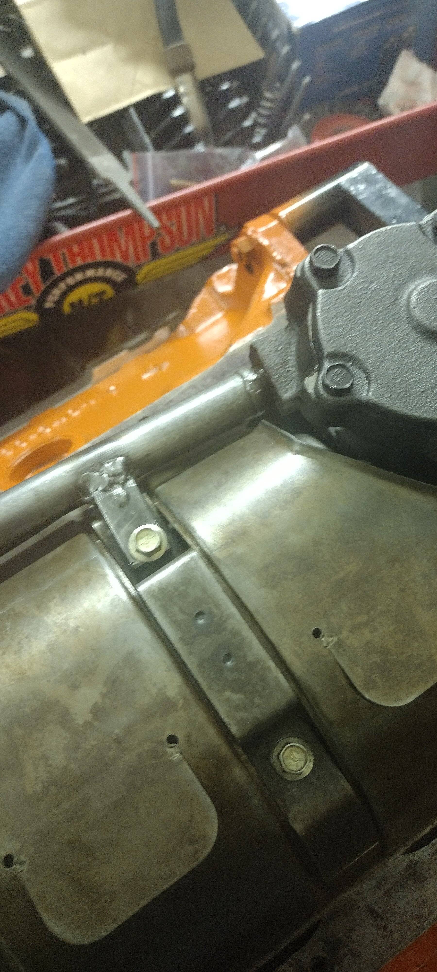

I pulled the kevko pan and pump last night and welded a tab back on the pick up because I had just cut it off previously. Wasn't comfortable with it being off.
