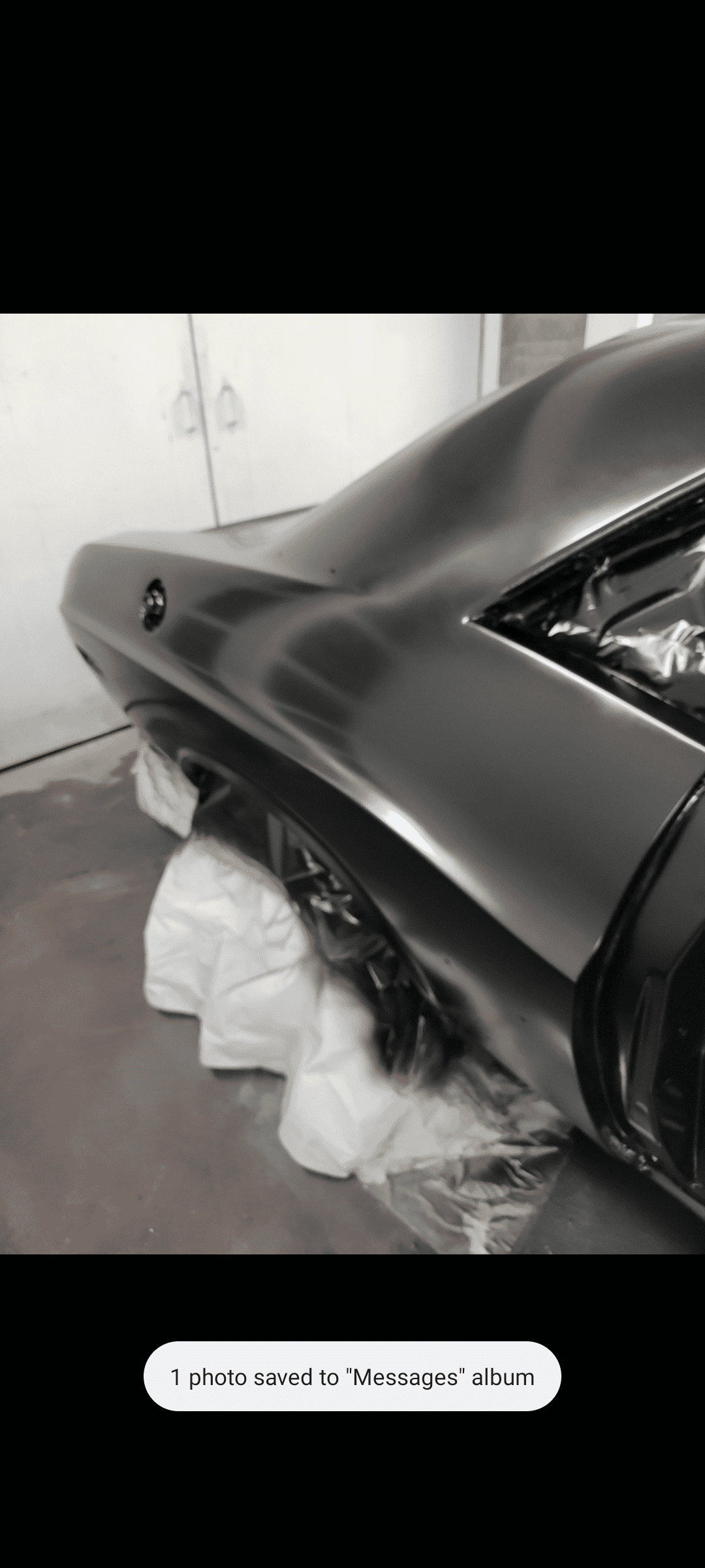

Finally going to paint shop!

It;s looking good cheak it over real close with your glasses and a drop light fill any inperfections before spraying guide coat works better that way hand block whole car and buy good quality paint cheap stuff don;t hold up
i would use a base with a clear coat post more pics thanks

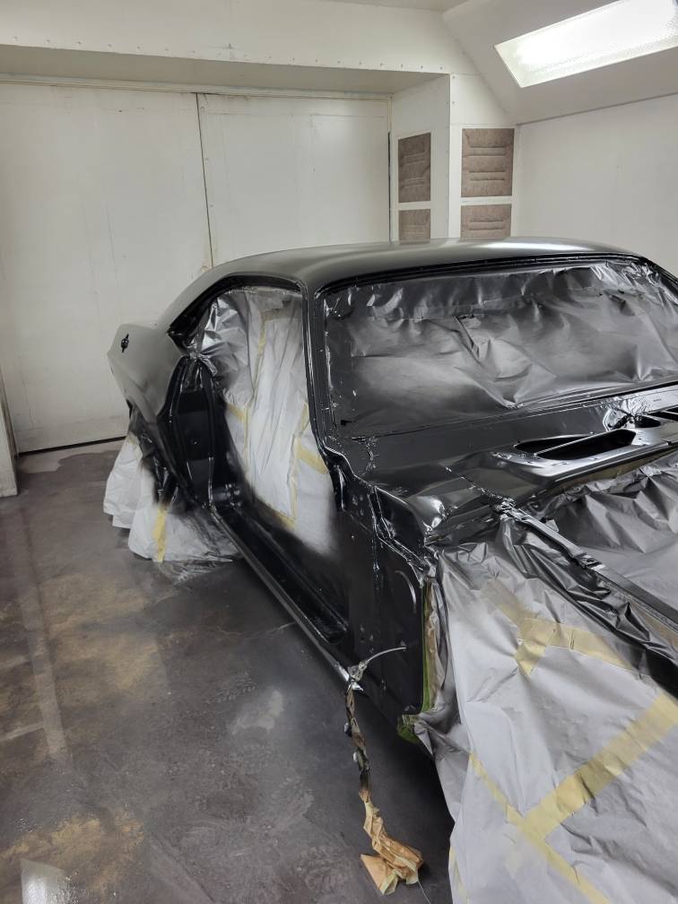

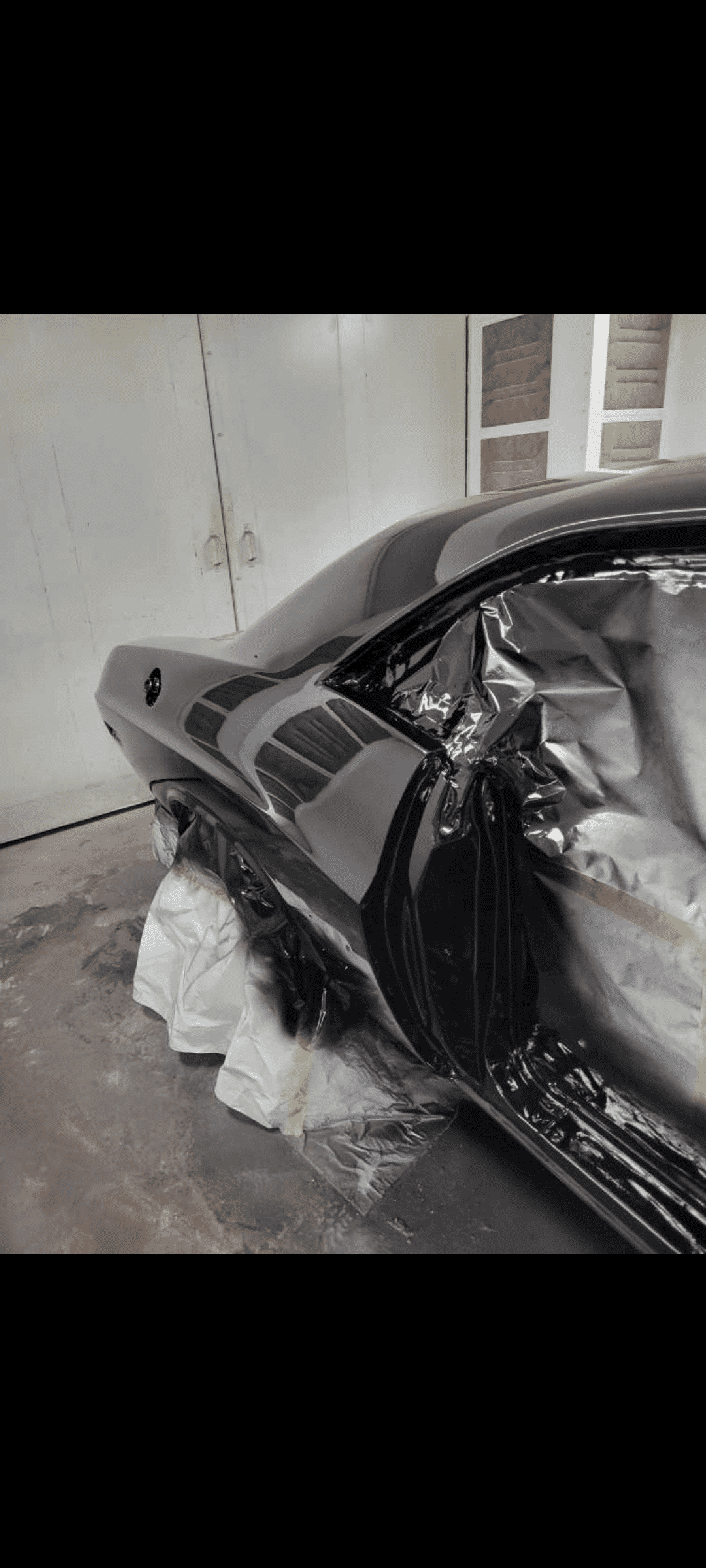

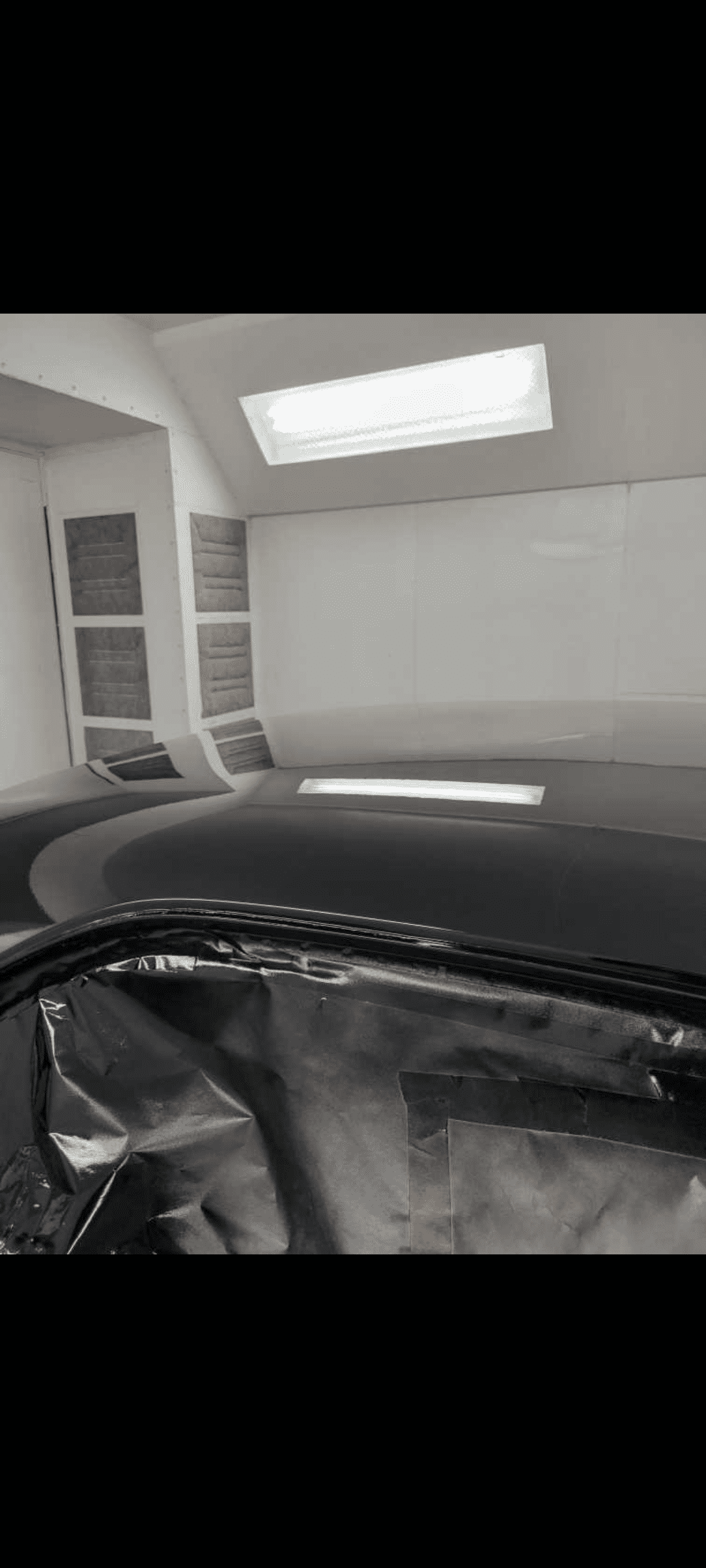

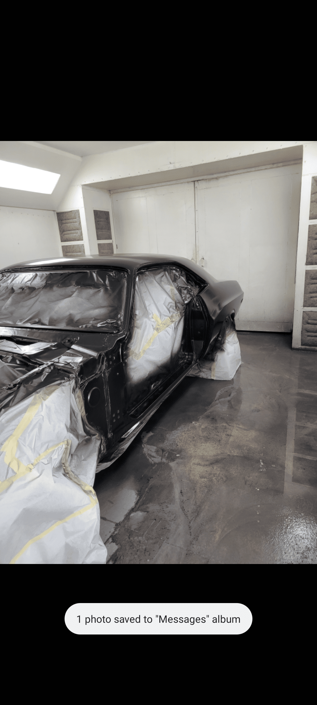

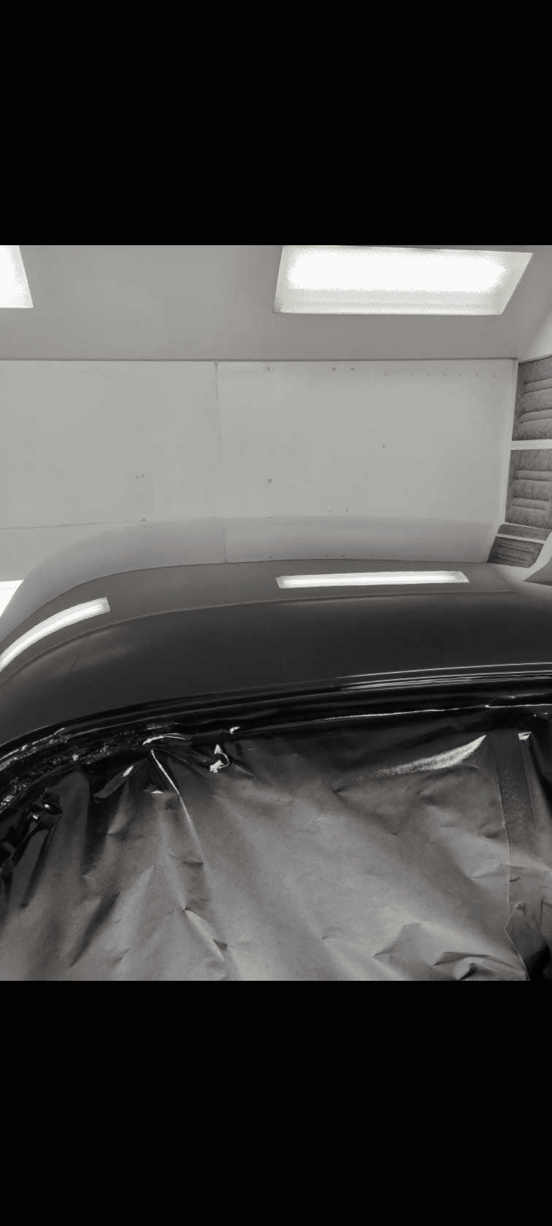

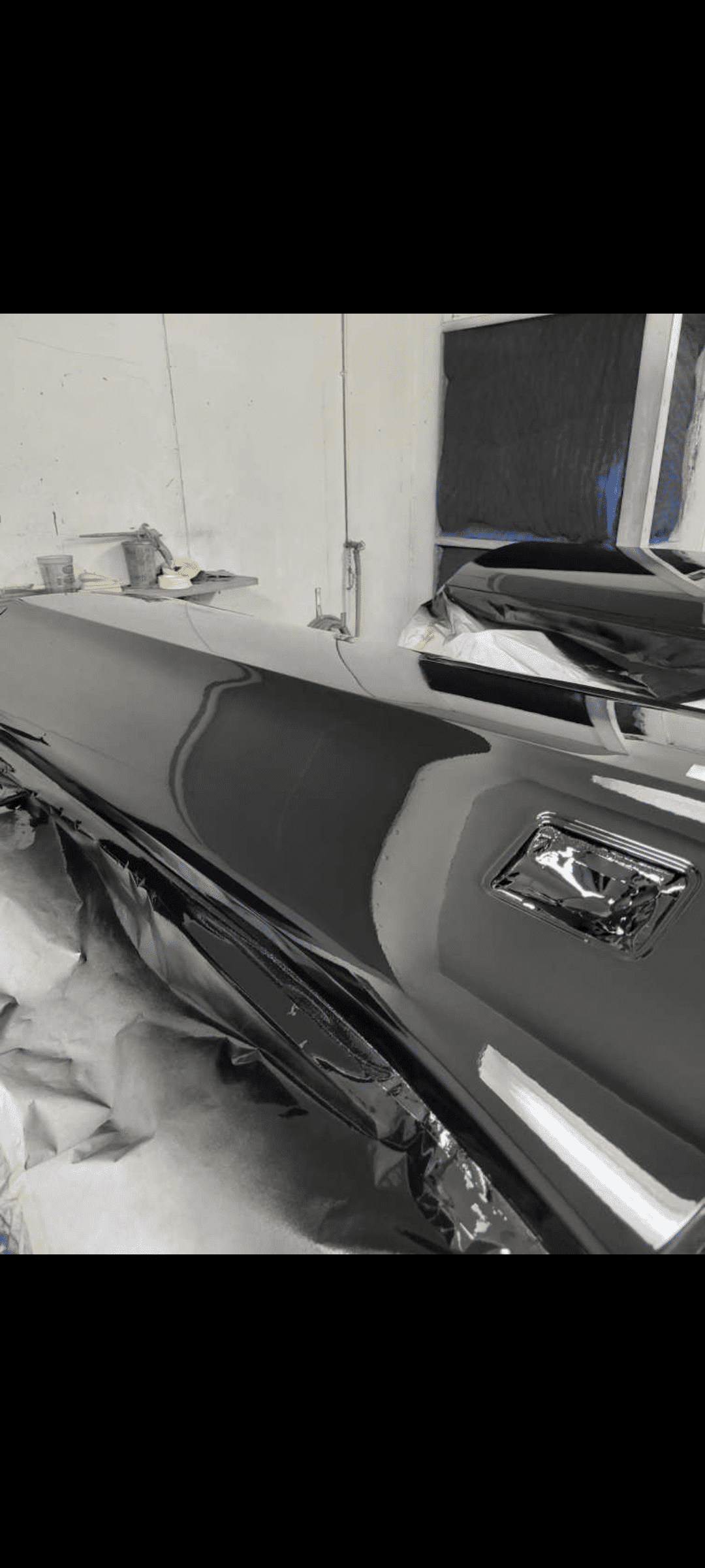

Progressing quite well finally with the paint. Still got the hood and trunk to finish but this thing is glowing. 5 coats was the ticket.

wow looks great you blocked it out very good and it shows.. looks like a binks crossflow booth haven;t seen one of them in a while
