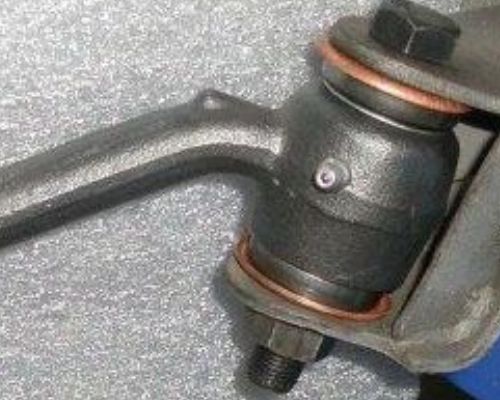

While you are working on the area I would do the steering sector support and the Idler arm up grade. I believe it has to be a Moog idler arm.
