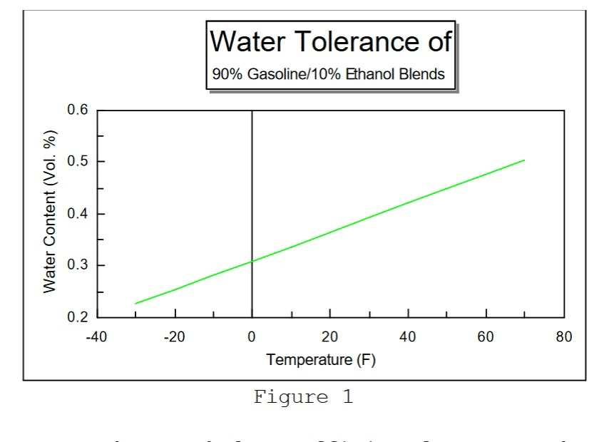

Figure 1
Since ethanol and water readily dissolve in each other, when
ethanol is used as an additive in gasoline, water will actually
dissolve in the blended fuel to a much greater extent than in
conventional gasoline. When the water reaches the maximum amount
that the gasoline blend can dissolve, any additional water will
separate from the gasoline. The amount of water required (in
percent of the total volume) for this phase separation to take
place varies with temperature, as shown in Figure 1. As an
example, at 60 degrees F, water can be absorbed by a blend of 90%
gasoline and 10% ethanol up to a content of 0.5 volume percent
before it will phase separate. This means that approximately 3.8
teaspoons of water can be dissolved per gallon of the fuel before
the water will begin to phase separate.

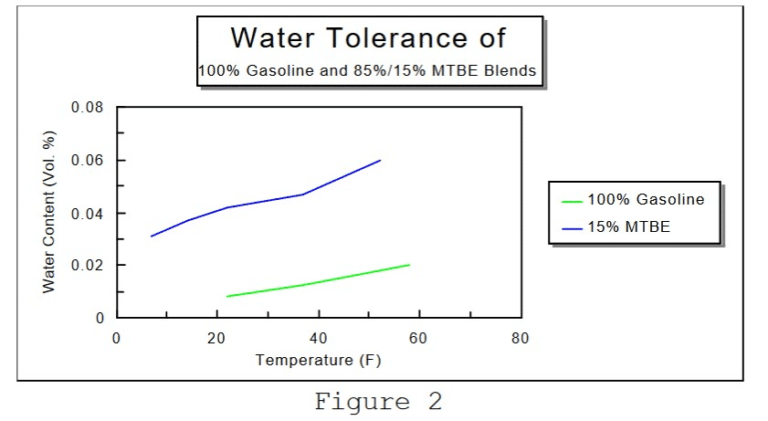

Since MTBE has much less affinity for water than does
ethanol, however, phase separation for MTBE/gasoline blends
occurs with only a small amount of water, as shown in Figure 2.
A blend of 85% gasoline and 15% MTBE can hold only 0.5 teaspoons
at 60 degrees F per gallon before the water will phase separate.
For comparison, one gallon of 100% gasoline can dissolve only
0.15 teaspoons water at the same temperature. These figures are
far below the 3.8 teaspoons which will cause phase separation in
the 90/10 ethanol blend.
