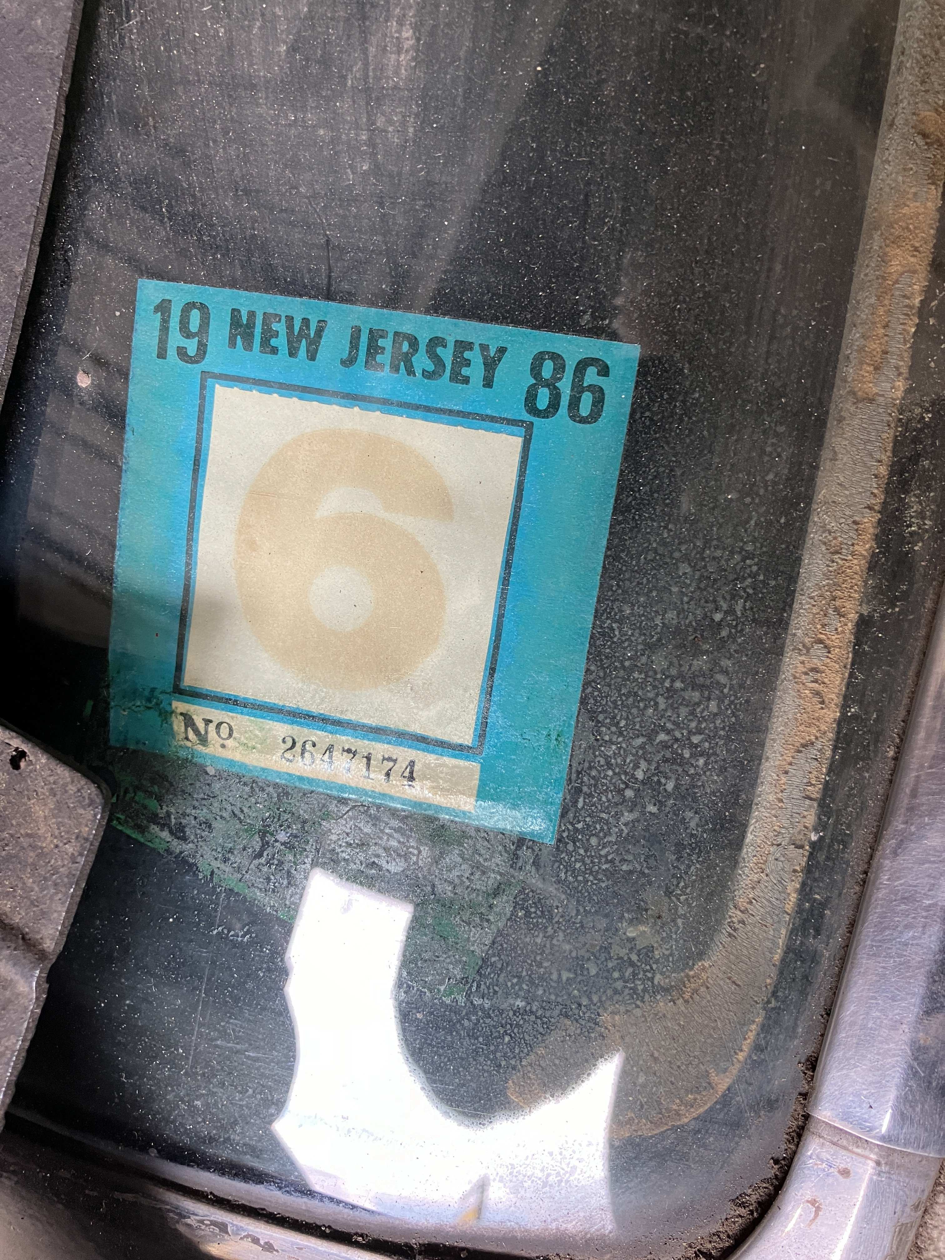

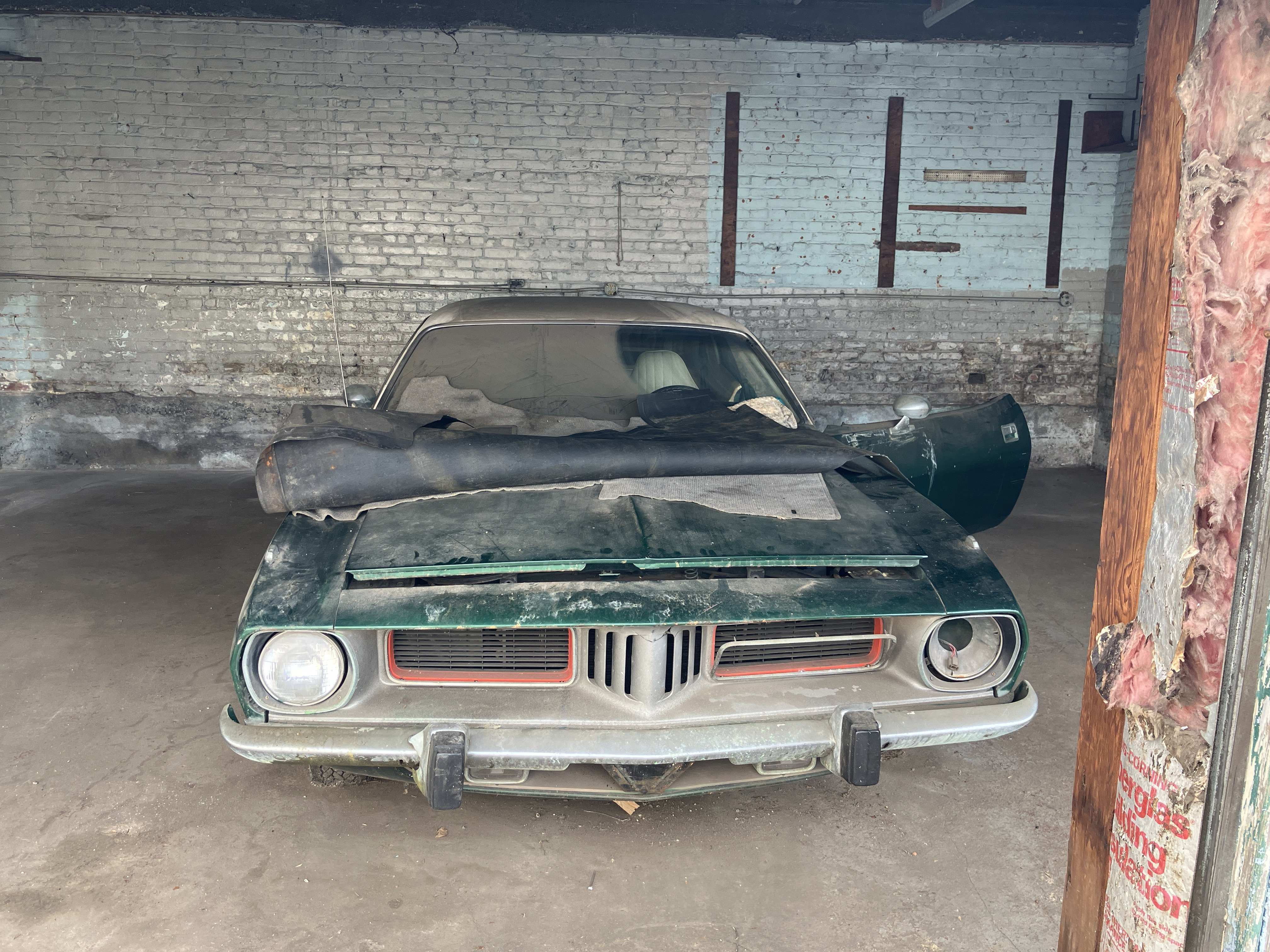

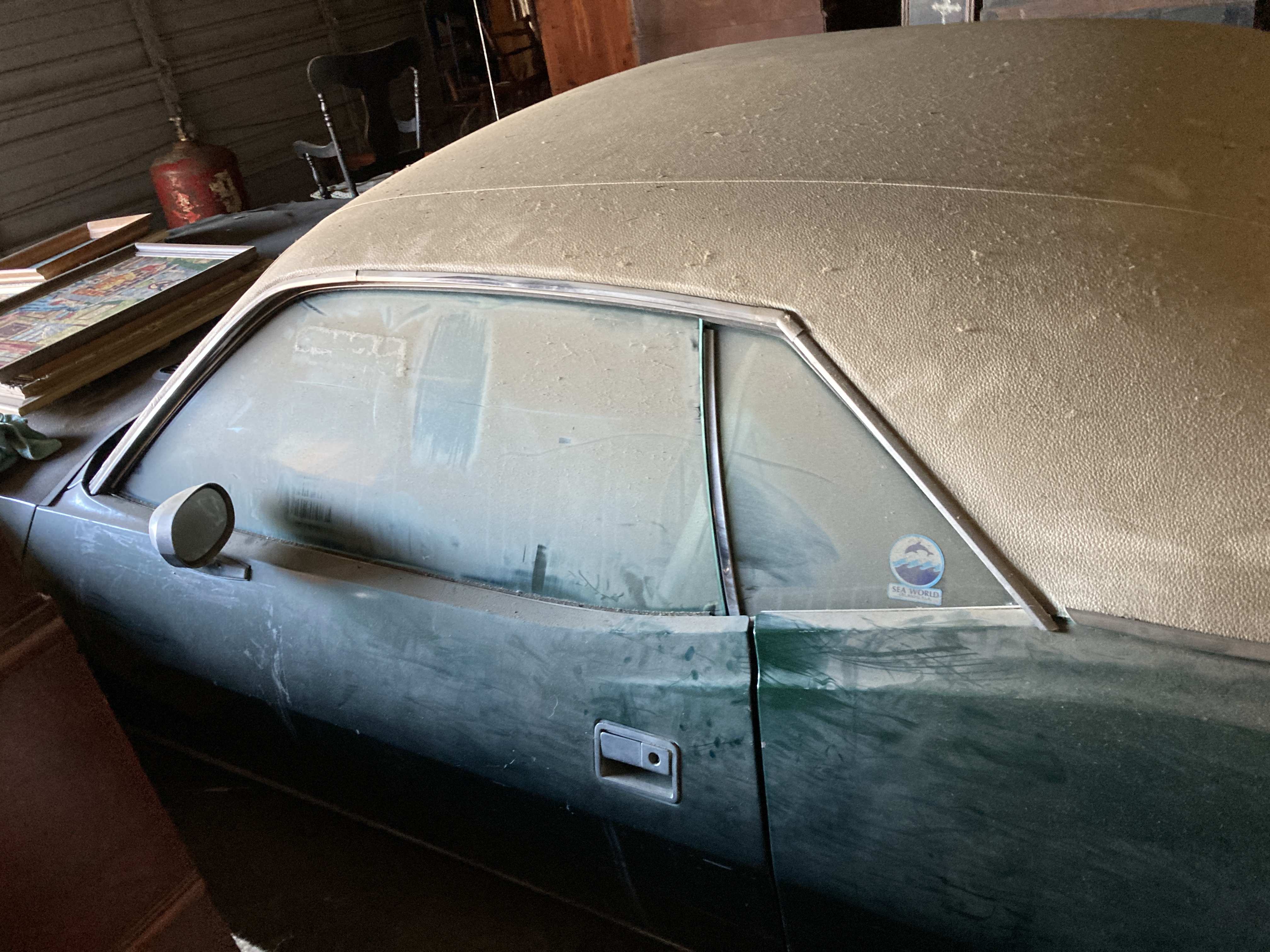

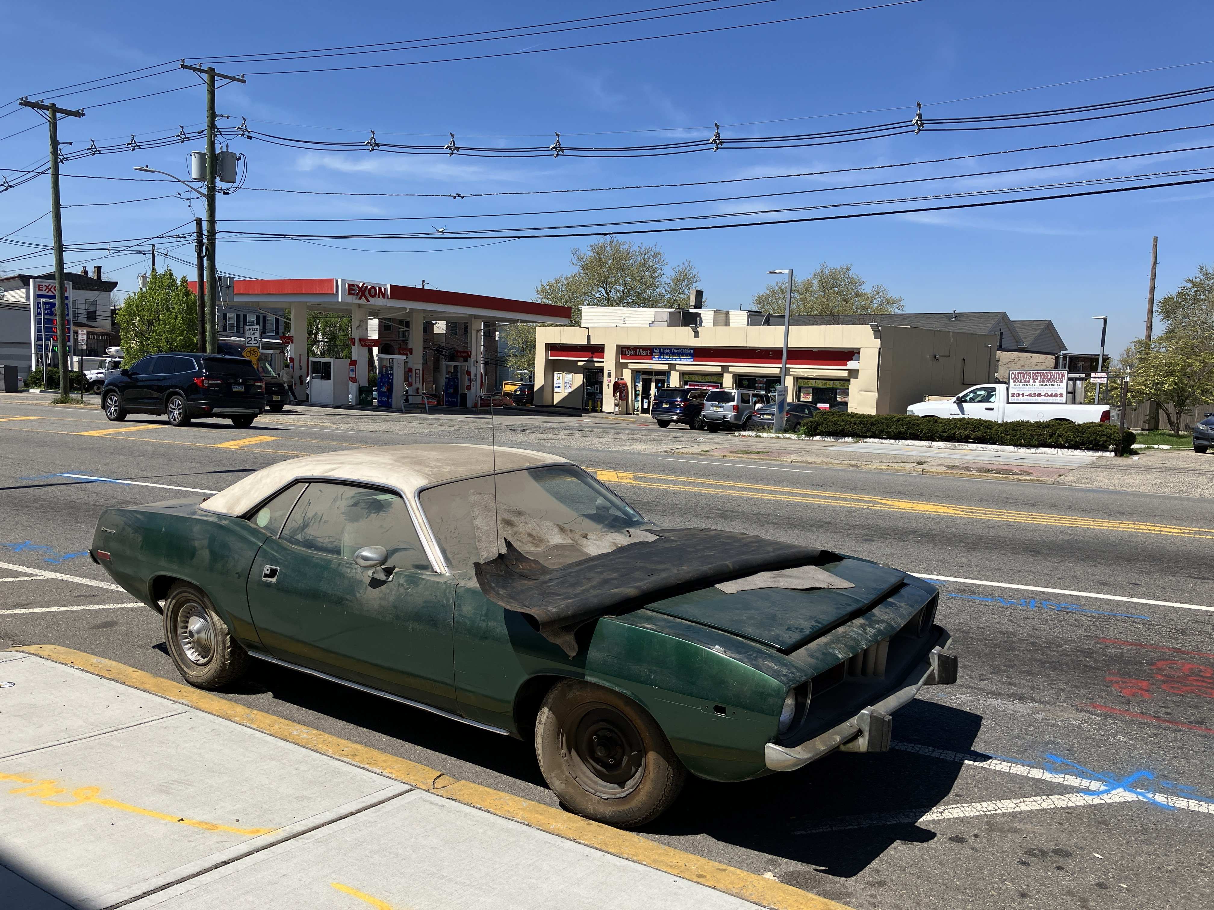

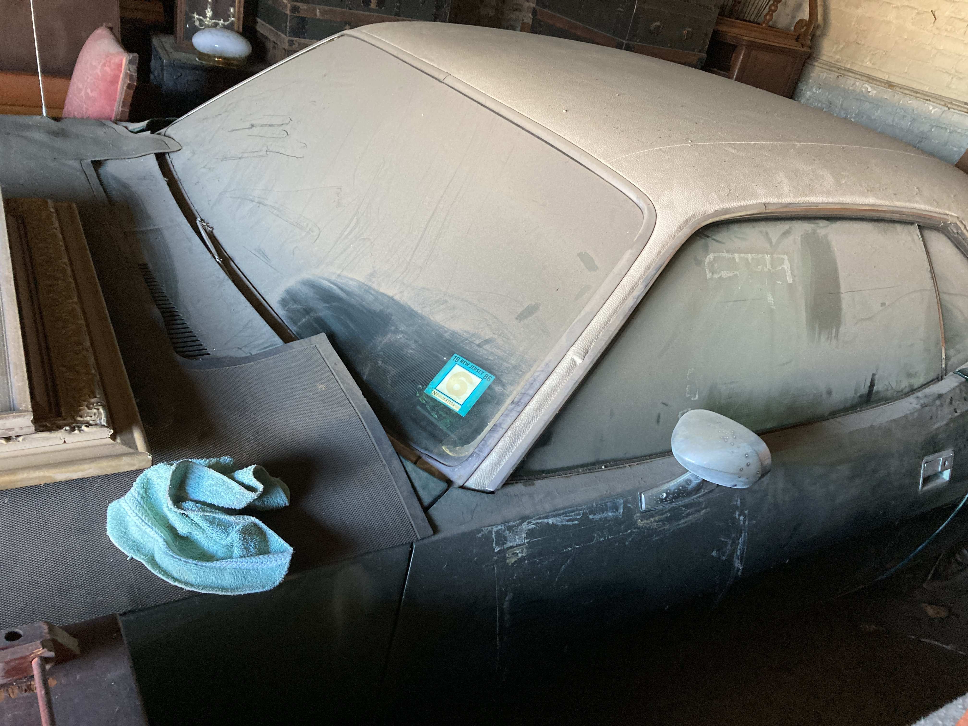

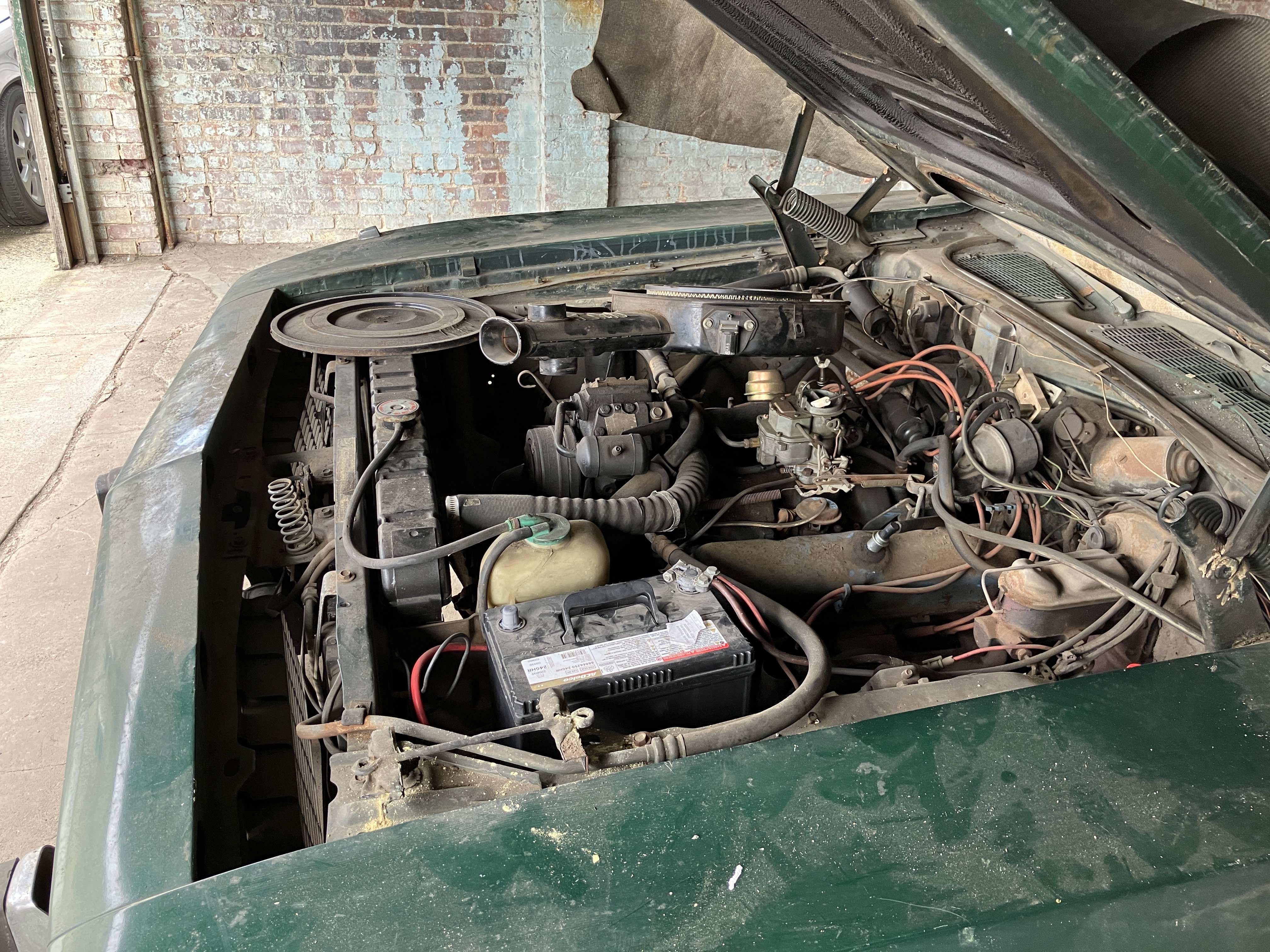

Picking up where I left off from my intro post, I stopped by the shop I bought my Barracuda out of last Friday. I asked the shop owner, and brother of deceased previous owner of my car, if he took any photos during the recovery of my car. He shared the attached photos with me and I wanted to share them here.
Incidentally, the PO was a mechanic at this same shop and I suspect my missing fender tag may be some where at the shop. I was allowed to look through the POs toolboxes which are still there however I didn't find it. Before I left I offered the guys working there a $100 cash reward for it. They assured me that if it's there, they'd find it!

Post some pics after you've just finish the initial cleanup! It's going to look great with green paint and that white vinyl top!
Cuda Hunter
3,215
1,197
high mountains Colorado
Finally!
I was wondering if we were gonna get some dusty pics of this car!
It looks like an emerald coming out of the dark! bling bling!!
That should shine up nice!! Even the vinyl top looks good enough to clean.

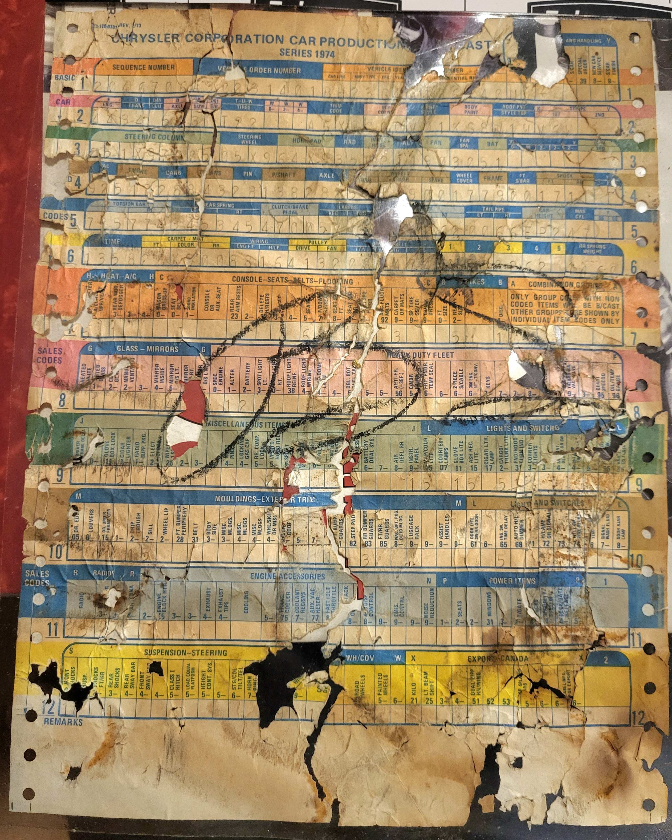

I found the (a) broadcast sheet last night beneath the drivers seat cushion. VIN matches to the car.
I painstakingly pieced it back together on an adhesive sheet. There was no sheet embedded in either cushion of the back seat. Is the decoding book available out there for $30 worth buying?

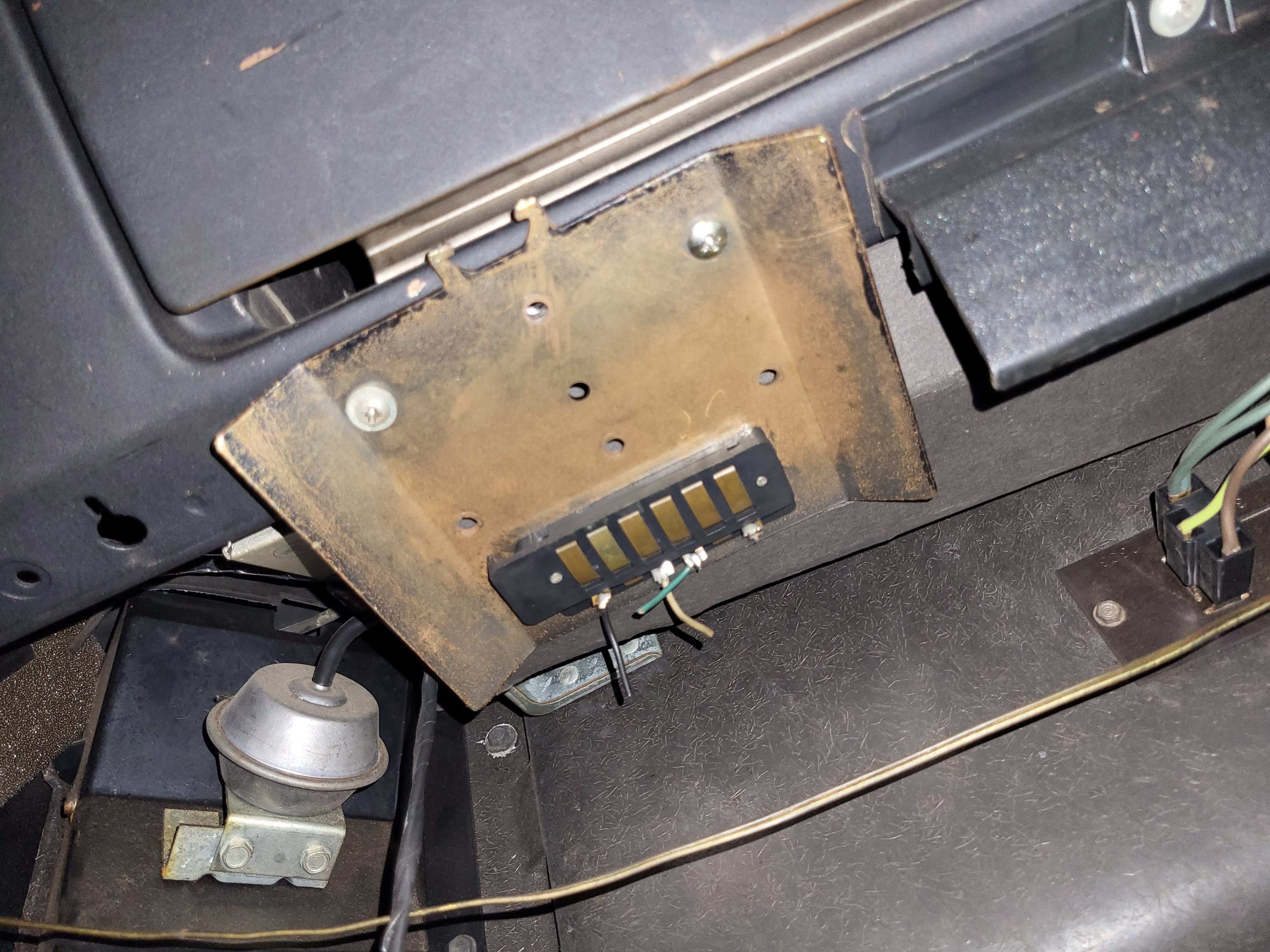

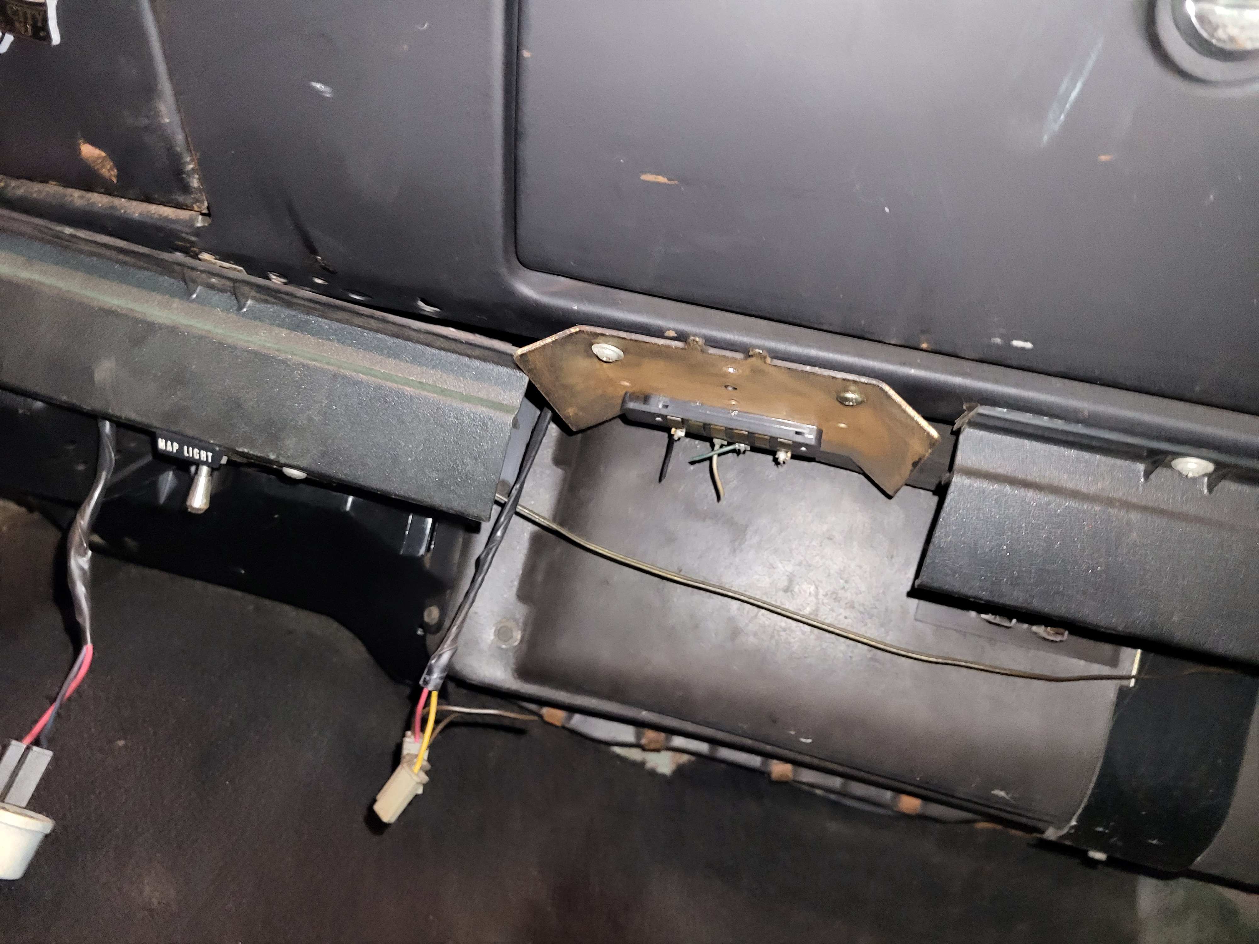

Btw, this mounting bracket was placed beneath the glovebox. Before it gets tossed, I want to confirm it's not part of some long lost factory underdash accessory. If anyone has a damaged lower dash strip available so I may repair mine with a good section from yours, please please shoot me a message. I'm just looking to graft the missing piece back in to mine, not replace the entire strip. I see complete replacement lower dash panel prices are through the roof. Thanks!

That underdash bracket looks like from one of those quickly removable aftermarket radio/tapedecks from the 80's. People thought it would eliminate someone breaking in the car and stealing the radio.

Yup, those were sold back in the day to mount an underdash stereo and be able to quickly remove it from the car when not in use. There is another bracket that bolts to the top of the stereo to interface with that bracket. I had one at one time and it worked quite well.

I found the decoding book was not that great. The most useful and free was a Charger site decoding section.
You can use the internet to find out most of the codes. Just search around.
Your car has the map light so it may have had the A01 Light Group.

That is awesome! Not that common to find either.
Looks like it had a white vinyl top with a v6w white horizontal stripe.
I think it calls out road wheels as well.
Lots of other information about the car on this sheet.
You can have a new fender tag made correctly with this sheet.
SPD or A30 and VON of 231401
That is super cool to find that sheet and have the ability to reproduce a "correct" fender tag. Congratulations!!

The bracket is for a Pioneer system I think. The KP500 and KP700 units from them had this so it could be easily removed. They were a high ticket item and theft was pretty common on them.

Just to mention it, if you found one sheet in the front seat there is still a good chance for another in the rear seat or elsewhere in the car.
Make high resolution copies of the sheet and put a new sheet back into each seat in the car. Under the carpet and taped to the back of the glove box. The next owner in 50 years will thank you.

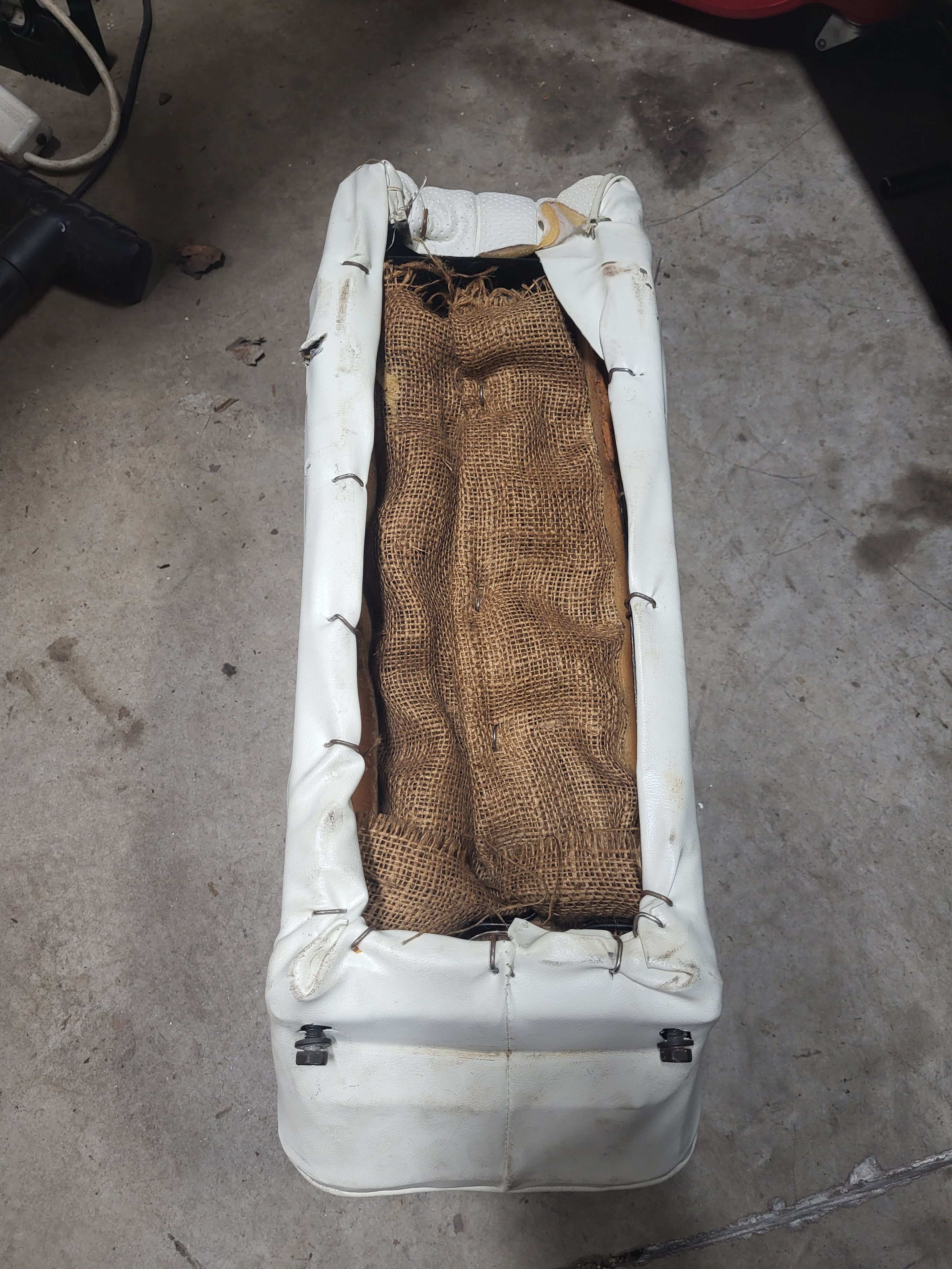

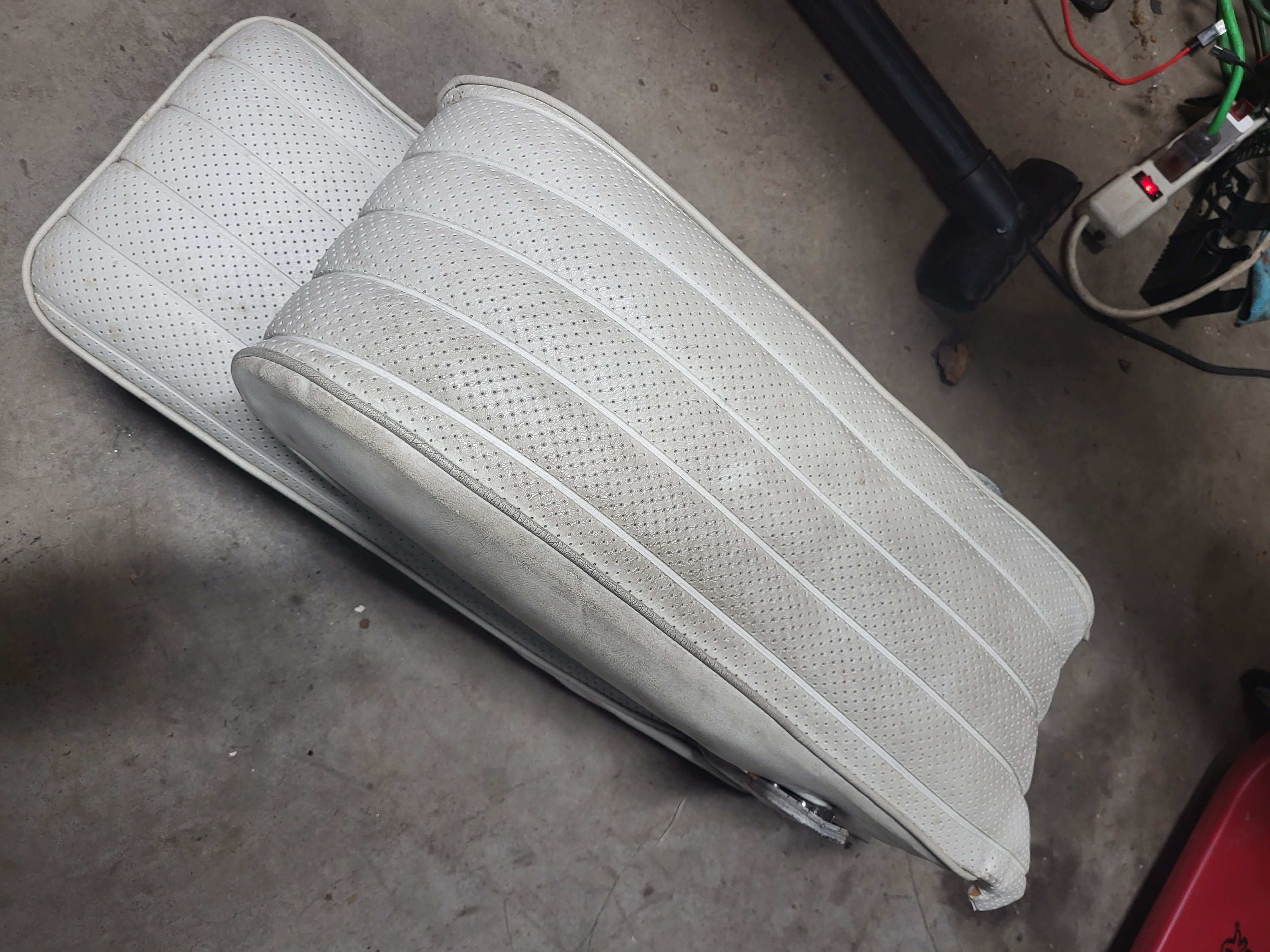

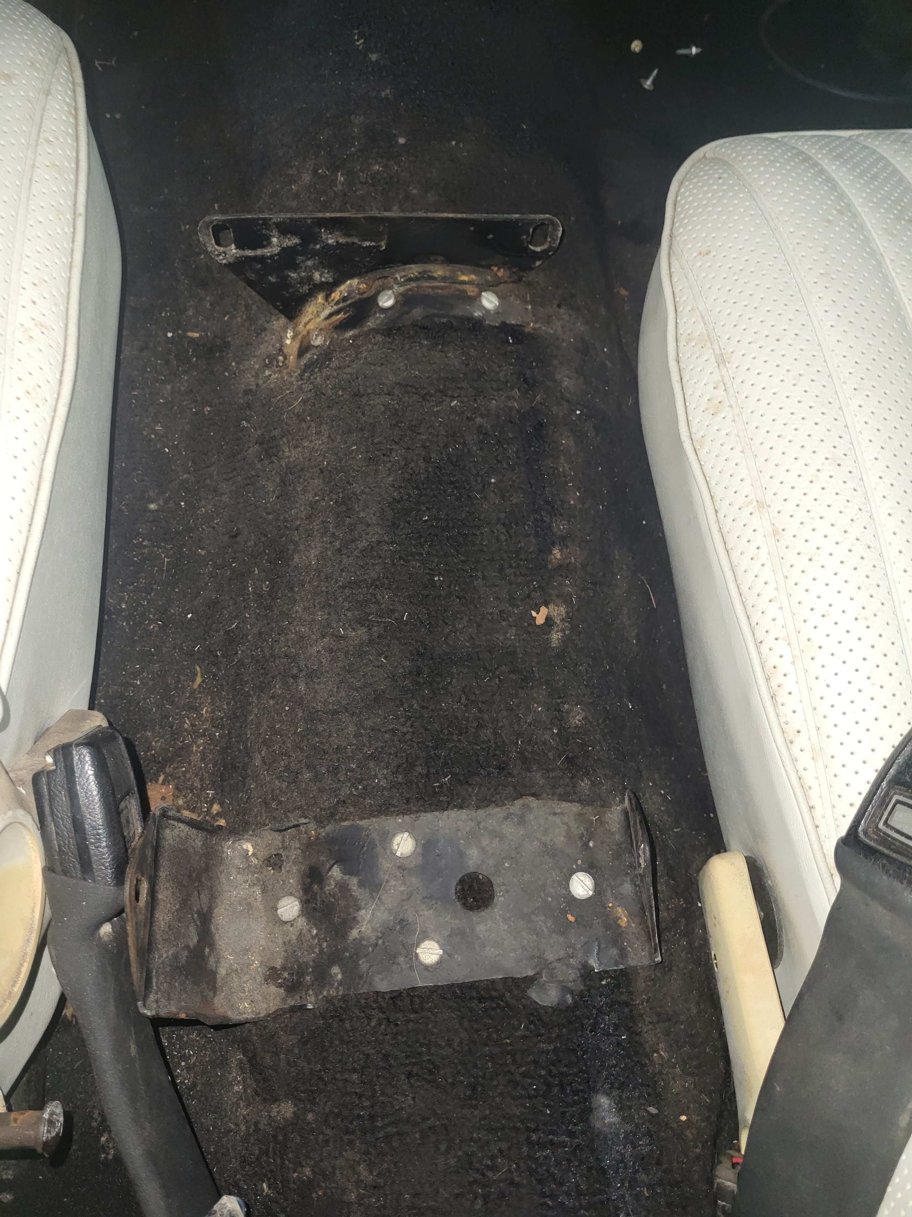

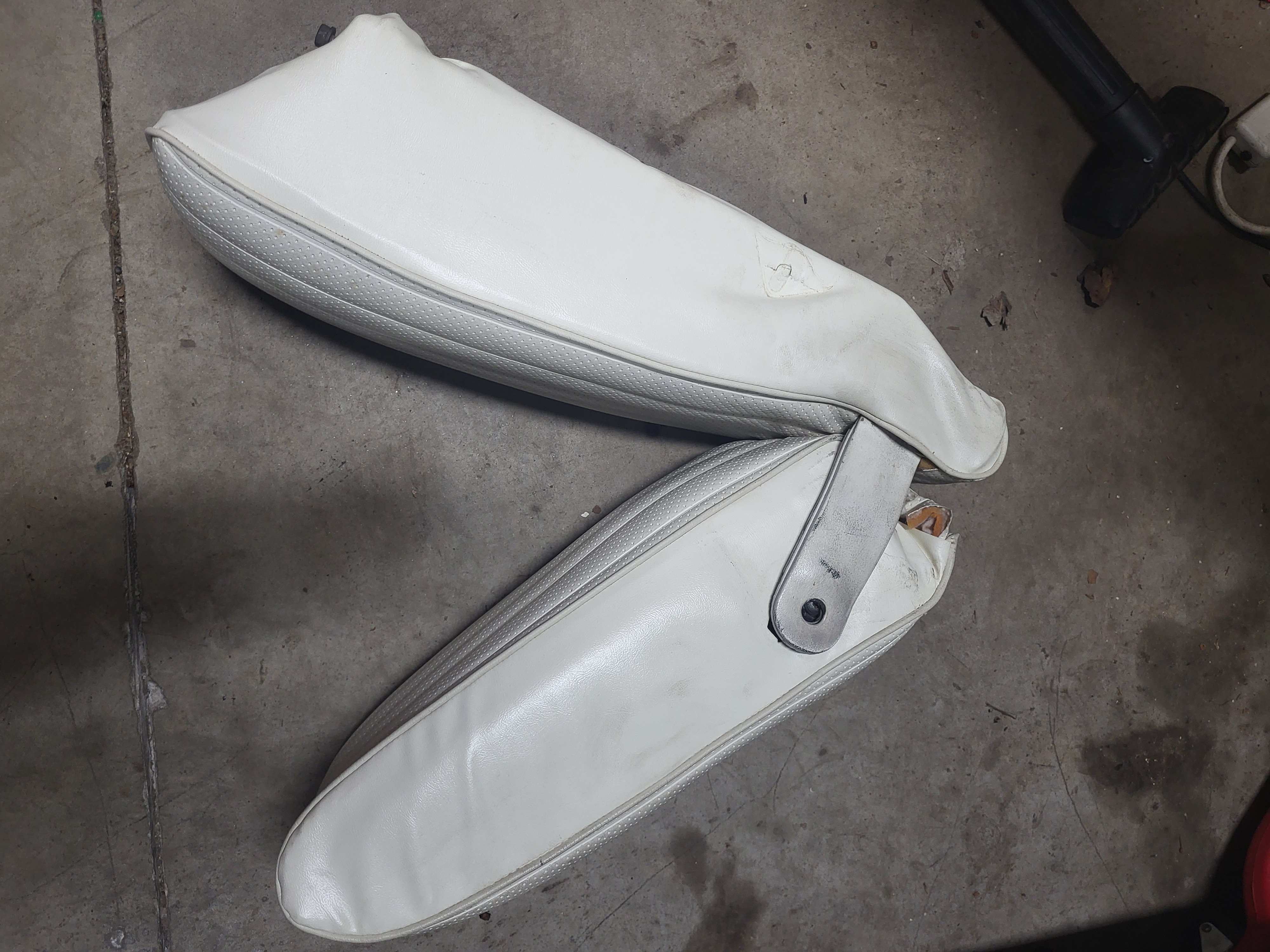

I pulled this folding armrest out from between the seats tonight and found the underlying upholstery doesn't match the interior. I'm hoping this means it isn't original to the car, frankly its ugly and it just doesn't look right in there. Any ideas? It hooks into the rear bracket and secures in the front bracket with two 5/16" bolts. It looks factory but which factory is the question...
If it's not oem, it's up for grabs cheap!
