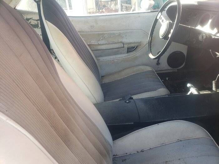

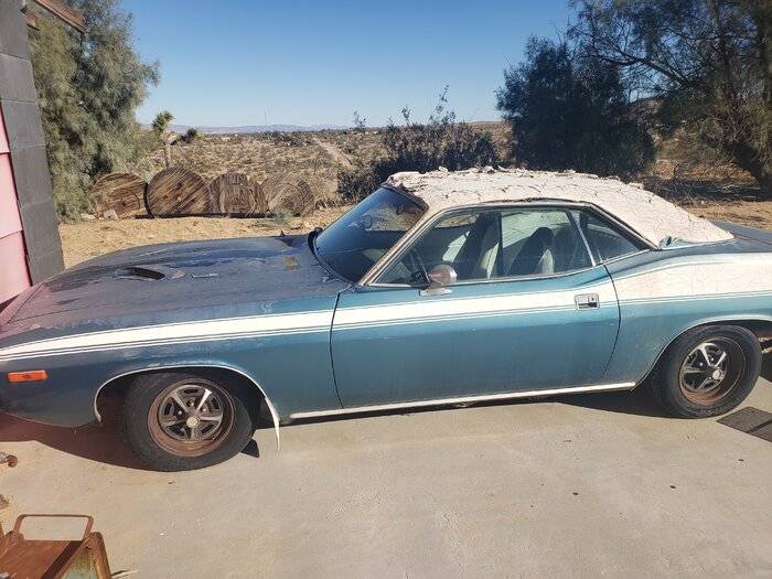

looks to have a few extras aircon,rally dash,power brakes,etc

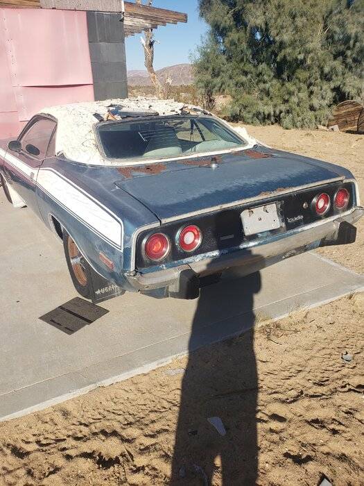

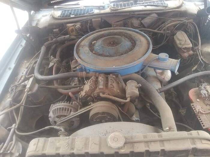

check along the firewall & cowl for rust particularly behind the brake booster & inner fender frame rail around the battery ,good colour combo will look good restored also has the stainless trim package
what's the curly cord on the dash cb radio or factory Mike record

Ok ill look there as soon as i can get back to the car. It has a CB in it and an old Kenwood cassette player that i never knew existed haha.

That's a good deal for a good complete car. The worst part will be replacing the roof skin. But, hey its all there and if frame and torsion supports are solid then buy it.
