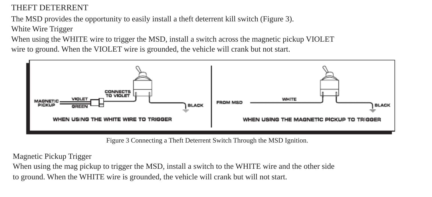

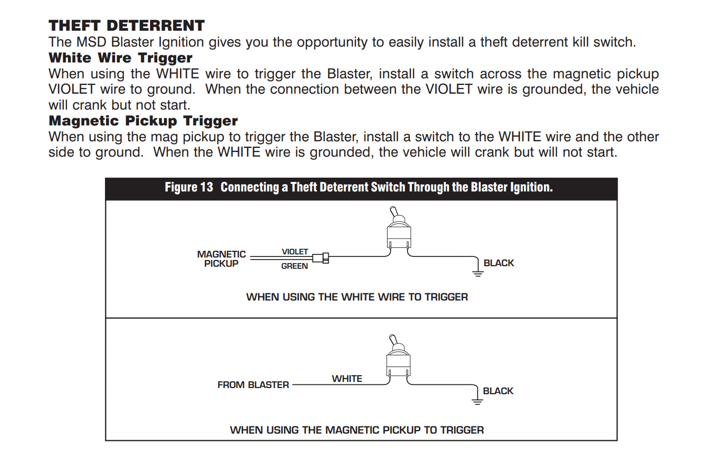

This approach will not work with MSD ignition because it connects to and fires the coil differently. However, MSD describes a method to wire a theft deterrent switch with their ignition.
I don't use MSD, and I don't know if it applies to all MSD ignition systems, but from two of their product manuals are the following images. It is similar for both.
MSD Blaster Igniton, part number 5901:
MSD 6201 Digital 6A and 6245 Digital 6AL:
