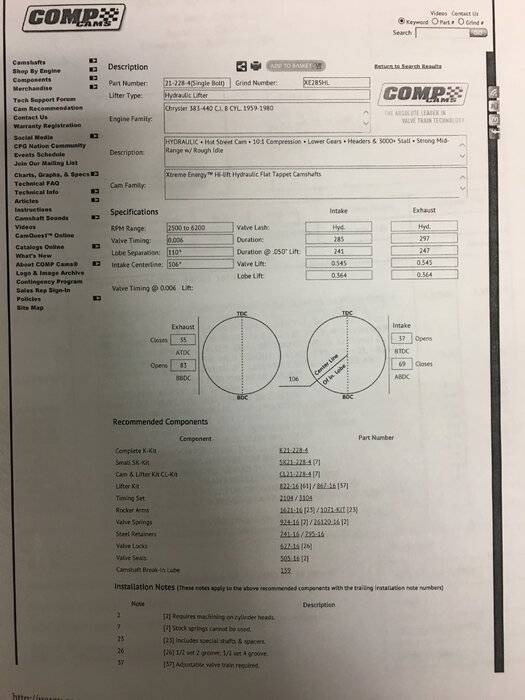

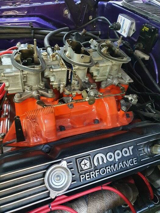

Have you or can you post a pic of the motor? If you already have, I didn’t see it. And what’s the cam card read
252 / 258 vid .050 .576.576 lyft 110 lobe.

Stretched to 512, balanced, 9.5 in compression Pertronix Digital HP ignition box

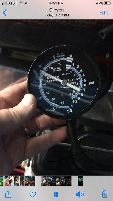

Looks great. Can’t imagine the low vacuum number with the cam designs for the last 10 years. I’m running a 500 stroker, six pack. The carbs out of the box are dang good. Center carb came with 62’s and 65 PV. I’m getting 12-13” vac with a comp cam ( I know they are not real popular) but, for my cruising and occasional WOT works great. You sure there’s not a vac leak? And you’re probably at 34-36 total timing. I have promax baseplate on the rear carb just for easy adj if needed. I’ll share my cam info if you’re interested. Good luck to you

Have now removed "Promax" and mounted your original. has 66 in nozzle and power valve 2.5 has AFR value of 12.8-13.2 at 1000 rpm. The ignition is 17 degrees, full range 36 degrees

Got better now I have 8 psi in vavuum, so I have some leaks on the Promaxen
