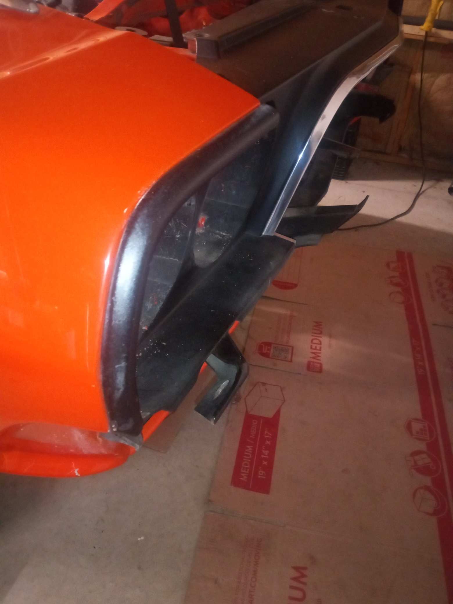

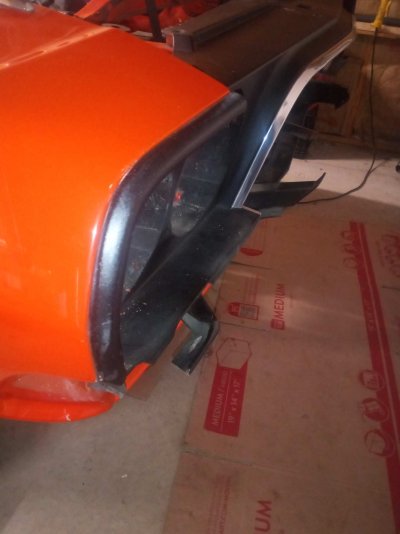

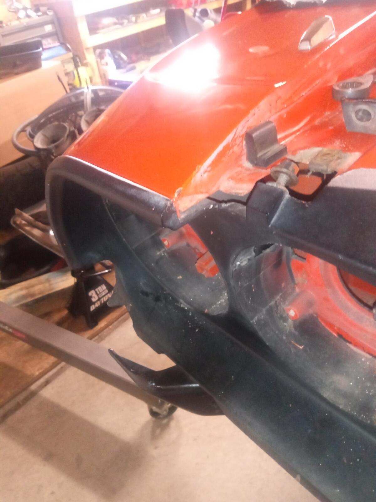

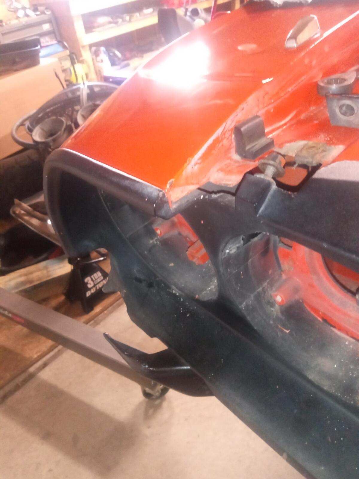

Hello, Has anyone out there removed there front header panel /grill assembly? This would be for a 72 Challenger.
I`m trying to remove my header panel for paint....pretty sure I have every screw /bolt out but it`s still on tight. Have the center grill out.
Header panel is tight where it meets front of fenders. Looks like there`s studs on panel that go into holes on fender from pics that I could find.
Not sure if there`s nuts on end of studs or just pressed into clips. Thinking pressed in cause you can`t get behind there to remove nuts. Don`t wanna pull too hard and break something. Any help would be appreciated. Thanks

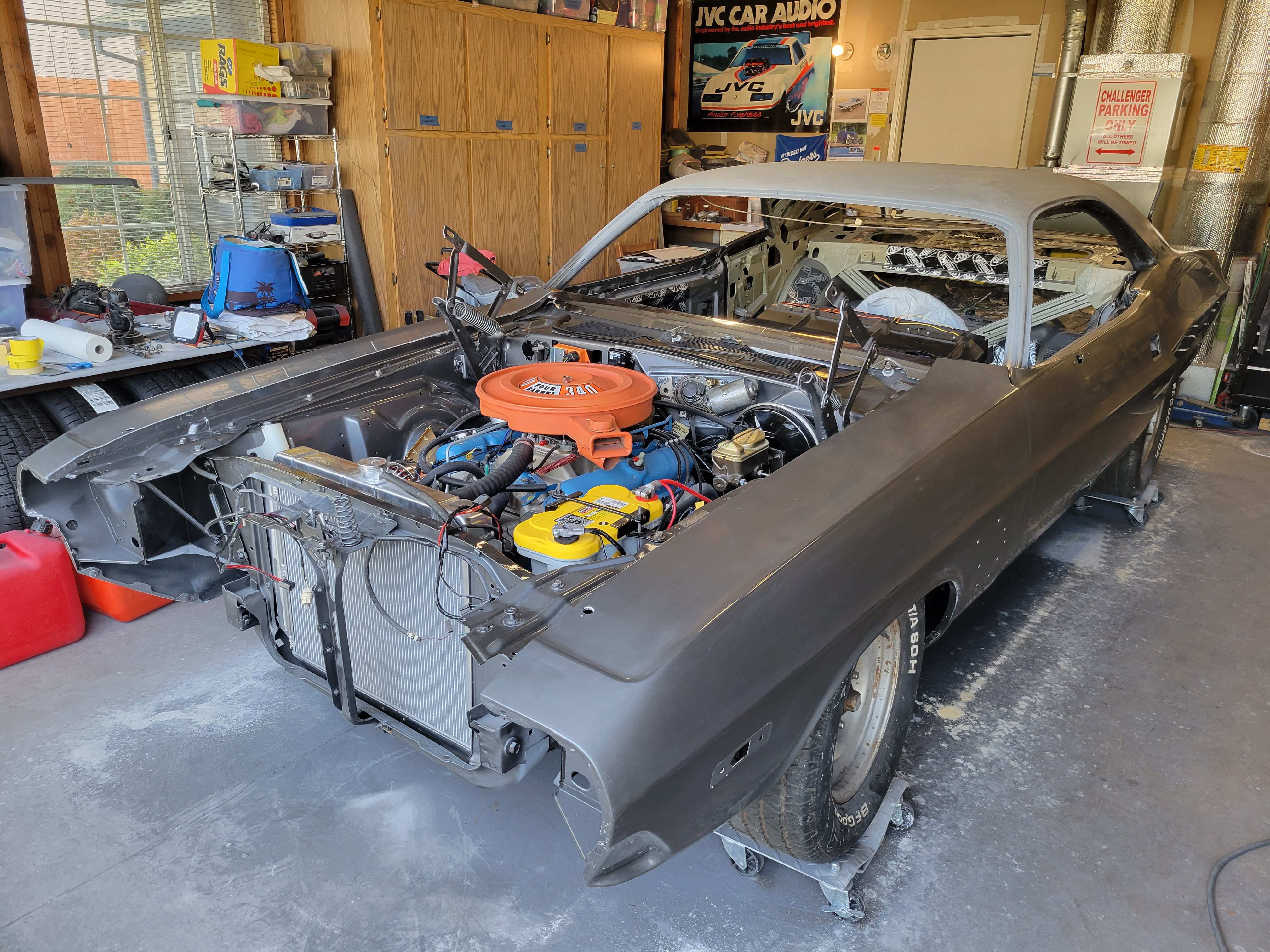

Juan Veldez
Jan 1, 2011
796
362
Nampa, Idaho

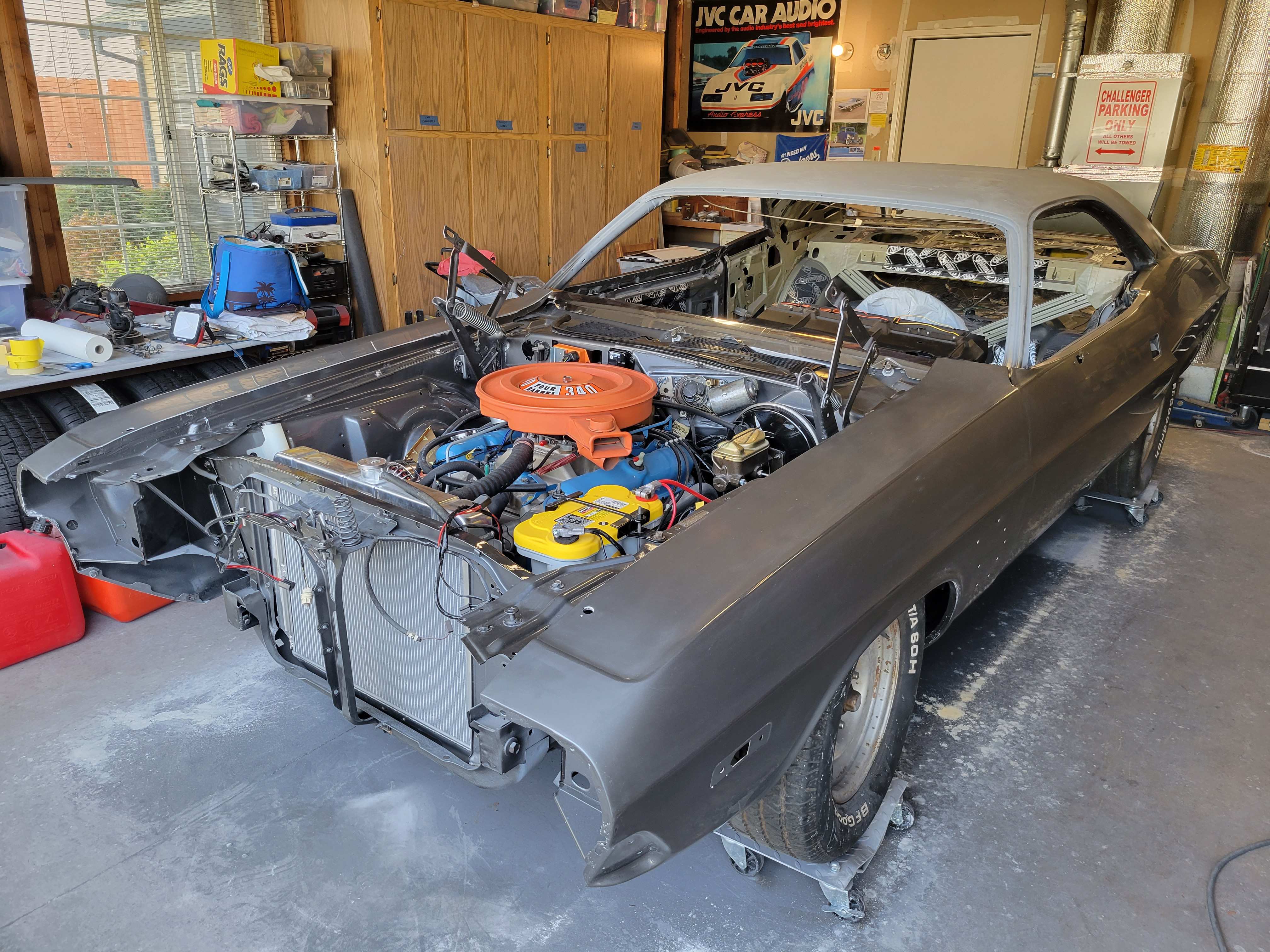

See photo. You can see the threaded rod w/ a fixed nut on it at the passenger fender pointing forward. It's on the driver side too, just can;t see it at this angle. It would be right behind the lights.

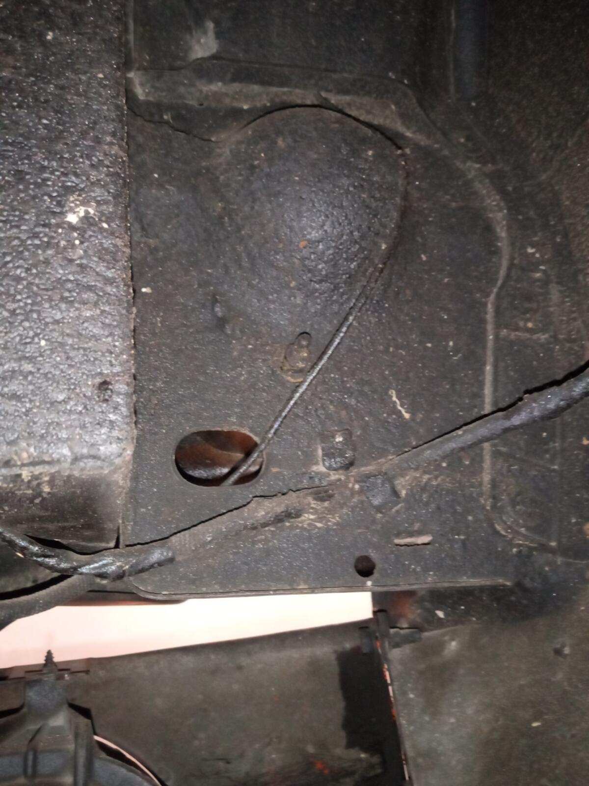

OrangeCrush72
Feb 25, 2024
10
Michigan

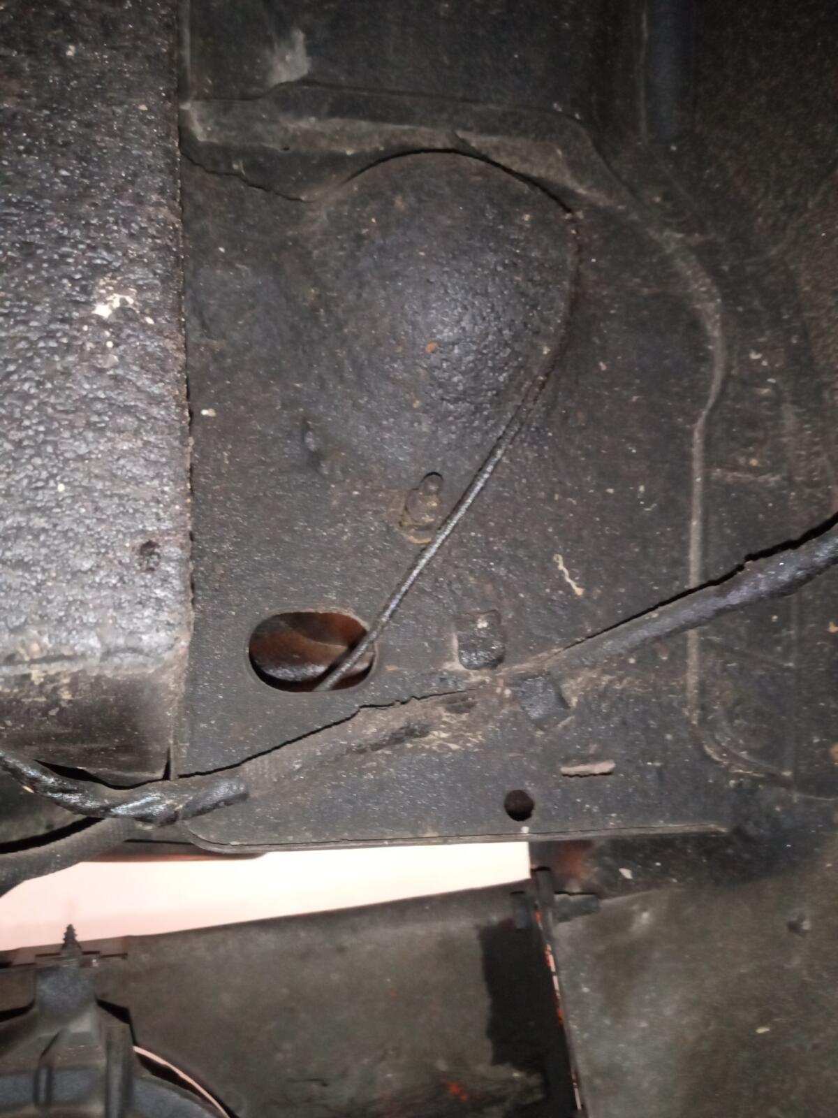

Yes, Got looking again think I found it. Pic inside wheel well you can see stud with nut on it. Looks like I missed that one. Thanks again.....Header panel 3.jpg
