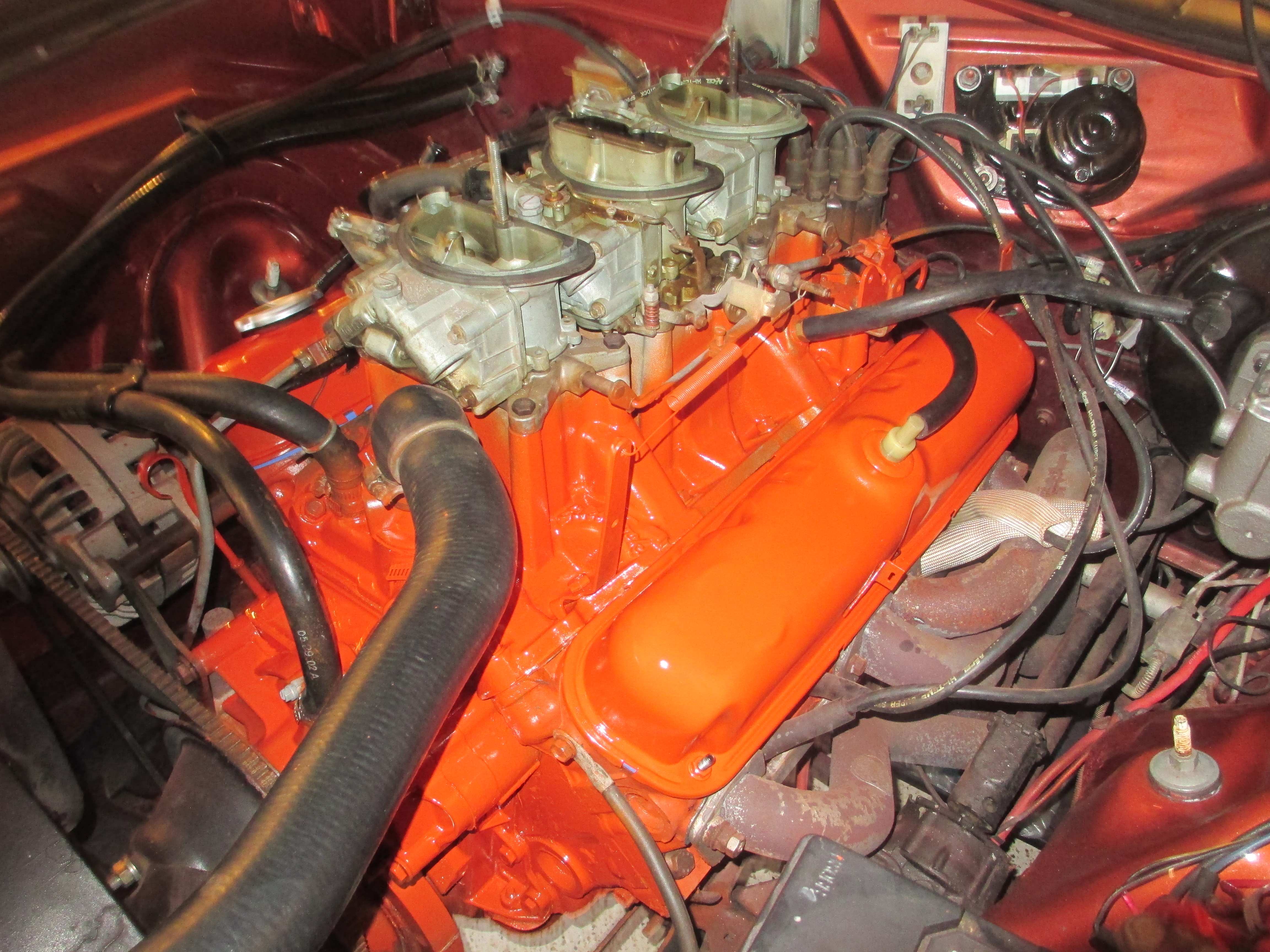

This it what im dealing with

Disconnect both engine mounts. Jack up/hoist up the engine as high as you can go (removing the distributor cap will allow some extra room). Headers should come out. Passenger side usually from the top, drivers side which ever is easiest. If you have a lift, it makes it easier to remove the headers from the bottom. Nice thing about the small blocks is there's more room than the big blocks! Best of luck.

I have a drive on lift so you think I can get both sides out the bottom if I take the starter out and oil filter
