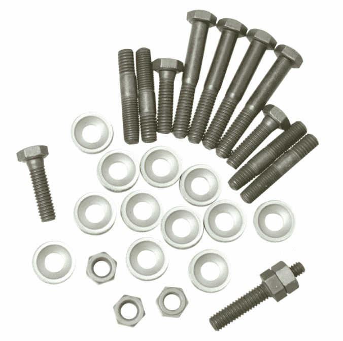

Classicindustries.com 70-74 318-360 71-73 340 Exhaust manifold hardware kit . Bight the bullet at $55. Or 4 or how many you want. Year one at $4.99 + sh. https://www.yearone.com/Product/challenger-cuda/fd1728
Exhaust manifold stud-Each stud comes with a nut (originals were brass and used a washer). Includes both 5/16"-18 and 5/16"-24 stud ends. 5/16 X 1.69 GR5 STUD .50 UNC. or go to an auto parts store.
Yeah I saw those, they'll eventually rust though the same as the black oxide ones. I'm a bit of a clean/neat freak with dress up. I already have some cheapo header bolts installed with my old headers, firing the new engine tomorrow, then I will swap in the TTI's after I heat cycle it 2-3 times. Don't foresee having to swap headers again any time soon so will probably just use the bolts I have for now, but thanks.

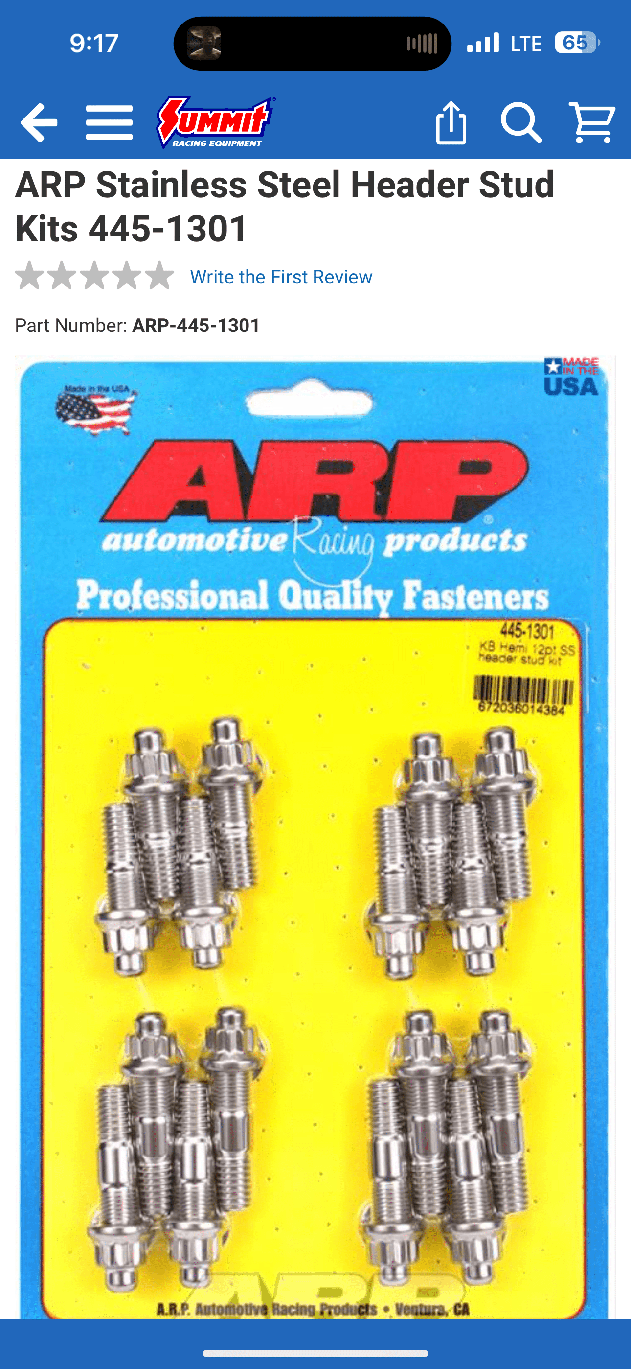

As mentioned ARP. They have whatever size s.s. stud you need and sell in bulk if you can't find them in the blister packs. I used s.s. studs on my entire engine externally where ever possible.

Ok, am I blind or does no one make a polished header stud kit for the small block? I’m getting ready to install my TTI headers finally and they only came with bolts, no studs for the water jacket holes. I searched hi and low but can’t find anything stainless or polished. Do I just need to buy an repro set from Roseville or somewhere and deal with the black hardware?
I dunno man I tried ARP and I could not find any 5/16 header studs. I could only find 3/8 studs, or 5/16 bolts. Not saying they don't exist, but I couldn't find them anywhere.

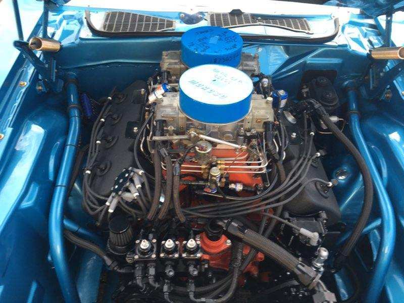

Edit: that motor is nasty looking!
