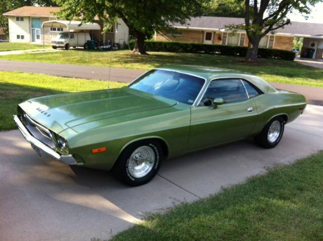

Just got it home, thought I'd share a pic. It needs some work, but it's a good start.
