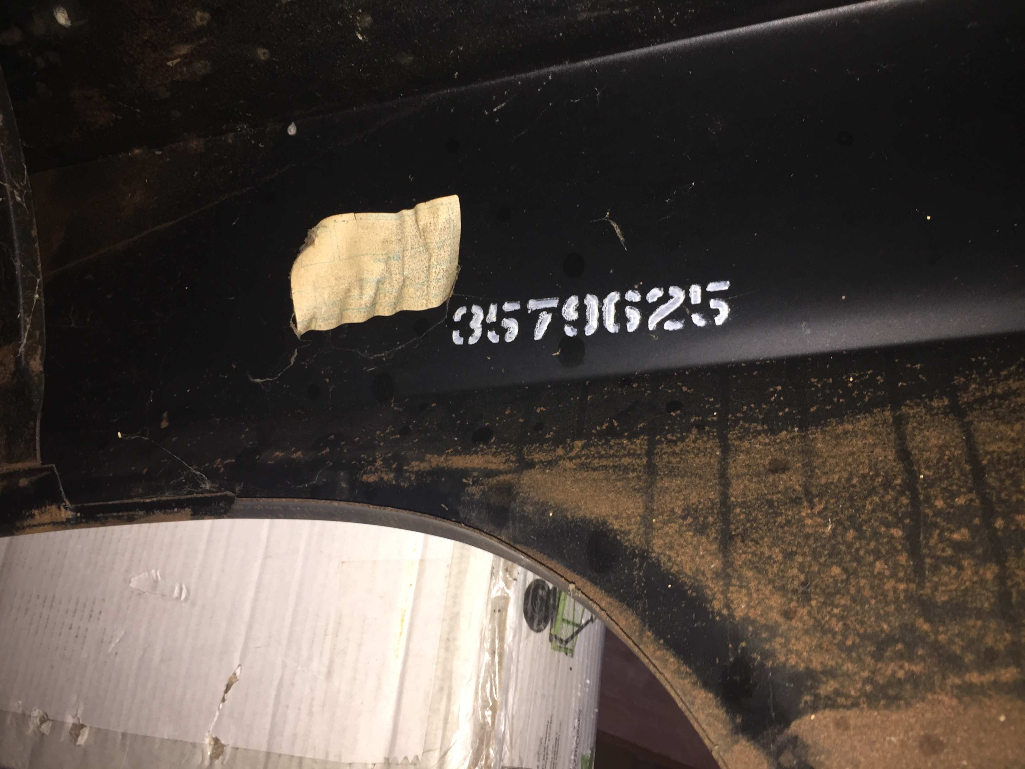

In the 70’s, Mopar, the were technically 3 Challenger fenders that were made; one standard-3419878-79, one for cars with 15in fenders-3579380-81, and a production fender that was a over the counter factory replacement fender in the 70’s-3579624-25 that was listed as a TA fender in the collision manuals.
I picked up a new set of the 24-25 fenders in the early 80’s. When you compare them to my early production (Oct.69) originals, the 624-25 have the notch and the hood bumper nut is welded in a different location. This was the only Challenger factory fender that was was available at the time and was designed (I guess) to be a replacement for all needs? They had the notch to fit the 1971 grill. The gents on the assembly line probably used whatever fender that was in bins by 1971 production. My Challenger is an early 1970 A66 that originally came standard with 15” rallye wheels and has the wider opening and the center is flat. Best guesstimate I can make!
340challconvert
Feb 13, 2011
5,342
2,845
Parsippany, NJ
And to confuse the issue more; the 624-625 fenders (TA replacements) had a bulge at the center wheel well that is different to accommodate the wider tires.

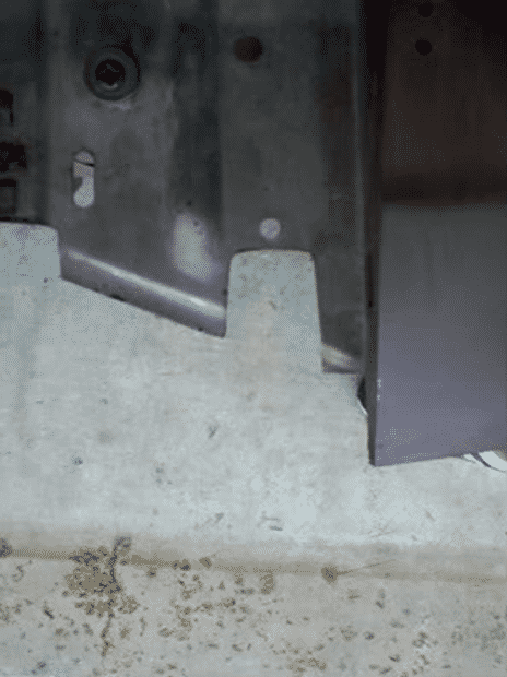

Actually, the notch was not needed for the 71 grille but for the 72-74 grille. The part of the fender with the notch was used on the later grilles so it looks like Mopar started stamping them out early. See photo of my fender to grille header area.

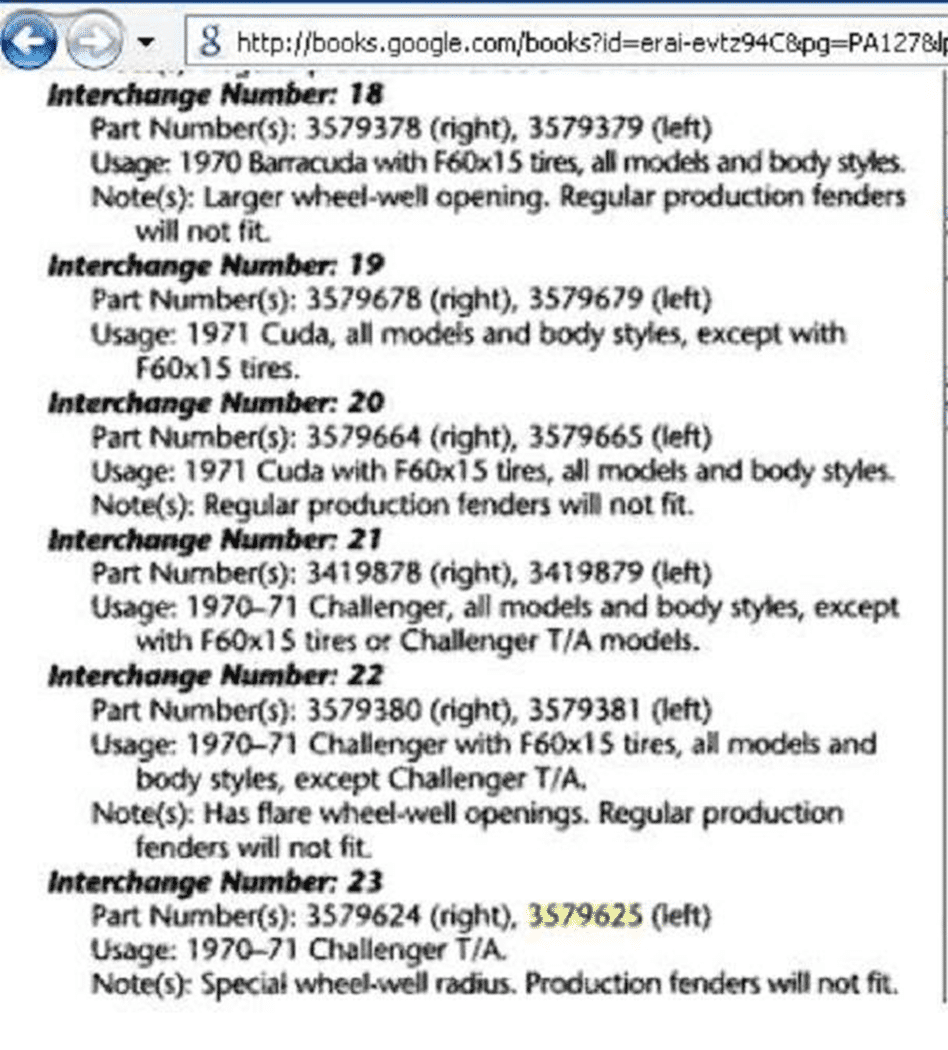

From the factory 1972 Mopar Dealer Parts Catalog
3419878-9 1970, except F60x15" tires
3579380-1 1970, with F60-15" tires
3579380-1 1971, with F60-15" tires
3579624-5 Trans. Am, w/F60x14 tires
