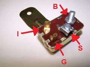

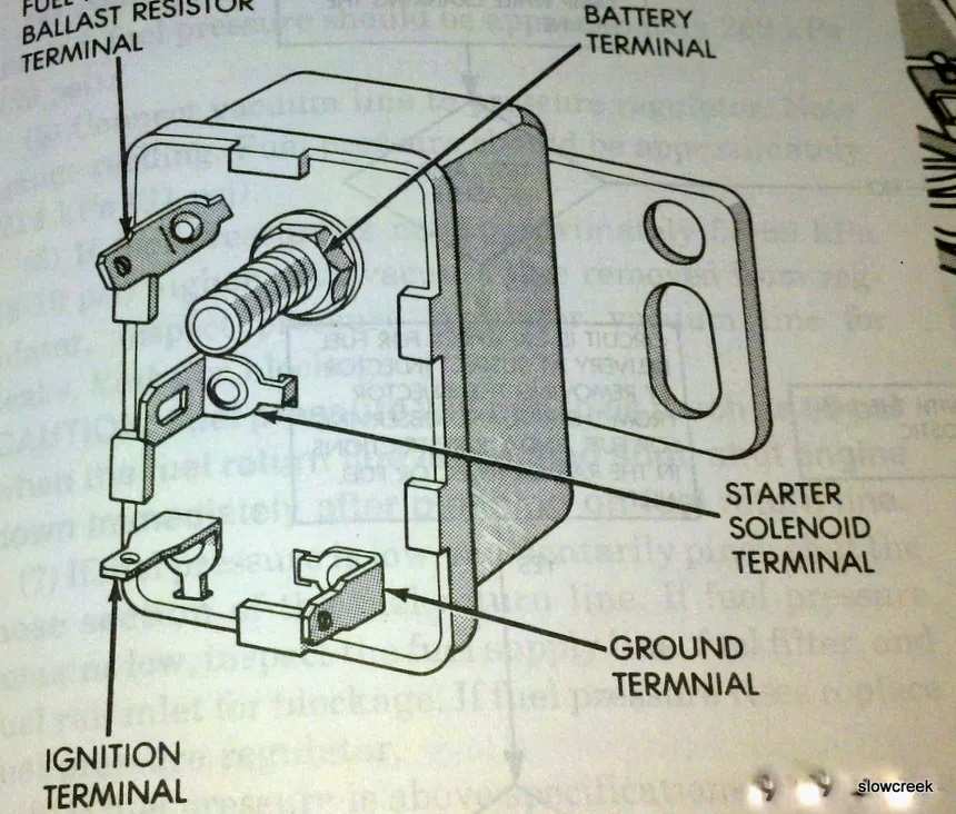

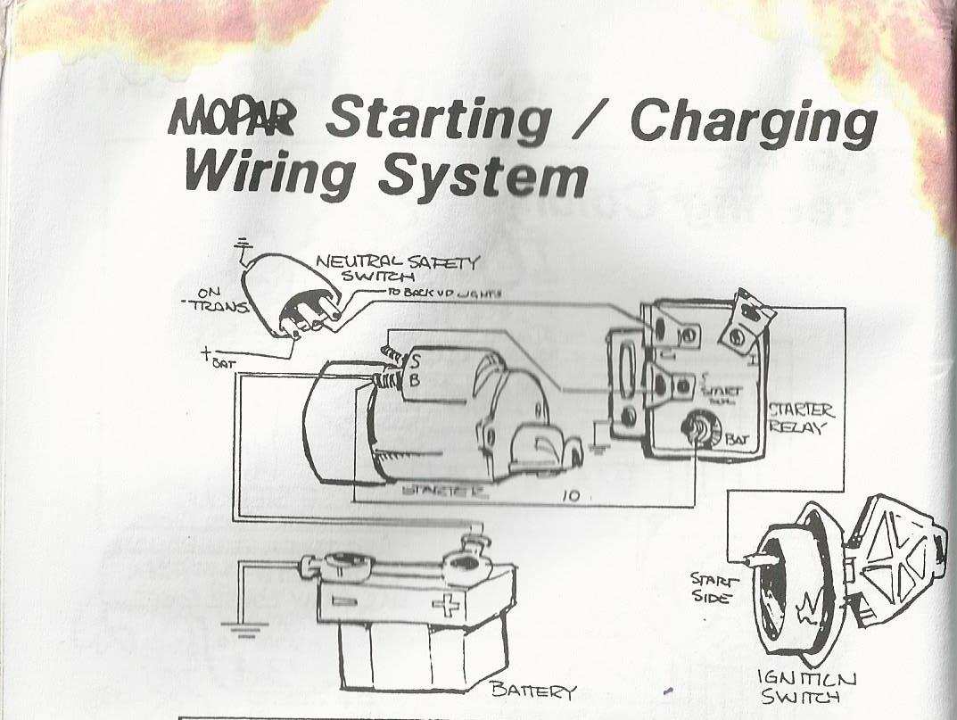

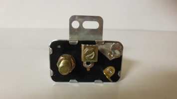

This is a point that is overlooked. there are 2 circuits in the starter relay circuit. there are 2 grounds. Look at the relay and nose of the starter. in 1st picture shows ground. Clutch pedal completes one ground for the relay to function. Then the relay completes the circuit to the starter solenoid and battery ground. The relay housing has to have a ground to work. The mounting bolt can be the problem. There are two different relays manual and automatic.
If it is a manual car then "G" is folded over and attached to the case.
"G" is where the neutral safety switch yellow wire plugs into
they are the same but configured different. Early cars wouldn't have manual and auto difference because no safety switch on clutch pedal
