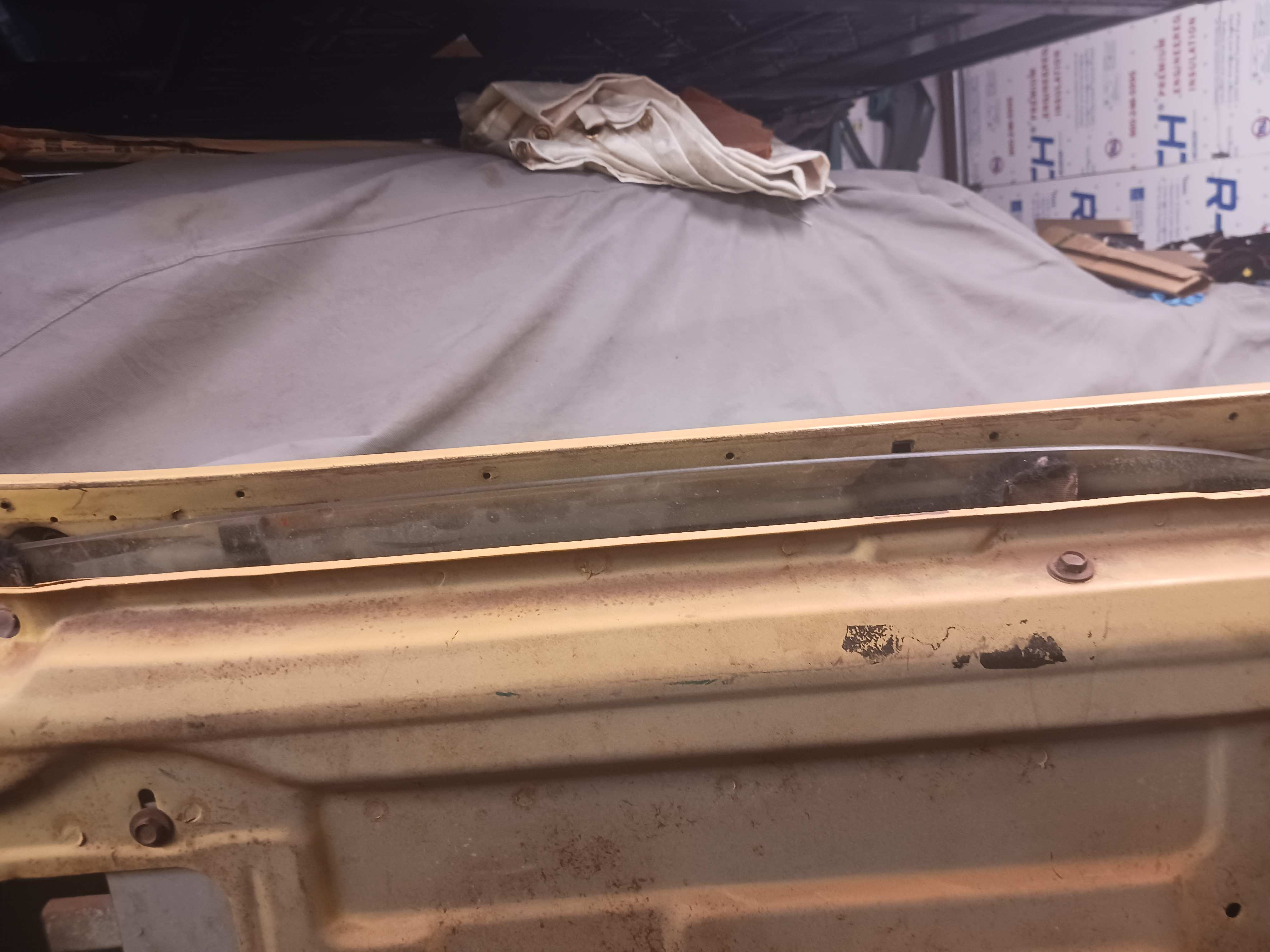

May 4, 2024 #2 T terrywalker Well-Known Member Joined Aug 31, 2013 Messages 457 Reaction score 265 I removed the large rubber blocks inside the bottom of the door. This allowed the window to go down further allowing access to the screws. Terry W.
