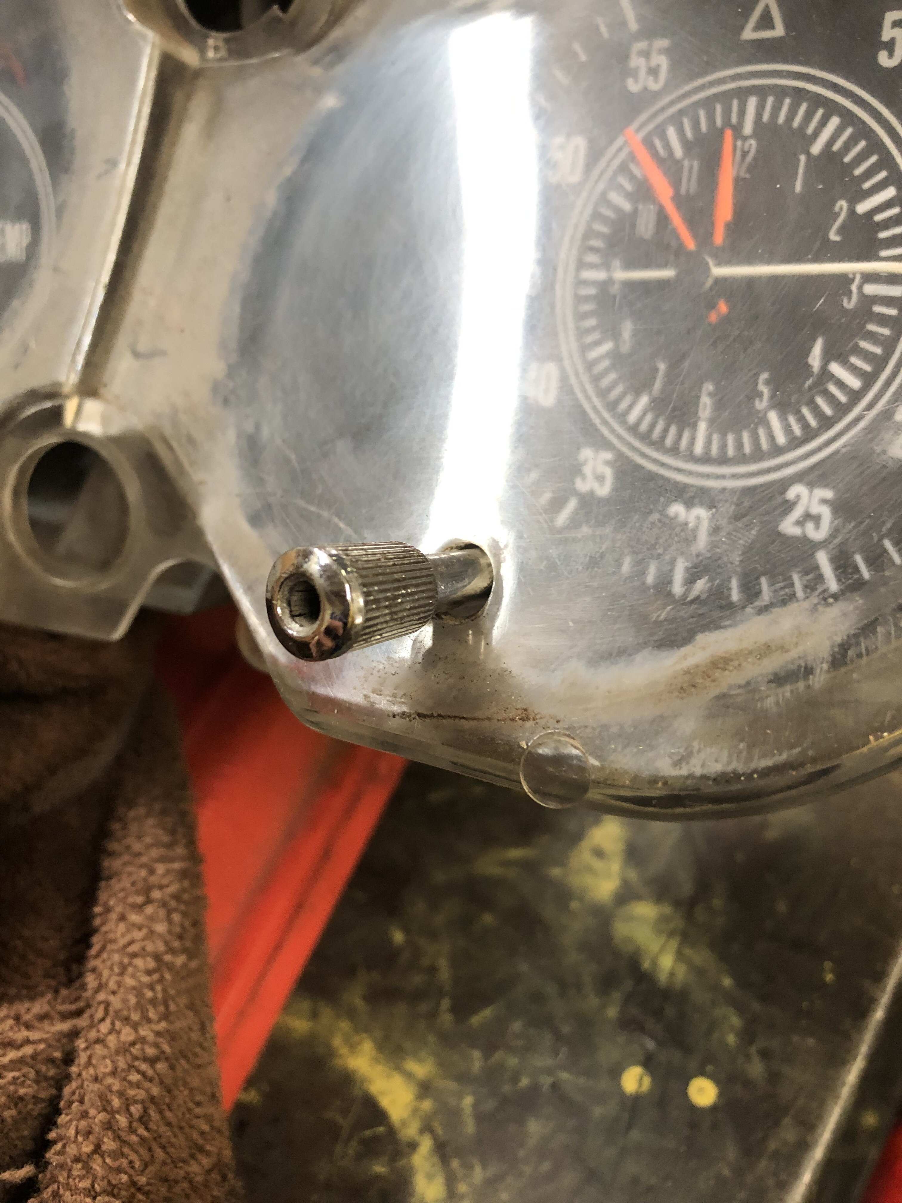

Hello members, hope you are all well. Just wondering how to get the clock knob off so I can get the plastic off & change it out. Anyone know how it is done? Please & Thank you all very much

Tiny little flathead screw inside.
If that is true, there must be some differences from year to year, because I currently have the rallye gauge cluster out of my 70 and the ends of both the clock and the odometer set screws are threaded so those chrome knobs just screw on and off.

Scroll down to “Similar threads” and the “How do I get these knobs off?” thread has a picture. Yours is the same idea as a ‘70.

Your barrel screws might be seized or glued on the knob. I have a ‘70 and it’s separate knobs and separate barrel screws.

Oh yeah, scratch what I said. It looks like those barrel screws thread onto the threaded end of the screws that I was talking about. Sorry, my mistake.
