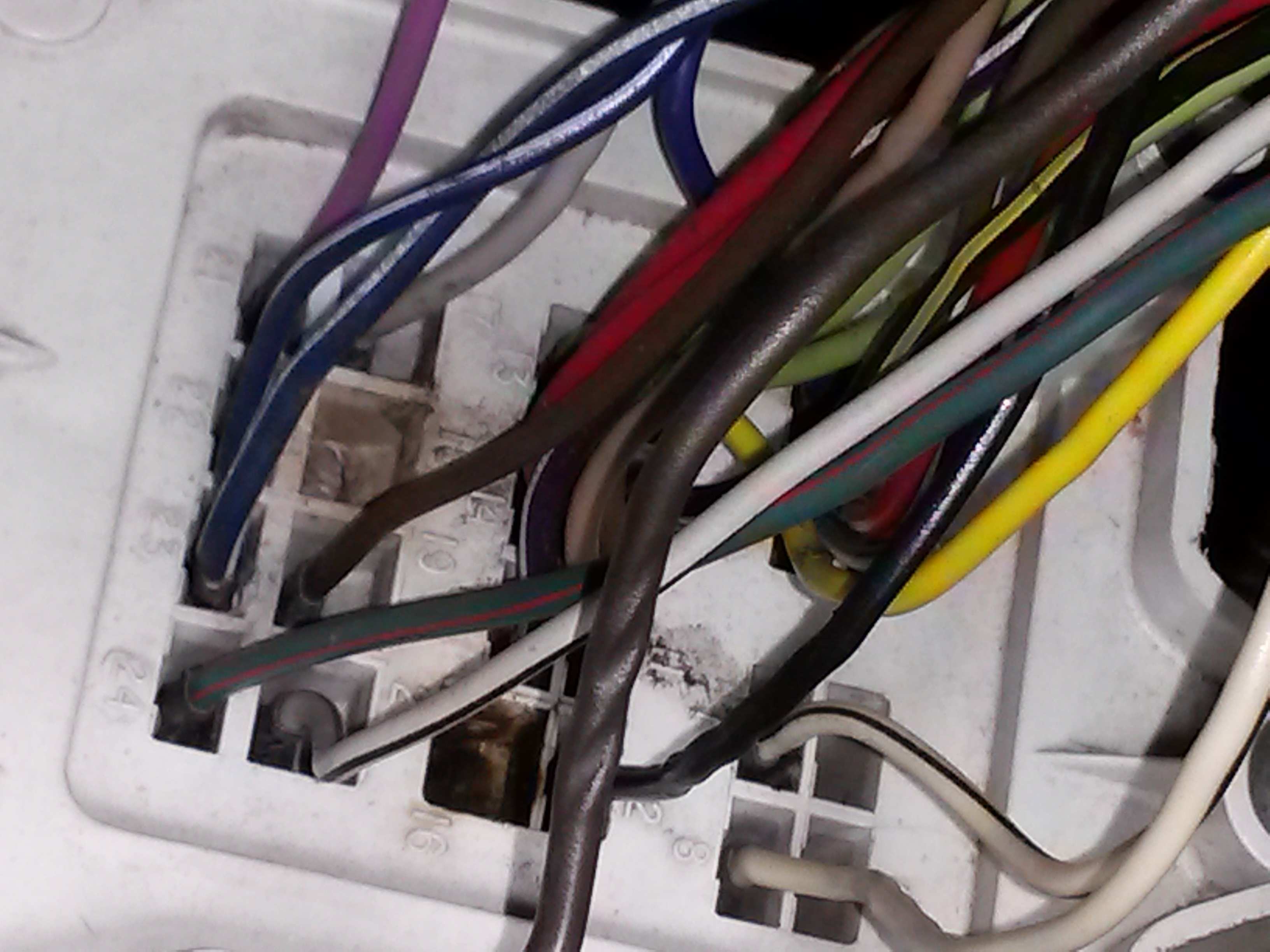

1:RED wire 16 Battery power yellow dot to splice one feeds fuse block, 2:charge wire 18 black wire blue dots to splice one through amp meter to red wire blue dot 16 to battery, 3:ACC feed from splice 1 Red wire Q3_12R yellow dot to steering column. Black wire 12BK red dot to ACC side of fuse box.
Start with a test light on battery to ground. 1 Check to see if you have power at starter relay. 2 unplug bulkhead connector check Red 12 ga wire for power. 3 check fuses box terminal marked BATT for power. 4 Under the steering column unplug connector and check the Red 12 wire. This should always be hot when the battery is connected. The alternator feed will also be hot R6 12 bk.

This is splice 1 untapped . where everything is tied together. Loads Headlight, ALT, AMP meter and ign sw power. See the brown wire beside it that is for ign. It is probably melted too. Just a guess because you said the fuse blows when starting.
Here's the brown wire again.

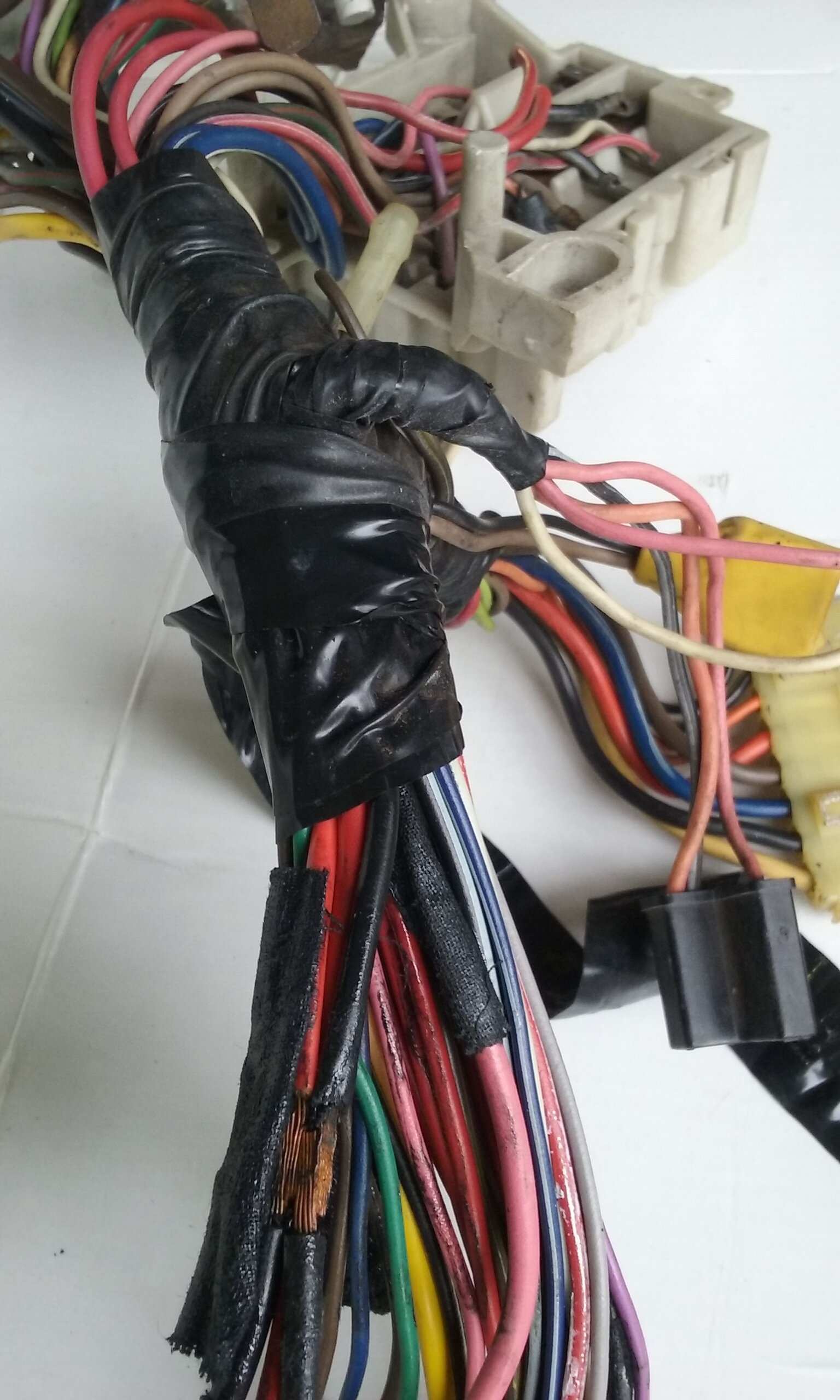

1 thing to do is unplug all the bulkhead connectors except the one from the battery the middle one and turn the sw on and to start see if it blows.
I know this is a shotgun approach but it will narrow it down inside or outside.
If it blows it is more than likely shorted somewhere in the dash harness. Like the pictures in post # 10
