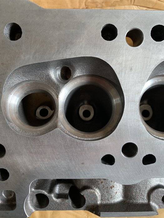

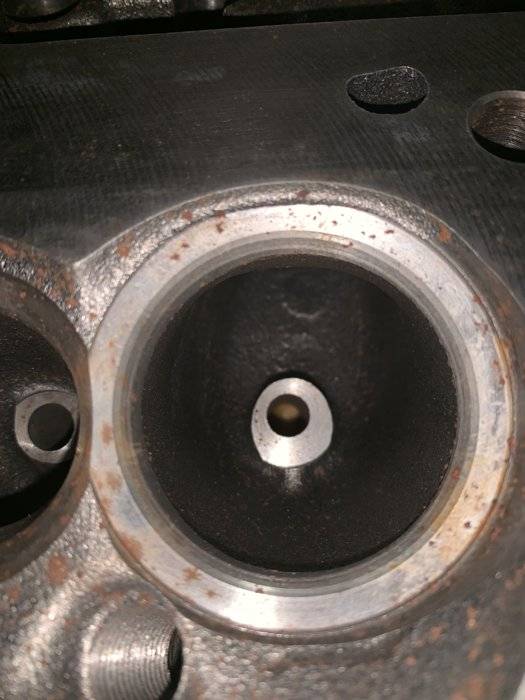

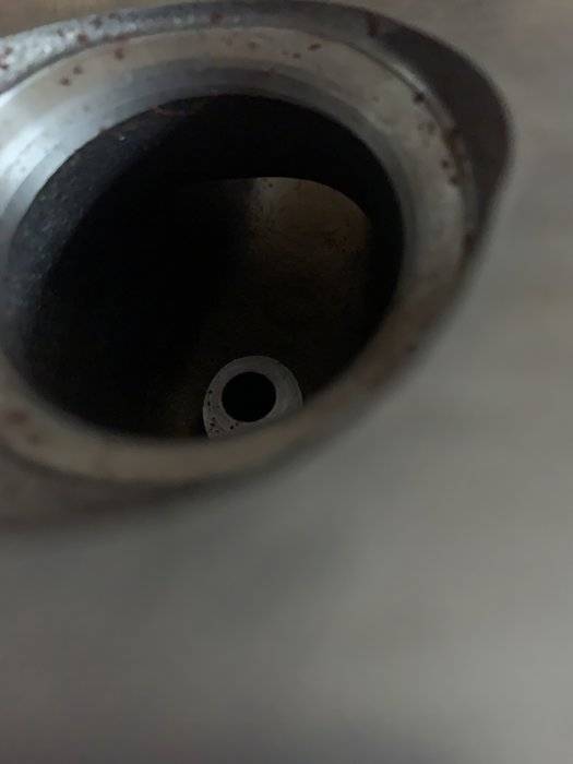

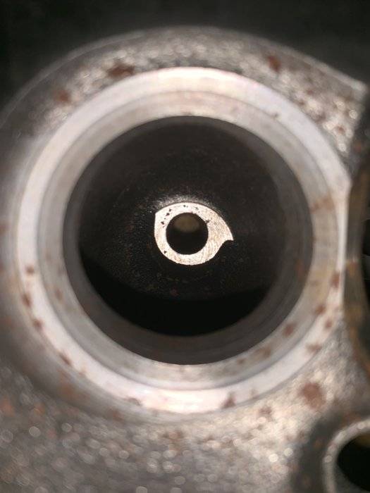

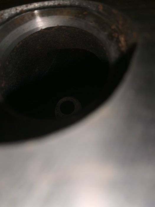

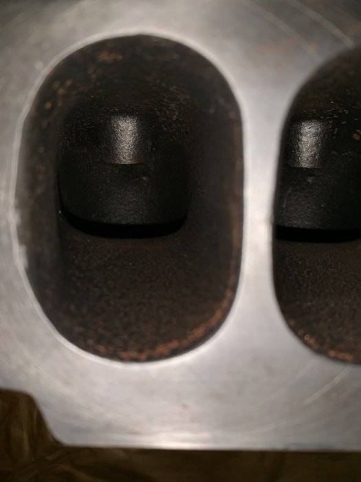

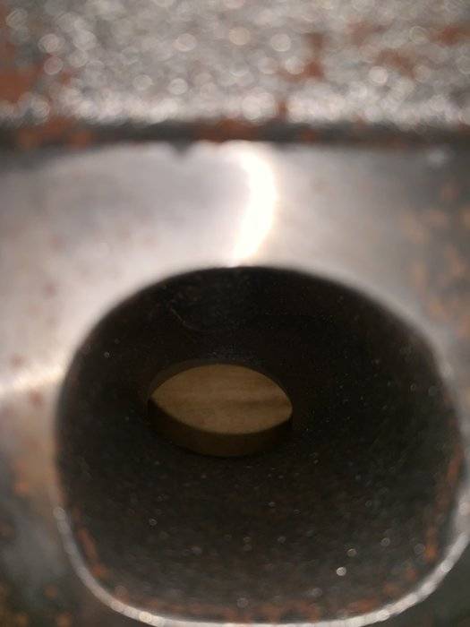

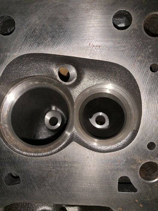

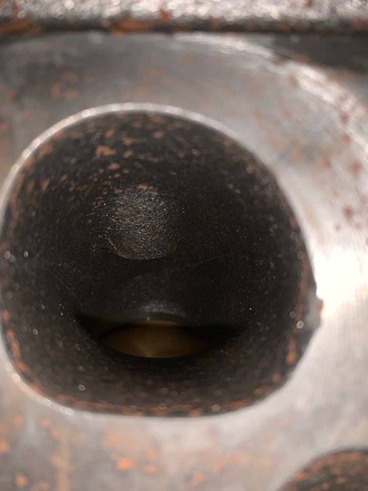

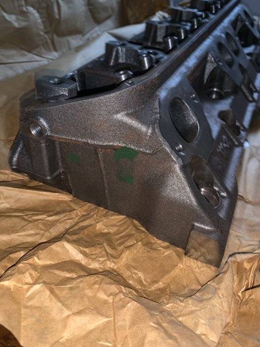

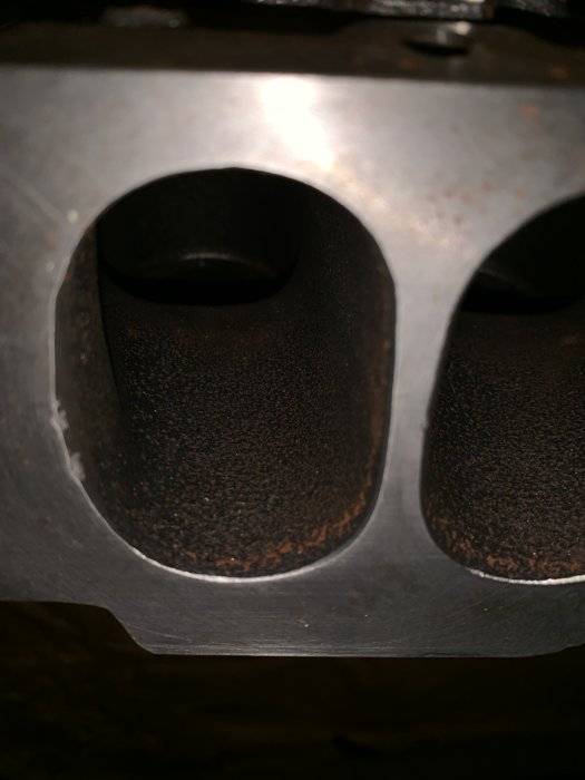

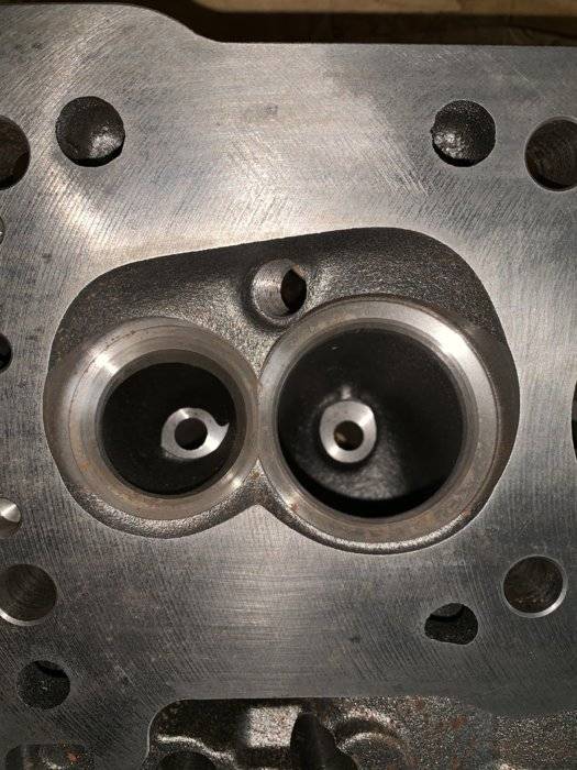

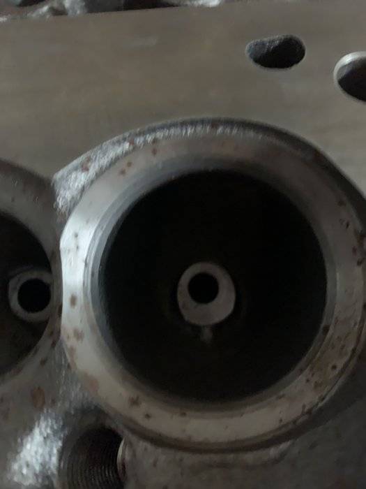

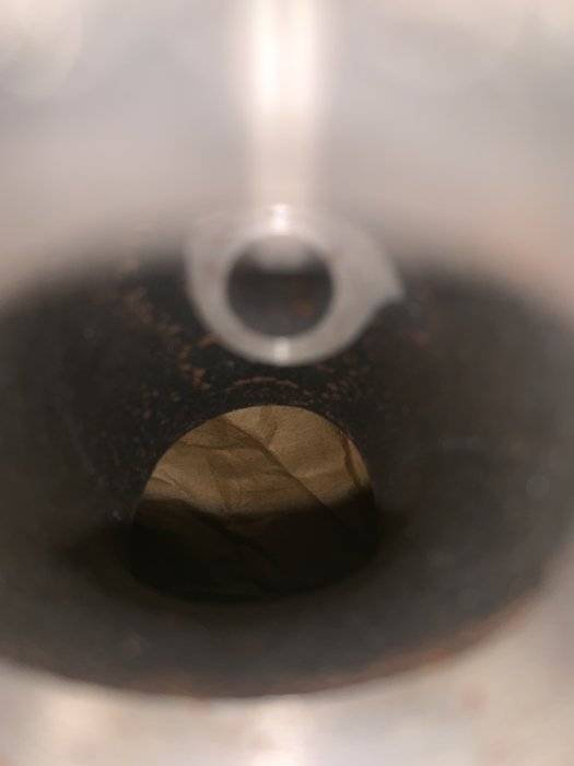

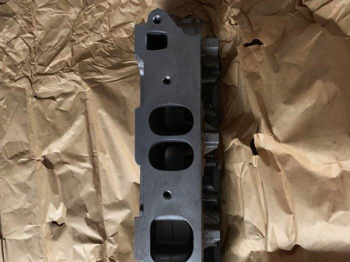

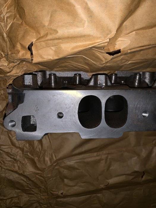

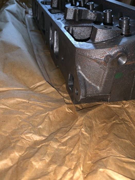

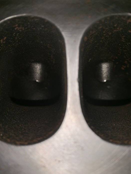

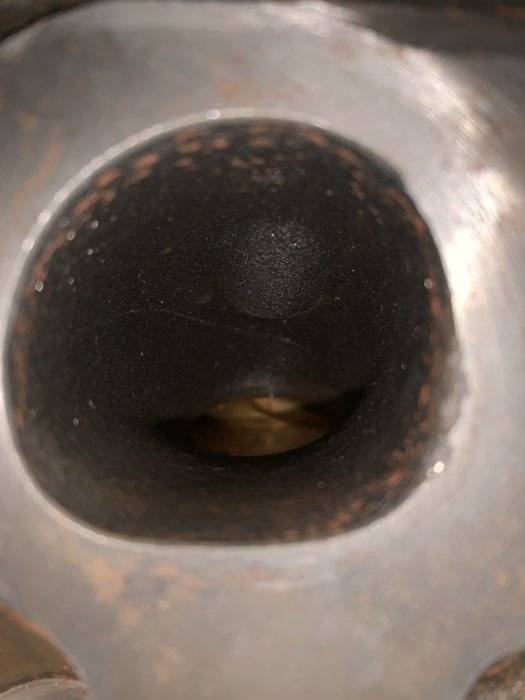

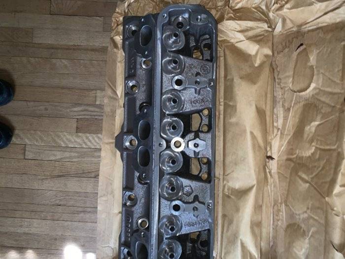

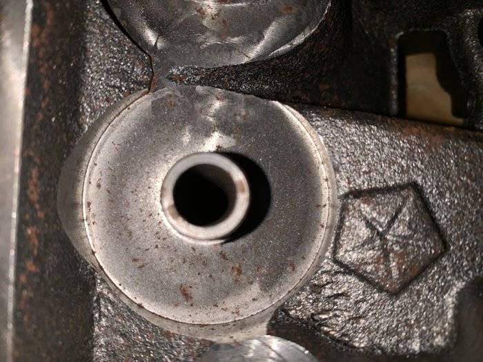

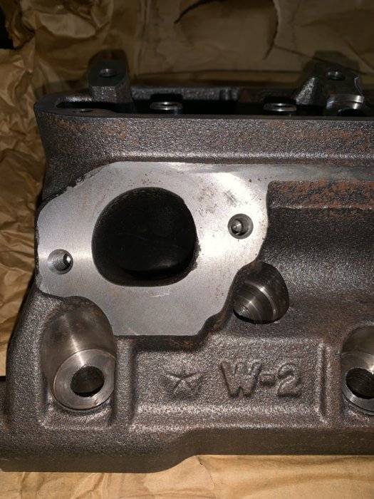

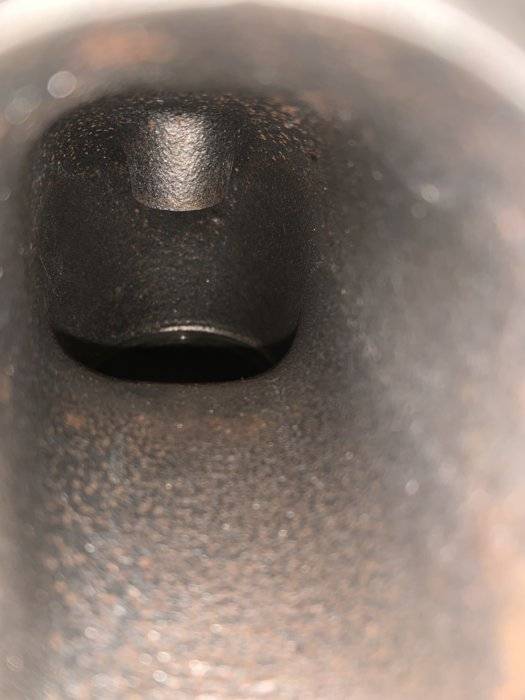

I was just getting busy taking some W2 pictures for you. These are mine awaiting there turn. Sorry! Phone quality.
Rust appears 100x’s worse with the phone. It is in reality very light.

As you can see, there is some good basic work to be done before use.
One thing most people do is change the valve guides from 3/8’s to 11/32’s.
The basic port shape is there. Mild porting around the valve stem guide and work to the bowls can use some clean up to mild work for basic usage. For a light race to street machine, this would probably be pretty good.
Full porting required for a max effort 300+ cfm is a considerable amount of work with iron. You can see the core shift pretty easy. I really do not know the in’s and outs of porting. From what I read I could talk a ton of **** but in reality, you really need an experienced head ported and one with W2 experiences to get this head at its maximum potential.
It is a good head. Just heavy.
I would not use this head in a search for 700hp.
Unless it is a old tyme Pro Stock build in a 2200lbs. car ignoring every RPM under 5500/6000 when I let off the trans brake.
But, even more so on a tiny 340 cube engine looking for 700hp.
