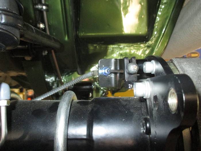

To use the factory e-brake cables on the Wilwood setup, we had to shape brackets and mill round pockets for the cable-ball retainers and tig them to the Wilwood levers. All the smallest stuff added up, are the time killers. LOL
Yes, when deviating from factory it is amazing all the custom small brackets and fabrication required.
I am only deviating from early year factory to later model mechanics and it seems never ending.

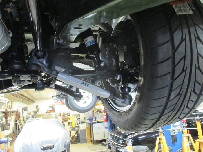

Well, the front end is all there. No brake hoses at this point, but that'll be done when I get to the hydro-boost stuff. We're waiting on the custom rear rims to be made[3-6 weeks], and the rear is all done except the brake hoses. I need to find a driveshaft out of a recent Charger/300[4-bolt flange], so we can do the tone-wheel thing for the speed sensors, on the soon to be fabbed driveshaft. I'm getting my left knee replaced on 11-13, so time is starting to crunch. I wanted to have the whole underside done before hand.....but it's not looking like that'll happen.

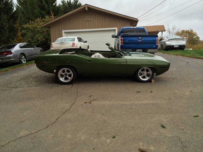

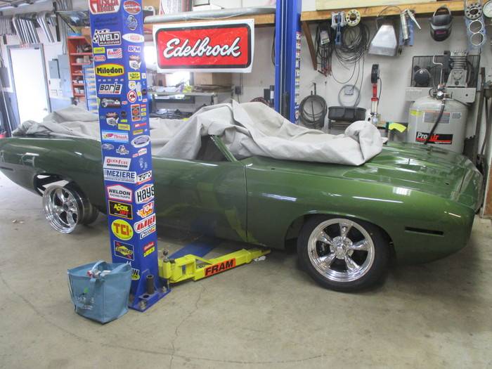

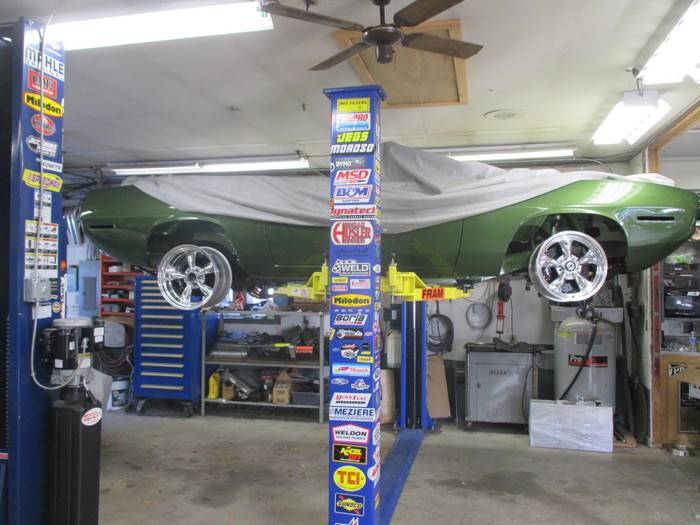

First time in 20 years, it's on wheels and it rolls. WOO HOO!! The rear will settle some with weight, and we have to make a couple adjustments to the rear shackles and wheel lips.
03HDFB
Oct 17, 2013
209
21
Fricken Awesome Mike....20 years??? Very happy for you and I'm sure Smiles from above!

Thanks guys....I'm jazzed. I measured the height of the fender edge on either side of the hood It's 27 1/2" from the garage floor. I'm wondering what's average on a stockish `cuda. I know the rear is gonna drop some, with the finishing of the car. If we need to lower it a little...we have that worked out. It's gonna be bothersome to be down for 6-8 weeks from surgery recovery..

It looks stunning sitting there.
I had my 68 Mustang disassembled for over 15 years. So I know what you are feeling.
Motivation factor will only get stronger now.
Best wishes on the surgery and minimal down time.
