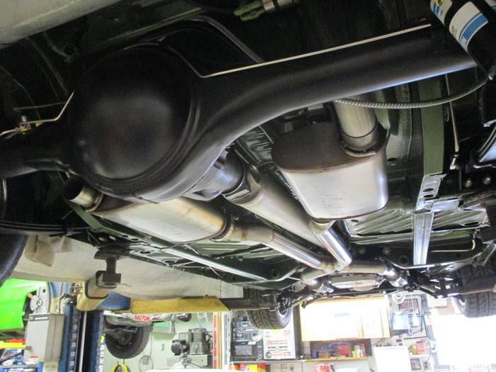

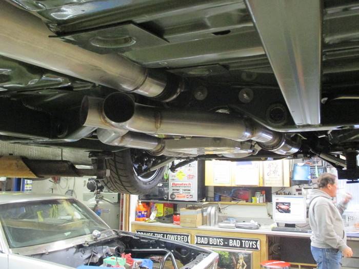

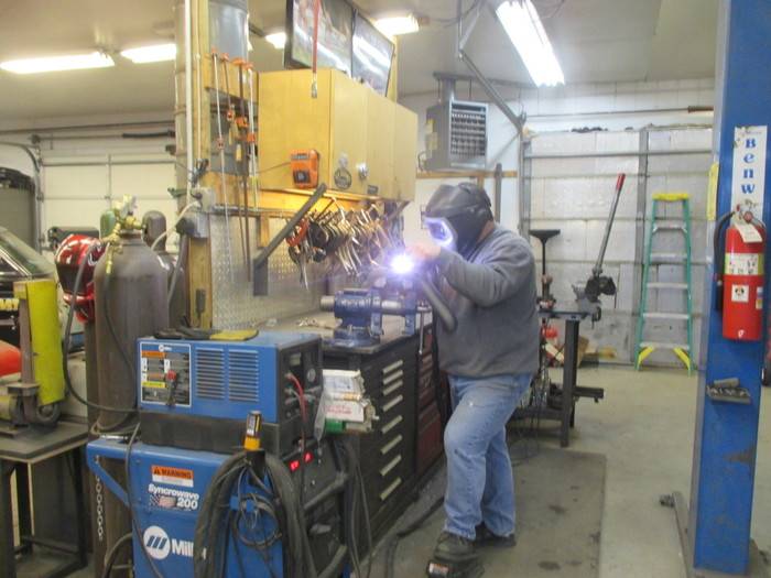

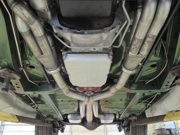

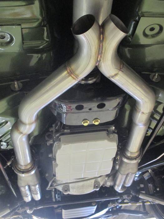

Okay, back to work on the car after a few weeks. Ernie started the 100% stainless exhaust system build. What you see was built in the 2 1/2 hours we were there. He always amazes me with his fitting and welding of this stuff...virtually no air-gaps

Thanks again. It'll probably be a couple weeks before he finishes the exhaust, as he does his regular and most distant customer's work daily. It gives me more time to plan the build sequence and parts. We're getting close to being done on the underside. Next, I would guess I'll be doing the under hood basics, and wiring it up for power. I don't feel the need to hurry any of this, as I'd like to do as few things as possible...more than once/twice. So far, some basic stuff has escaped the thought process, and had to be re-engineered and done. This is my first foray away from old-school type cars, and if this goes fairly smooth....I won't go back.

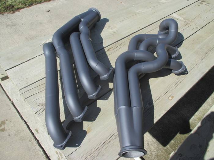

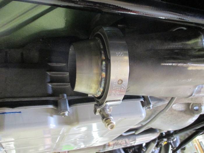

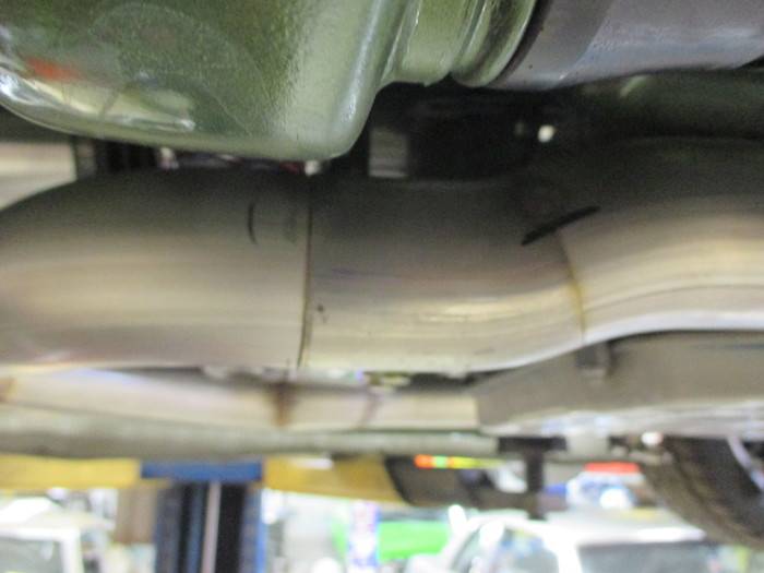

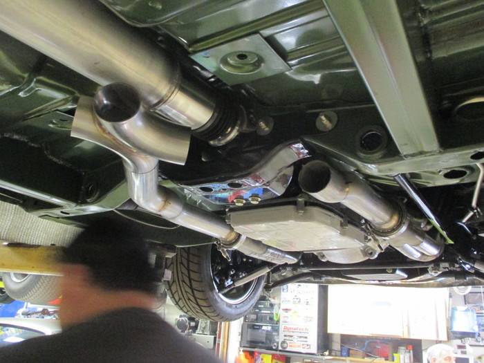

Well, the system is tacked together and hanging up to the rear axle. As soon as the tips arrive, it'll be to the back/valance. The headers will be ceramic-coated, the finish tig welding done, and the whole stainless system hand rubbed with fine scotchbrite. The amount of measuring and checking level and body points that he does is amazing. It's very symmetric, in an offset body/drivetrain.

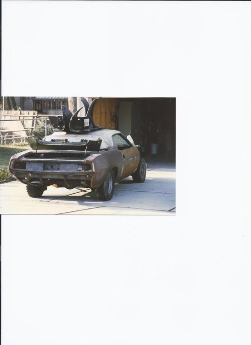

I was going thru some old photos, and found a bunch of old 35mm stuff. Here's the car in 1996. It had sat for 10 years, after my dad had started the "1st resto". This is after retrieving it from my Dad's place. It had become quite the mess.:sad2: I started over completely, and we cut off the NOS quarters that were brazed on. I bought lots of metal[didn't need a bunch visually] but I didn't want to be chasing rust on down the road.

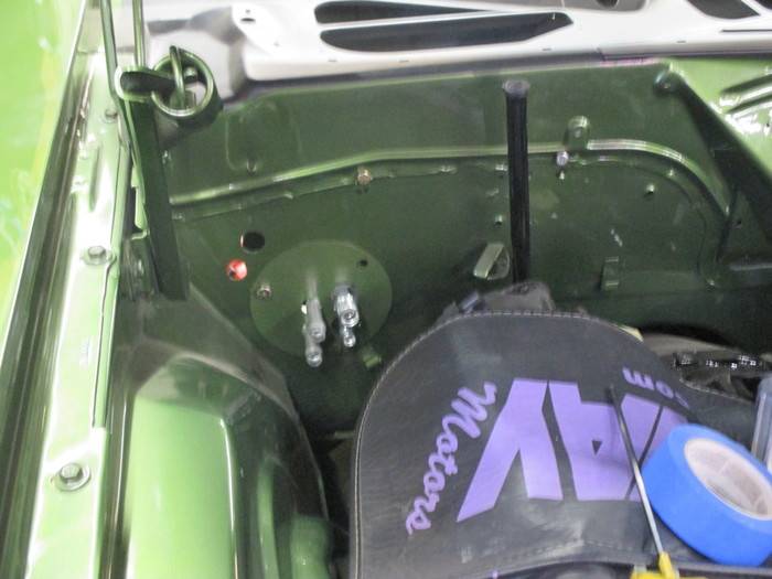

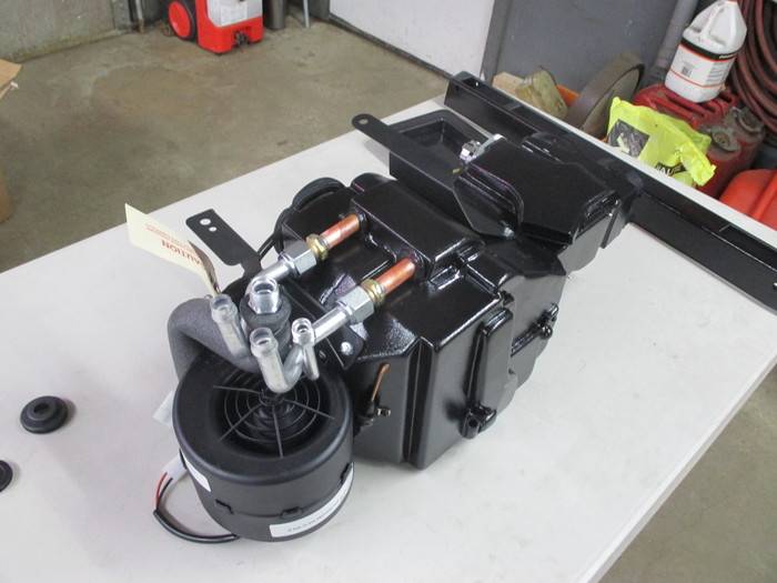

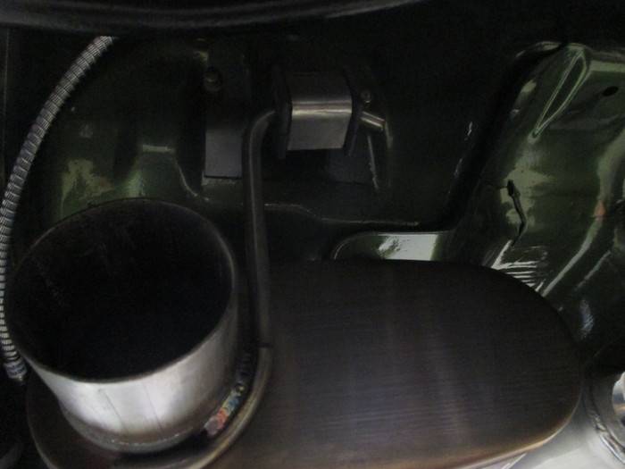

Dropped off the headers, so we can finish the exhaust. Bill and I also installed the Vintage Air evaporator/heater box. I insisted we take it out a few times to make corrections and mount it more securely. I made the black marks on the outside of the cowl per instructions, then went about doing it my way. The mounting holes were way different actual location than the instructions, and we welded nuts to the back side on the supplied brackets for mounting the box. Everything is located correctly now, and bolted in with thin rubber between the brackets and cowl, to prevent any possible squeaking. The kit came with self-tappers to mount everything. NFG! We notched the front frame-rail flange to clear the alternator and tig welded the edges back together. We also had to notch the end of the right frame-rail to make clearance for the factory "new" Challenger/Charger condenser/trans-cooler fittings. I'm trying to use as much "new car" stuff as possible. Now comes all the plumbing for the heat/A/C. This is all the stuff I've been dreading. It's been fun up to this point. Now for my opinion about the parts... I think most of the Vintage Air stuff looks "cheesy", and I'll be seeking other trim and vent options. The actual heater/evaporator unit looks okay, but it's nothing like the sturdiness of the original stuff. I've used their stuff before, and basicly only used the box inside.
you can see where the black marks are, and where the holes ended up being.[blue spot] the other hole is to the right the dipstick tube, and not close to the mark, either. Notice the nice hole locations on the new cowl-plate for hoses and bolts. GRRRR

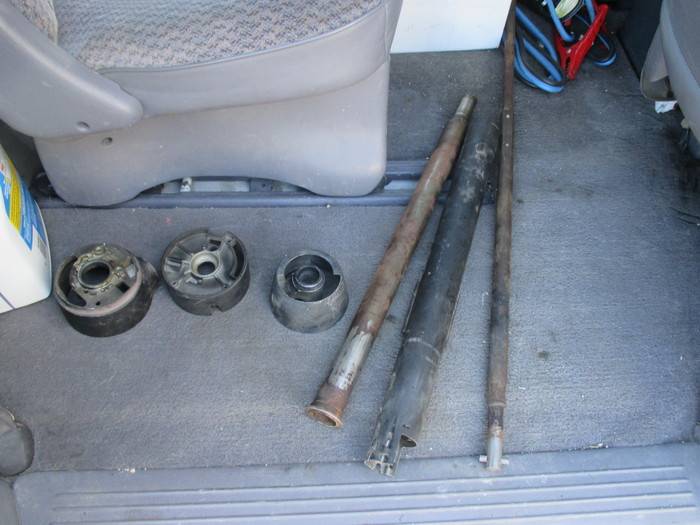

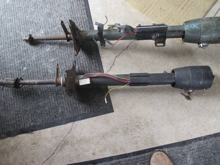

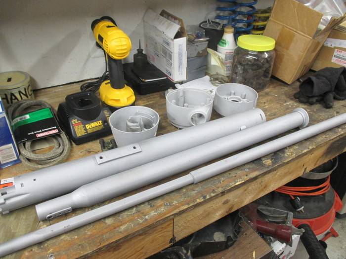

Gotta rebuild the column sometime soon. Have the original black one, and another green one. I'll be doing the original in green. I have to order all the parts.....

Making headway. I'm rebuilding and painting the column myself, thanks to info from another member[Code3]. Waiting on parts and paint mixing.
