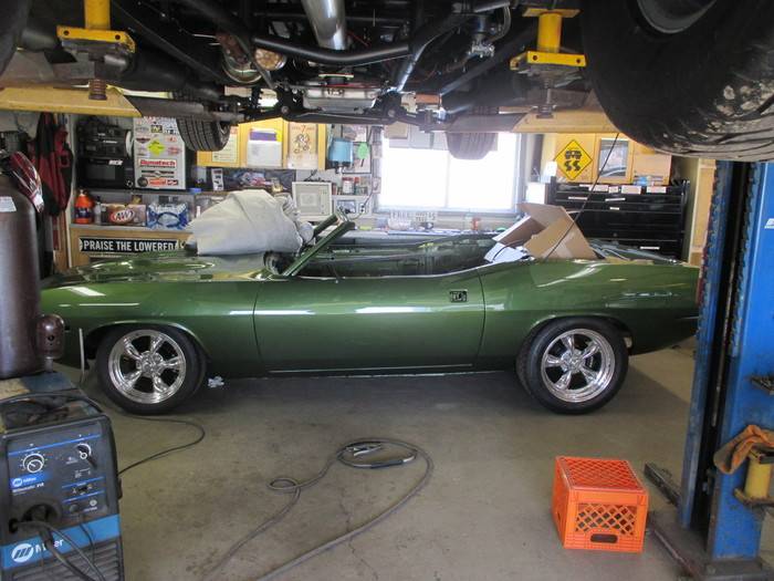

When you see it. You'll see it's not my typical over-done car. I just want a nice driver. Pictures always make things look better or worse than the actual thing is.

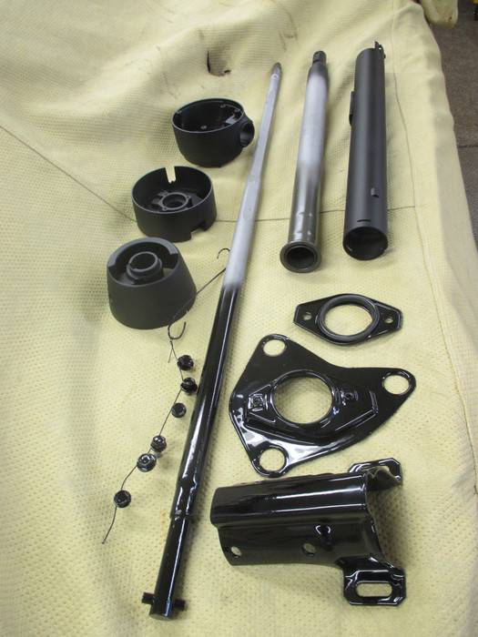

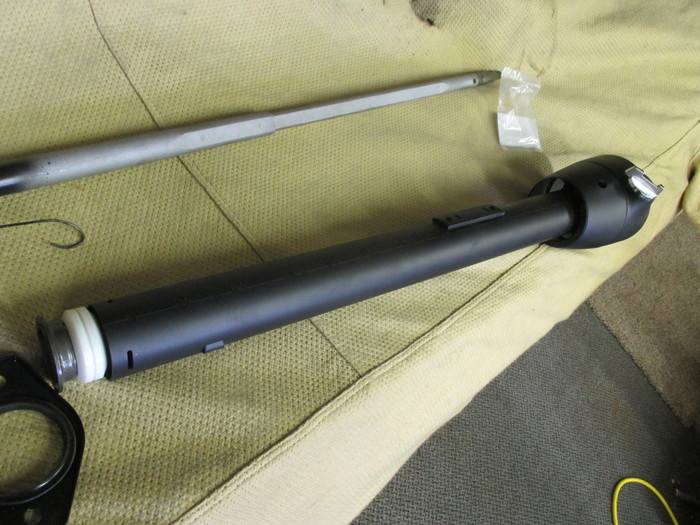

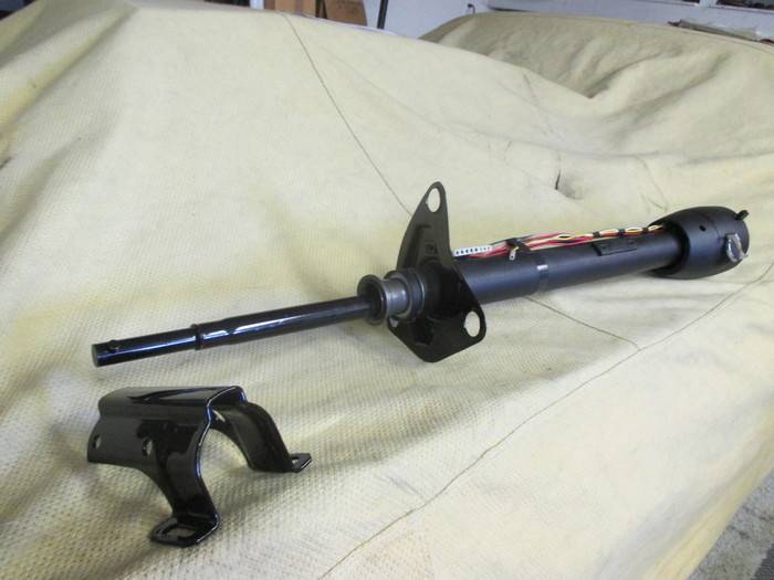

Got all the painting and coating done on the column, except for the green. The flat black parts are etching primer. The lower bearing and clip arrived today...so now I'm waiting on the upper bearing and NOS lockset. I don't see anything wrong with my original wiring harnesses/switches., so my wiring guy and I agree I should use them again.

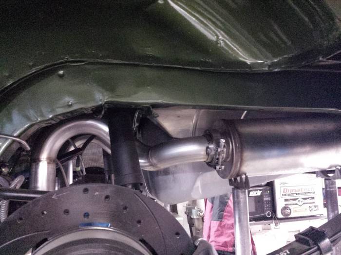

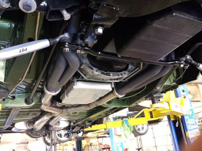

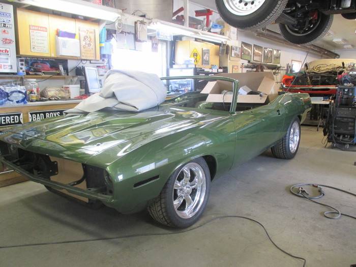

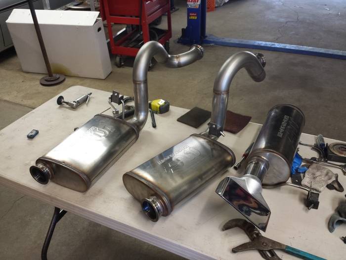

Went by the shop today to drop-off and pick-up some parts. The exhaust was just being finished. It would seem I'll be urged towards having myself and Ernie to do everything we can while on the hoist. I think we're both at the point of it being almost done at his shop for the time being... very soon. It'll be easier to continue a bunch of the tedious stuff at home. I got an small injection of interest today.

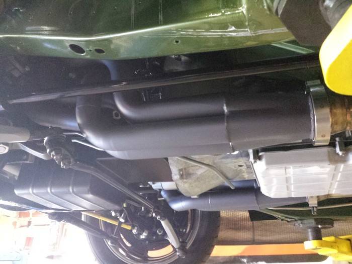

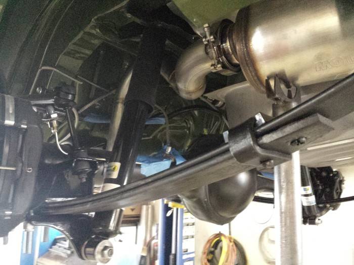

From the headers back, everything in the exhaust system is stainless. It's funny how a magnet will only stick to the mufflers.

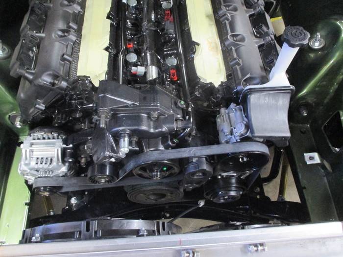

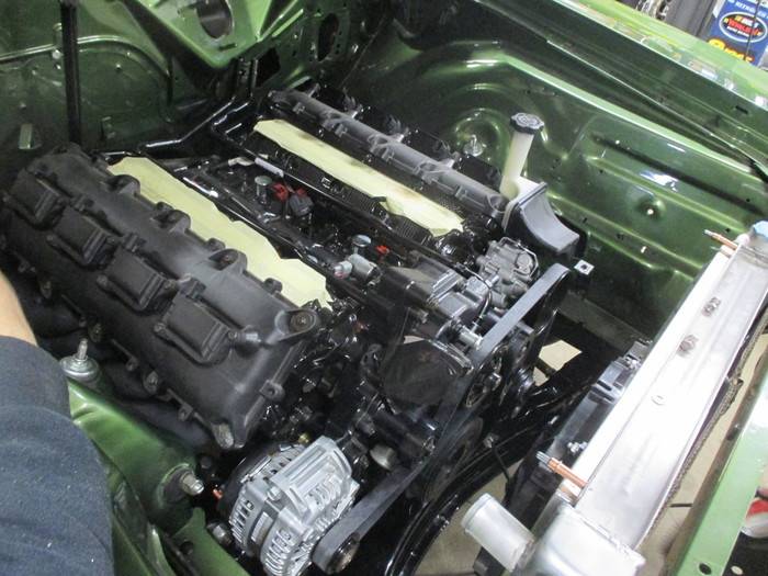

Went with Bill today, and we bolted up the convertor, attached the new engine accessories and serpentine belt, and gave the front-end an eyeball alignment. Water pipes are next.

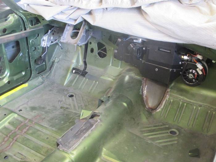

Thanks my friend. I have to decide what to do about that ugly-ass plate where the A/C and heater hoses exit the car. I didn't want to weld up the original cowl....but that crap is awful. I gotta figure a way to make it look more factory and like it belongs there. It'll be another pause for thoughts on this process. In the mean time, I'll get the condenser and hose routing planned out for that.

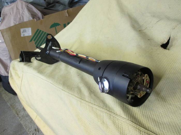

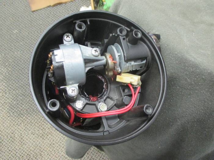

I spent a couple hours in the garage, rebuilding the steering column. I need one snap-ring that "snapped"....otherwise it's coming out great. I'll paint it "suede" finish green in the next few days. It'll be lots of careful masking, but I painted cars for years. I know it would have needed repainting after assembly anyways. Just too much handling of the parts.

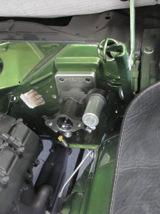

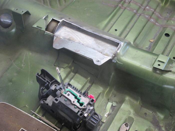

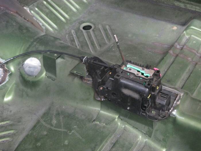

Got shifter in. Still gotta route the cable to the NAG1.
Also bolted up the hydratech and brake pedal. I have to take it apart, and mill off the advertising. I'll have the mounting plate coated.

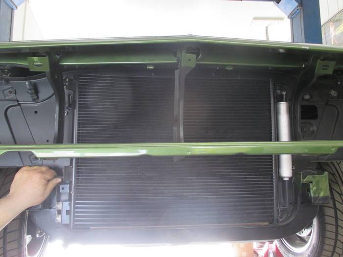

The new Challenger/Charger, A/C condenser/trans cooler is gonna be a great fit.
It appears the car will be coming home next weekend, if the weather permits.

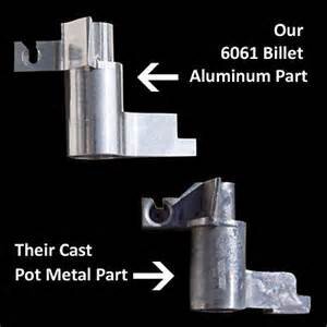

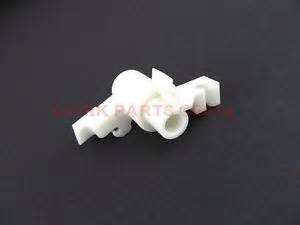

Just a note. I don't know what year the shifter came from but most came with a plastic shifter interlocks that will fail. Dorman and others make a metal replacement. Just incase. I already replaced the one on my Magnum R/T.
mmissile
Dec 26, 2013
1,137
355
Macomb County Michigan
It's a new replacement shifter[dirty from sitting in the shop] I got from ebay or Hotwire[can't remember which right now]. Do you have a picture of the part you're talking about? If it's gonna break...I'd like to replace it now. Thanks.
NOTE: Just ordered the Dorman part. I'll put it in in, though I think my shifter is a bunch newer and probably updated. Easier now, than later.
