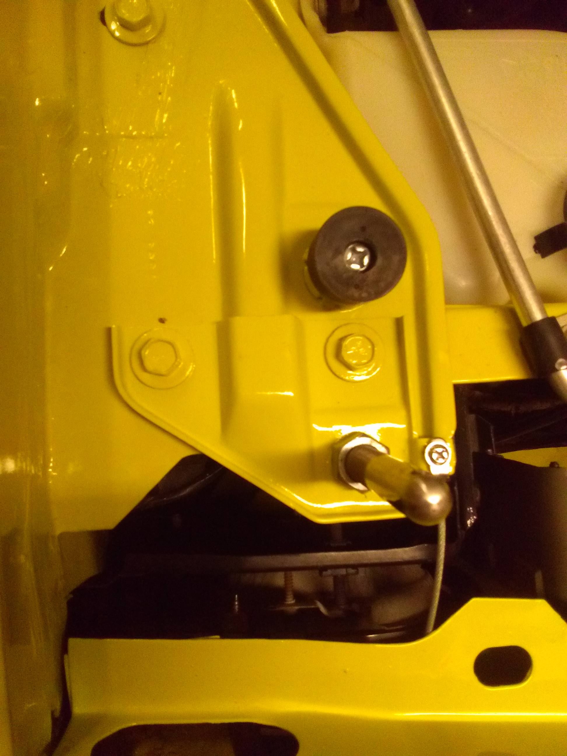

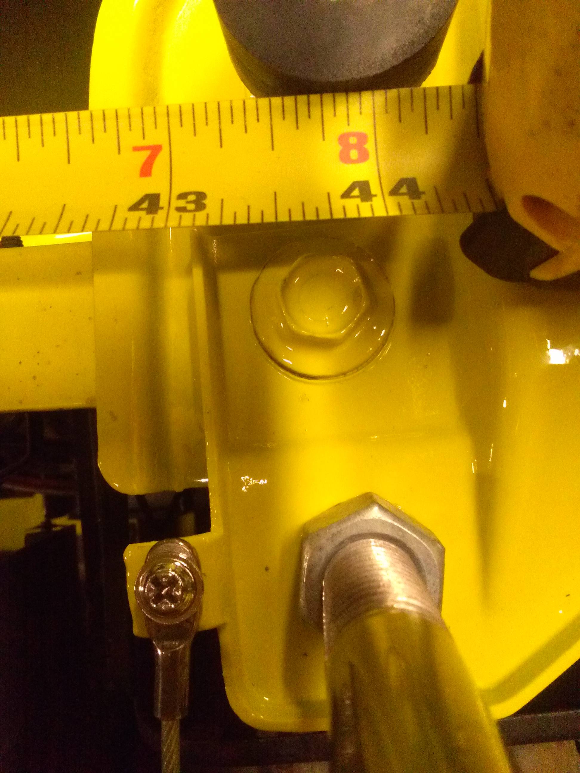

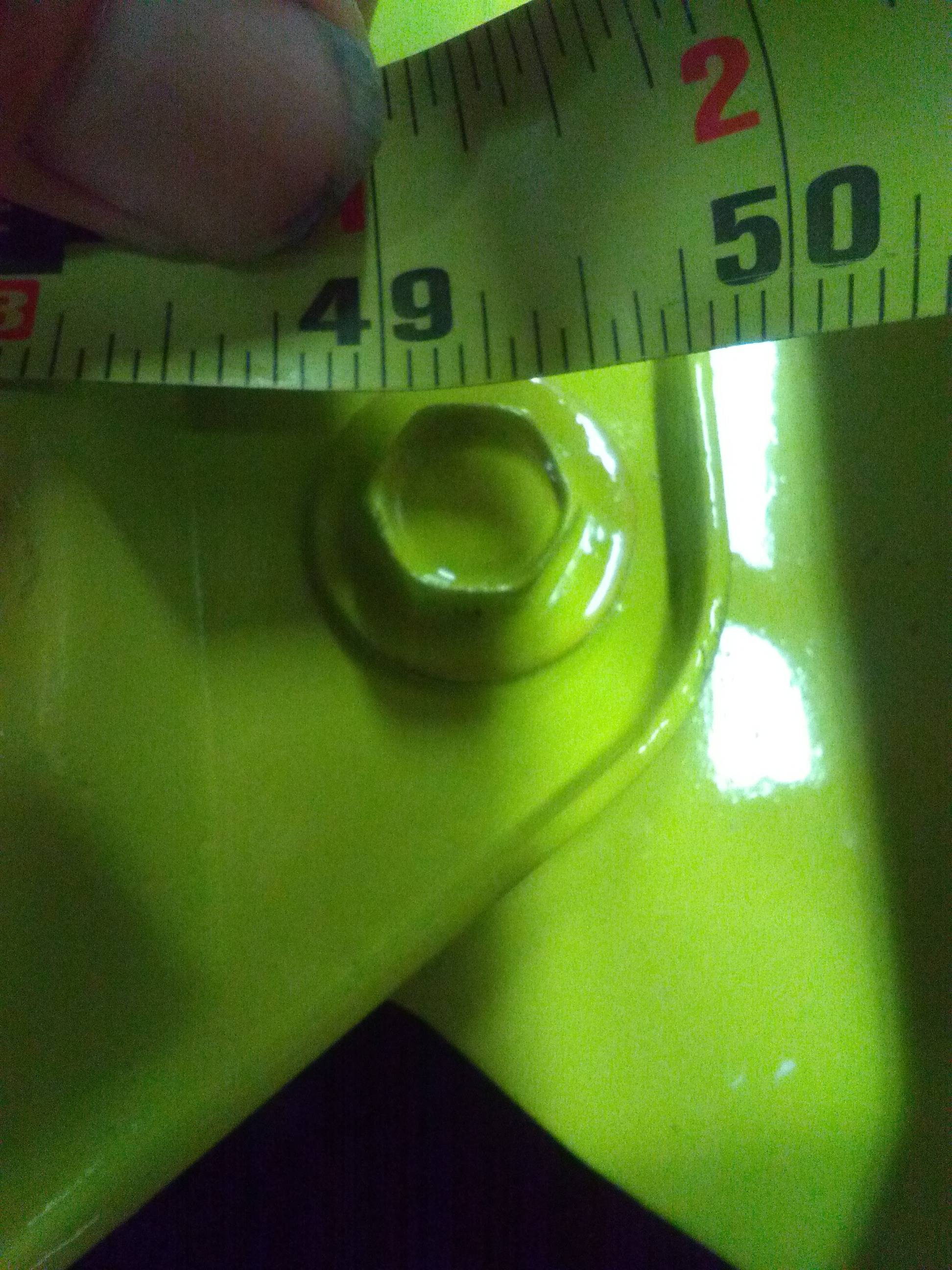

hope this helps first measurment is between the center most bolts second is between outter most bolts the other end of tape measure is at the center of the bolt head third is the bolts i measured

oh and the rad support flange looks like it goes on the outside of the inner fenders

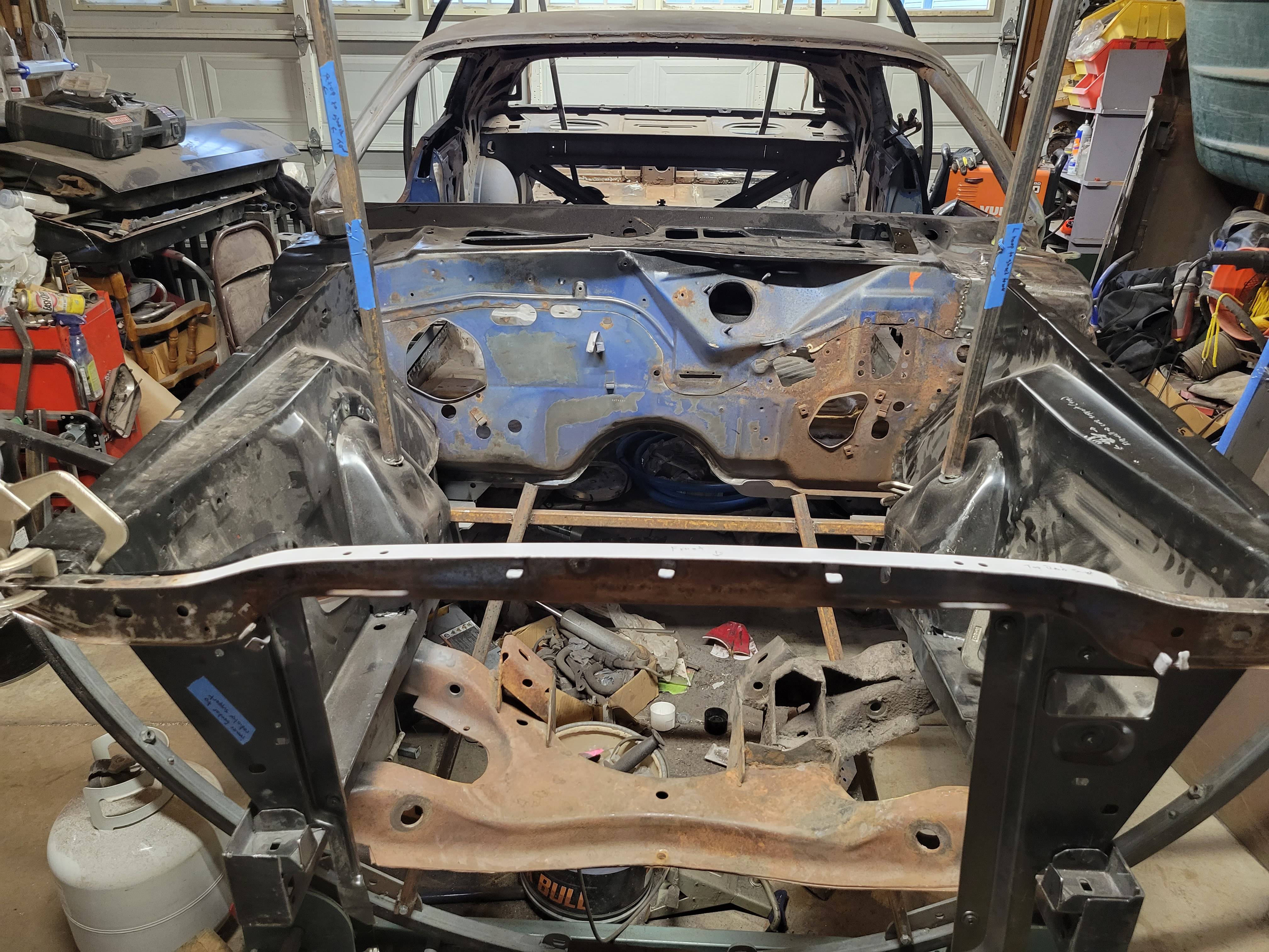

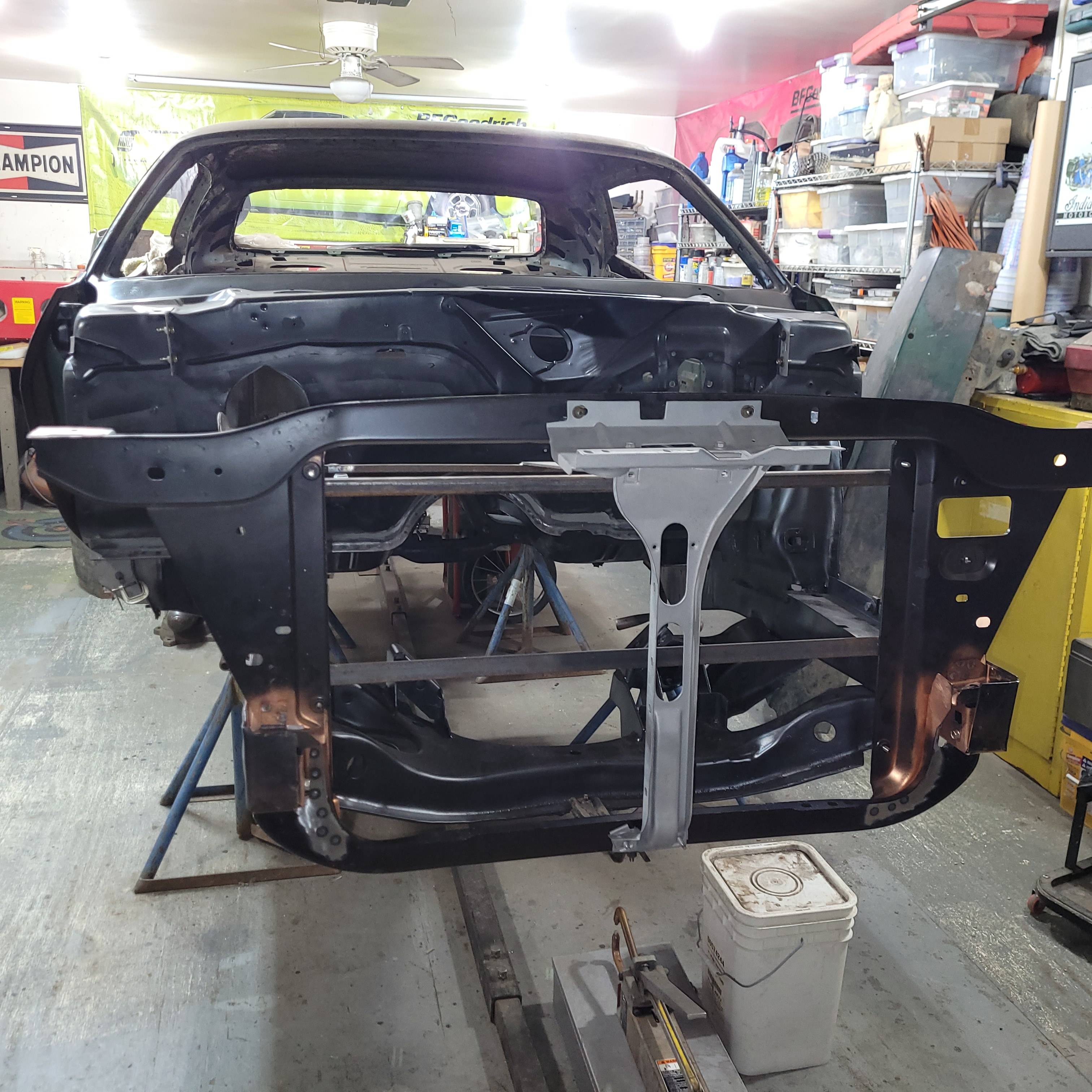

A picture speaks volumes. let us see what you have left. Are the firewall brackets still on the firewall? You can get 1,000 measuments from every one here.

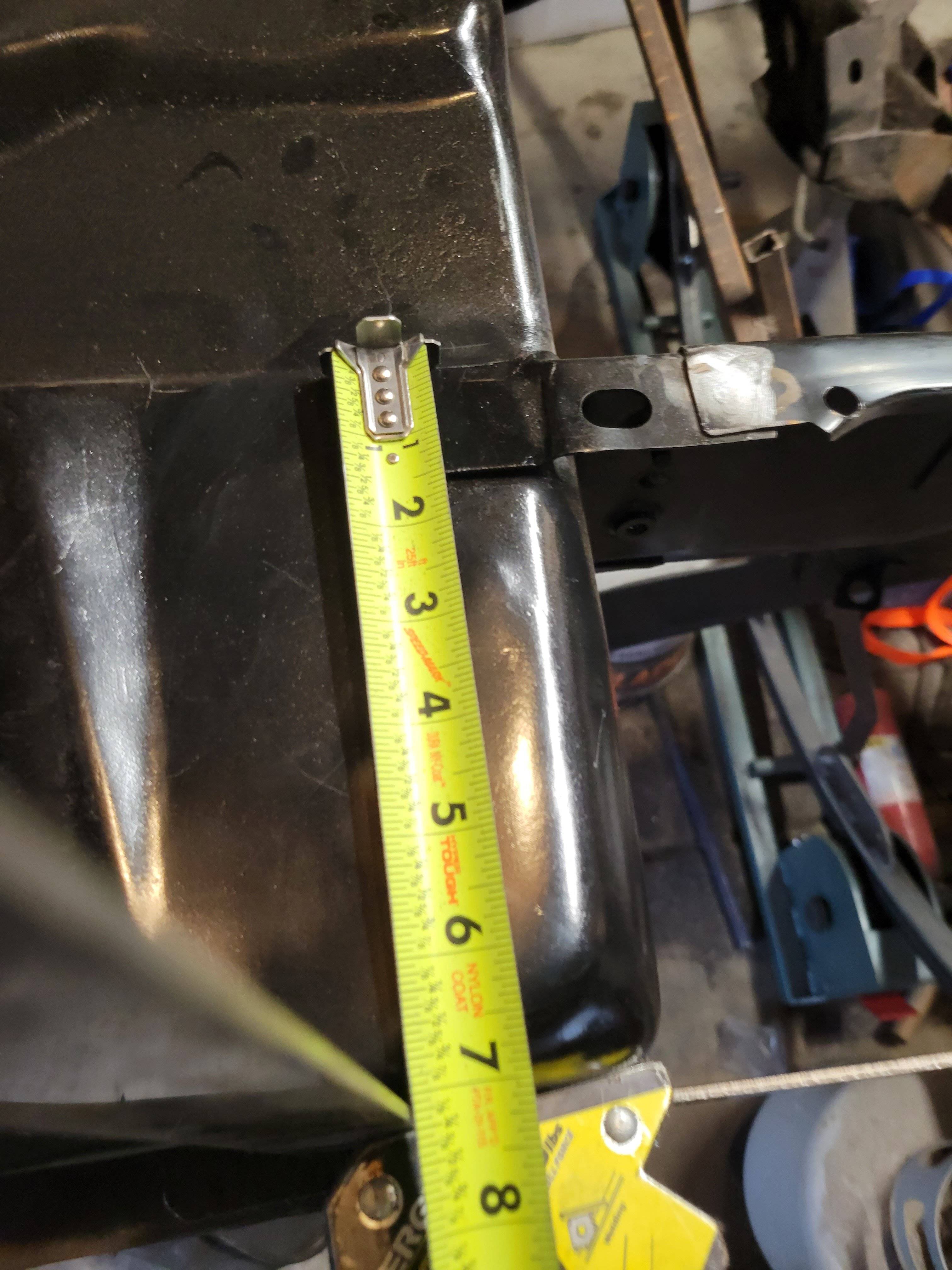

I have the passengers side cowl support on and the firewall bracket and inner fender tacked. Nothing on the drivers side yet. The upper cowl support measures 7 1/8" from the inside to a square against the side of the cowl.

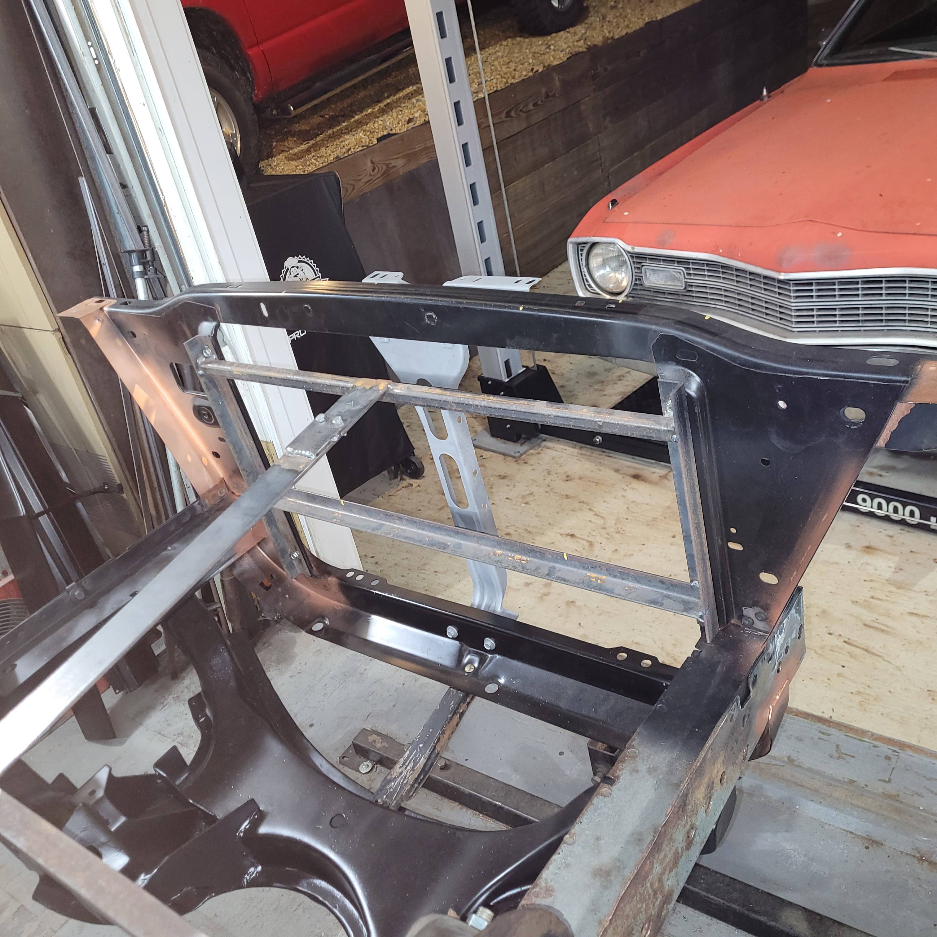

I was expecting a picture like this. Front laterals and shock supports on? I only see a sentence not the whole story.
Challenger RTA
Oct 28, 2018
3,354
1,777
PA Flood city
Ok got it. now I see the story. looks like you removed all firewall bracing, shock tower and put back. should be close enough. First thing shock support did you measure from shock hole to hole and set back to measurement? 34 1/2"? next find center of core support and mark,counter sink an 1/8" hole,it wont move. 26 5/16" to inside of fender at core support.I think have to check. With the firewall bracing in place even temporary,on the back shelf the is a hole. pull a mason string to core support mark to establish center line. establish center and mark on cowl.I drill a 1/8" hole.It will be covered. Then you know it's a good line. On the roof front and back there is a notch you can check for alignment. Then from cowl to rad support use it for center line. hood with is about 52 1/2" +1/4" for each side gap 53". the fenders come in over top a over the inner fenders little bit . so that is an approx aliment measurements. The objective is to have everything fit with in the parameters of the measurements. There are no Tram measurements that I have ever seen.To check for squareness do cross measurements on the inner fenders. there is good chance that you will see a difference,do to set back. that's built into the chassis. The inner fender have adjustment forward and back fender are side to side. As I believe someone said the 1/4s and the doors have to be set.Front rails in good alignment. From front of core support to firewall it's 48 1/8" following along the top inside of the inner fender. the 2 pictures there 3 measurement that are pulled from the rear shelf hole to the inner fender back edge of hole and one to the core support. AFTER YOU have good center line drop a plumb bob to the K frame hole with car level.remember the string is a 1/6" that's an1/8" off center. Think 3D.

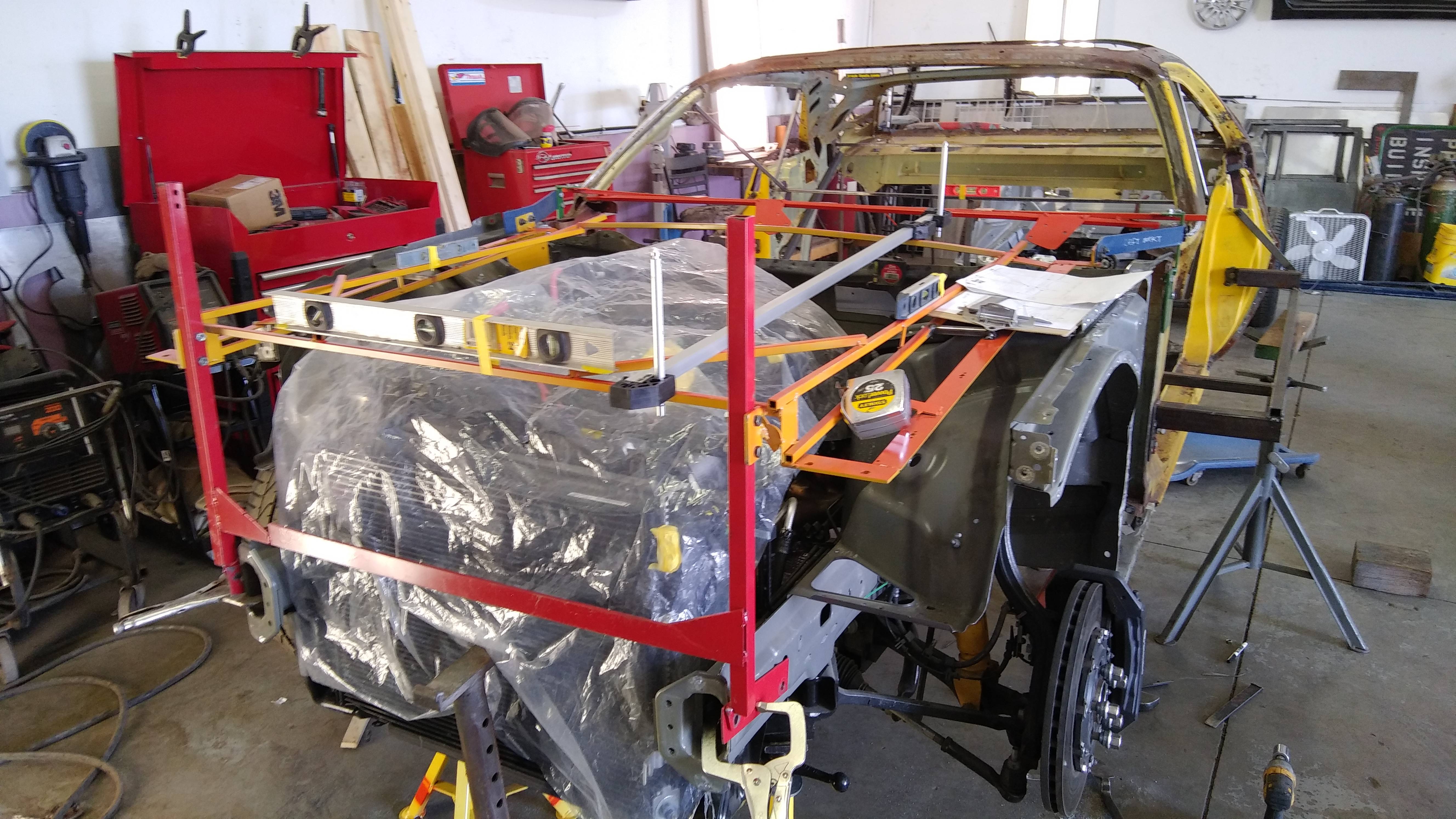

Rich Followell
Jul 12, 2020
139
89

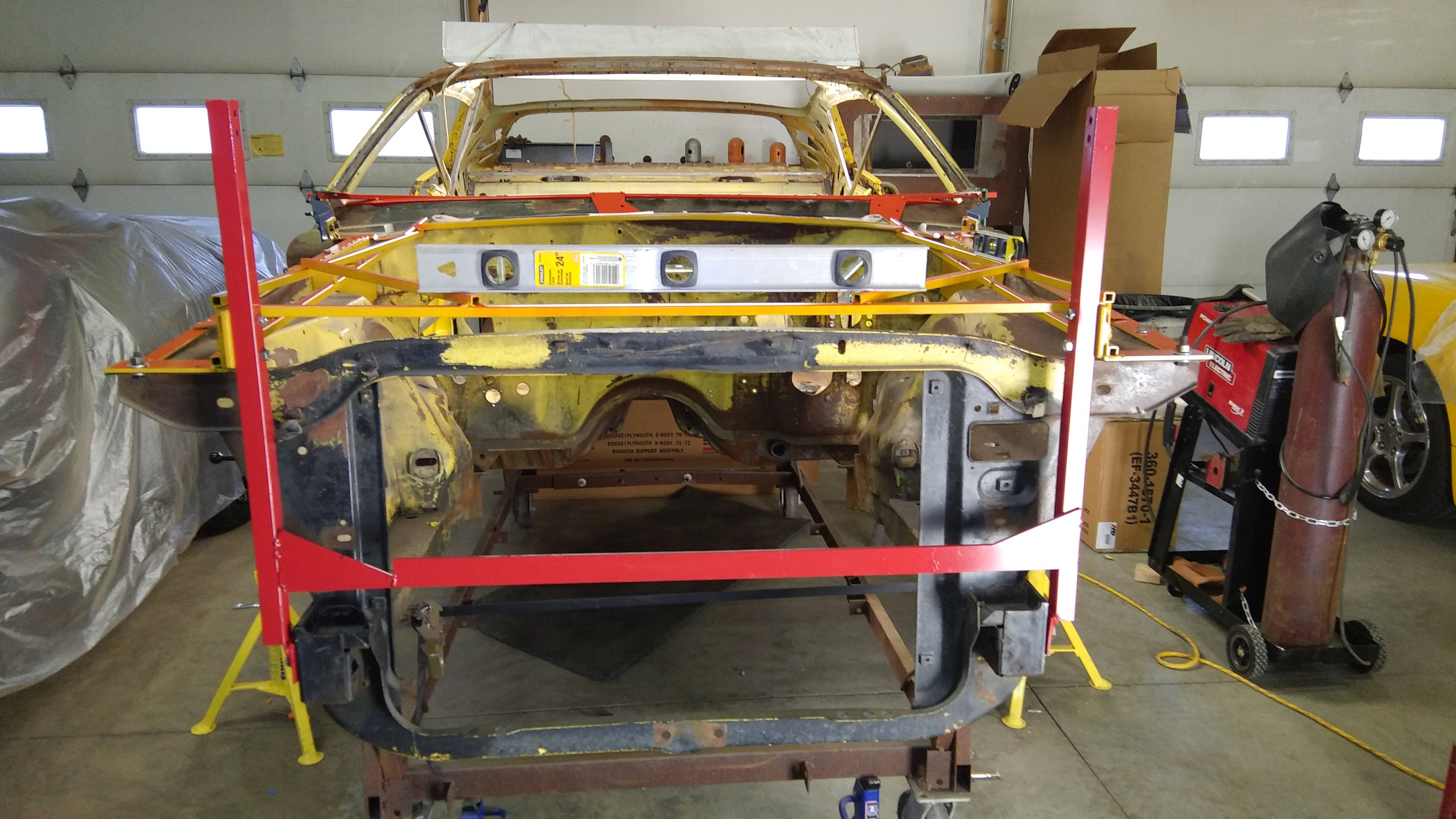

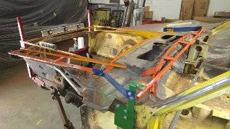

Where are you located? I built an alignment jig prior to disassembly based on a early production 70 Challenger. I no longer need it!

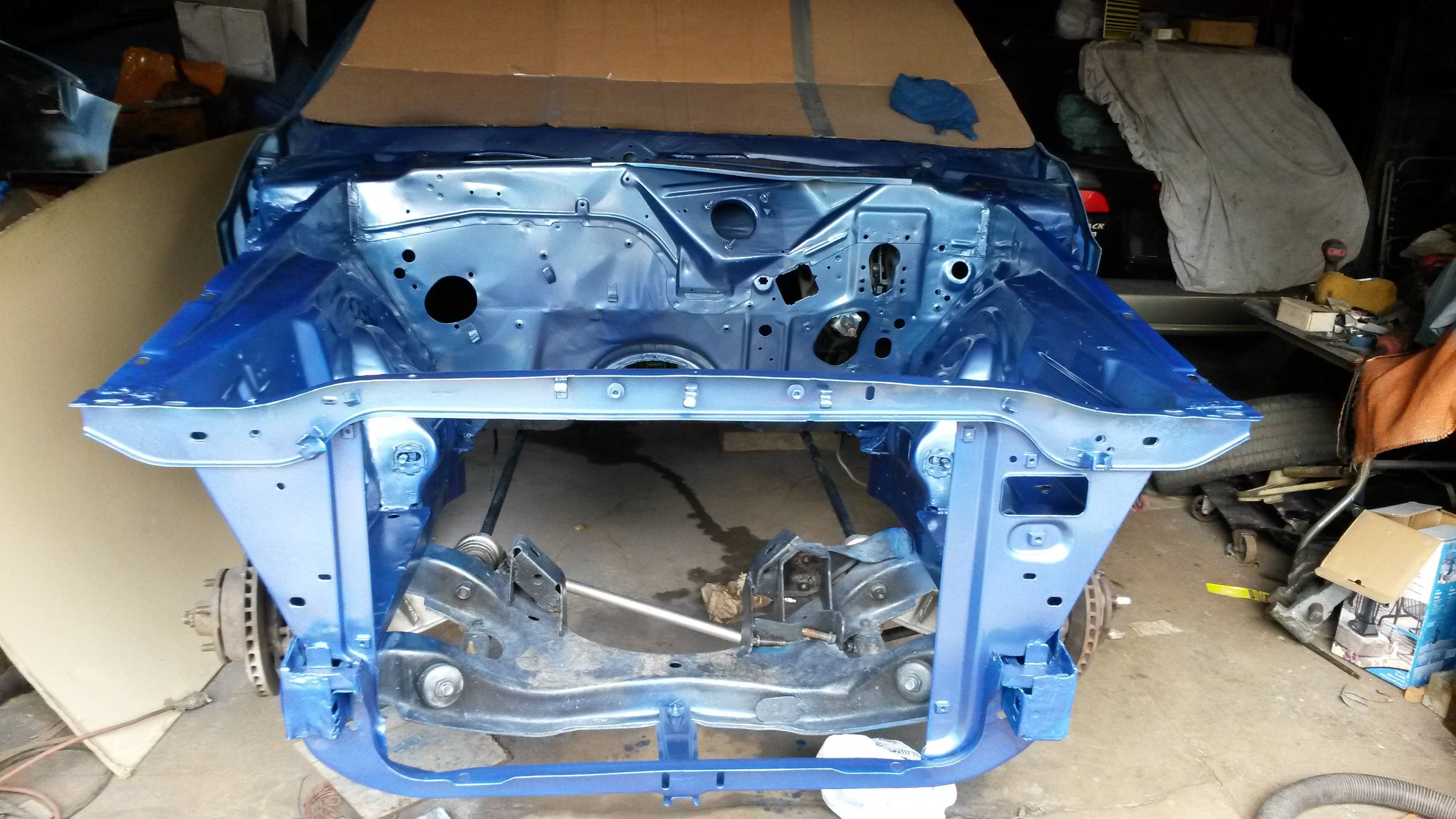

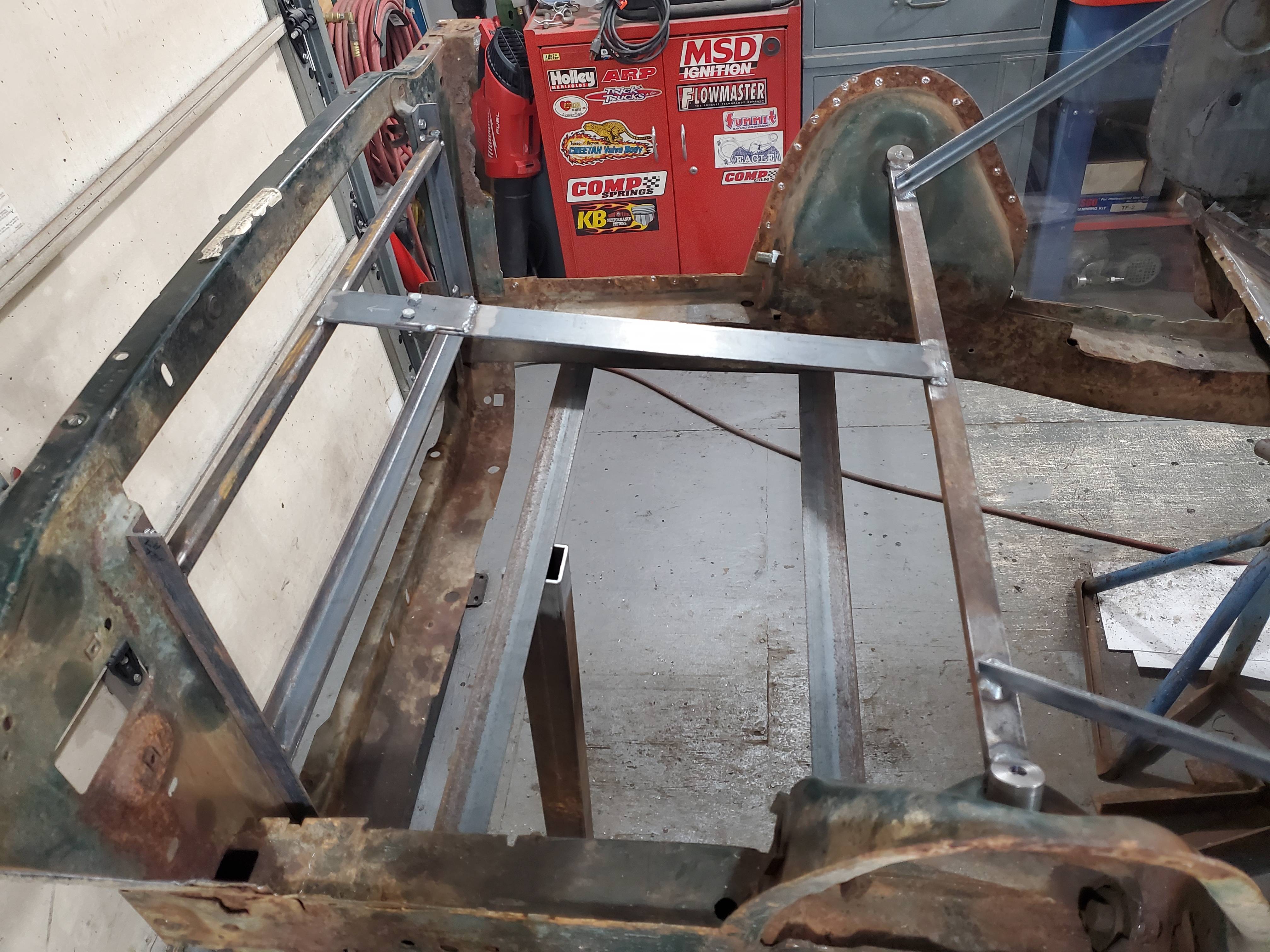

moparmike1974
Nov 12, 2018
66
12
Here's what I did. Made a jig to help line up everything. I machined bushings that fit snug in the shock towers to locate everything. I know it wont help your situation but maybe it will be useful to someone. First pic is before, others are after.
Starting on the inner fenders this weekend.
