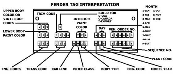

Is there any way to find out if my 72 Challenger is the early or late version. The door sticker was missing when I bought the car.
Thanks Gary
340challconvert
Feb 13, 2011
5,342
2,845
Parsippany, NJ
The date should be on the engine fender tag, 2nd line from bottom, right side of tag, next to the vehicle order number.
3 digits; month and day except; October uses A, November uses B and December uses C
