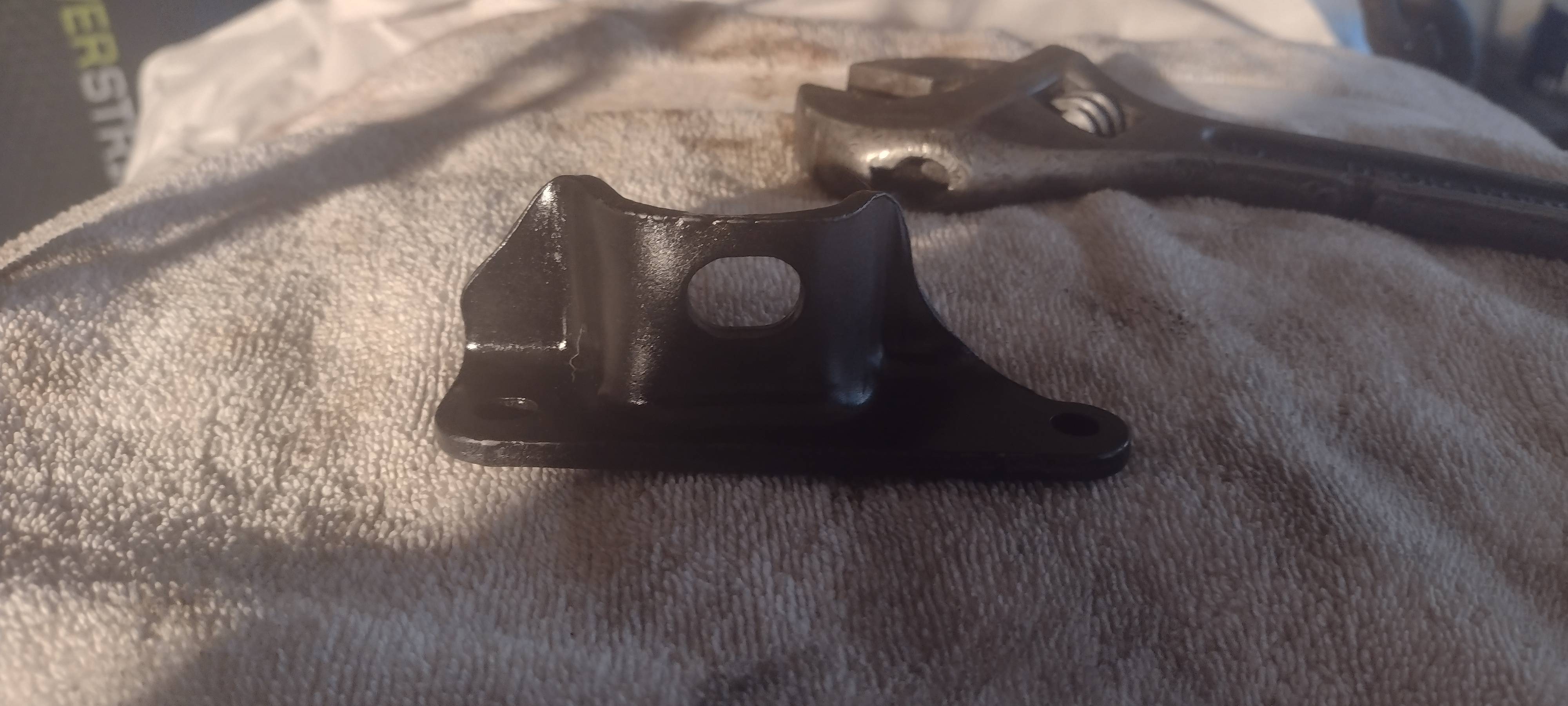

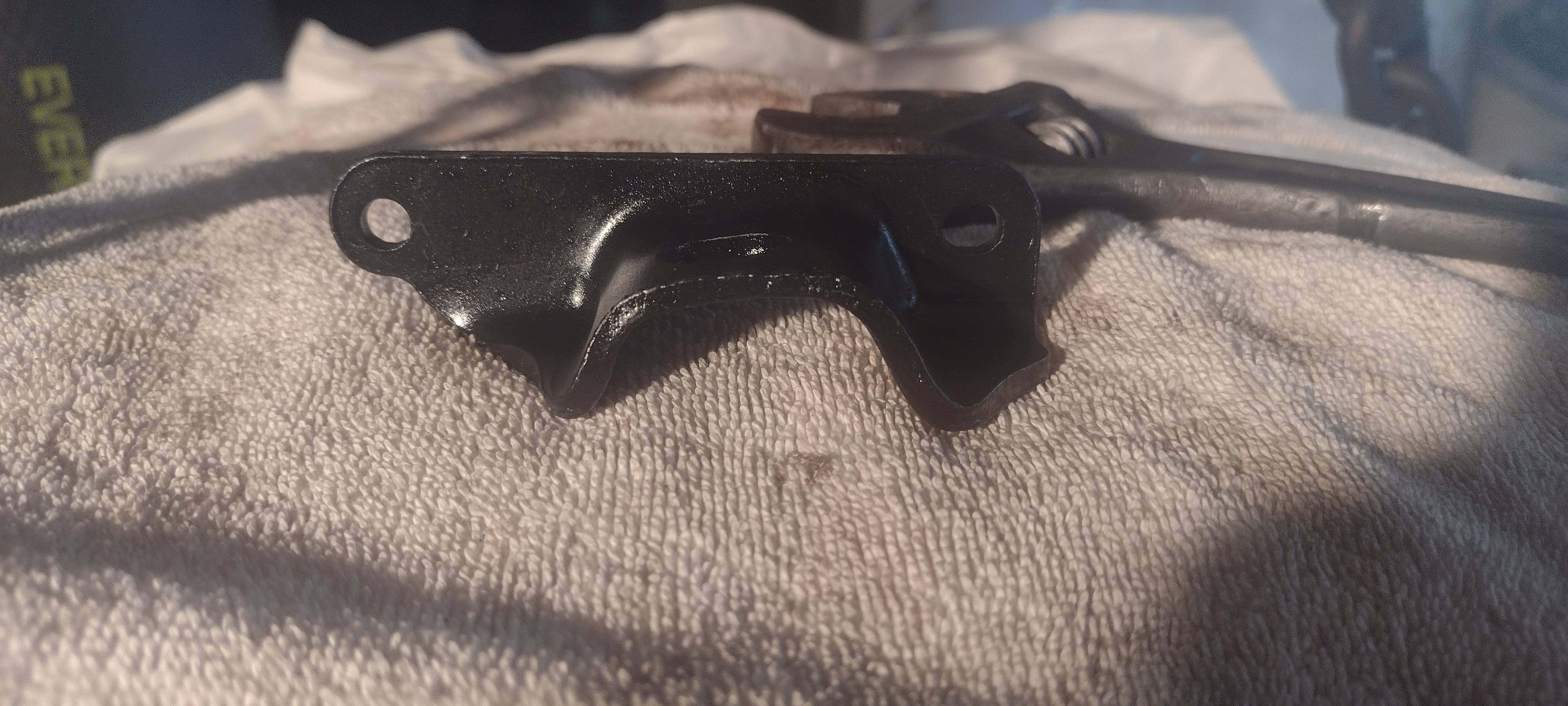

Hello fellow members,
I am going thru a box of parts and came across this bracket. Not sure where it belongs on the vehicle (Engine, Suspension, Chassis)....Does anyone recognize the bracket and know where it's supposed to go? Vehicle is a 70 Challenger 383 engine.
Thanks
