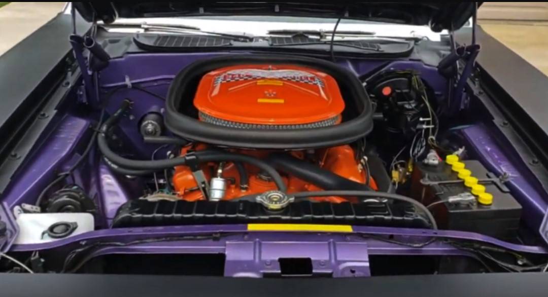

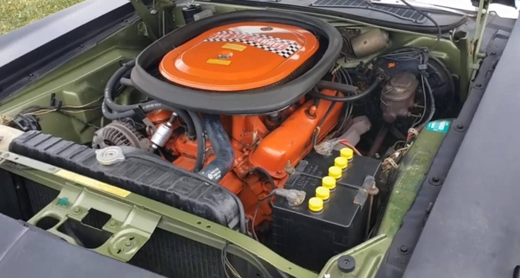

Pop up spring was never used on AAR or TA fiberglass hoods steel hood only
That is correct.
