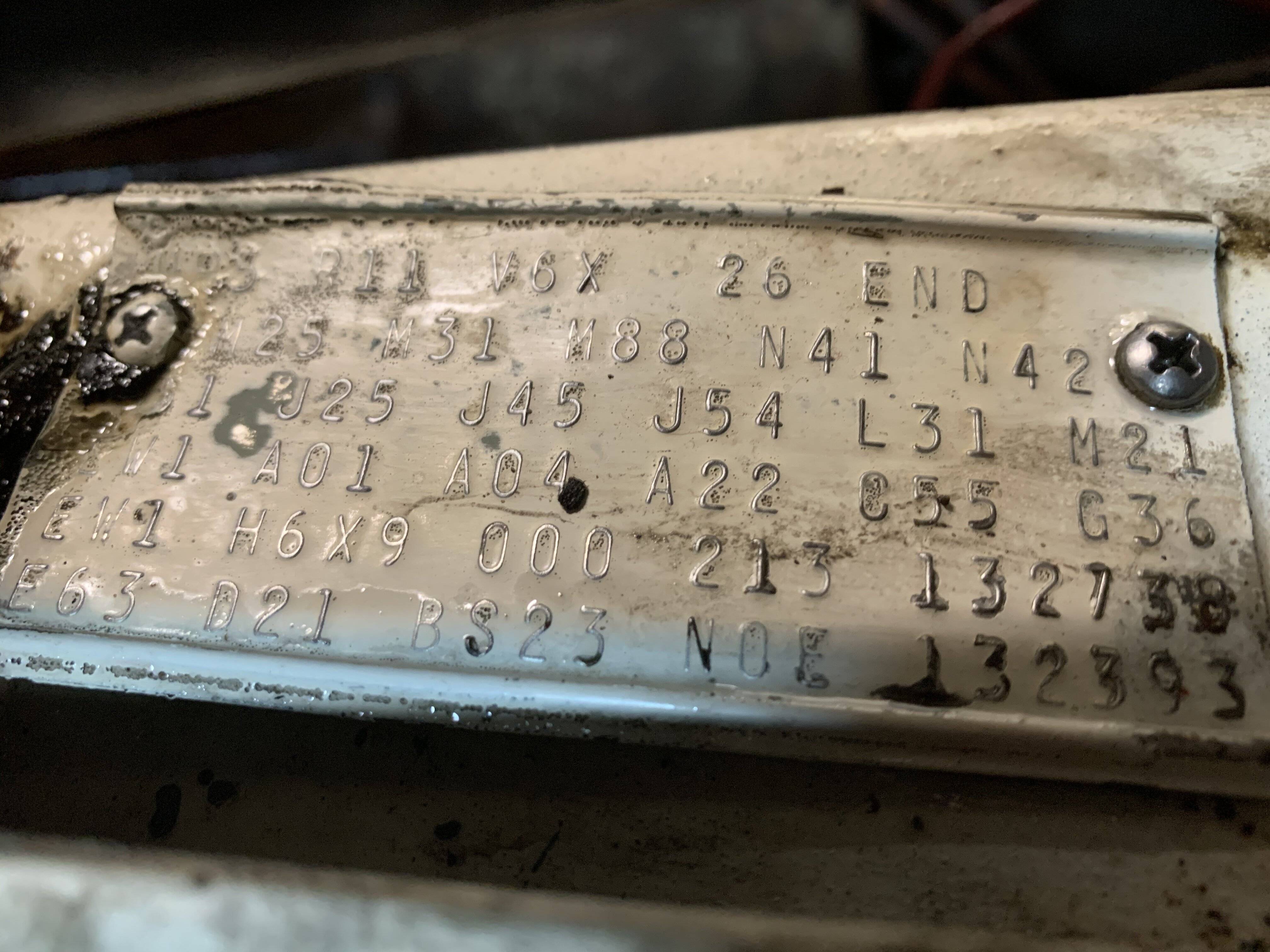

Fender tag.

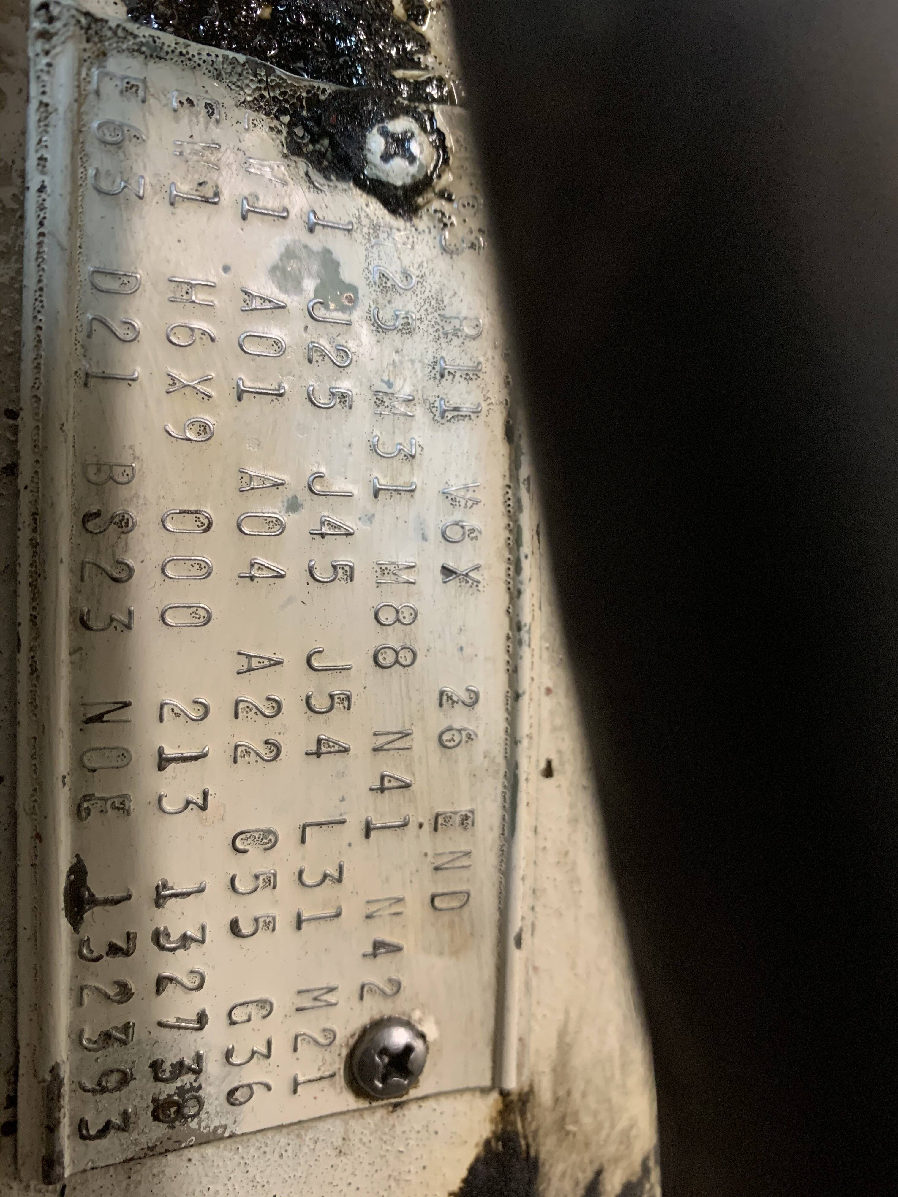

Wow! That is one nice fender tag! I can't quite read the two codes by the left screw. What are they?
that really has some cool options on it!
azfrench
Oct 5, 2020
39
16
Tucson
One is N95, CA emmisions, and the other is H51, AC with front heater.

Oh...and yes I had decoded it already. Everything on the tag is still there except for the side molding that came off.

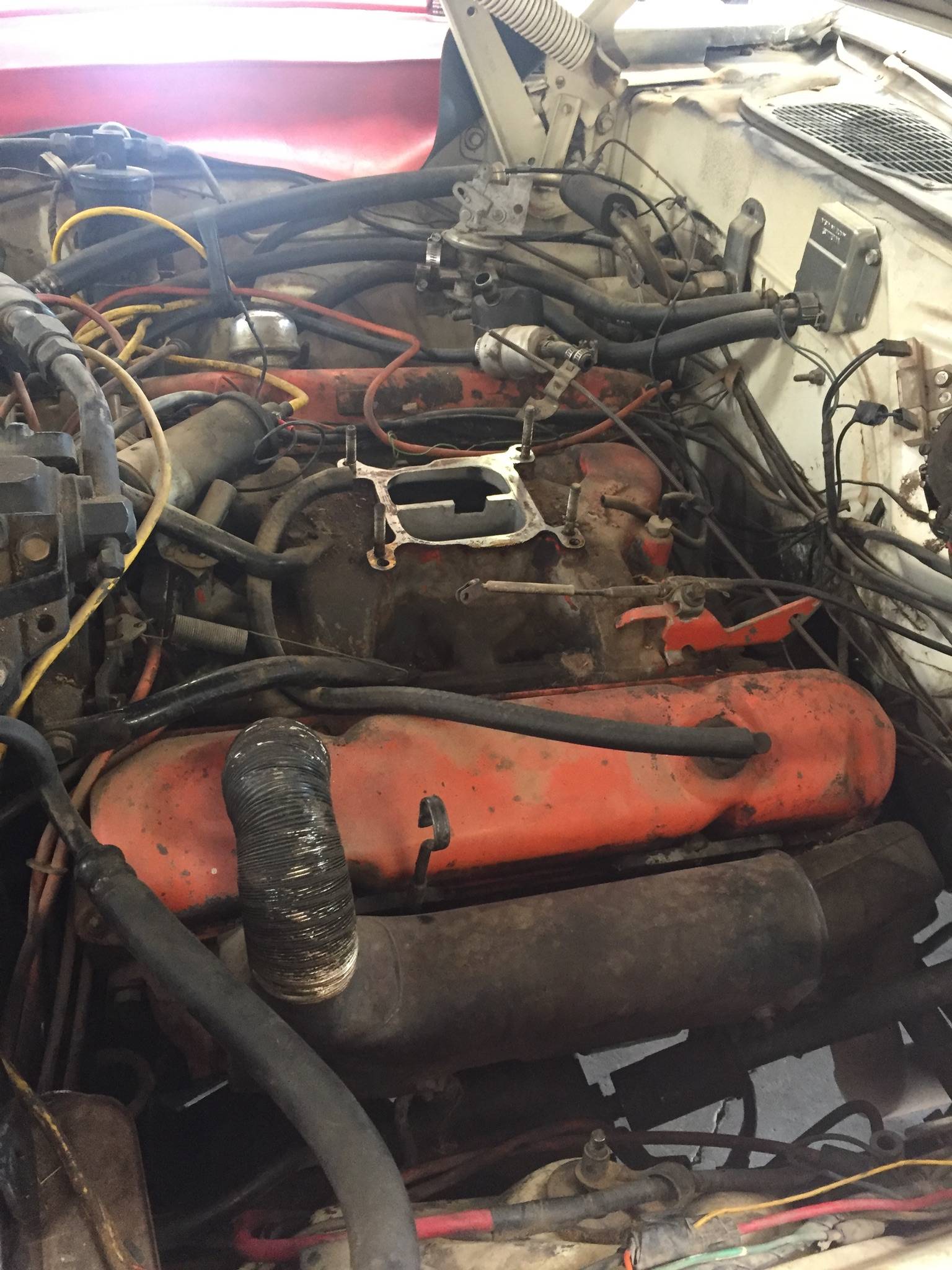

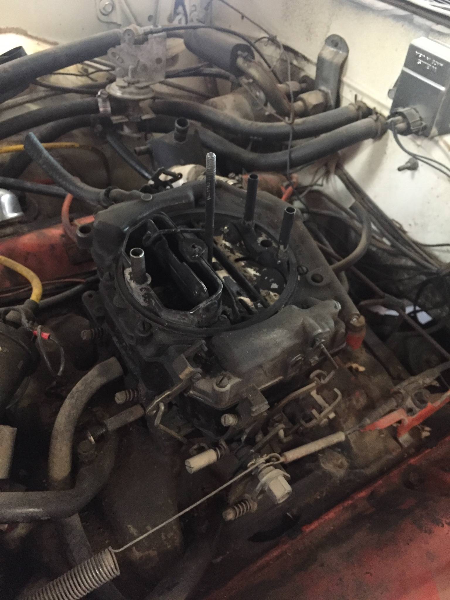

It might be the original carb but I don't think it is the original mainfold.

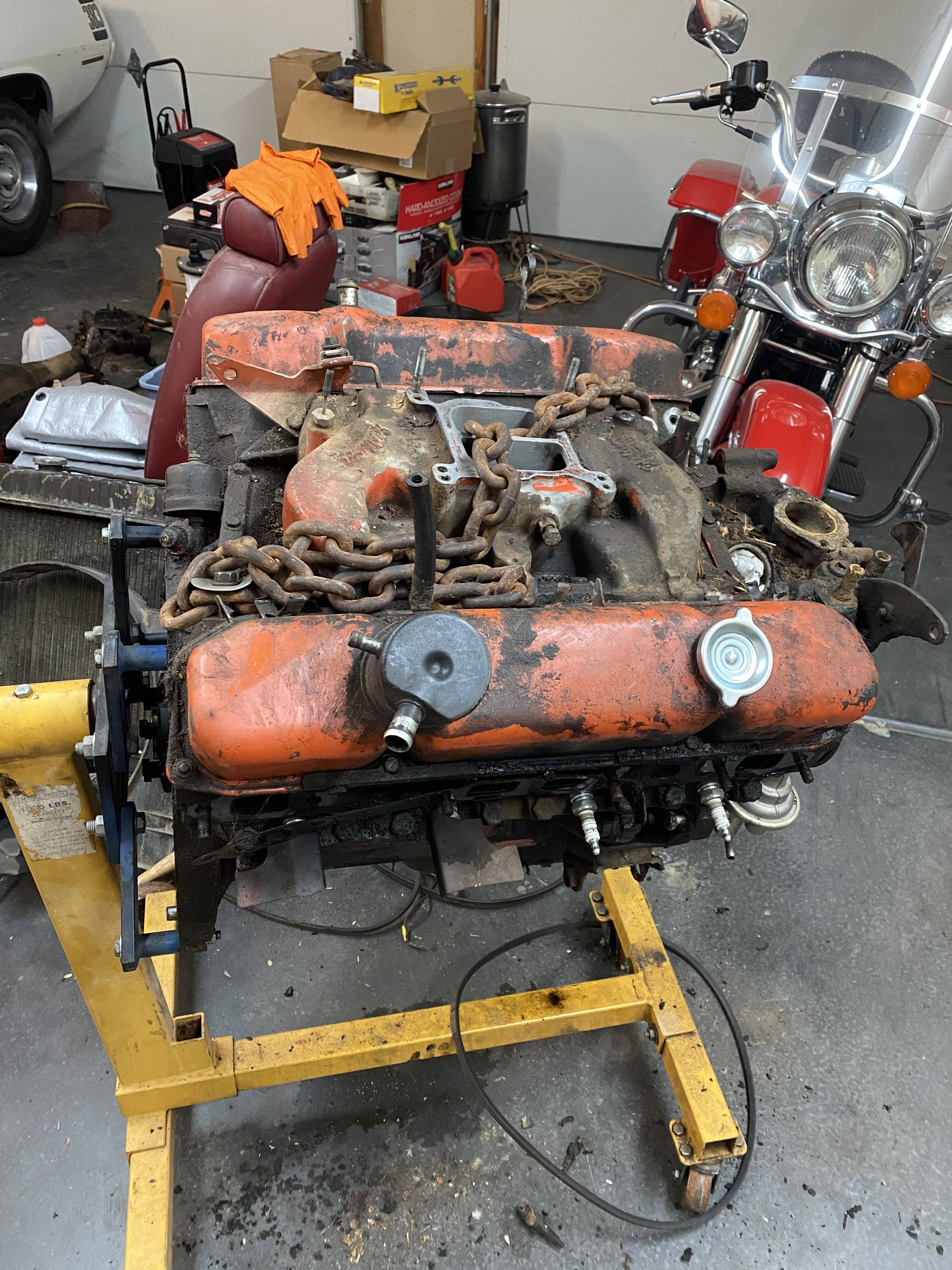

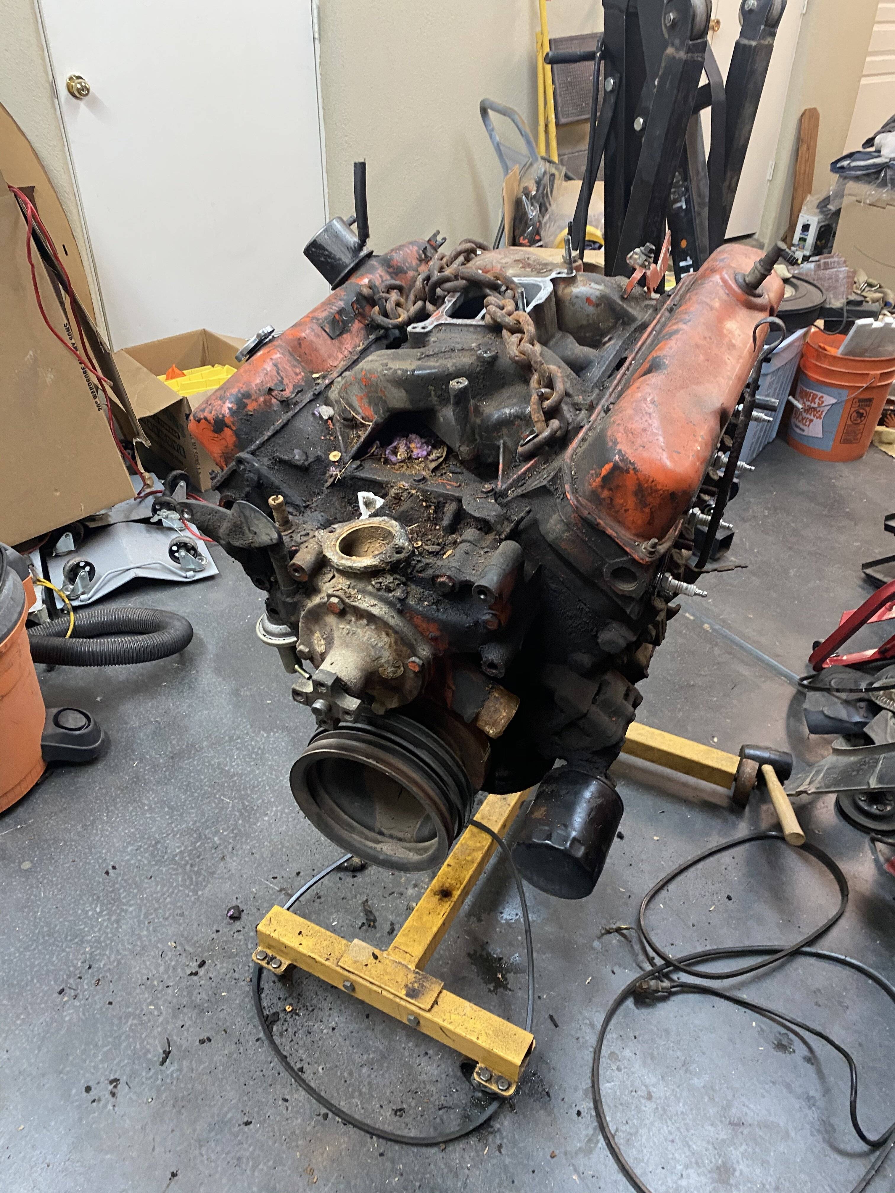

I ordered all the parts that I could think of at this time to get her back on the road. The motor is going to the machine shop tomorrow for an inspection and freshen up service. This will most likely be a rebuild due to the age and the miles on the car but it will be wonderful!
motor stripped and ready.
