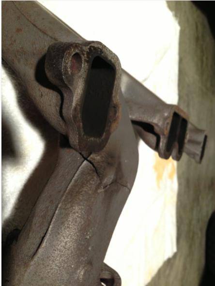

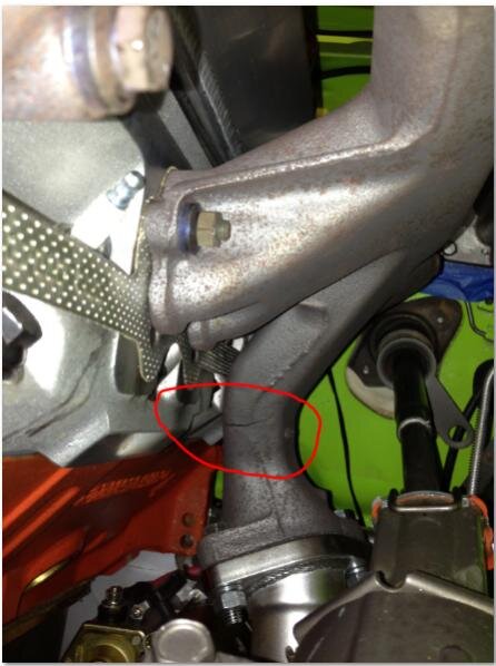

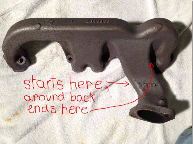

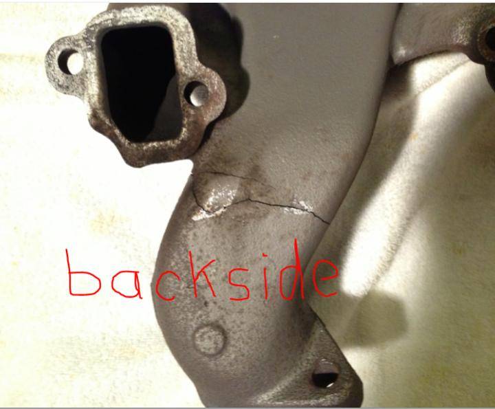

Got motor started and through the break-in period. Yea. Valve train noise appears to be gone, but difficult to hear over the exhaust leak noise. Found my drivers side, stock cast exhaust manifold is cracked. I think this happened during the break-in run. Dimensions of hte edelbrock rpm heads must the larger than stock, becuase the manifold comes in contact with the head near the mating surface of the head and block. Any way to repair cast iron?
These stock exh manifolds will only be used for 500 miles. Then I'll be putting my beautiful TTI polished headers on (note: I have a another post on this forum regarding avoiding running the TTI headers headers on a new motor for concerns of damaging the ceramic finish).
So, any repair to the stock cast exh manifolds only has to last 500 miles. A couple road trips stretched across a couple weekends should take care of that.

All aftermarket aluminum heads are different externally and most external bolt ons either won't fit or must be modified to fit.
Cast iron manifolds can be fixed by any competent welding shop.

crack is worst than I thought. See pic. Think it's salvagable?
