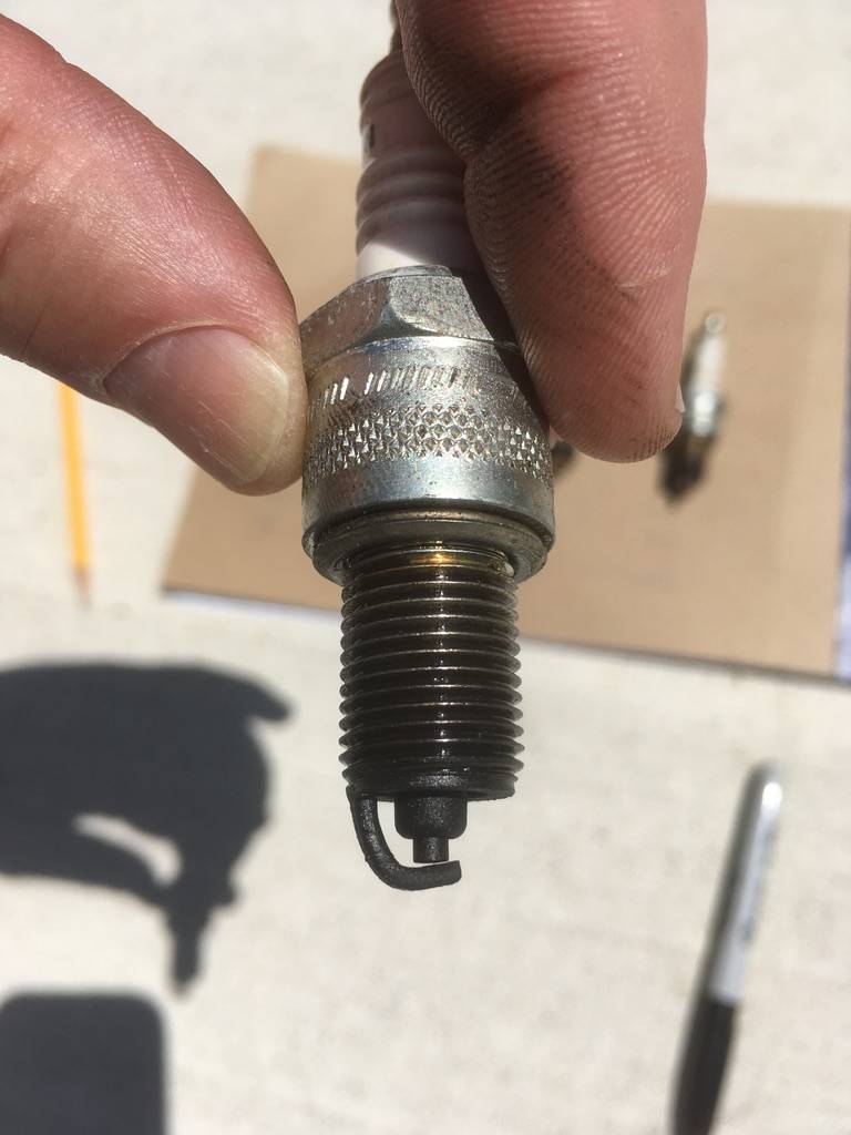

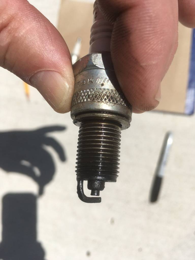

I pulled the plugs. 2 and 4 cylinders looked good. 6 and 8 were oil founded and electrode gaps were reduced to .012" and .001". Other plugs were .032.
Any suggestions on what caused this (ex. piston rings, valve guides leaking oil) combination. Could pistons have excess travel and be hitting plug electrodes?

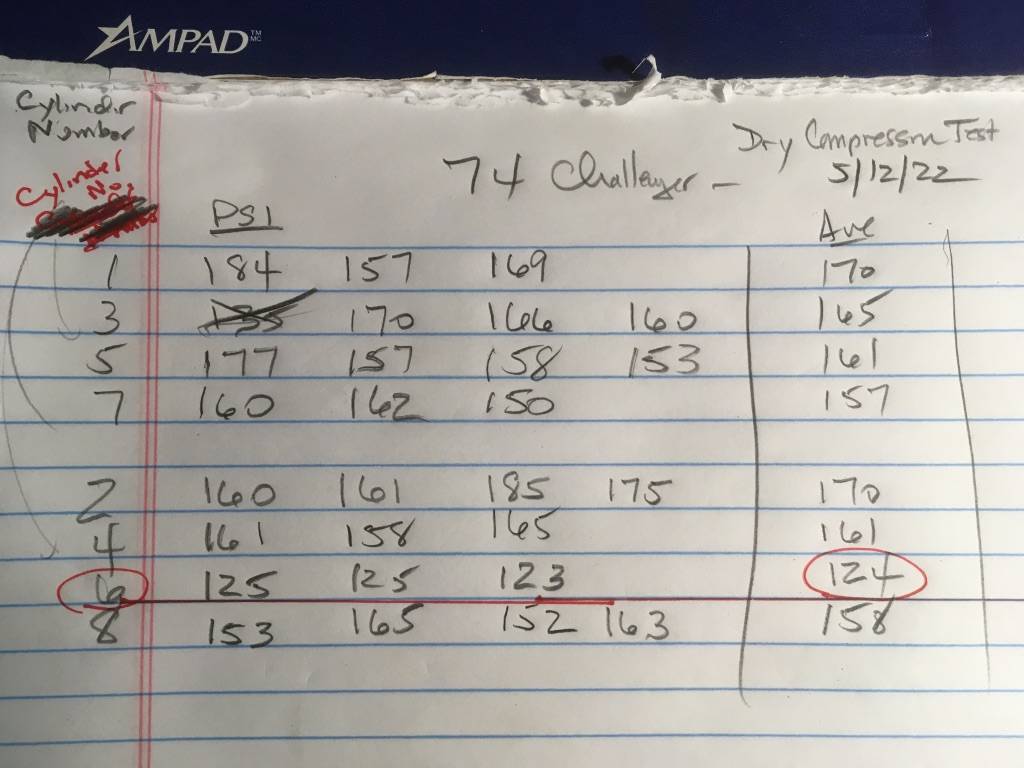

I would start with a compression test , & you can get a cheap camera to plug into a smart phone that will fit in the spark plug hole to take a look inside also .

Agree on the compression test, might have a busted ring(s).

Compression test showed no 6 cylinder averaged 124 psi, which was 33-45 psi lower than other cylinders.
Cylinders 6 and 8 had oil fouled plugs, especially 6, and both had bent spark plug electrodes.

plug from No 8 cylinder
plug from No 6 cylinder. gap reduced to .012 from .035
compression test results. No 6 cylinder is 33-45 psi lower than average for other cylinders.

Check for badly worn valve guides i ate up 1 in 2000 km really bad geometry could explain poor compression, burning oil & clipping the spark plug mainly on the inlet especially with a large intake valves take the rocker gear off & check the contact wear mark on the tip also the side to side movement towards the inlet & exhaust
