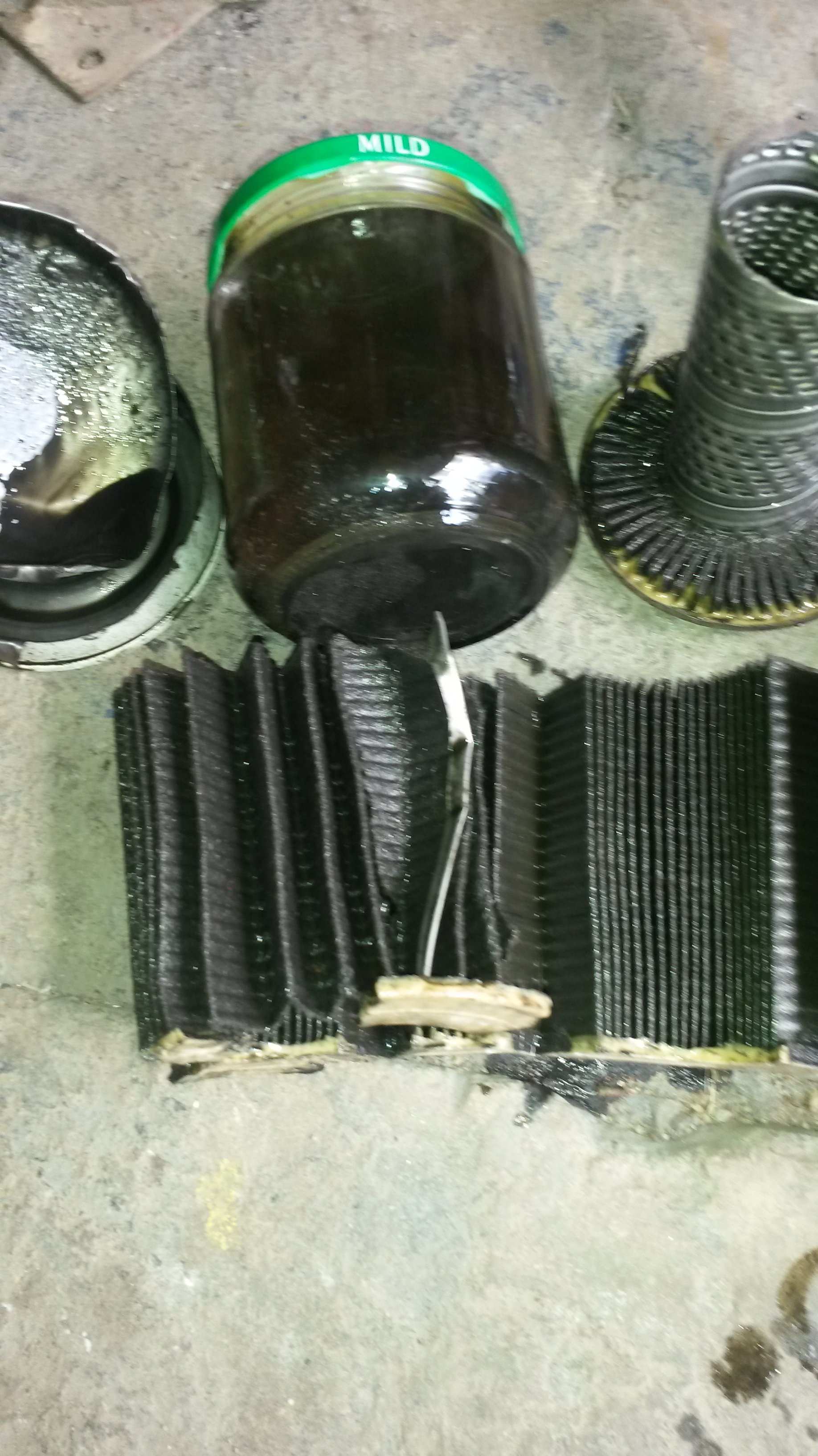

Change the filter right after break in and cut it open.
