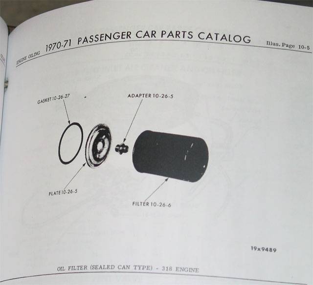

shop that did the engine work, removed the oil filter to block assembly. went through 3 different oil filter to block plates held in place by threaded bung[ 3/4 inch nipple] . went through 3 different adapter plates to block. the last one did not leak when just rolling over the motor. over. when started it leaked. is there a gasket that is incorporated with the adapter plate and bung/nipple.

The adapter plate uses a gasket around the outer edge as shown in the following image:

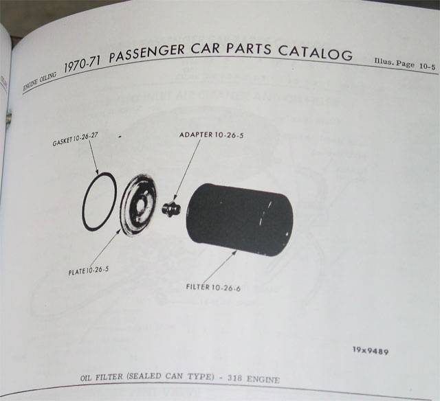

shop that did block work removed the plate and adapter....did not know this until engine assembly..sued a 3/4" pipe nipple to replace adapter... have a plate, must be wrong...got any idea where I can fin those 2 parts???? 318 engine..
It's likely available at several sources for the parts, but one good place for the plate, fitting, and gasket is Mancini Racing:
Mancini Racing #2402105 Oil Filter Adapter Kit
This fits the 318 and other LA small blocks, but not the later Magnum engines.
A standard pipe nipple will not push the plate against the block machined areas to form a seal. The correct adapter fitting has a flange in the middle to press the plate against the block.

Had the same problem when I got my engine rebuilt. The 3rd try got it done, after losing 60 dollars of oil. Had to use gasket sealer on the gasket.
