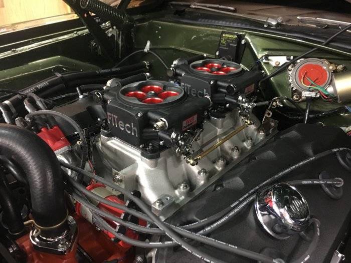

It looks good. I am following your build with great interest, especially the EFI install.
Thanks, I will try to keep this thread updated. I will be pulling the 360 powertrain from the Scamp soon, I just need a little spending cash to buy the EFI carb. once it is running I will concentrate on the interior then paint.

My cousin Norm just put a FiTech EFI system on the Barton Hemi in his '70 Challenger. He told me it was one of the best mods he has made. It is an animal and super reliable...

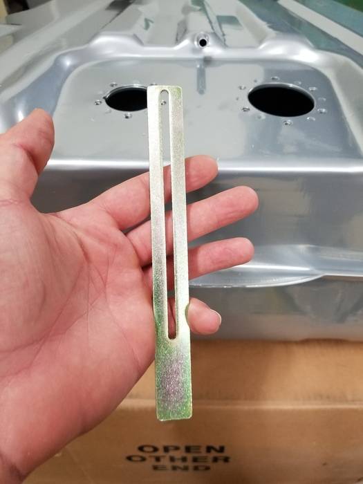

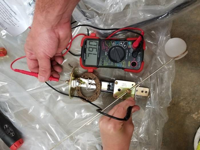

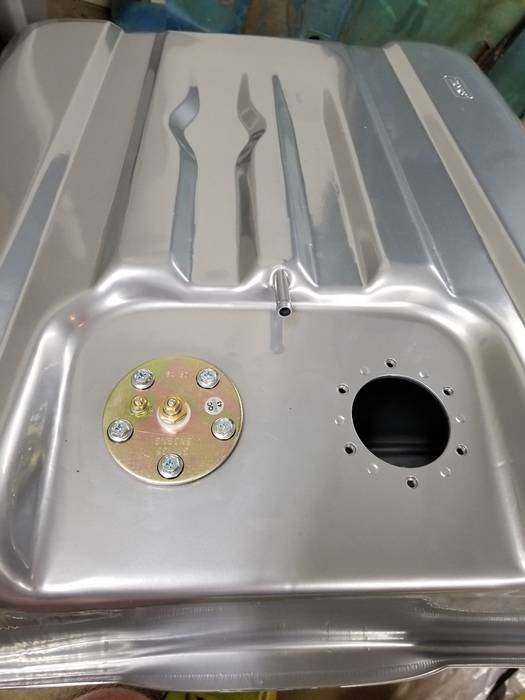

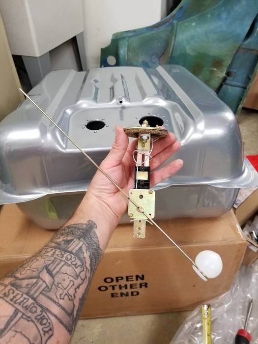

Ok so tonight I tackled the fuel sending unit install, directions are a little confusing but I'll do my best to describe it here.
1st take out the 4 bolts holding the upper and lower portions and remove the lower metal bar.
Next measure the tank depth and devide by 2 then add 1/8" for the gasket. Make the center of the pivot on the reostat to the bottom of the gasket that measurement.
Then install the float rod to where the top of the float is equal to the bottom of the gasket.
(Here is a handy tip, The directions say to then cut the rod to length amd cut off the two ears on the bottom of the reostat. However with a pair of dikes you can snip off the remainder of the arm and bend the ears back and forth until theu break off without putting amy stress on the reostat. This will minimize metal shavings associated with a cutoff disc.)
Next I tested it with an ohm meter as per the directions. My son helped with the pictures since he happened to walk in the garage to tell me we were about to finish the Karate kid 2. He is 9 and I hope some of this runs off on him. ;)
Last but not least. Pay attention to the bolt hole setup as it will only install 1 way. The holes are not evenly spaced. This had me scratching my head for a bit.

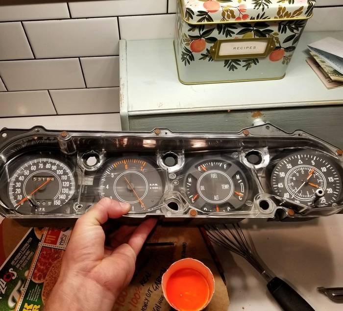

Got the front part of the cage cut out so I could actually remove the dash and instruments. Cleaned up the guage cluster some and highlighted the faded redline numbers. Keep in mind this is not a concours restoration.

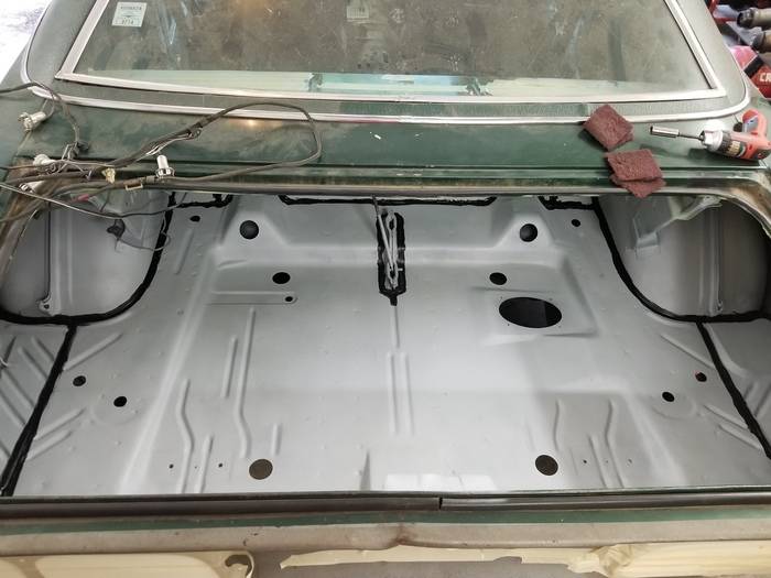

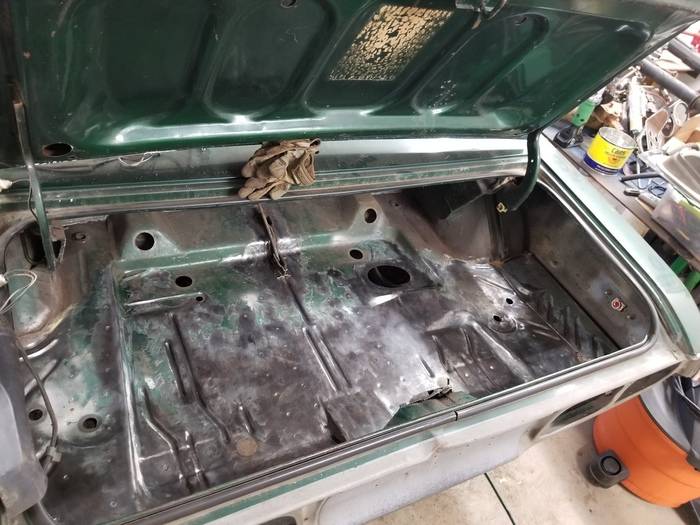

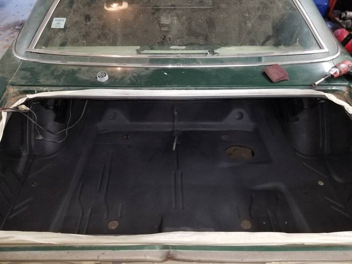

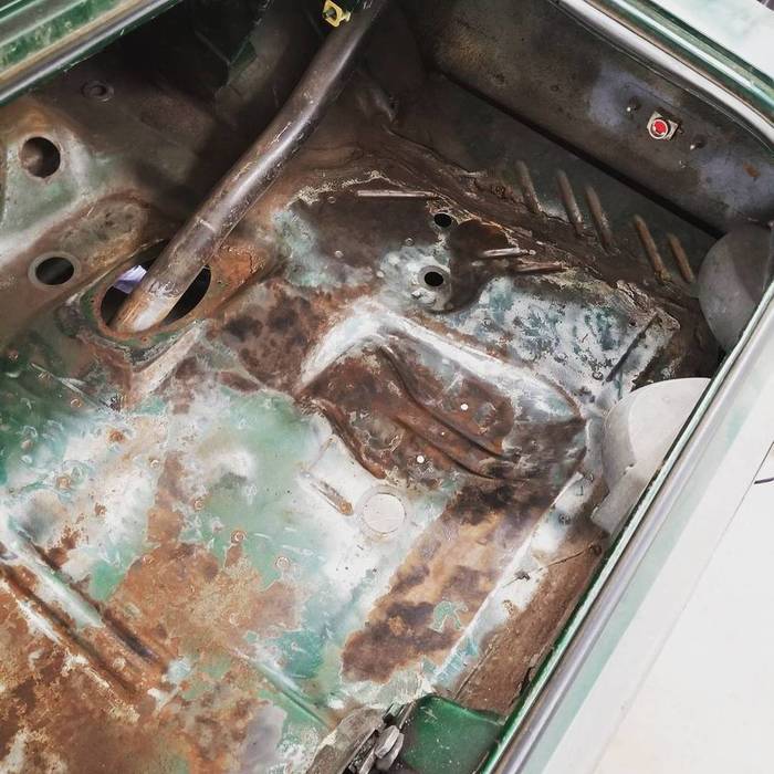

Well Over the past couple of weeks I have been working on the trunk. I decided to clean it up before I installed the EFI tank. There was some surface rust underneath the trunk pan above the gas tank. I treated it with Eastwood Rust treatment that is supposed to turn rust into a paintable surface. I then undercoated it.
Then I went on to the trunk itself. Many hours with a wire wheel and I got to here.
20170522_193958_zpst7eqddrg.jpg[/URL
Then hit it with self etching primer and new seam sealer
20170529_185511_zpsuojvnzi6.jpg[/URL
Then finished it off with Duplicolor Bed liner in a can
20170529_203210_zpseq7znuip.jpg[/URL
I have spent more time inside this Dang trunk then I ever thought I would.
