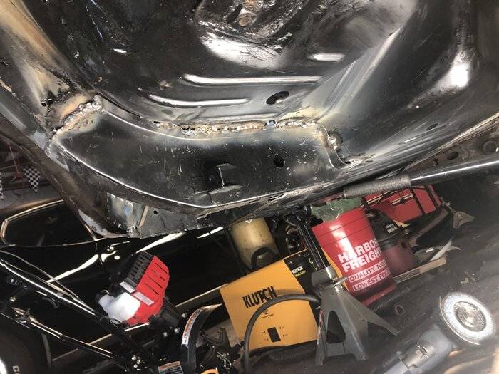

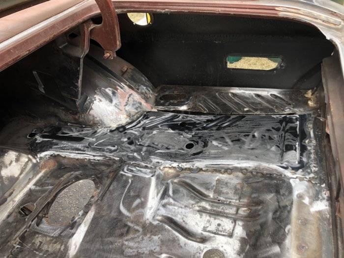

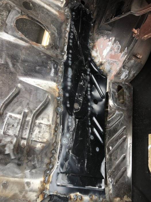

Got the rear right frame rail in today. It is really like surgery. I had to cut the lip on the rear valence to fit the new frame piece in. I had just restored that last weekend. I also cut the floor piece I ordered up from AMD to fit in over the frame rail. Nothing like a little social distancing - except with my MOPAR! - TJ

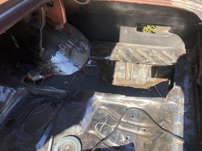

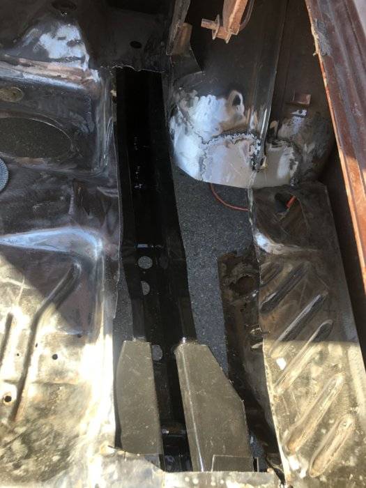

Finished off the installation of sheet metal in the right rear trunk. New frame rail, and trunk floor rear right. Need a narrow grinding tool to get into the tight spots to smooth out the welds underneath where the frame rail meets the new floor. I added a thin coat of Bondo to smooth out the weld seams. Will grind most of that off then move to finishes like POR 15 and trunk paint finish.....

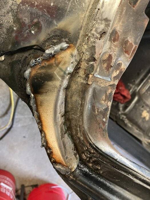

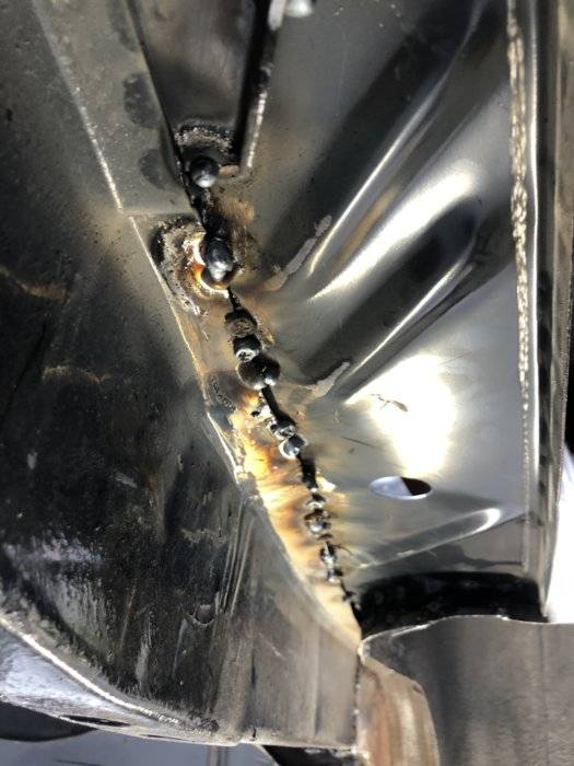

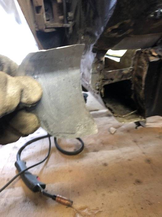

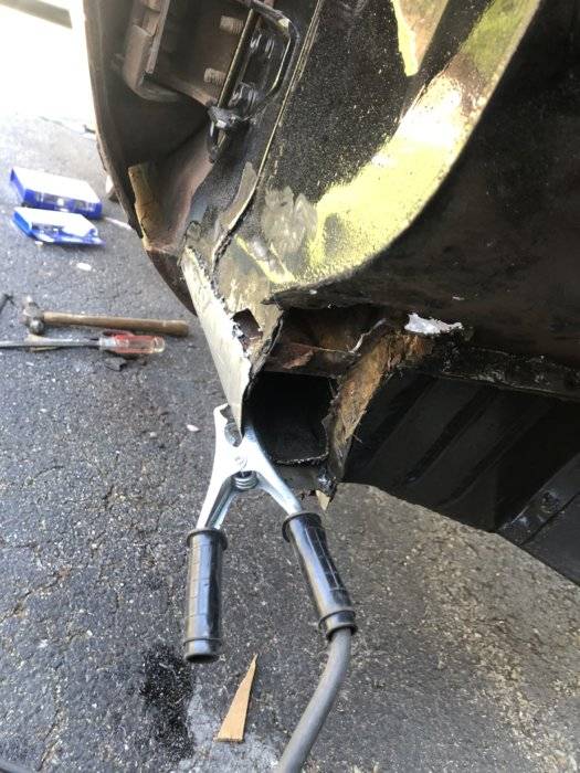

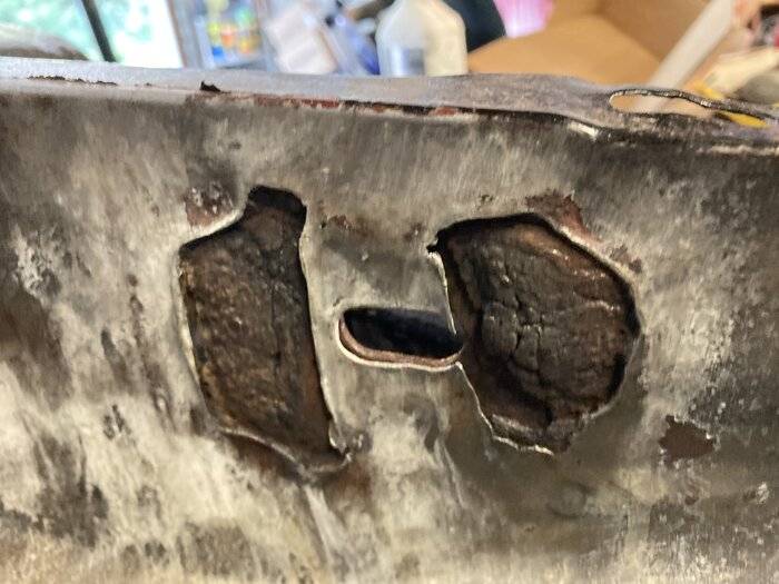

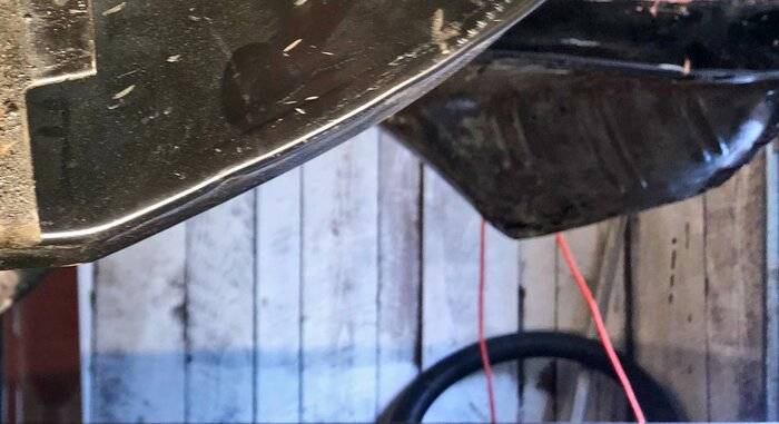

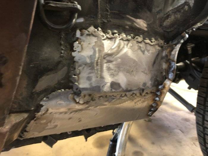

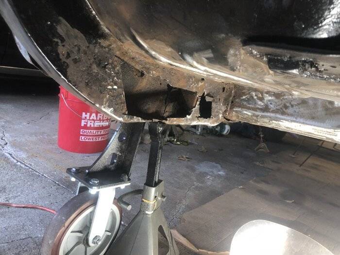

Proud of this work.....recreated the passenger front rocker with 3 pieces of sheet metal molded to shape!
Todd Jackson
Nov 5, 2019
138
66

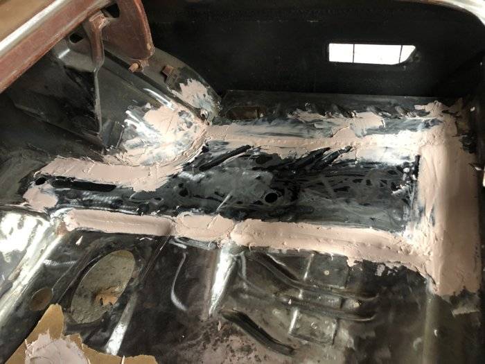

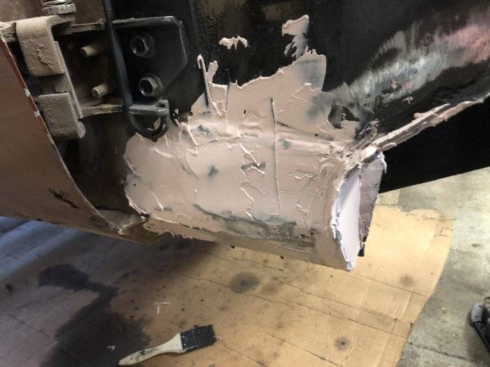

Used a skim coat of Bondo to smooth out the welds.....POR 15 over it all....
Todd Jackson
Nov 5, 2019
138
66

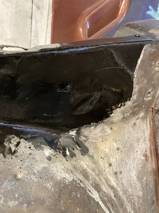

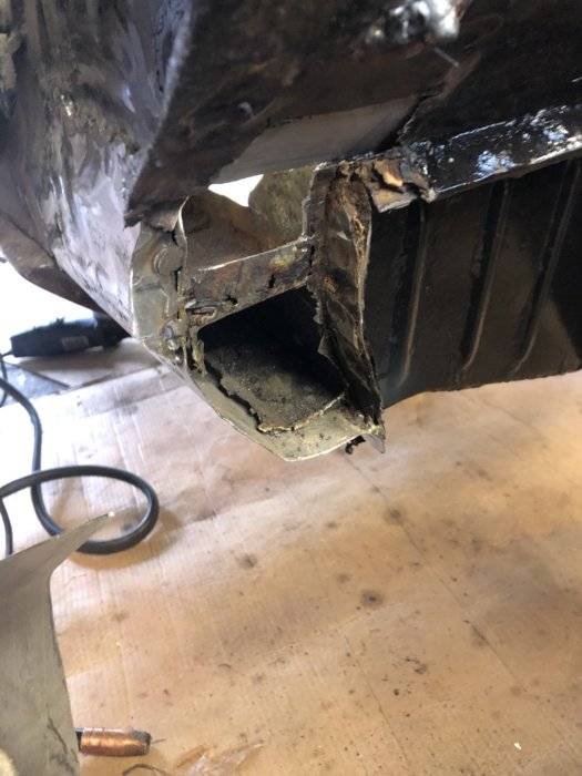

Labor of love....I have major surgery on the rear LEFT
frame rail. Front end of it. That's after a few other things ahead of it.
I got the driver's side Rocker 80% done today. Should finish it off this week. That one was much easier after doing the other side. I LOVE welding where no one will ever see! LOL Any of the body work that will be seen will be done by a pro shop. I am doing all the structural stuff.....

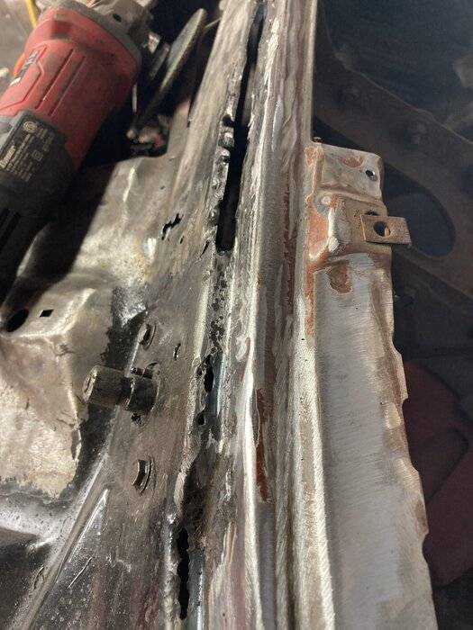

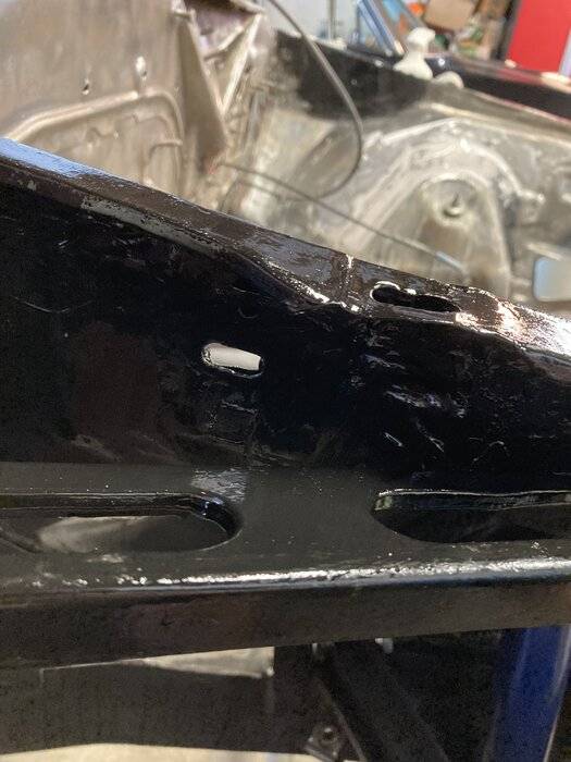

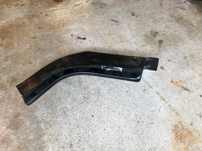

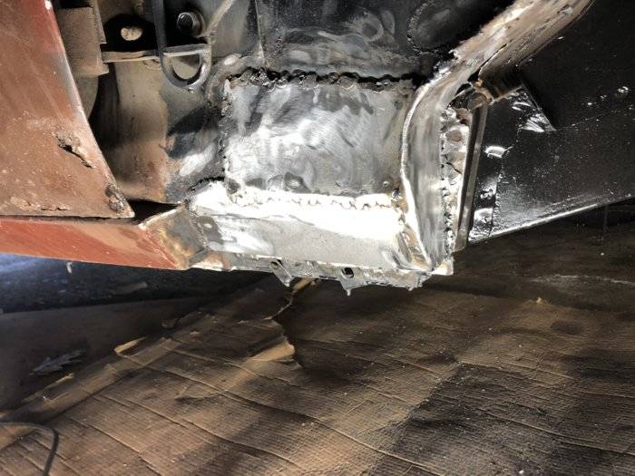

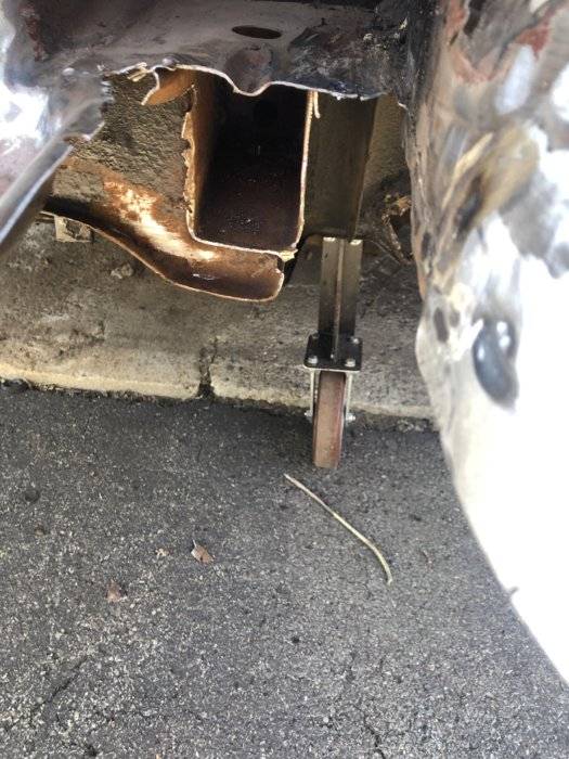

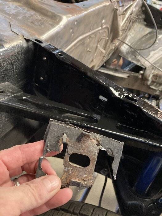

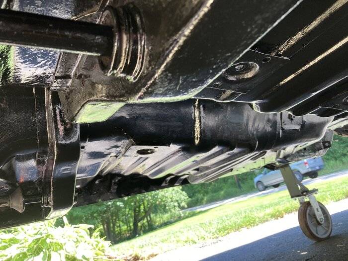

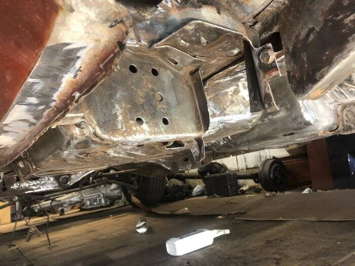

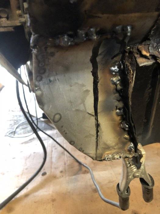

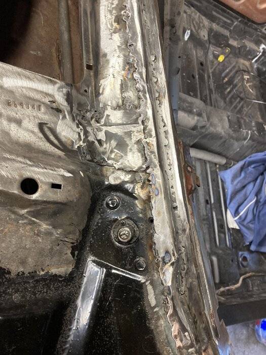

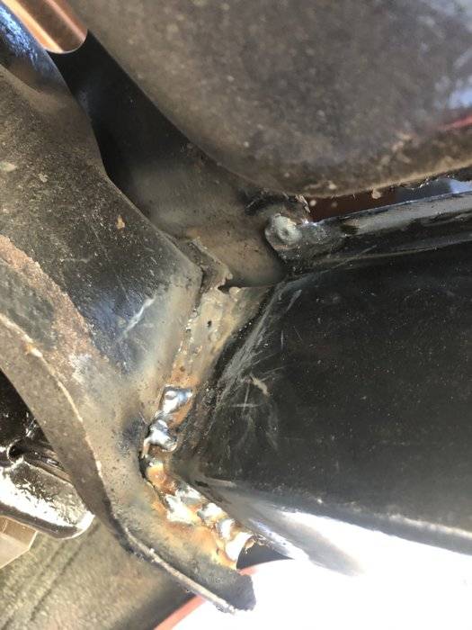

Had a few month break - had a deck built, new job etc.....getting after the rear right frame rail at the Leaf Spring mount. Prob one of the more complex joints on the E body. Cut out the rotted section, bought the WHOLE rail because I tried a cover piece and it fit like ass. $150 mistake.

I have some more grinding to do, then a little bondo at the seams to smooth it out, one last coat of POR 15....

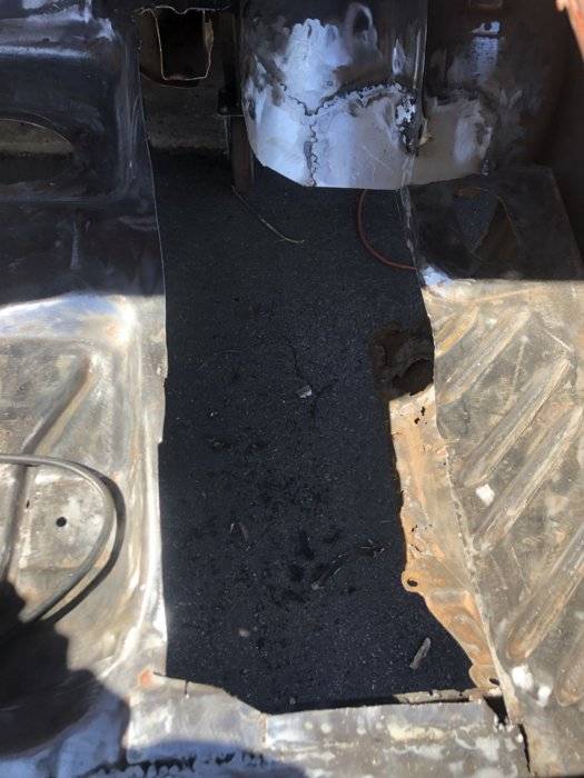

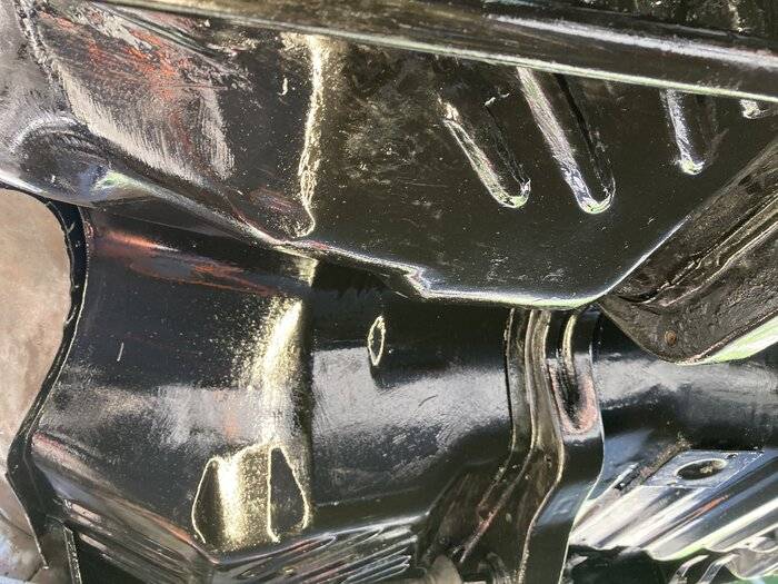

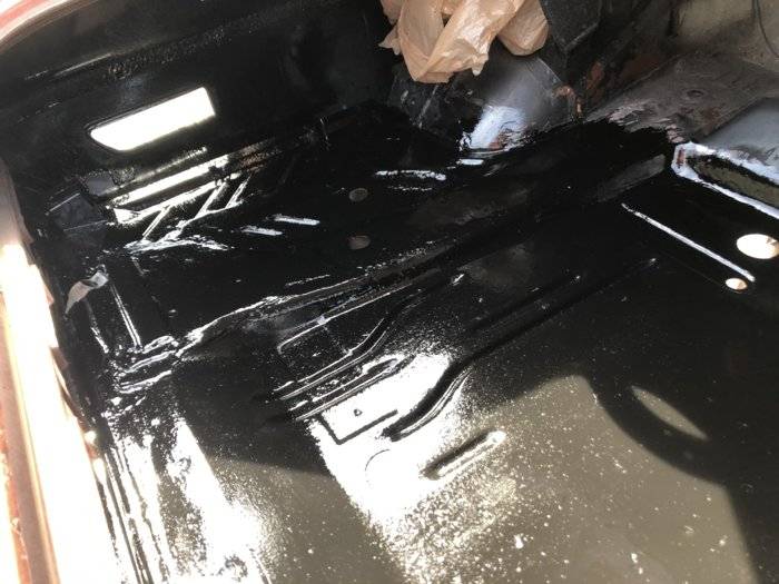

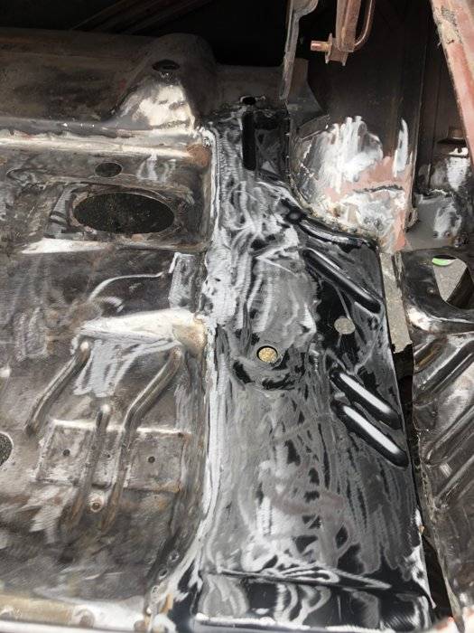

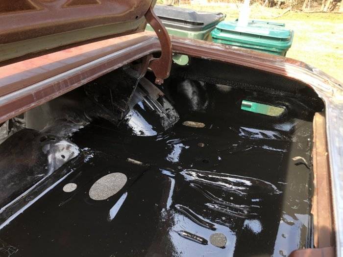

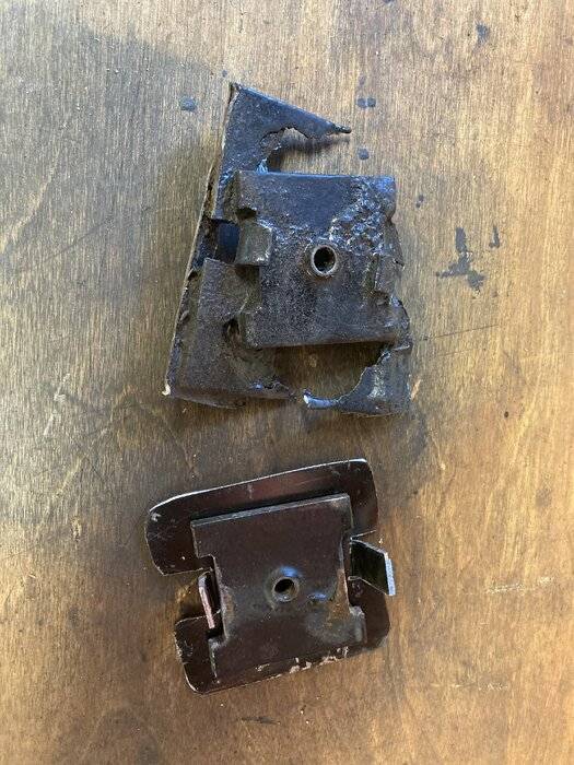

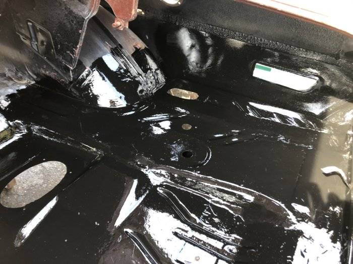

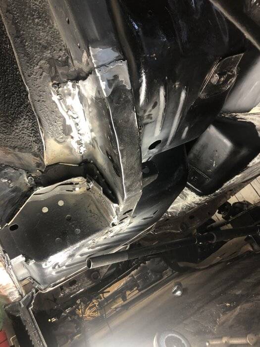

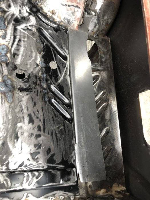

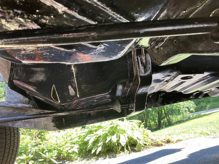

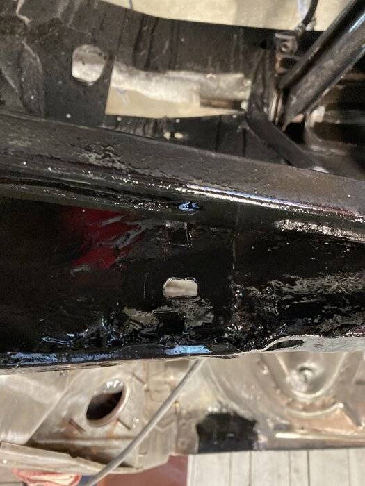

Floors and frame are done from the rear to the firewall.....time to get after it in the engine back. Not many patches to do. I do need to rebuild the hinge mounts for the hood.....

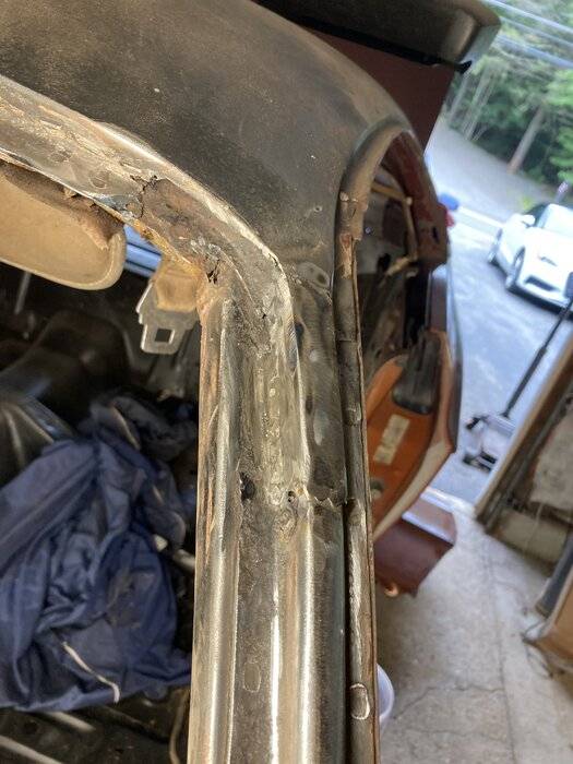

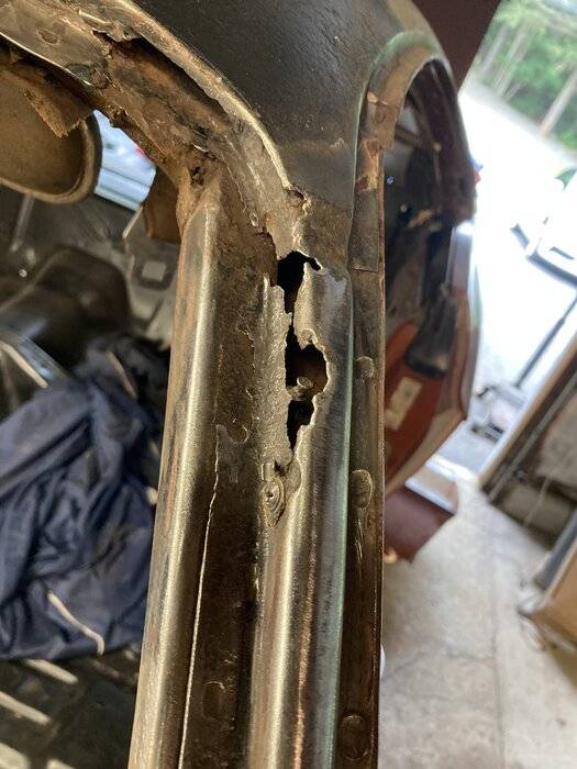

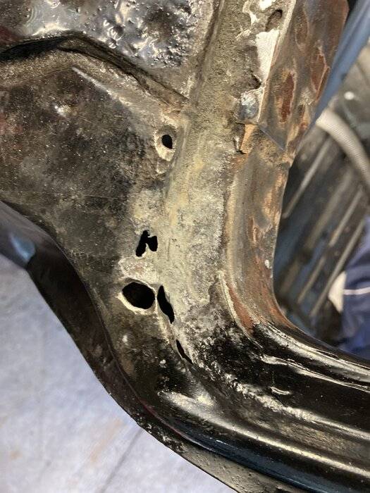

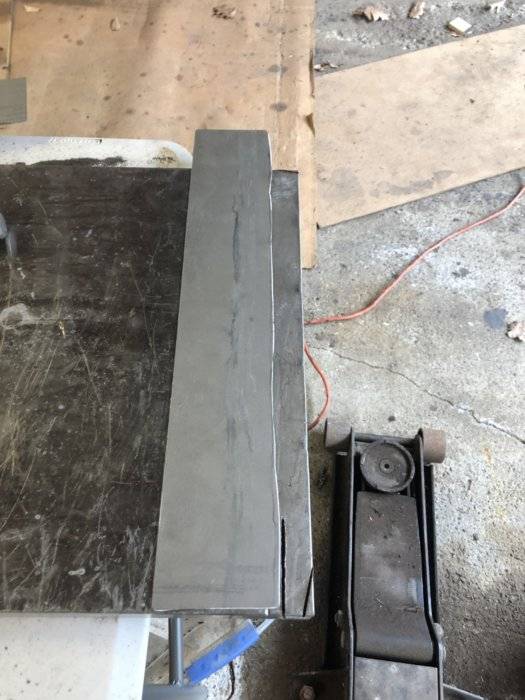

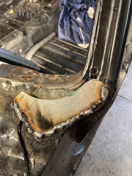

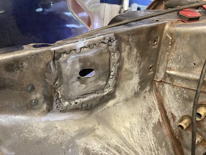

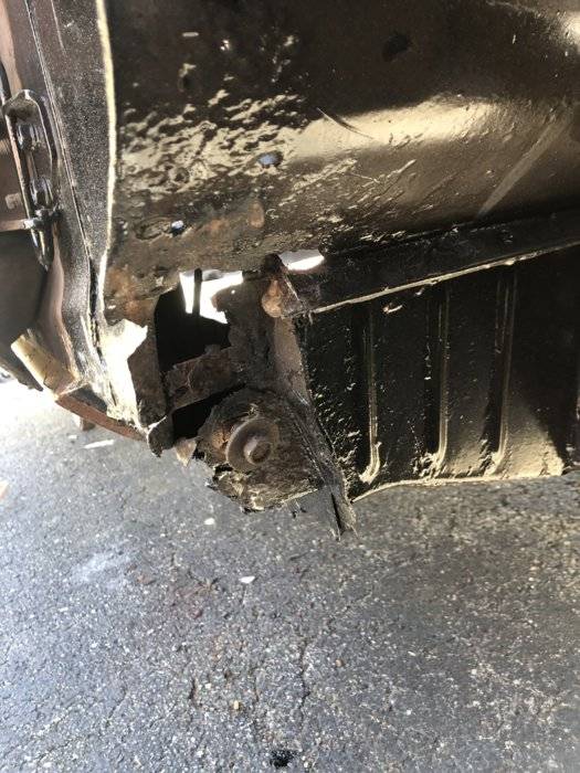

Windshield Frame. Lot's of spots at the base. Welded patches and POR 15 will seal it up....
