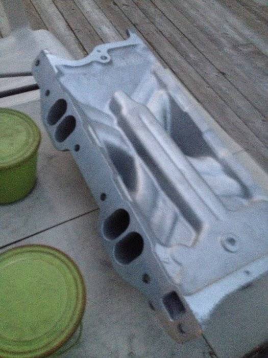

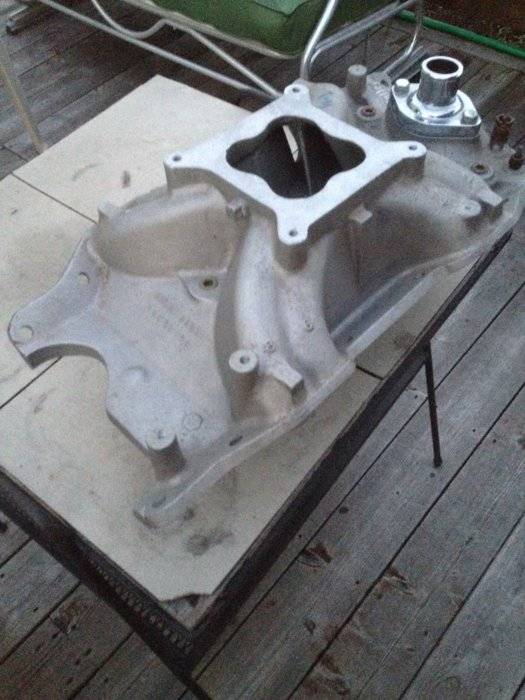

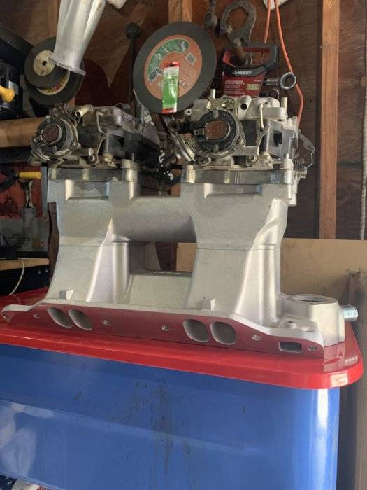

OH! Class rules! I didn’t know. My bad, sorry. Dave’s find is an extraordinary find!!!! That intake is obviously a Weiand Action Plus recast with the oval ports. I have the rectangular port Stealth from Weiand. It is a pretty good manifold. I have heard of people modifying a standard intake to mate to a W2 before but I have not seen the work.
Killer find there Dave. Just in time!

Yes, I saw that one for sale. That 8015 is the same one the 1998 engine book calls the "maximum torque dual plane" for W5 heads P/N P4529295. It has the heat crossover though and so if I go W2 I will use the M1 dual with no crossover that you can still purchase new. Unless I can find the LD 340 TA I have been looking for, that would be perfect!
You cannot buy any w2 dual Plane new for mopar anywhere
