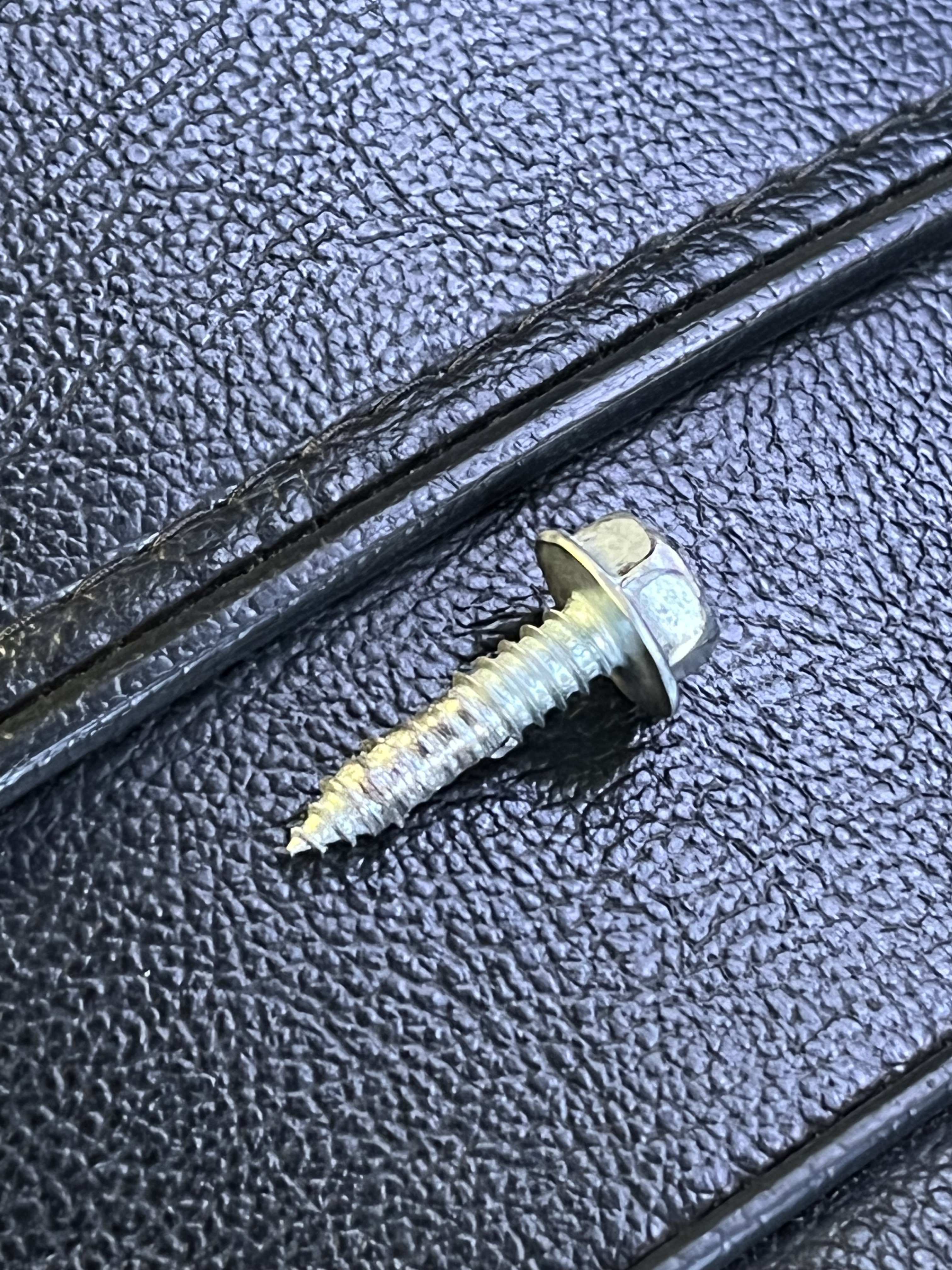

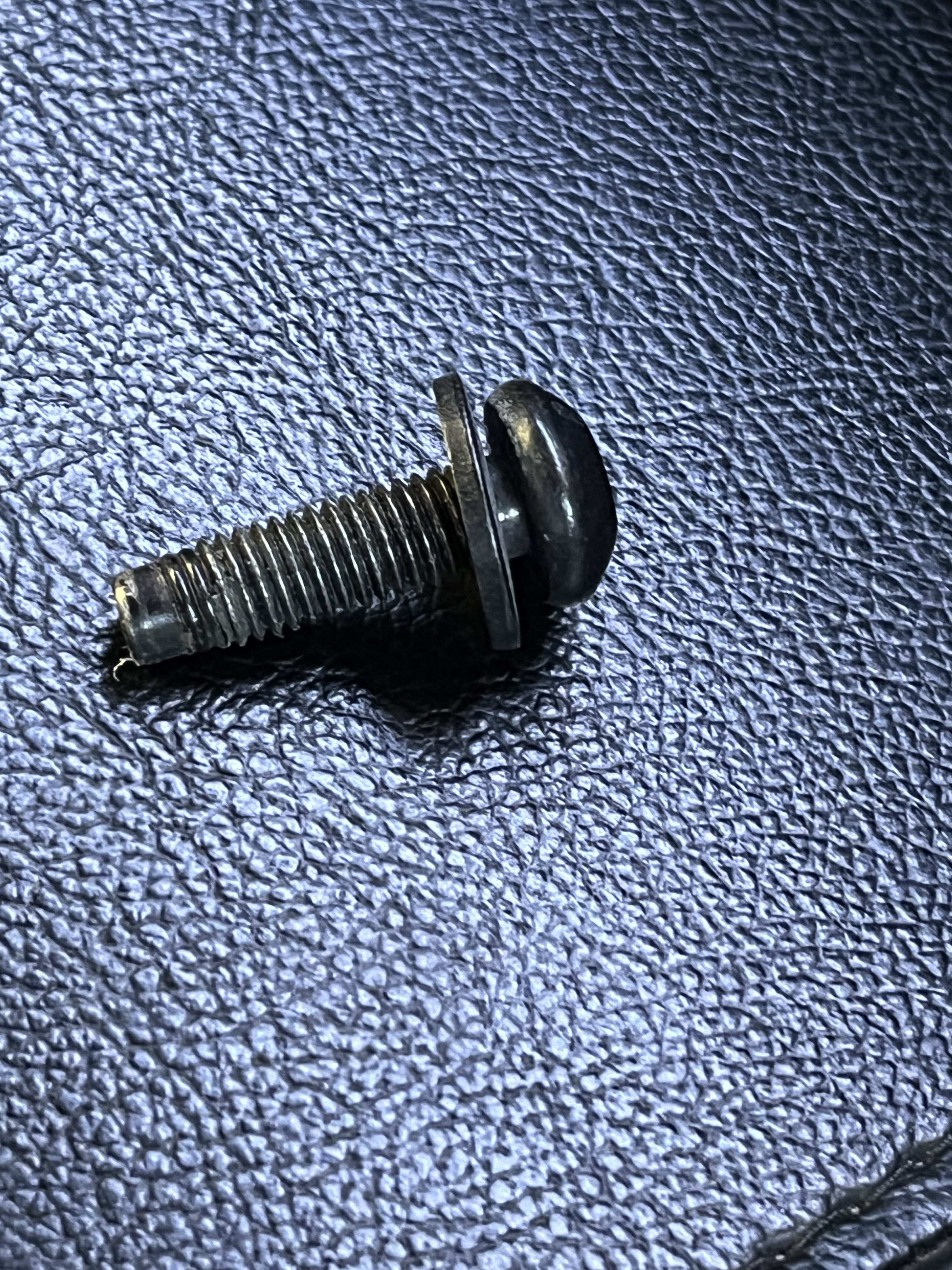

I took out my rear seat back today and both of the bolts were different. One was a hex head sheetmetal screw and the other a torx bolt with machine thread. It appears the female thread is made for a sheet metal screw. I have been checking online and I can’t find any photos with enough detail to tell what belongs there. Can someone tell me of the sheet metal screw is the correct piece?

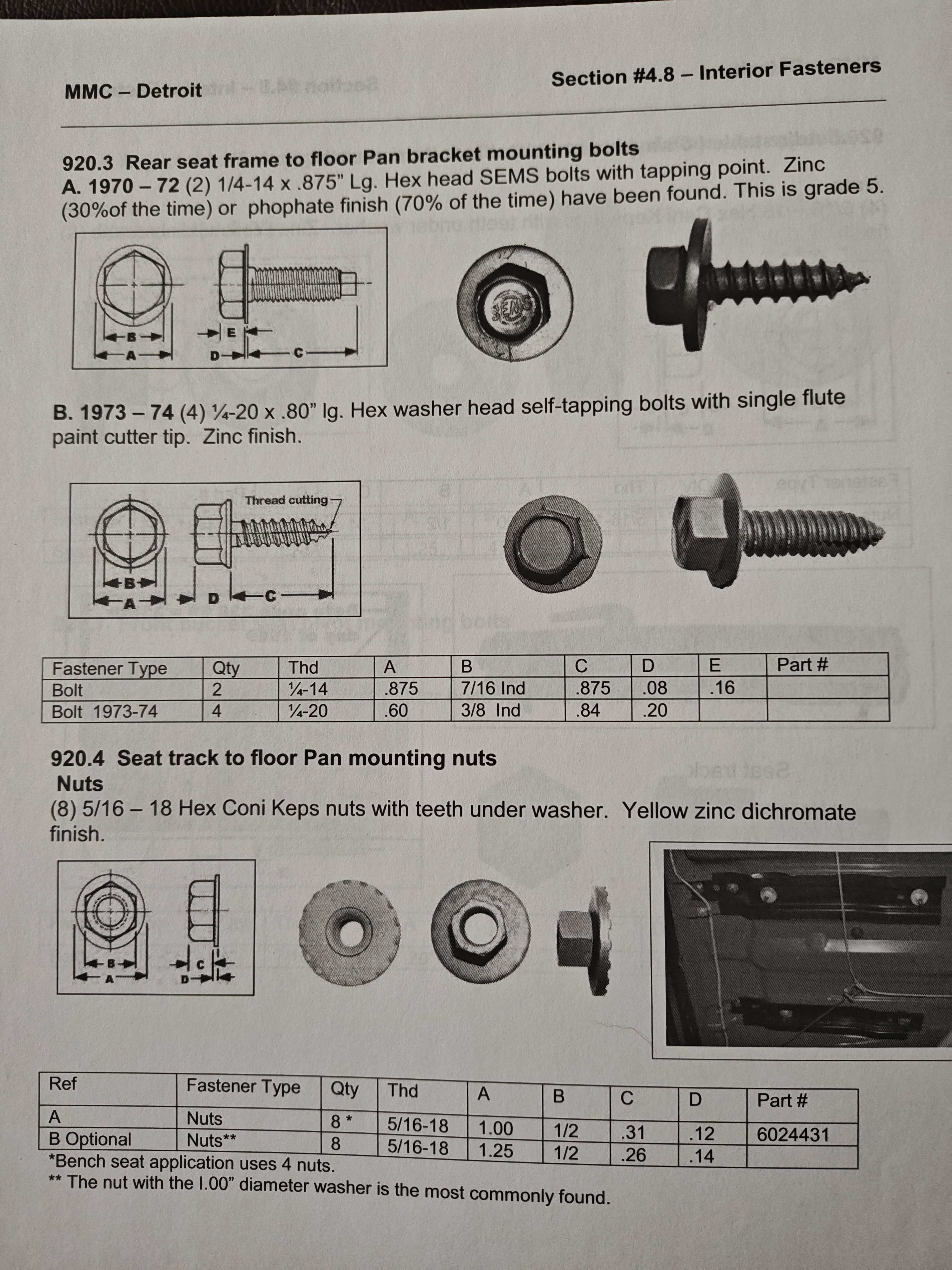

I couldn't verify EV2RTSE's eBay link. Here's from the MCC Guide to E Body Fasteners. This shows the differences between years which might be helpful for others who see this post.

Yes, I've got the massive two volume restoration guide as well. Definitely helps identify my collection of parts!
