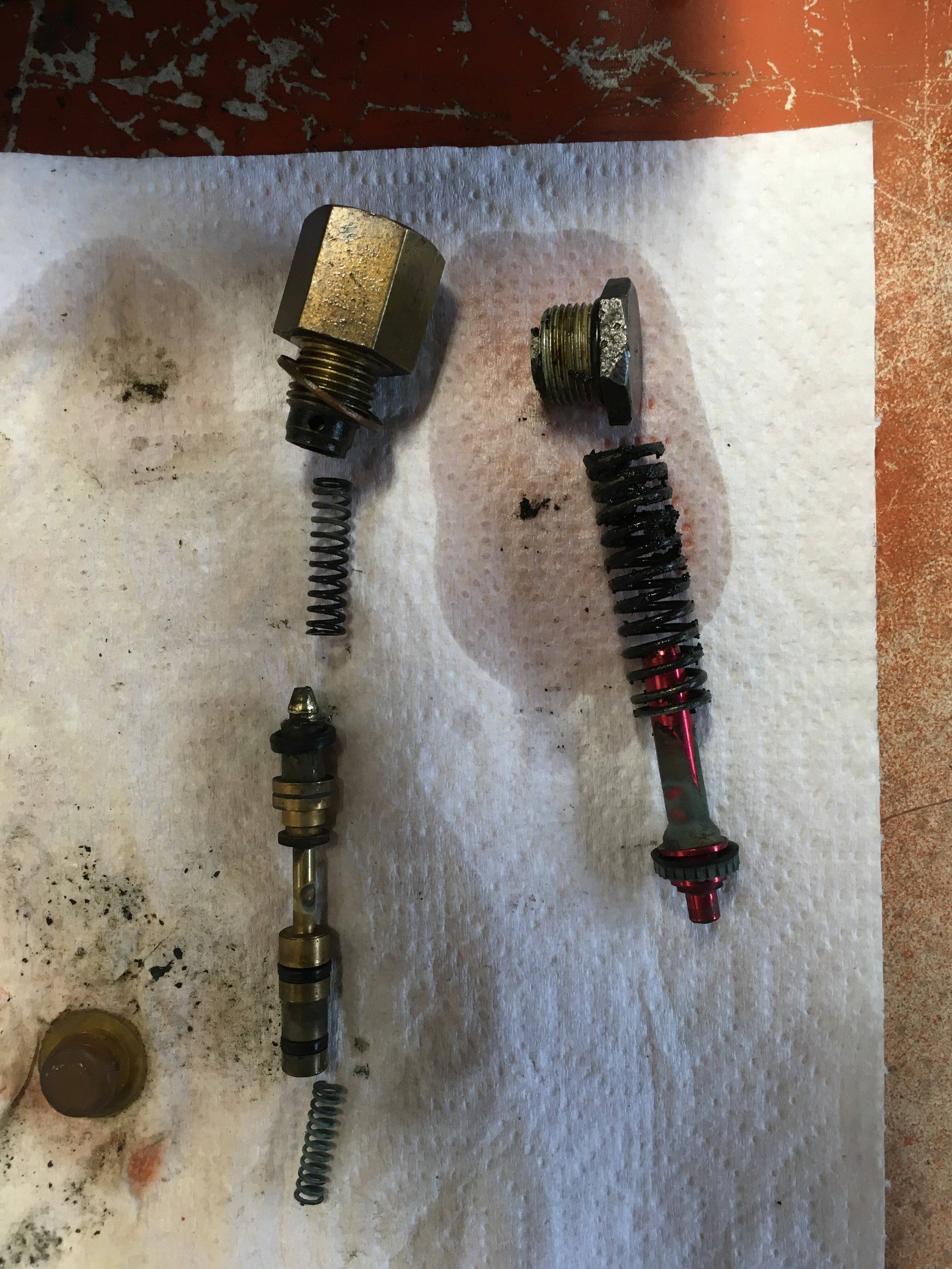

ZippyZoo
Oct 20, 2018
56
23
Denver, CO
I also rebuilt the distribution/proportioning valve. I could not believe how much crud was inside - especially in the proportioning valve section! I'm still a long way from driving but have to believe getting all of the crud and sludge out - plus new seals- can only make things better!
