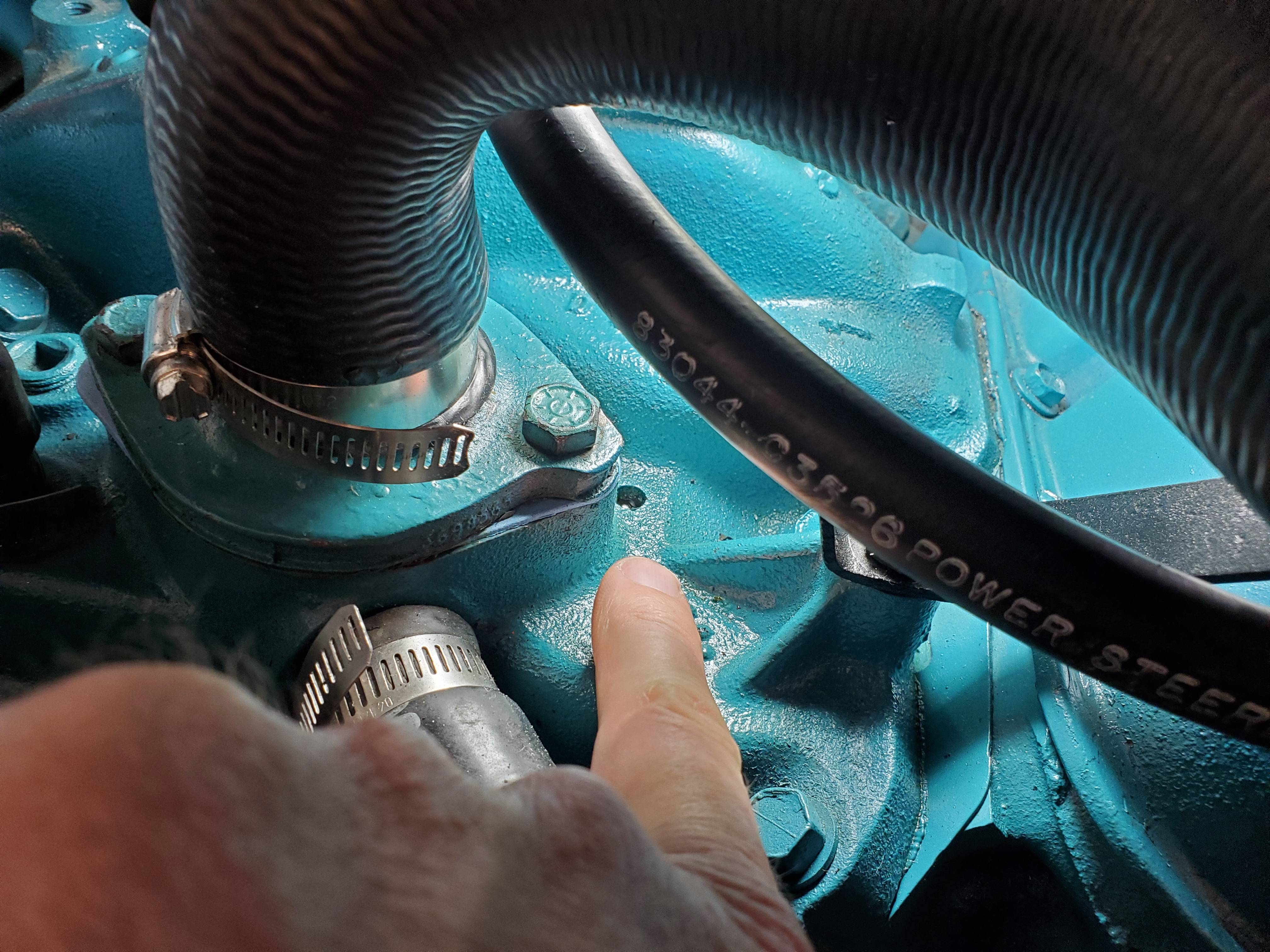

BUT.......I then noticed this sorta of weep hole in the intake manifold was wet.
I had not seen this before and I definitely had not spilled anything on the motor.
So I stuck a small screwdriver in the hole and it was OIL
1) Can anyone tell me the purpose of this hole/divit in the intake?
2) Could this be a sign of a potential cracked intake or manifold gasket failure?
3) Or does this hole mean nothing and its just oil left from someone elses spillage month agao during the engine install?

I’m not accessible to my book but, I believe it may be a guide hole for throttle return bracket. I can look tomorrow. It definitely doesn’t go all the way through the intake right?
Titan1969
Nov 6, 2020
90
56
Orange County, CA
No the hole doesn't seem to go all the way and thanks fir the assistance.
it could make sense if this divet is for a return bracket.
The one on the car I thought was original but it does tend to swivel on the the single bolt holding it on the engine if I bump it, which does not seem right to me...should be fixed unable to move IMO.
