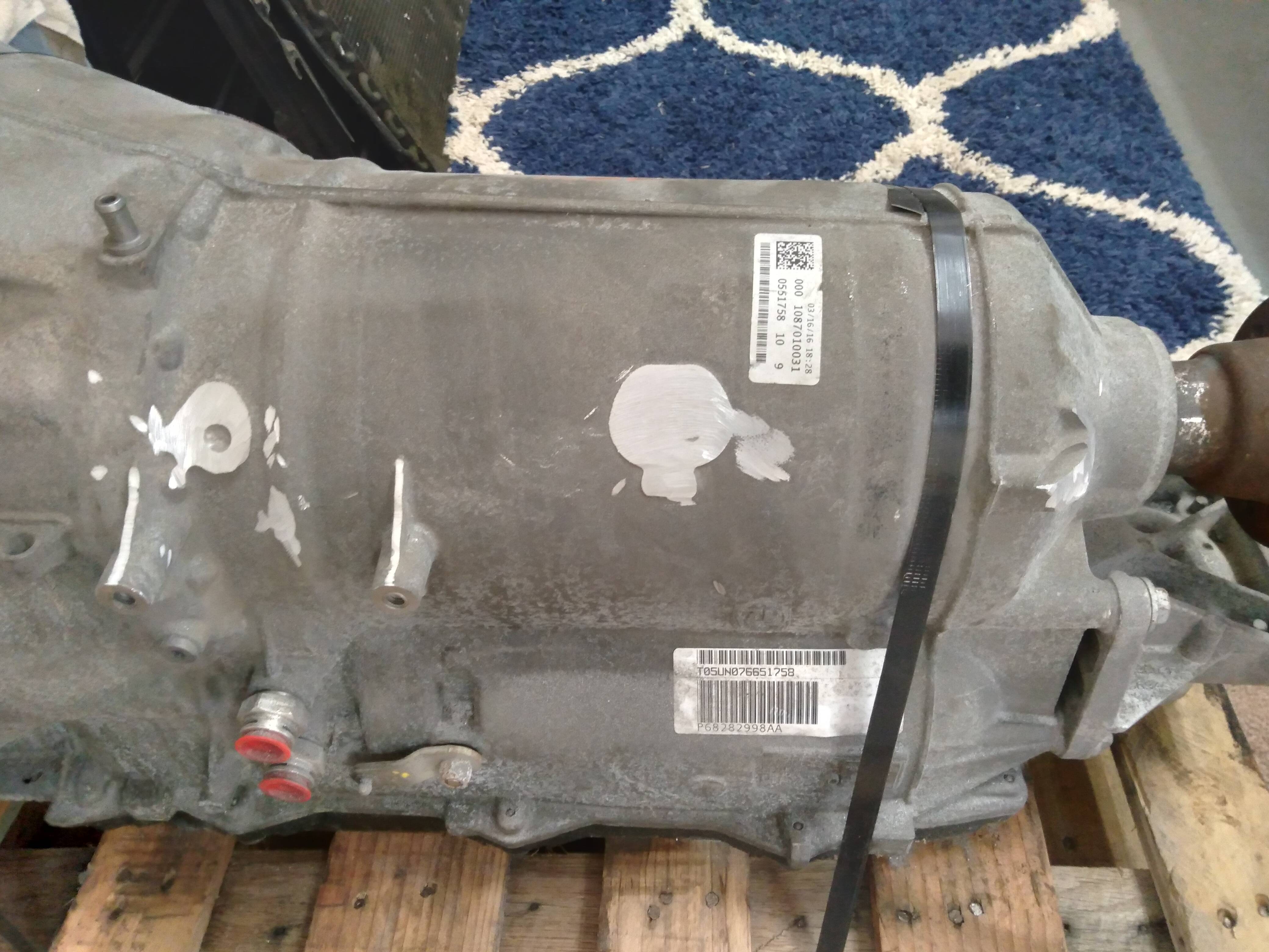

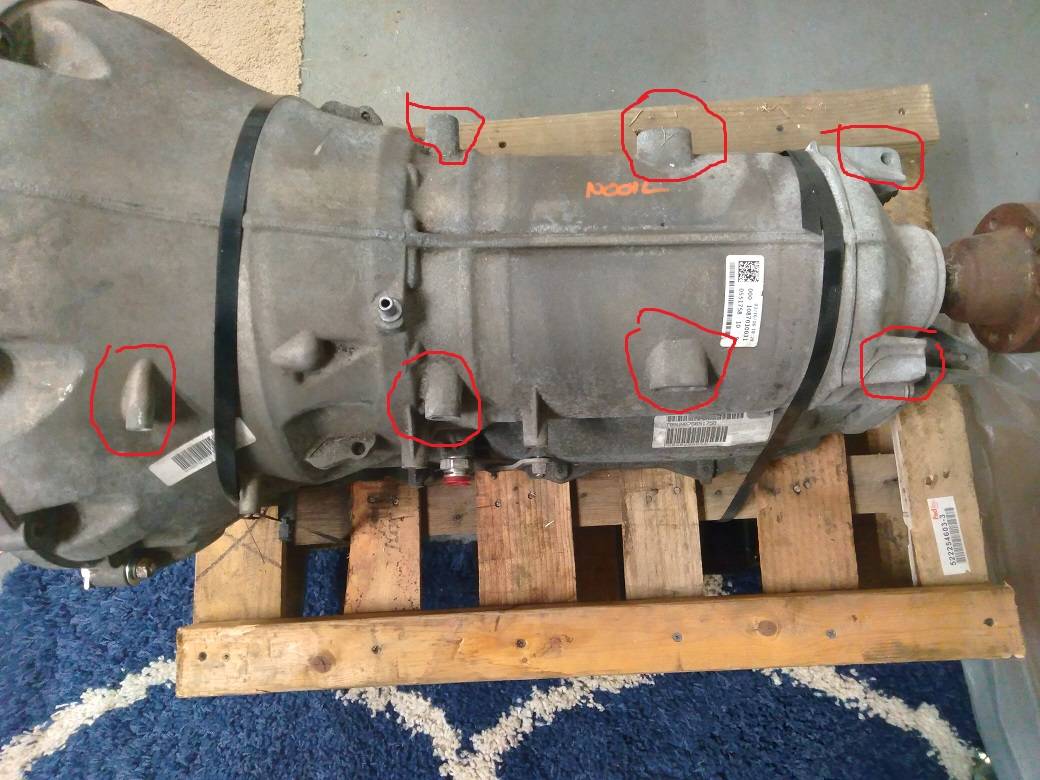

For those of you that have installed the 8 speeds, did you grind off all the tabs on the sides to allow it to fit better? Grind all the way to the case? I am trying not to cut my car up to get it to fit so I would like to move as many or all tabs. Are there any that should not be removed?

Here is the ones I am talking about... any others or that is all I need to remove?

I have not done this but you should be fine going almost flush with the case , it has to be strong there if they are mounts .

I cut the middle 1's & ground them flush measured with an ultrasonic guage i had casing seems to be aroung 4.5mm thick around the thinnest mid section

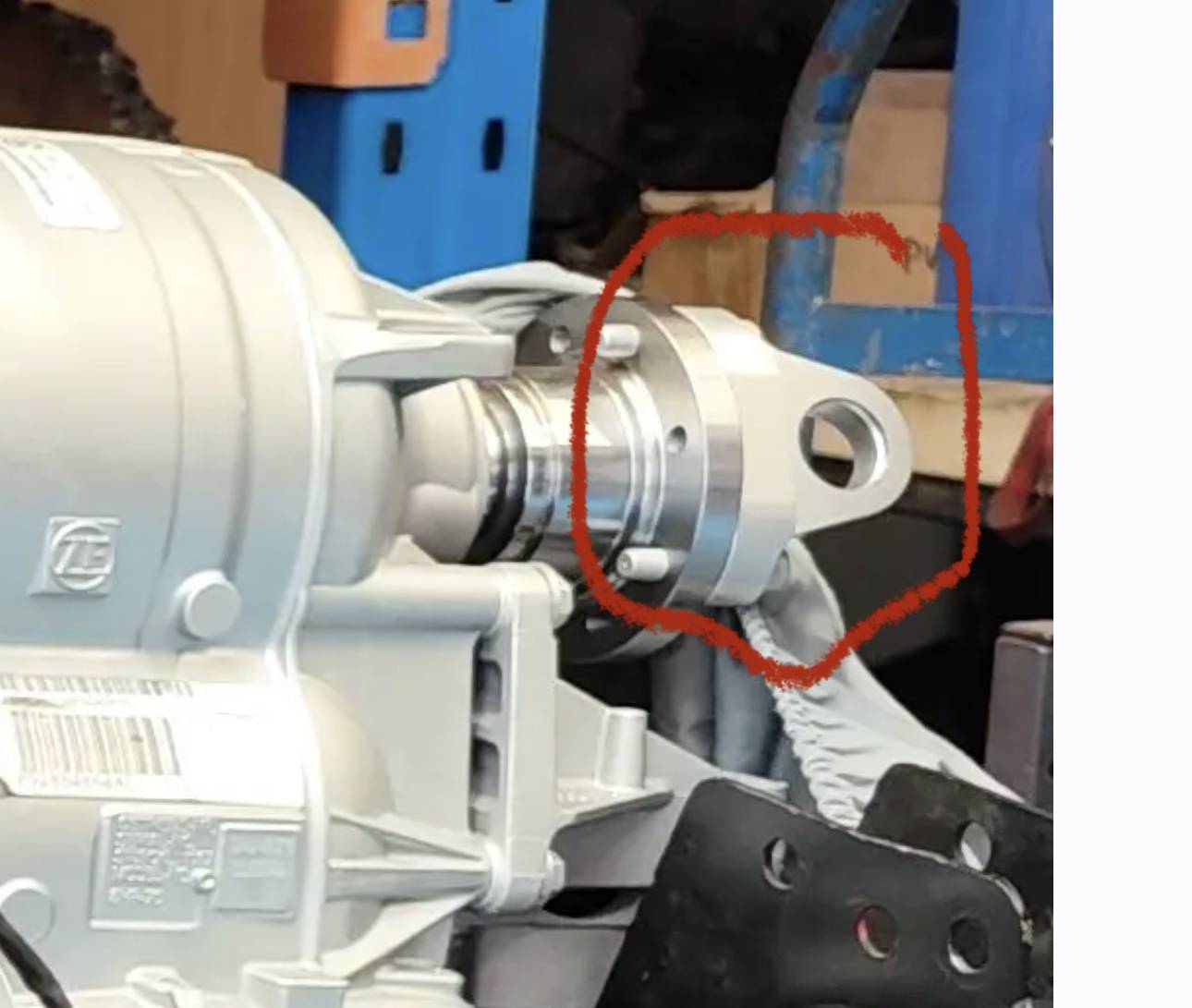

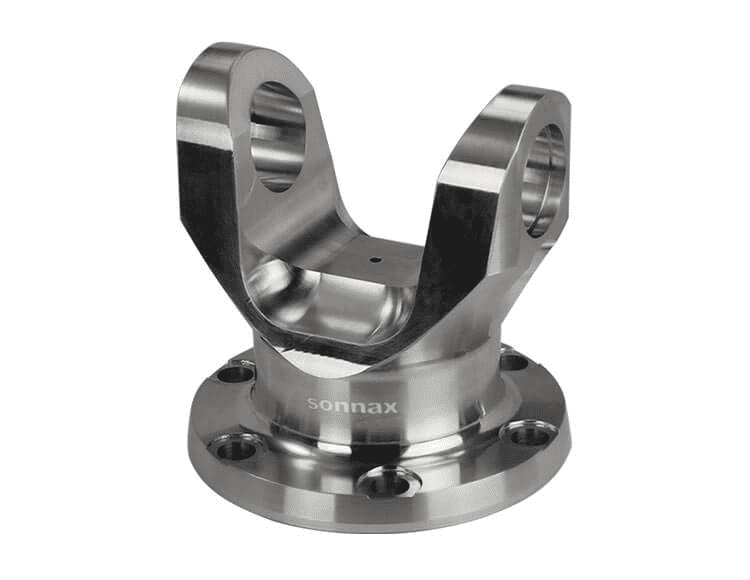

Denny's Driveshafts has a good selection the steel output is from HTG HPR 8HP output flange
Sonnax T3-2-1859A
Aluminum Flange Yoke
  • 1350 series
    • Fits 1350 series universal joints listed at bottom of this page
    • Fits 3.625 x 1.188 u-joint size
  • Outside Snap Ring style
  • 2.95 inch female pilot
  • 4.75 inch bolt circle
  • 1.750 inch CL to mounting face
  • Material: 6061-T6 Aluminum
  • Bolt Hole Dia.: 0.516"
  • Weight (lbs): 1.270
  • Bolt Count: 4

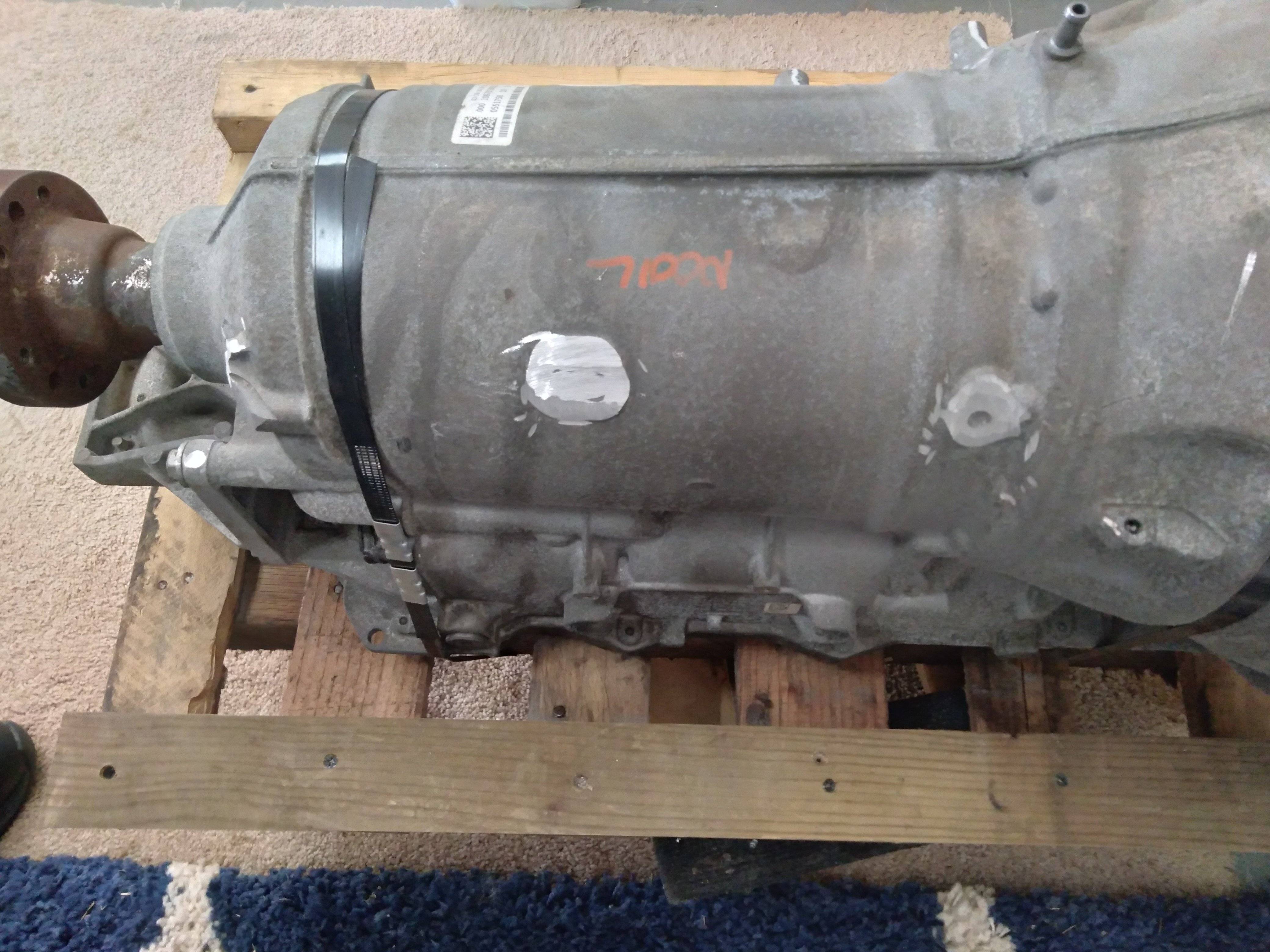

OK, I removed 2 tabs and 1 case "extension" per side.... here is before and after pics.. I didnt remove the left side tab that is closest to the torque converter, waiting to see if that is in the way, along with the threaded tabs that stick out above the cooler lines.
