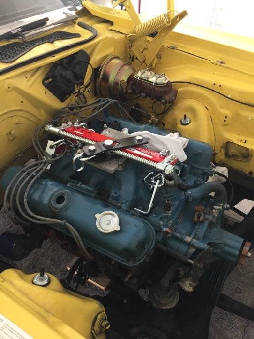

Replaced my 340 with a 392
Cudafor36
Mar 21, 2018
229
43
Sylvania Ohio

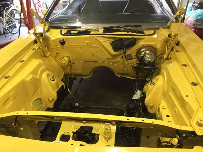

my fellow mopar gang. I have owned my car for the last 36yrs since I was 12. Yup. It was time to upgrade my car to the turn key capabilities. Nothing wrong with my fast 340 but I fingered why not. Given this I can sell someone my entire driveline, motor (very well built), 727 tranny, the new radiator, drive shaft, tti headers and a new firm feel power steering pump all for a low price. I have photos and videos of it running just before I remover her. Just dirty but a whicked strong motor. Txt with questions.
I would also like to offer my experience so far with installing the 392 and all the fun doing it. Lol.

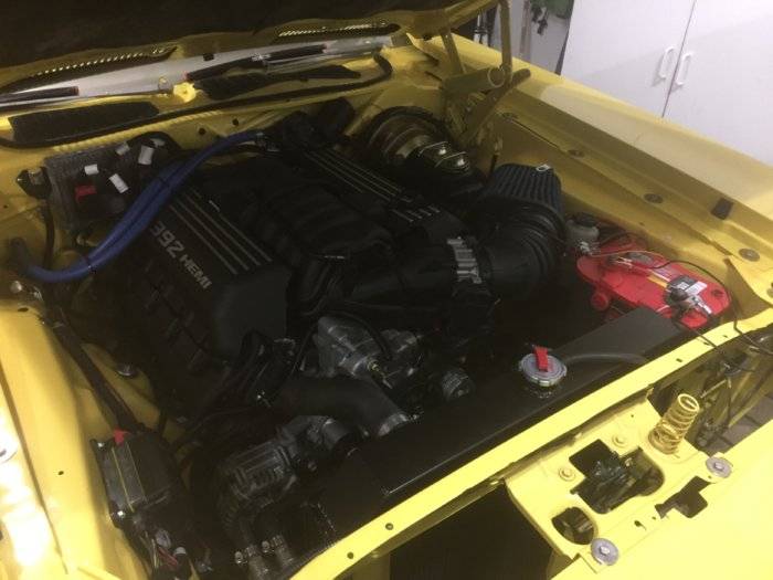

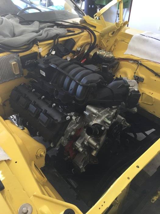

I purchased the TTI motor mounts when I ordered the exhaust system. That was a mistake they make the motormouth high. Go with Schumacher ones

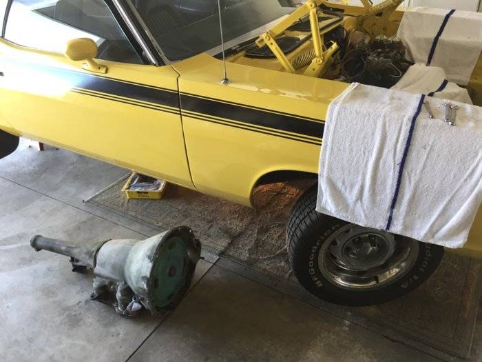

I Webt with the four speed auto from Silver sport transmissions. My caution in that is it was freaking really right in my tunnel.
As far as the wiring goes I am starting that this weekend. Seems straight forward enough though just lots of them. And some confusion on how to get the rpm signal. I should be able to get her.
Word of caution though.
- the pass side tti header hit my brand new motor casting at the rear. I had to grind off a tab that held the original oil pan
- do not use mopars rear sump oil pan it hits the steering linkage. I used a mildon but should have researched it a bit more for a better quality one.
- do not use the mopar 45 degree oil adaptor it hits the k frame and even after grinding off that the oil filter still won't clear. Use a remote kit.
- the drivers side tti header has one bolt that will not go in the hole due to pipe to hole clearance. I had to shorten one on the fly.
- the mopar kit for the cold air intake is too big unless you move the battery fro the stock location.

So the starter install was my first objective today. No go. Had to grind down the tab on the motor black like the other side. Also the tti header pipe is slightly hitting the starter. I'm a bit disappointed with them now.
Second words of advise are. Buy flexible tranny and oil dipsticks. The mopar one that came with the motor interfer significantly with the headers as well as the Silver sport tranny supplied dip stick honestly sucks and would not fit.
The alternator and power steering kits I bought direct from mopar fit great bit both belts they supplied with them are too long. Argh. Had to grind out a bit of the frame to install the alternator but I already new that one.

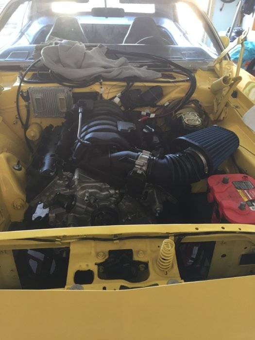

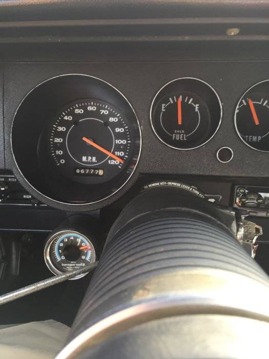

I'd love to see that. Especially since I am having trouble getting Intel on what wire to splice into for the TPS signal Timmy tranny controller. Also the rpm signal for the tranny and my new tach. Mopar was no help.
Question for ya as well would be how the motor knows the starter in in neutral or park as the new mopar kits now control the starter. No wiring to hook that into the CPU.

We used the 1970 starter system connected directly to the battery and mounted on the left side of the block, not the computer starter system. The wire harness is set up for the starter to be on the right side of the engine, so you will need to un-tape the harness and re-direct the wiring to reach the left side if you are going to mount your starter on the left side. Also, on the wire harness you can cut off and seal the starter cable connection because you will connect the positive battery cable directly, along with the starter connect for the battery on the wire harness to the starter.
PM me for a pic of how/where to splice into the tach signal.

Help
Tried to start her today and It starts then immediately shuts down. Fuel pump is triggered by a switch I installed so it stays on.
dfrazz
Aug 25, 2013
142
Help
Sounds like you are losing voltage in the key run position. The only thing I can think of is that you wired the starter to the Mopar harness.
Cudafor36
Mar 21, 2018
229
43
Sylvania Ohio
Thx For the note. Yes I did wire as instructed. But it appears our old cars fluctuate volts too much for the new CPU. So I wired in a toggle switch that sources to battery. Also it feeds my fuel pump. A secret little way to start my car. Lol. The mopar kit wiring for the starter sucks, solinoid wire too small not providing enough juice. So I wires her up as original and it works great.

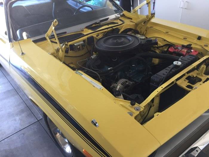

I probably have less than 5k on her over the last 12 yrs. I know I know but it's a nice weather driver.

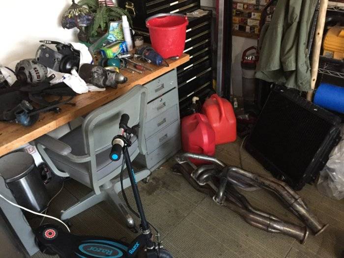

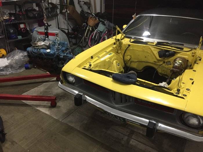

So I told my brother for 3k he can have it all. But he is dragging his feet so to speak. Never does anything fast like moi. I took over the car when he was 23 as he was letting it sit. Now nearly 36yrs combined working on it in my possession he wants to get his own. Blah blah blah.
What you would get is
- a proven '69 340 with 450 lift and Duration balanced cam and blued crank. Bored 30 over. I would put on new seals for pan, crank, and valve covers while it's out. Does not burn a lick of oil. Can shift it at 7k rpm with no issues.
- J heads that have been ported and polished back then with a 3 angle job on em
- msd ignition system with a new position sensor in it. That sucked trouble shooting that one. Lol
- a new firm feel Saginaw power steering pump
- a new radiator, long story from a poor mech changing out my control arm.
- a strong 727 tranny. Needs front seal for sure. Long waits till I warmed her up over the years. I would while out put a new pan gasket and filter in.
- a balanced drive shaft.
- the original 340 carb cover that covers an eldebrock comp 650. That's bolted up to a performer AL manifold that matches it. No starving for fuel here. Though at 10mpg who cares.
- new clutch fan a number of years back
- tti headers. Though they show there age they work and sound great.
- all new brakes from just prior to making this plunge. I now have a wilwood system installed.
- unfortunately I just tossed the original gas tank. Wife was mad at me for holding onto the stinky thing in the garage. Argh.
