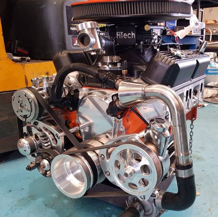

This is a 340 but may give you some ideas
Air cond is a vintage air compressor is a 7 cylinder mini
Pulleys were bought separately off ebay but is notice the price has doubled since
Lower brackets are an Australian product
