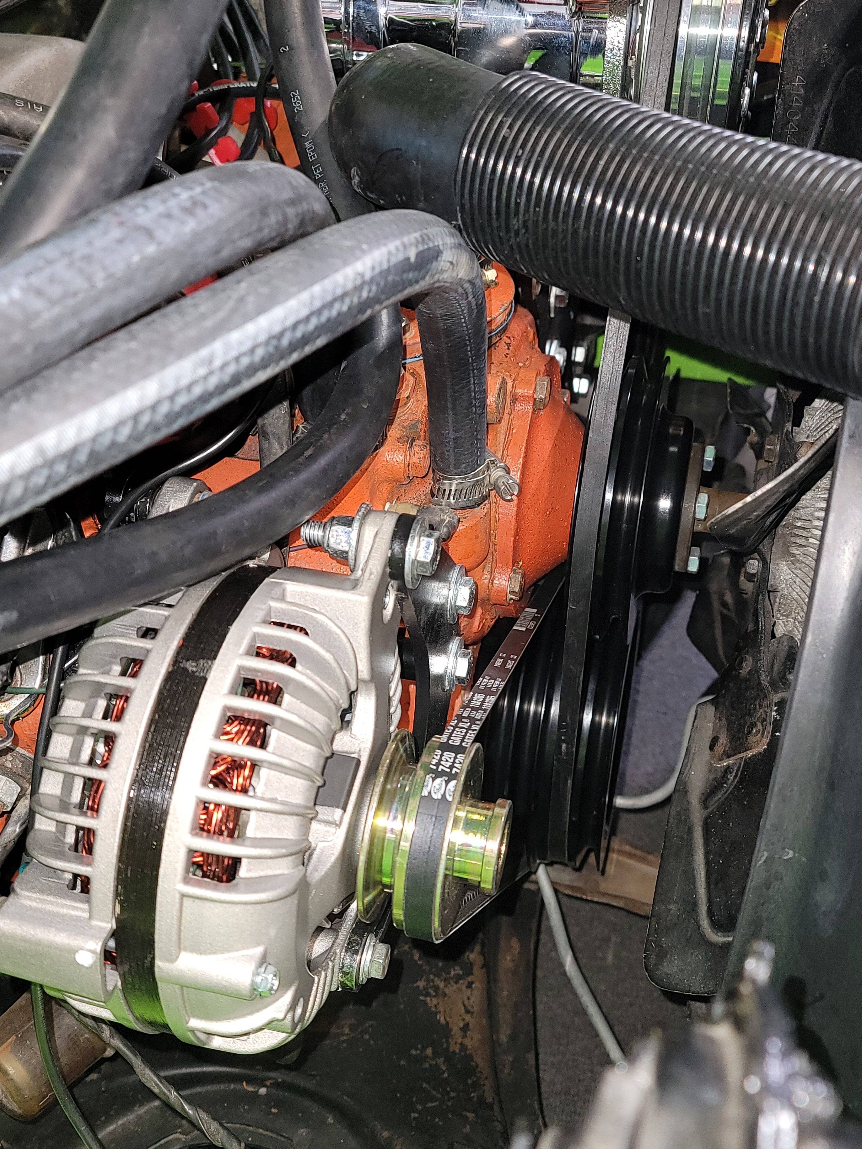

I recently had cooling problems with my 383. Turns out my radiator cap crapped out. Replaced it with a 16#. Fan clutch also crapped out so replaced that too. Also, replaced my 180 thermostat with a 195. Running cool for now. Summer will be the true test. This is the way my belts are installed. Moparleo, are you saying it is better to run a second belt exactly as the one I have on the ac compressor now? Thanks.

What I see in the picture of post #24 is that the belts are not routed properly.
The problem is with the water pump pulley.
The alternator and a/c compressor have dual groove pullies because when the a/c clutch is engaged it puts a large load on the belt and it will slip, so it needs 2 of them. They are driven directly off of the crank shaft pulley.
The water pump and p/s are driven off of the crankshaft on a separate pulley groove.
Your water pump pulley is too deep and that is why it rubbed on the water pump.
Also it looks like a spacer and not a clutch for the fan.
Now the water pump and the fan for a/c was different than the non a/c pump and fan clutch and blade. When you start mixing up parts you get mixed results. Always try to duplicate the factory set up. Chrysler spent $$$ designing and testing their cooling systems to be reliable and functional. Remember they had to warranty their cars ...
Does my belt setup look correct? Should I run a second belt in the same configuration as the one already on the compressor? Thanks much for the advice.

I forget about the LA's but the B & RB's ran (4 groove crank pully) 2 belts from crank-alt-a/c, 1 belt from crank to ps, and 1 belt from crank to idler pully to waterpump. If I were you I'd run a second belt on your ac just incase that belt is slipping, after all you have belt grooves for a extra belt
