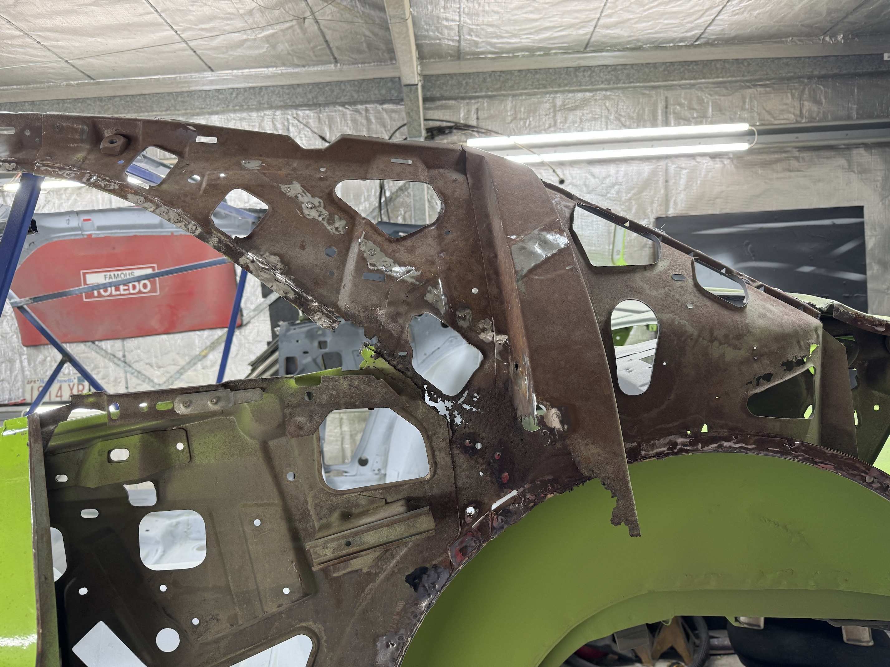

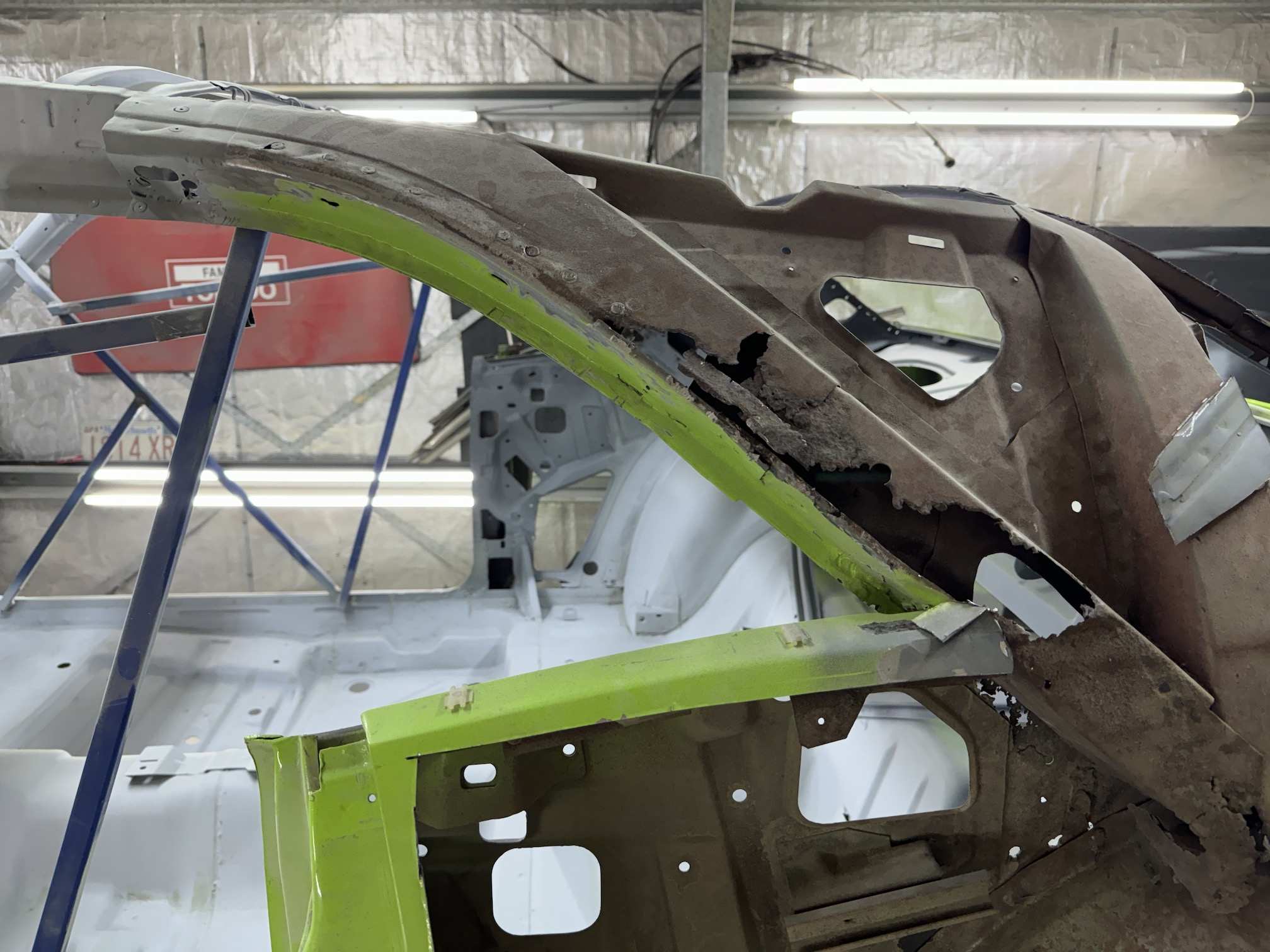

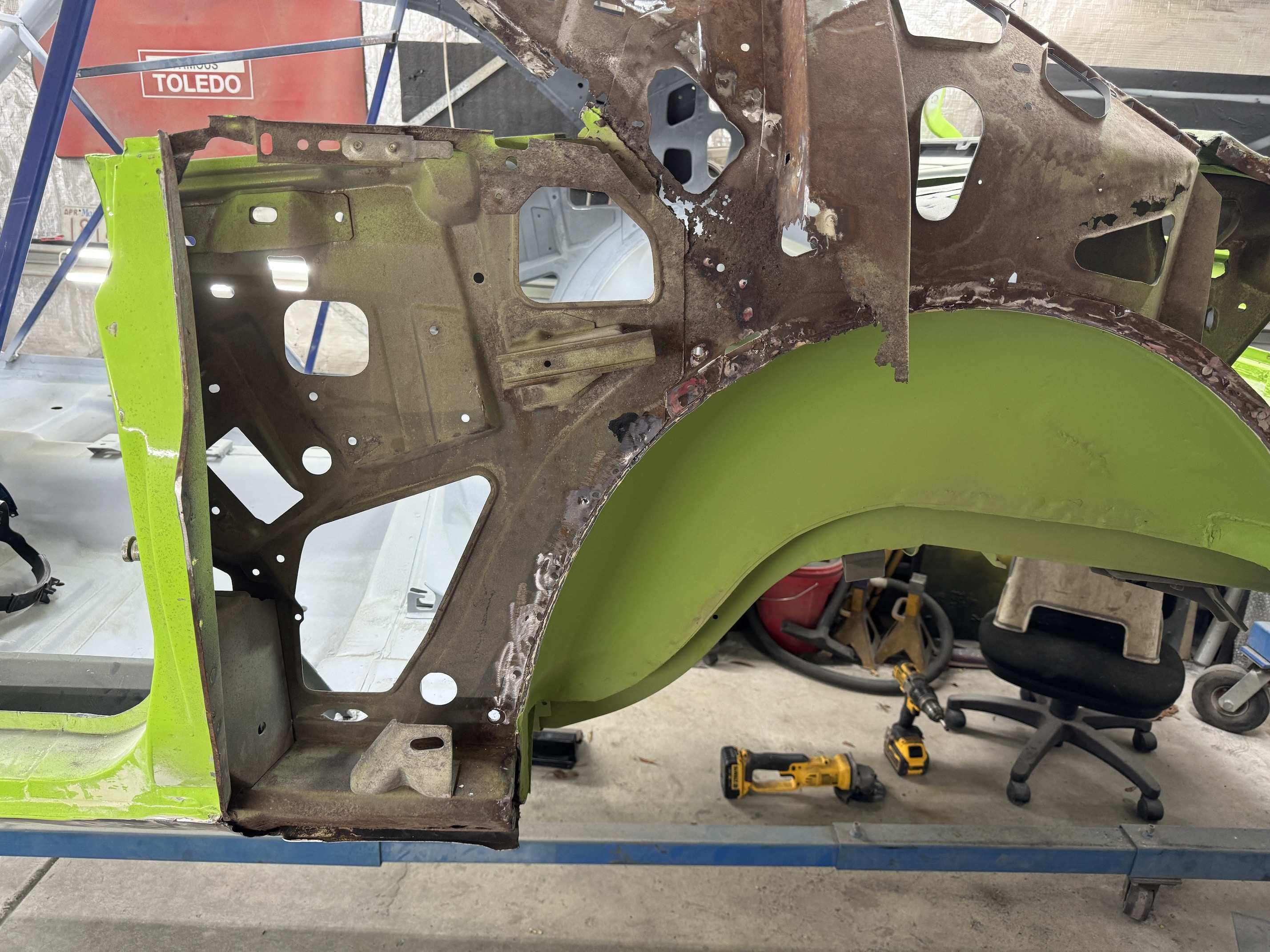

Well the rear quarters are off so I can address the rust in the roof structure. The passenger side rocker and bottom of door jam pillar are going to need some work as well. On the positive side, while it may be taking a little longer (ok, maybe a lot longer) once I've got it finished it should out last me ...

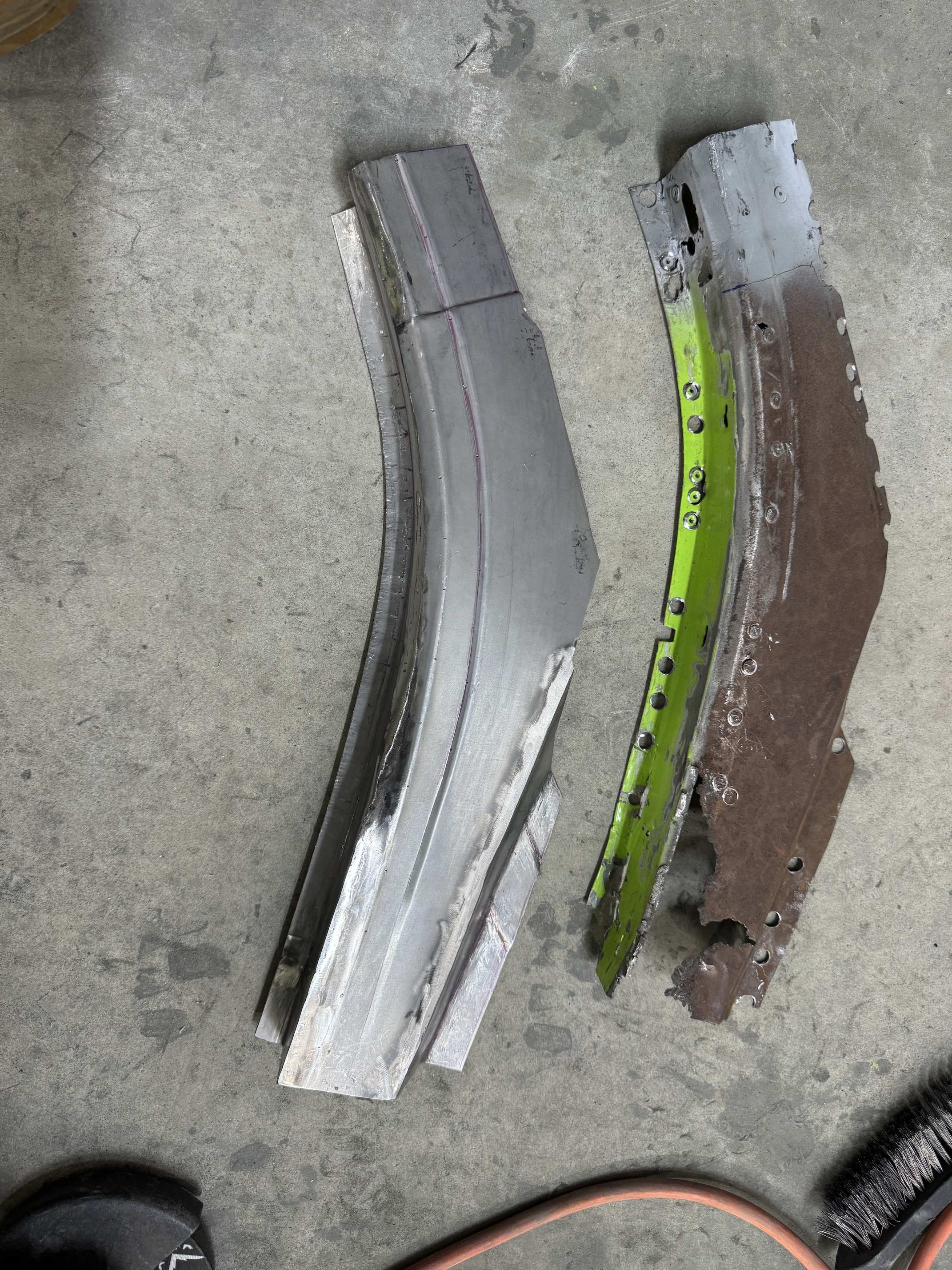

Any of those sections reproduced, or is it fab time?

The better part of two, maybe three days over the last two weekends and I have one of the six components made up 🤣. All jokes aside, I'm actually pretty happy with how it turned out. I started out trying to make it out of a single piece and using my bead roller and english wheel I thought I could get it into the right shape. There was just too much metal and I couldn't see if I was getting close to the orginal profile. I ended up cutting it up into three sections then TIG welded the pieces together. Making them in 3 pieces meant that I could effectively clamp the top and side piece over the rusted original and get it almost exactly the same profile.
Hopefully making the passenger side should go a lot quicker now as I have the template and the concept of how to make them. Potentially I'm kidding myself, but the other 2 braces each side should be easier as they don't have quite so many complex curves.

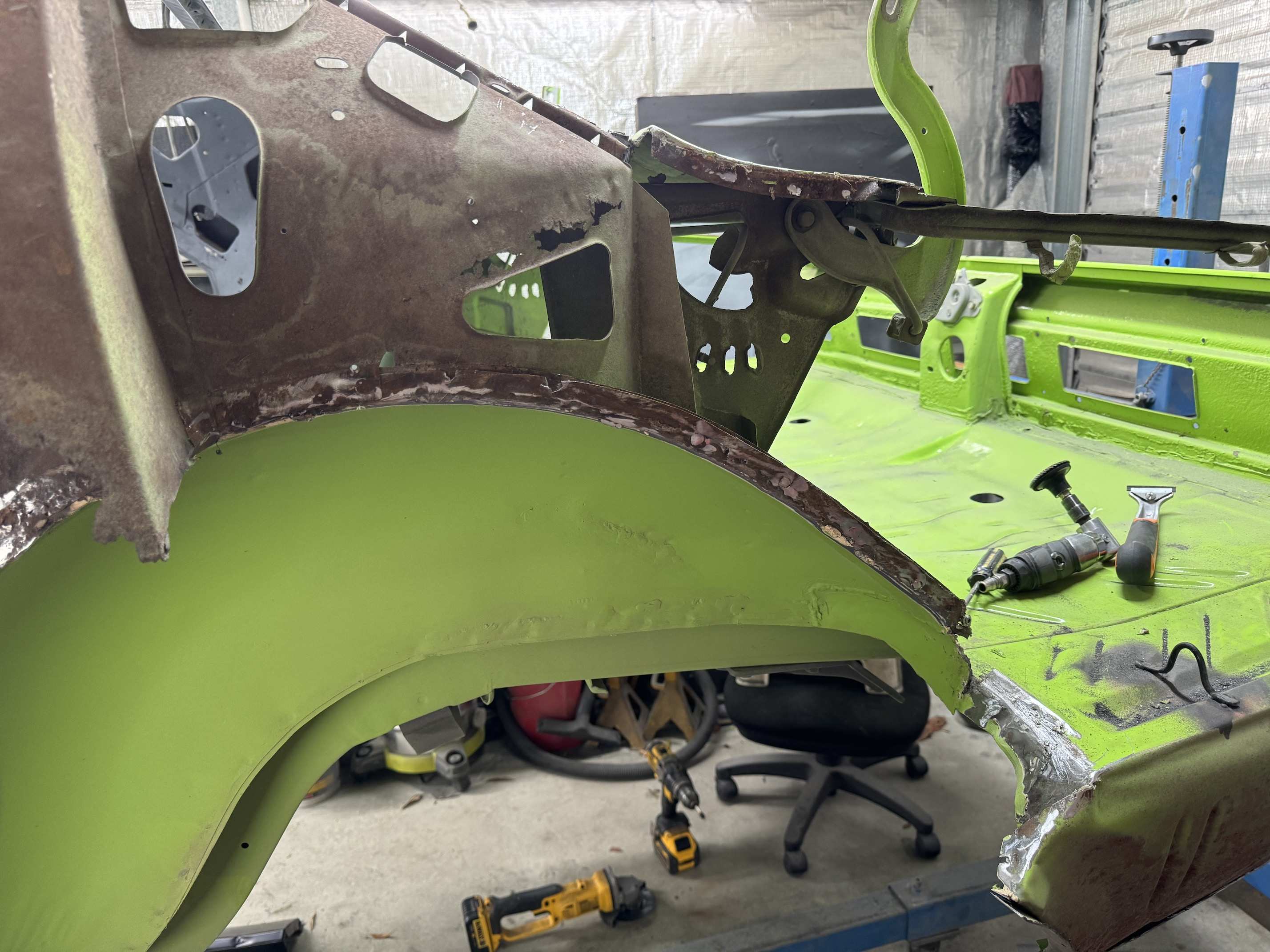

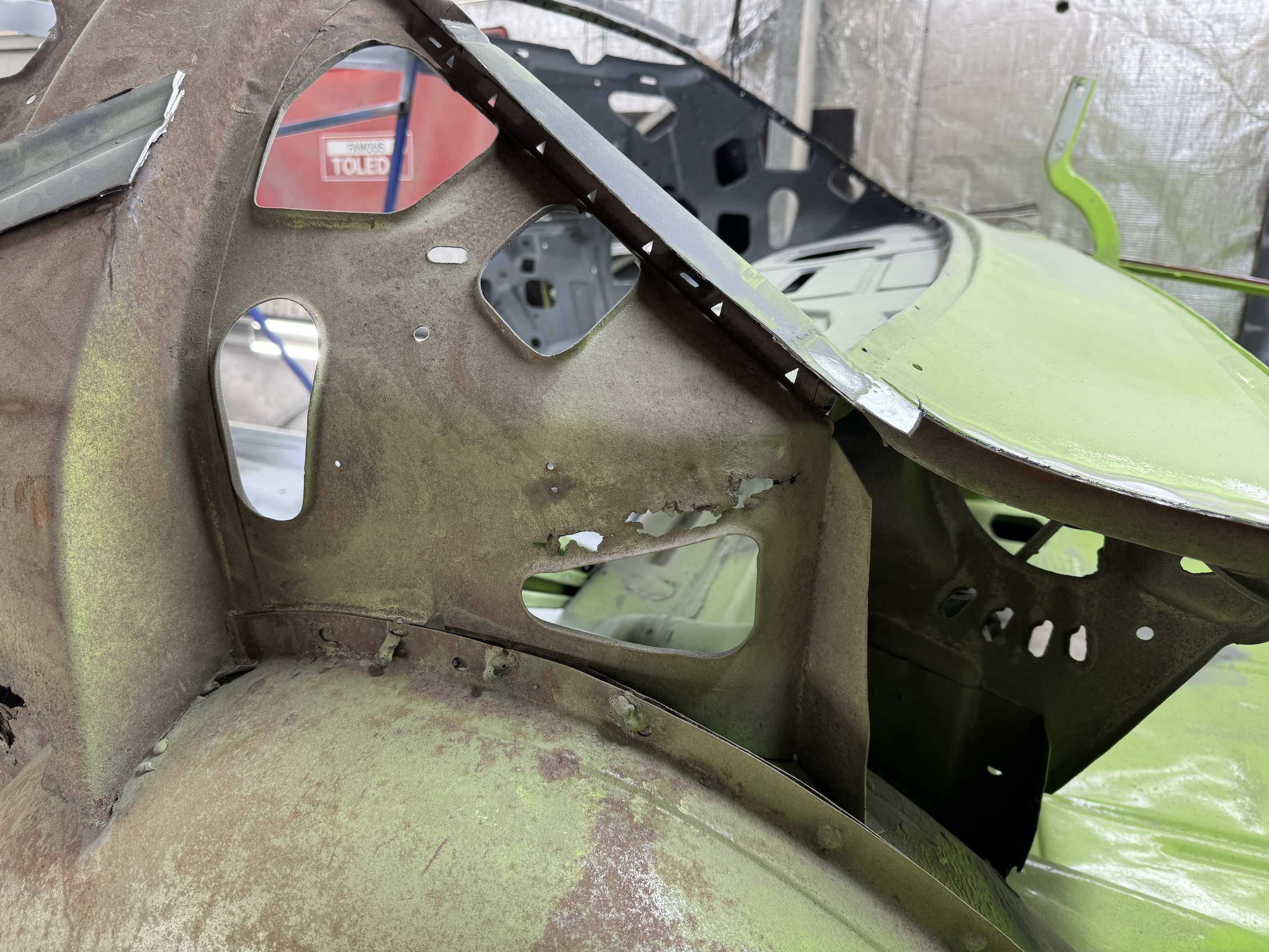

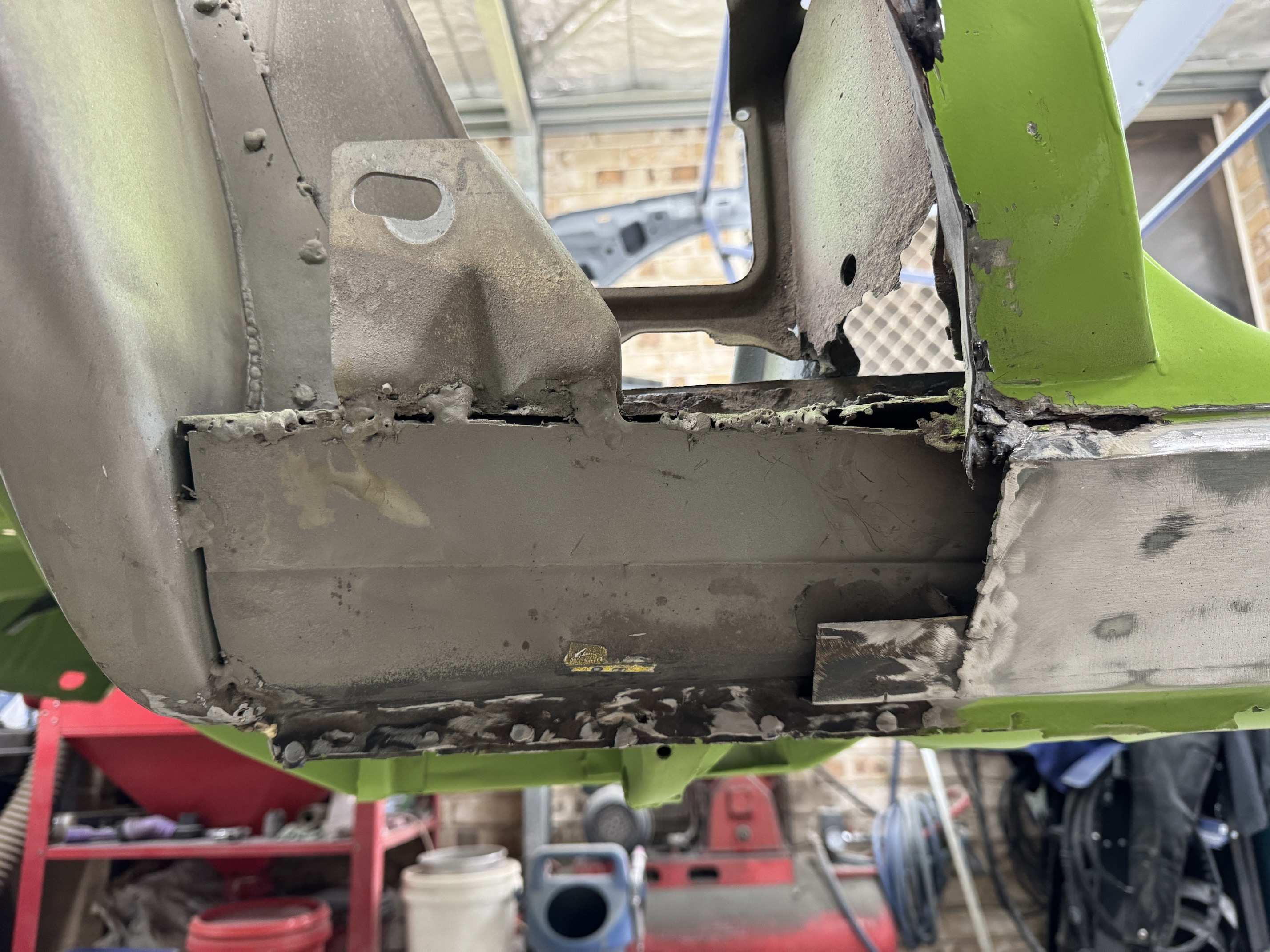

I removed the next brace down the B pillar. It's a much simpler shape to make, almost all of it is straight lines. Underneath the brace surprise, surprise more rust that needs to be cut out and replaced. While I was poking around, I discovered that when the outer wheel arch was replaced, either the old outer was rusted out to the seam, or they cut it off flush. So there was the rusty old "flange" sandwhiched between the old inner wheel tub and the new outer tub. Wasn't happy with the prospect of the rusty "flange" sitting in there, so I've ended up removing the outer ...
At least it should make it a little easier to repair the rust on the inner part of the B pillar. It's just a shame that I'd finished the painting of the underside. Guess I'm going to have to re-do at least the wheel tub area ...
