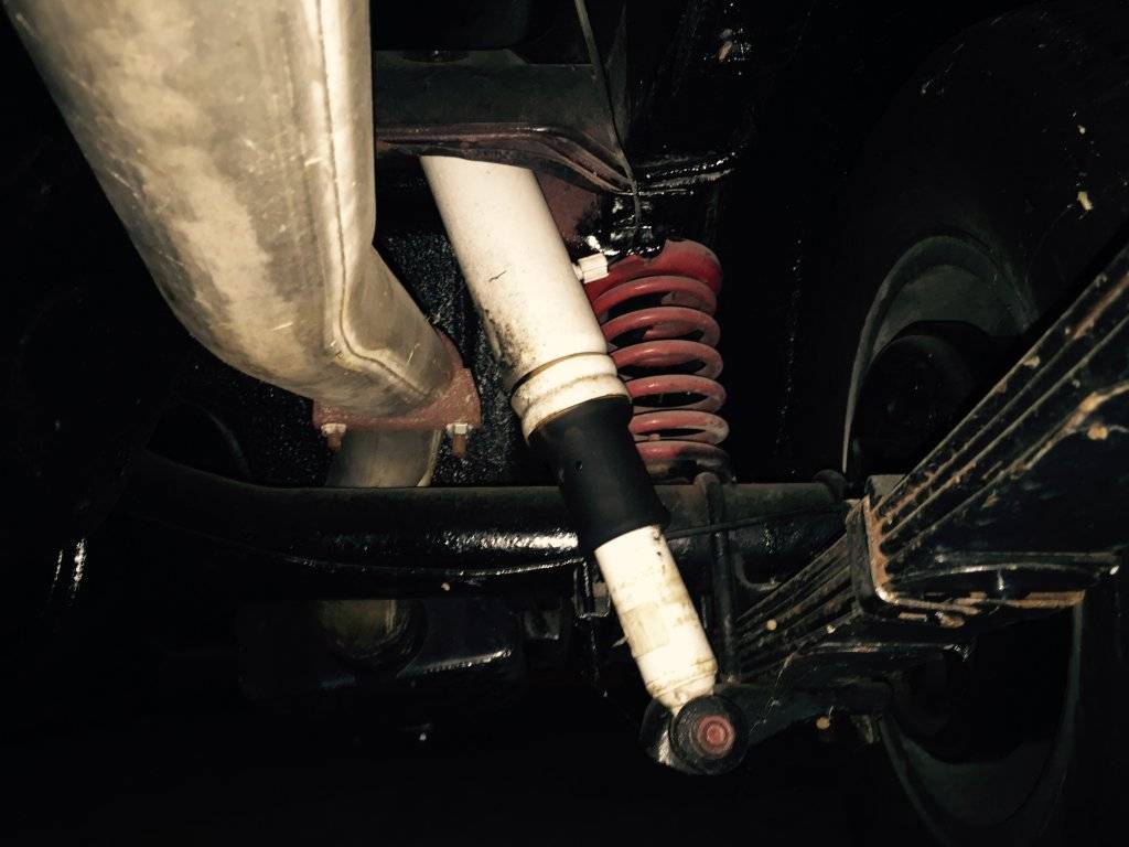

i have a 73 challenger with a 440. Looking for new leaf springs. Thinking of going with the 3300lb springs in the car. The car is full weight so probably about 3600ish. Would that spring selection help it not ride like a dump truck or sag in the back? I currently have XHD springs, some fabricated coils on top of them(bought it like that), and air shocks. I don't fill the shocks because I don't want to break the upper mount.

A pic of the setup

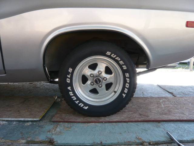

espo plus 2 dont buy the mopar spring there junk ,bought a set and then bought espos +2.

How do the espo +2 compare to the ride height of a super stock spring and how is the ride? What size is the tire in your picture?

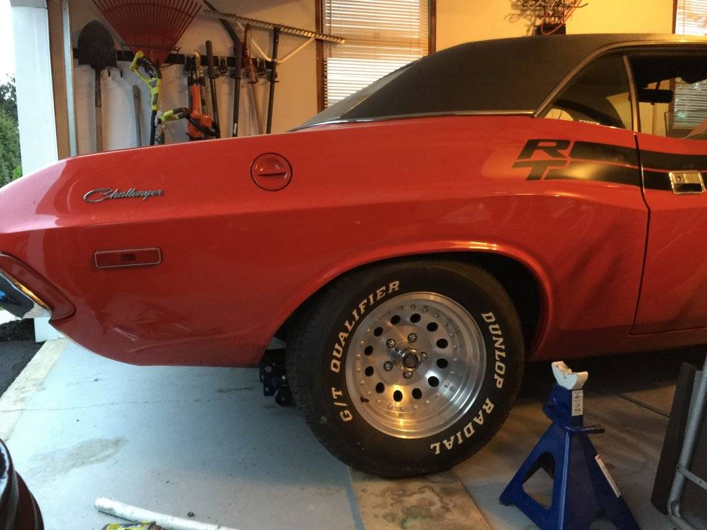

San Bernardino County, Ca
I just did the ESPO +1. Couldn't be happier. Great product. Great service. Car looks great. See pics on my restoration, but keep in mind the car is not at full weight yet so it might sit a little lower when the car is done
