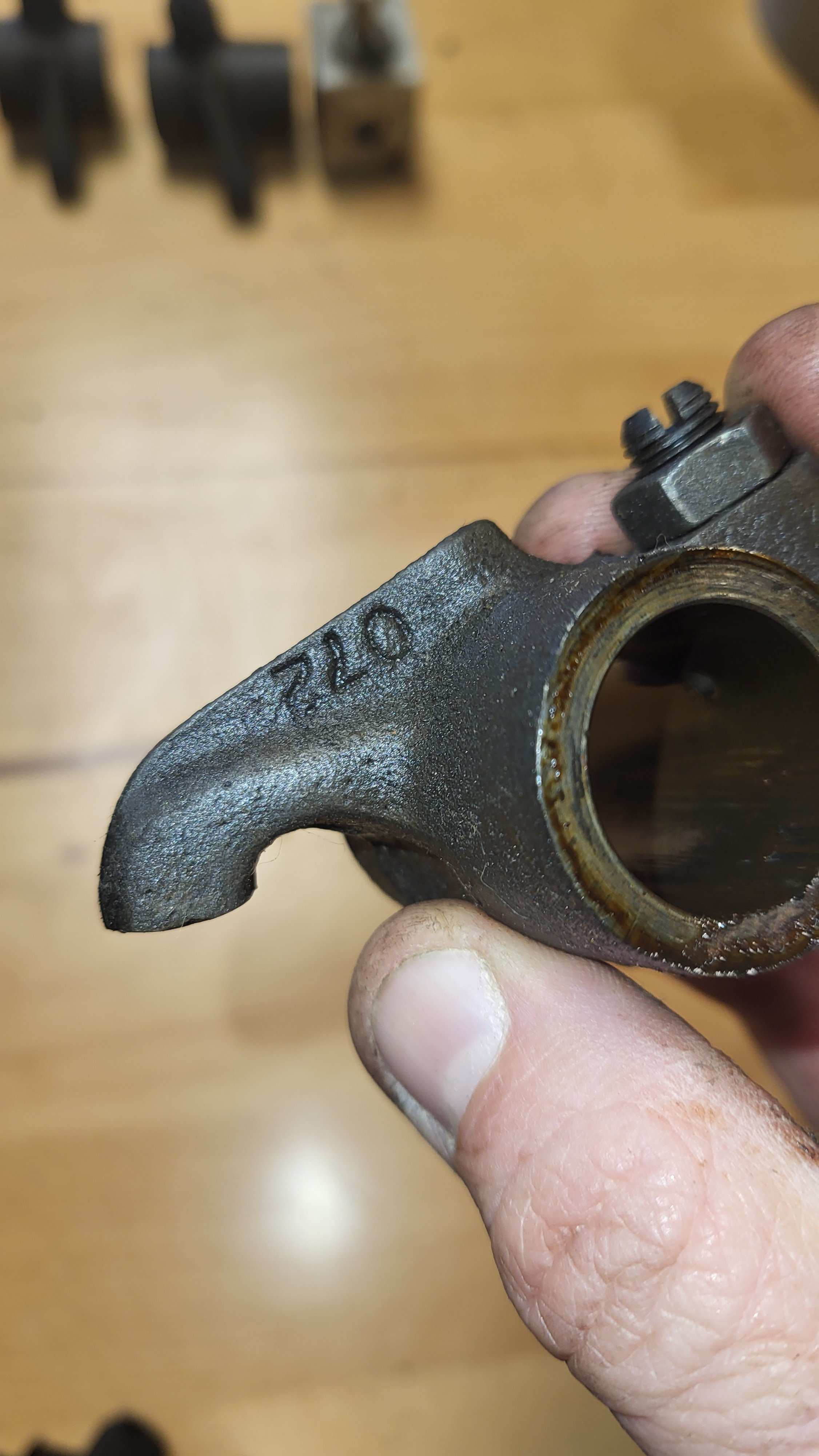

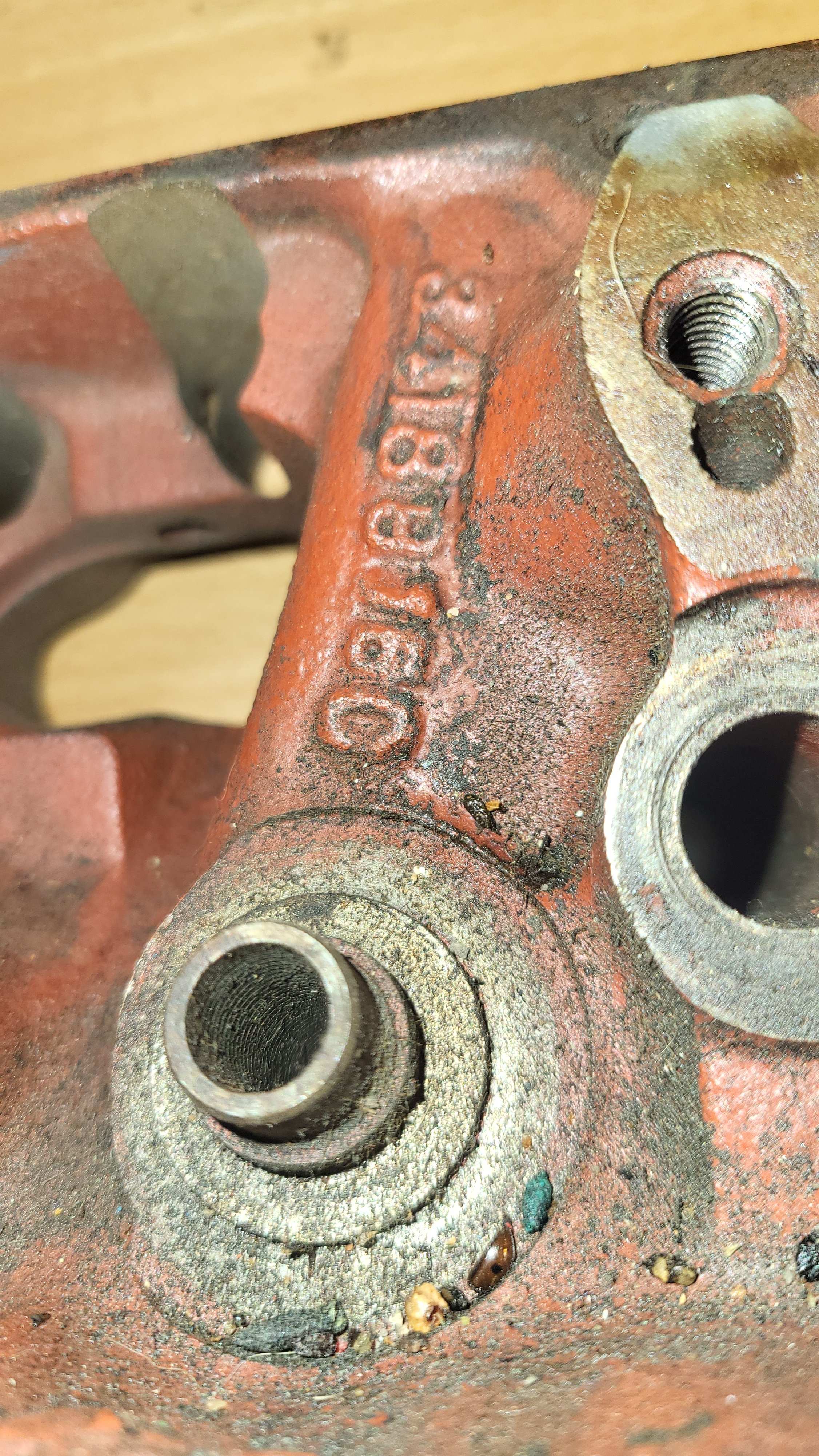

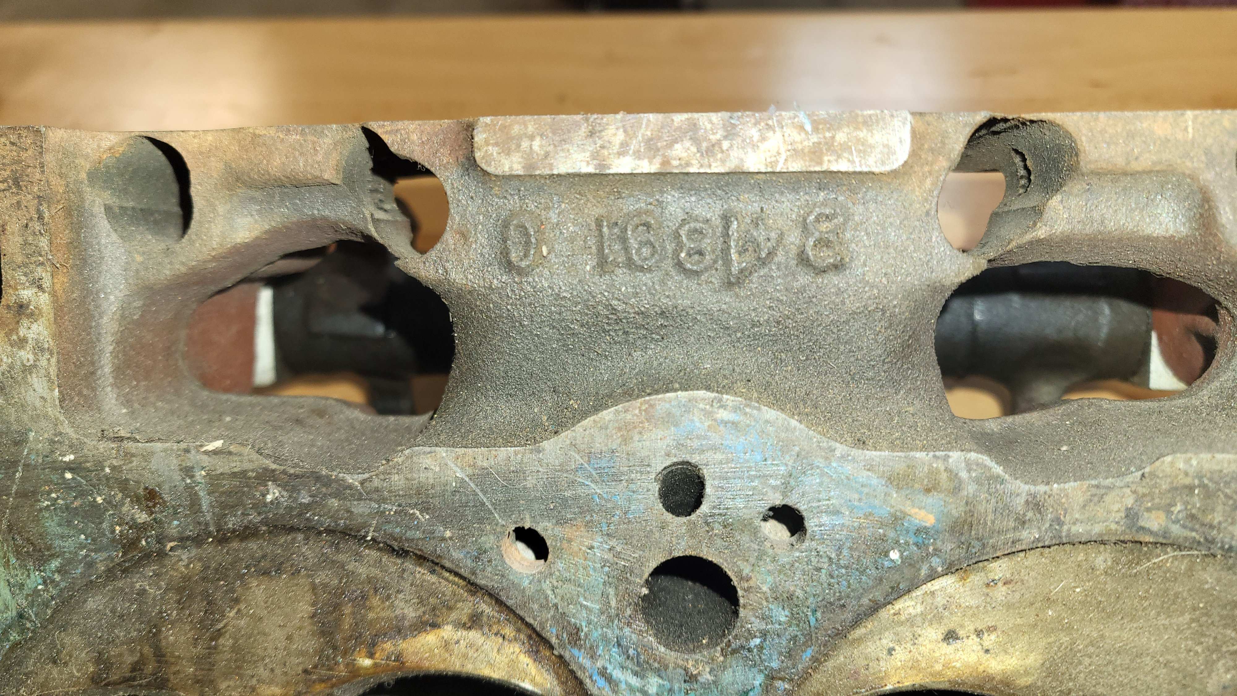

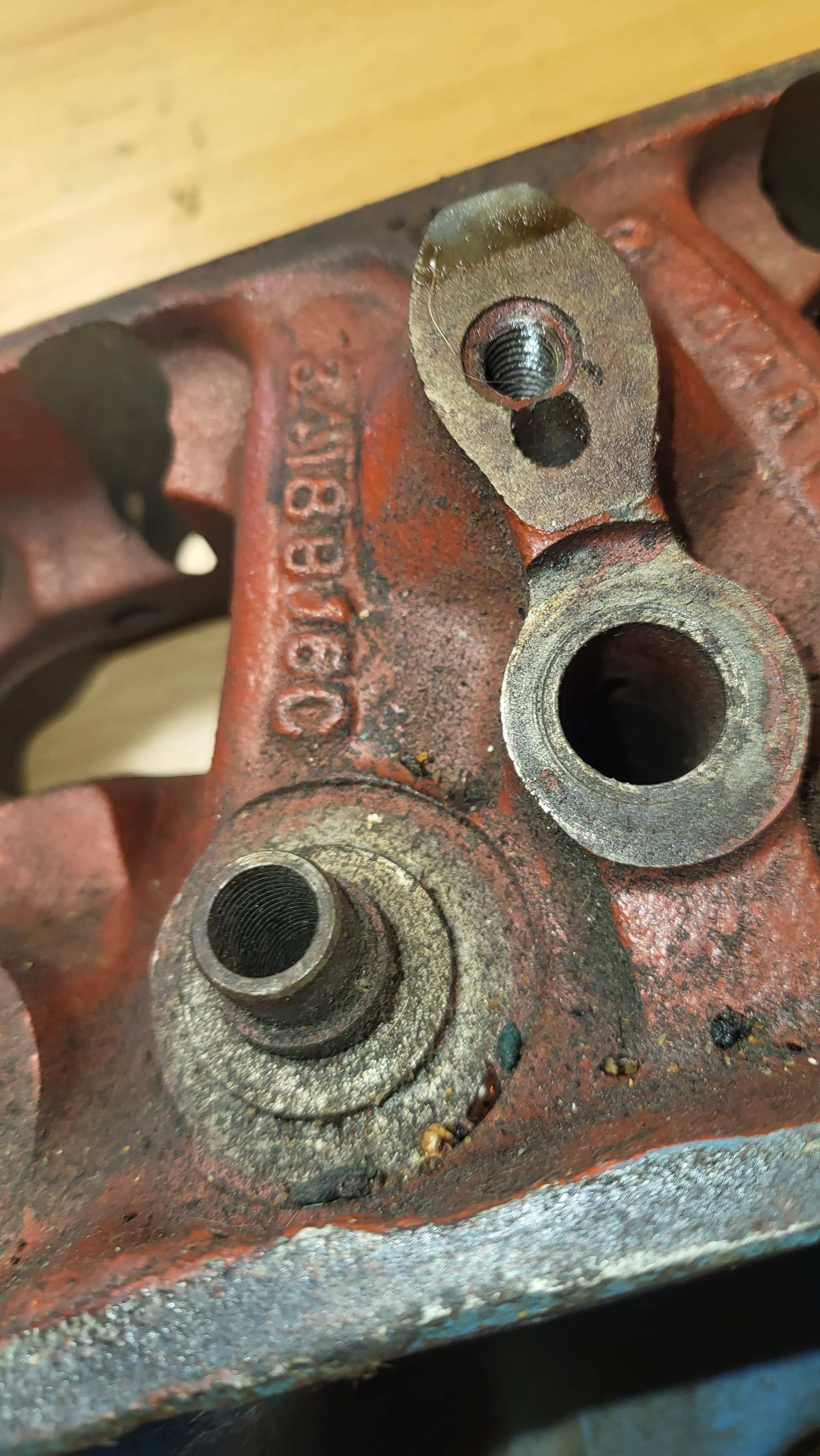

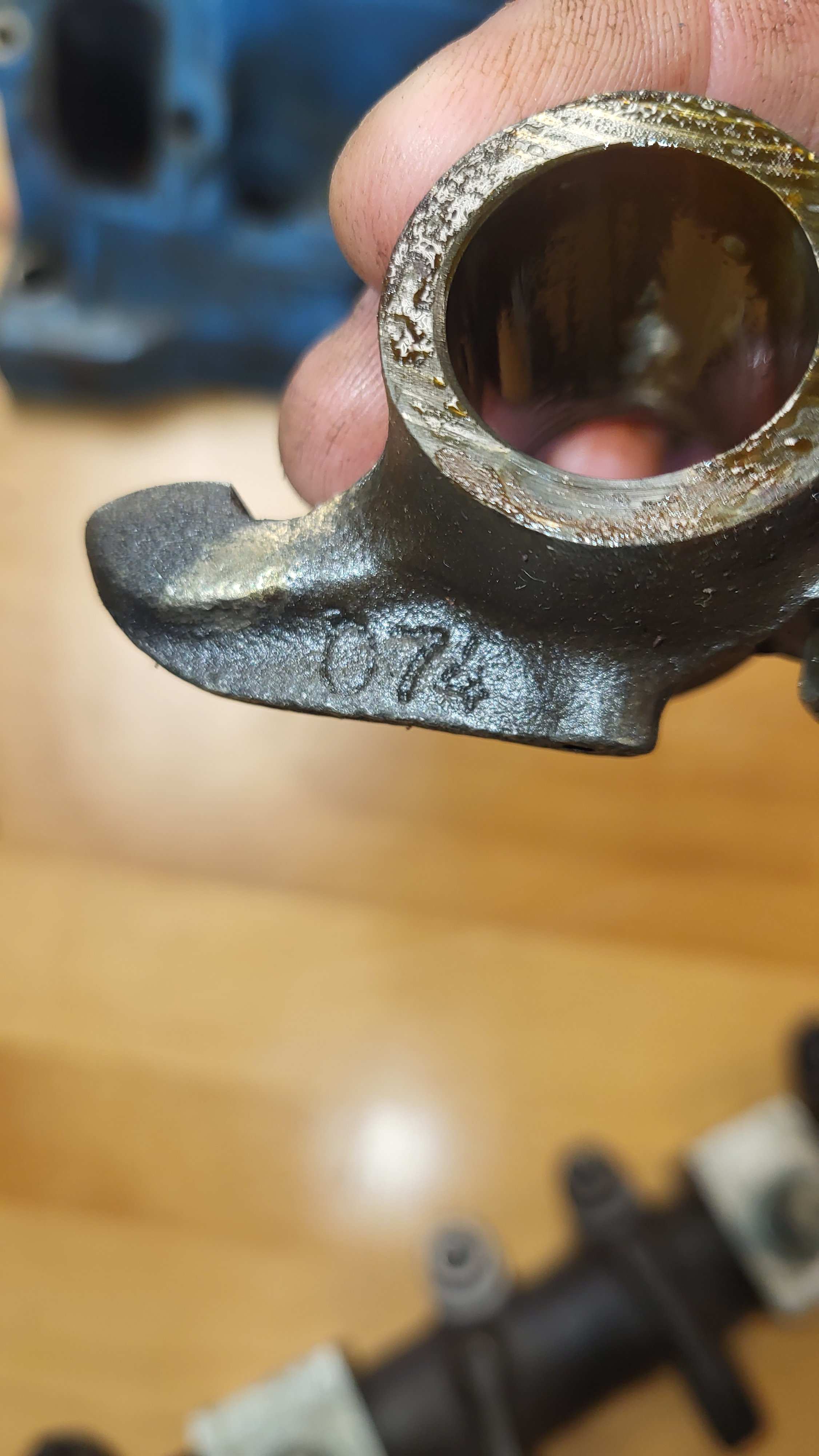

I purchased a 360 block and heads last week. Long story short I believe I have a set of ta heads and rockers. Someone milled rocker arm pedestals flat for w2 style block lock down. Rockers are real ta rocker according to part numbers I have found. I also know they had heads like these that Bob mullen was working on. Some call it a w1 head.
So next, is there value in these heads? I know there is in the rockers. I'm just unsure on what I want to do next. Do I clean them up and sell them? Can I say they are a ta head. Then what's a fair market value? I don't what to give them away as I would use funds for next project, but I don't want to be that guy either. Of look what I have I want triple the value. Any advice would be helpful.

Looks like you have one J head and one U head. From what I have read the all have the 915 casting number and most likely the 1.88 intake valve size.

That's not actually accurate. So not all 915 heads are 1.88 valve. 1970-71 915 heads had 1.88 valves and 2.02 valves. 1972 they went to all 1.88 valves. I would imagine that change happened around april 1972. Thats when they went from forged and internal balance in 340s to cast and external balance. 73 no more 915 cast head and all were small valve. The u code and j code mismatched heads are not uncommon on ta motors. They took U, J and O code head blanks. Machined them for the ta motors.

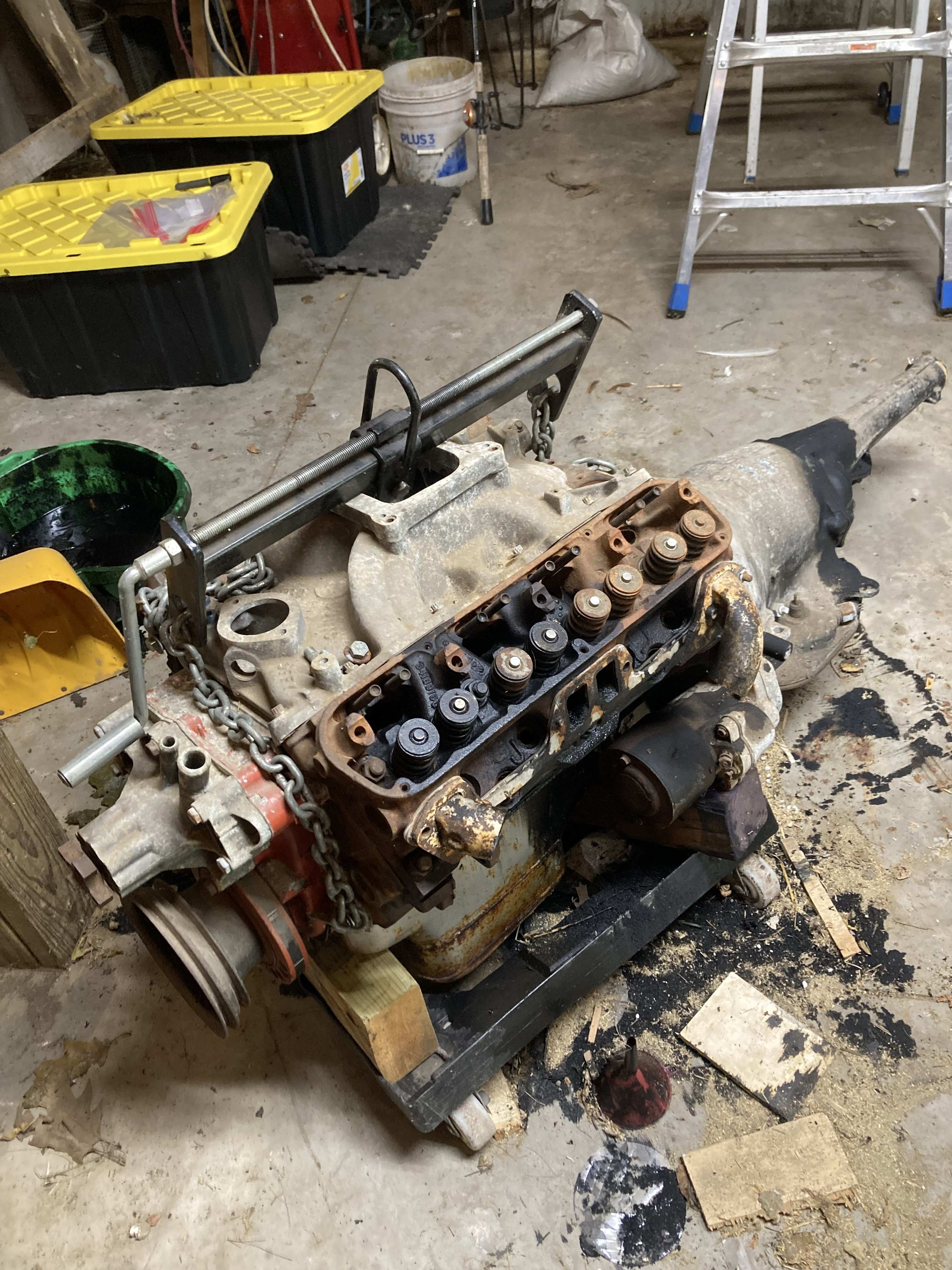

Here is a photo of the original motor from my recently acquired AAR. If you look close you can see numbers matching what you have. Looks like a t/a head to me as I’ve never seen anything else with the offset pushrod provisions. Congrats

TA heads have the intake pushrod holes moved away from the ports as yours do. So yes, they appear to be TA heads that some one modified with the rocker shaft posts and machined out the intake push rod holes even more. As for what they're worth, I'd say less than a virgin set of heads, but someone might be willing to pay more. Which brings up the old saying, "It's worth only what someone is willing to pay."

Are both heads on your Js? Or are the mismatched one u and one j or an o head. I see driver side is a j

Normally when the rocker shaft posts are machined, it's to fix the geometry back to usefullness when running a big camshaft (think .55" or more) and those TA rocker arms. That 360 might be a pretty stout engine!

Looks like a J but not sure could be an u on there, take a look. Engine is in the shop so can’t verify beyond the picture.

Looks like they have a lot of porting & Oringed also the block has been drilled for oil return around the lifters i would get them pressure tested & cleaned could be some good race heads

His heads are definitely TA heads as the non TA pushrod indent is on his heads. See circle below. Thinking more about it, this 360 could be built up with those heads and more gas pump friendly compression pistons and ~.500" lift camshaft and last basically forever without ever blowing a head gasket!
